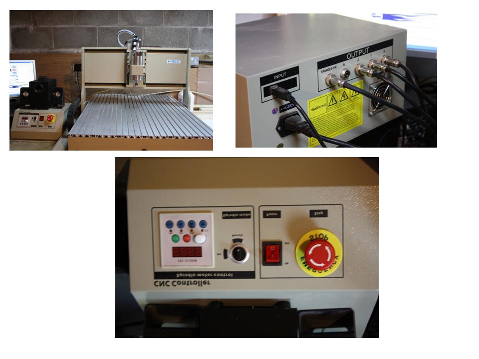

Re: Brummie, New Member Needs a Hand
Sorry it took ages to upload the pics.
OK
from the picture of the rear of the control box I see it has a USB interface to the PC
unless you have installed the correct "plug in " supplied on a CD that came with the machine
mach 3 will not to be able to control the machine
a picture of the board with the USB connector may help if a member recognises it
John
Hi Brummie,
I have found a software download for a 4 axis USB Chinese machine. With a ton of luck it could work, but you will probably need a computer whizz-kid to set it up. Anyway, it is the best I can offer for now.
https://www.chinacnczone.com/en/mach..._l282_p15.html
Hopefully - and it is big hope - the Chinese machines with USB use the same controller.
The fact that your machine thuds when you switch it on means the motors are connected and the drivers enabled, so that is a good sign.
