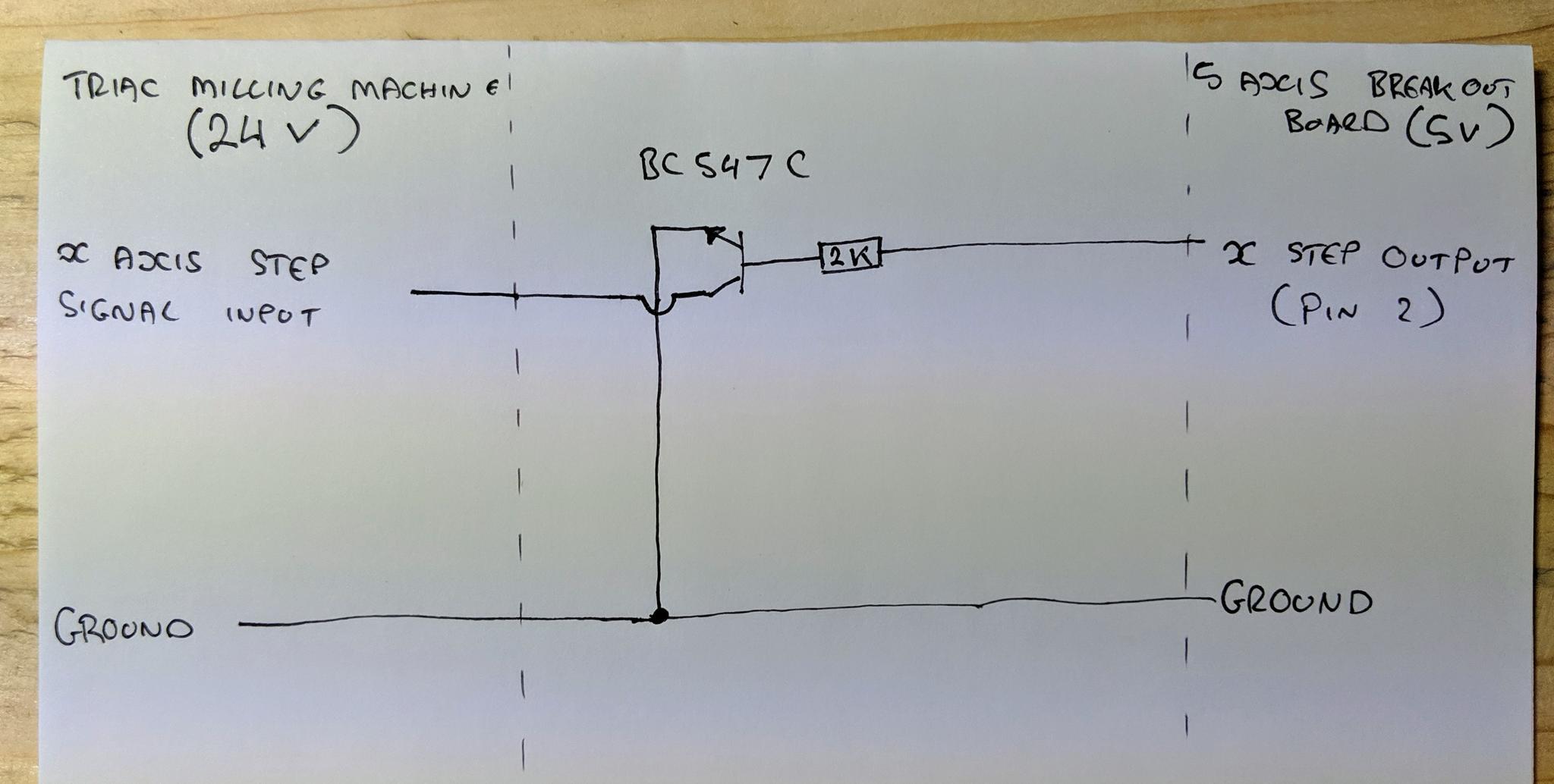

Hi Kit

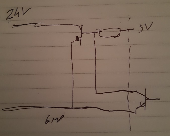

Thanks for your input. I've been racking my brain trying to work out how to get the open-collector transistors to send 5V to the Base on the transistor required to power the Step signal on the milling machine driver. I've drawn out 2 circuits, the first it the one I have already tried and it failed, but when I connected the 2K resistor directly to the 5V source on the breakout board, rather than the X step output (Pin 2) it did cause the X axis to step once. The second circuit is my version 2, do you think this would work?
I'm open to any suggestions, all I need to do is connect the X Axis step signal input on the milling machine to ground and I need the pulses from the BOB to make and break that connection.
Dan.
Attachment 26322
Attachment 26323
Re: Half complete Triac conversion needing some advice.
You want the BOB output to switch to GND for the driving transistor, so the only way to acheive that with a single transistor is to have the driving transistor pulled up via a suitable resistor, then have the BOB output switch the driving transmitters base to GND.

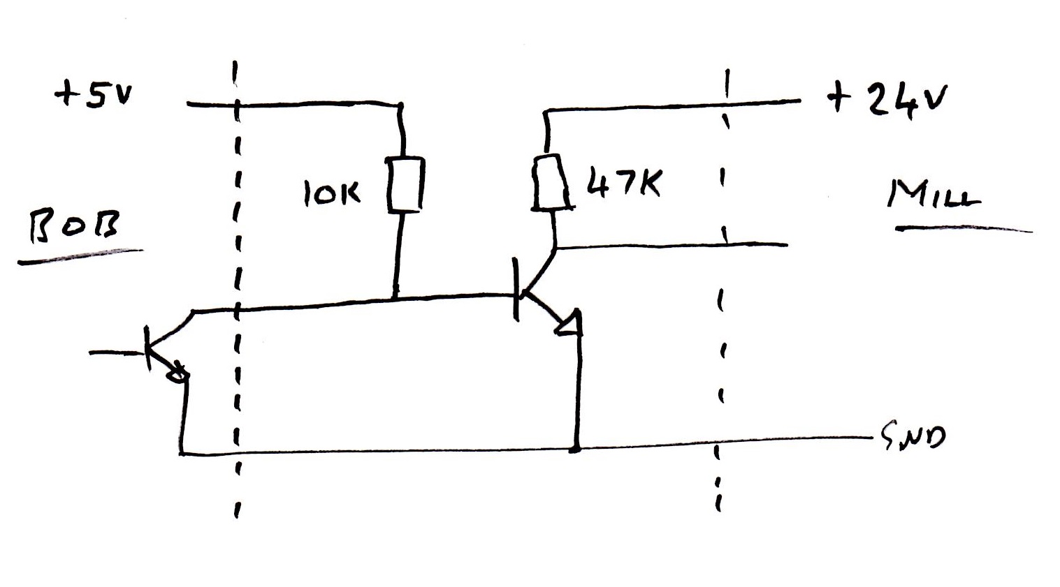

Dan,
The open-collector on the BOB (if that's what the output actually is) is a connection to earth which may be able to control the 24v line directly, though without more knowledge of the exact equipment involved I would not want to suggest you do that without checking with the manufacturer's datasheet. The fact that an open collector does not connect to the BOBs own 5v power rail gives it the flexibility to be used with different voltages from external equipment but without detailed knowledge of your specific equipment caution is advised.
The attached is a possible circuit to try. The 10K resistor pulls the open-collector output of the BOB to +5v when the BOB output is HIGH. This turns on the external transistor pulling the mill input to LOW (about +2v in practice). When the BOB output goes LOW the external transistor is turned off and the 47K resistor pulls the Mill input HIGH. It's primarily the absence of pull-up resistors which has doomed your experiments so far, though there may be one built into the mill input. Try measuring the open circuit voltage at the mill input to find out. If it's 24v then the 47k resistor can be left out. This would effectively give you an external, buffered open collector.
Note that this is an inverting buffer, you may need to adjust settings in MACH3 accordingly (I don't use it so cannot help with where to do that).
Exact resistor values are not critical, the values chosen give about half a milliamp of current in the transistors when turned on.
Kit

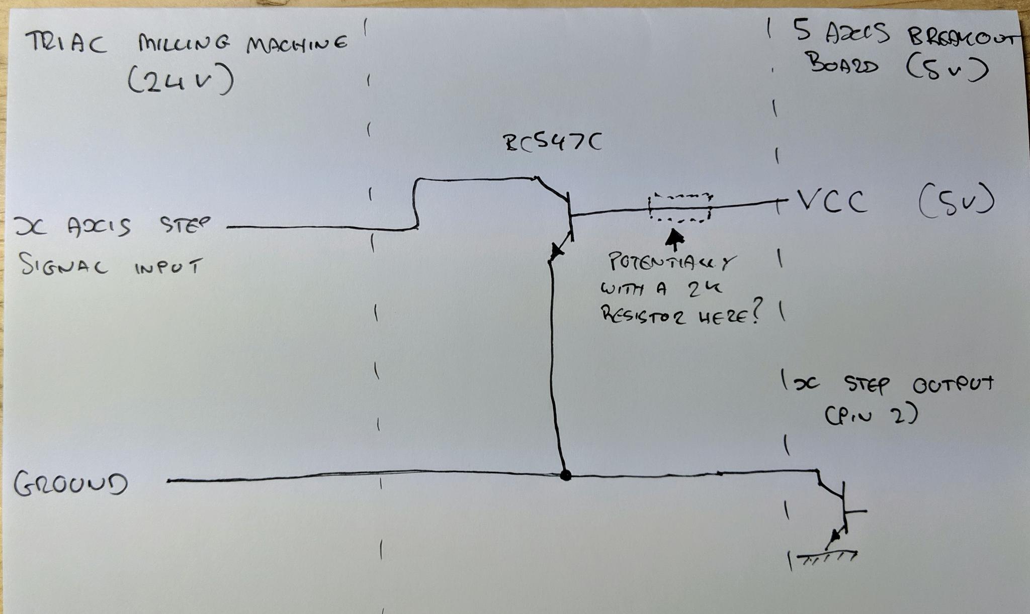

Kit, going by Dan's second post (relevant bit quoted below to save you scrolling up!), the drives must already have internal pull-ups, so there shouldn't be any need for a pull-up resistor to the 24V.
Dan-27
Attachment 26322
m_c,
I think you're right, I did suggest Dan check for 24v on the mill input to check. It's the lack of a pull-up on the input side that is most important here.
For those who might worry about it, two pull-ups in parallel will not cause a problem as long as the total current through the relevant transistor when on is within limits, so adding an external resistor for testing purposes will not harm anything. 2Kohms per volt (gives half a milliamp of current) is a good rule of thumb.

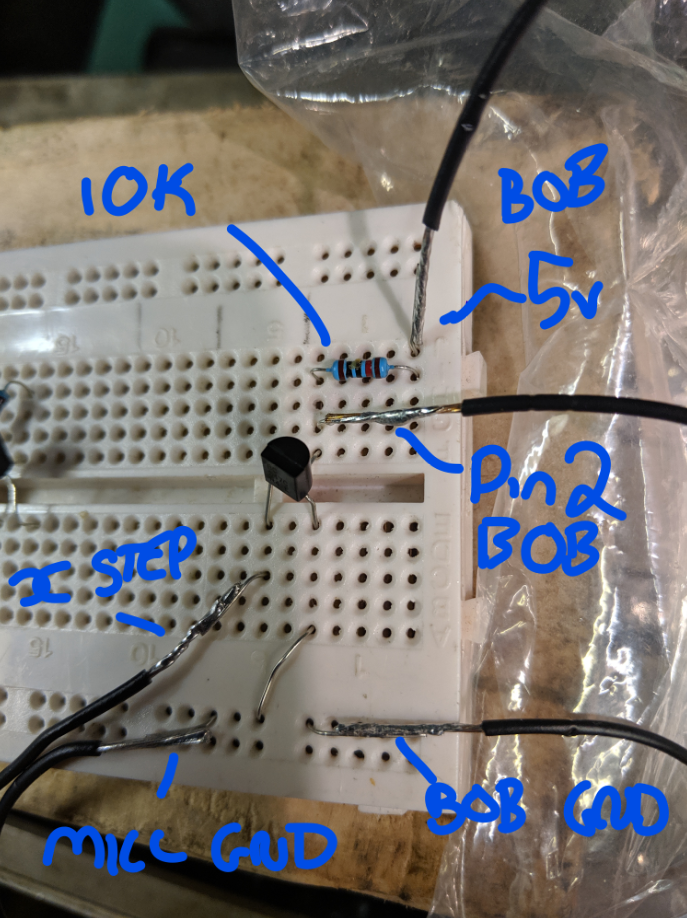

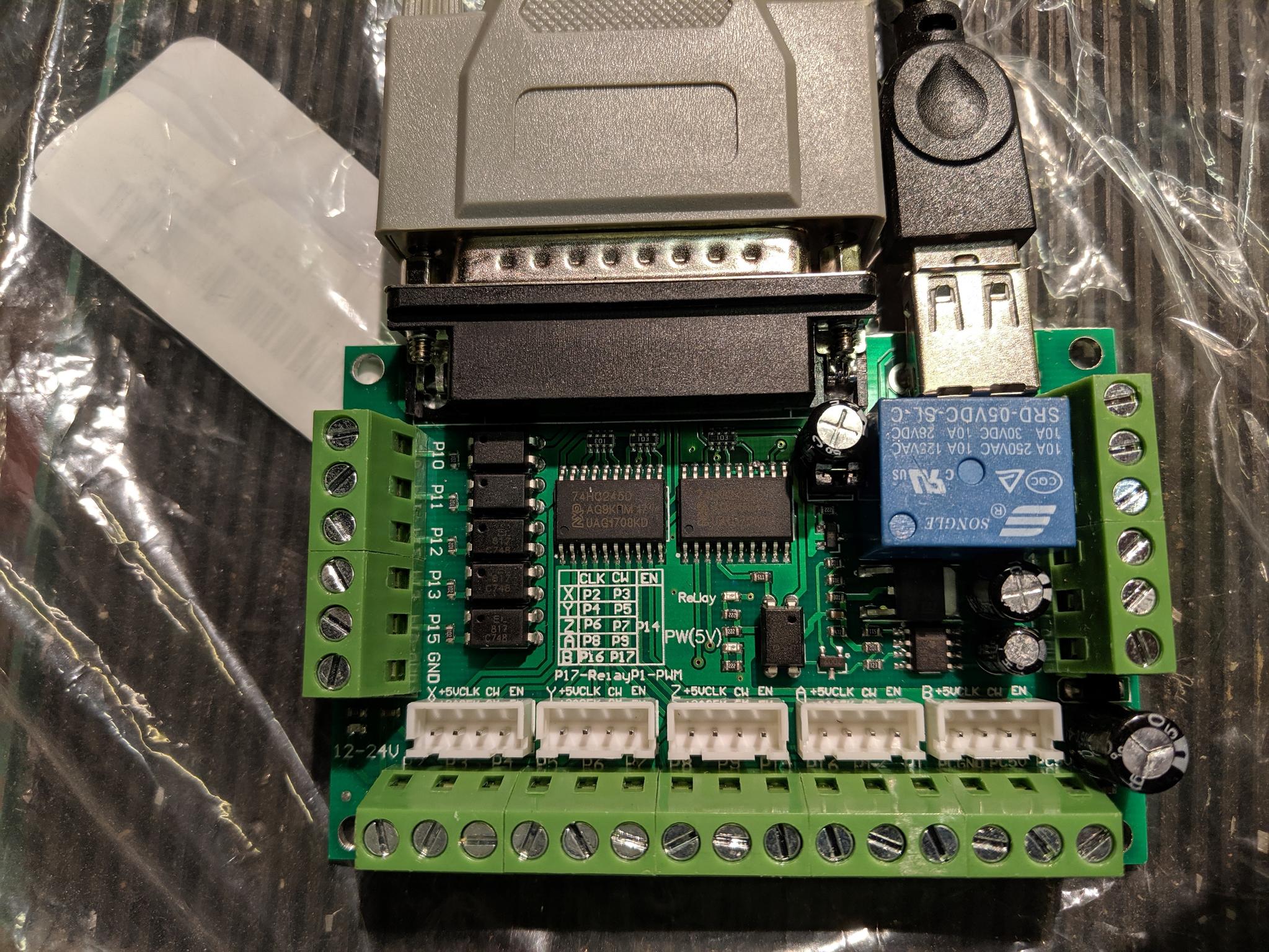

It's not playing ball unfortunately.
I believe I have replicated the circuit correctly, and the X axis does step once when I connect the wire from the base leg to pin 2 on the BOB, but jogging the X axis has no impact. I have also moved the wire from Pin 2 to 3 on the BOB, with no affect. Pin 2 is the X axis step and 3 the X axis direction.
The mill does have just shy of 24V on the signal input. On the picture of the breadboard touching 'X step' to 'Mill GND' causes one step.
How can I test if Mach 3 is making any impact on the BOB? I think all the results I have currently achieved could be been done with just the 5V and GND. I only have a multimeter for testing.
Also I don't think the BOB is capable of switching 24V. Aside from it being very cheap, I think the IC's in the middle handle the output switching (the 5 on the left are opto isolators) Searching 74HC245D found they are 'Octal bus transceiver's capable of handling 2 - 6v. Again way outside my electrical understanding, but I think that's correct.
Attachment 26342

Having a think about a suitable test to confirm whether or not the BOB is being changed by Mach 3. If I took a red LED and a 150ohm resistor and connected them between the 5V supply on the BOB and pin 3, the x axis Dir, would it light when the axis was moving on one direction and not in the other? I was under the impression the BOB would give a High output for one direction on the motor and a Low output for the other?
Many thanks
Dan,
Strictly speaking the BOB open-collector outputs are either a low impedance path to earth or a high impedance. This is why you need the pull-up resistors to get the required 0v or +5v output to your external transistors.
The LED circuit should work. The LED must be connected the correct way round, test it first. You probably already know that but just in case there's somebody reading who doesn't know about diodes.
Check that all three outputs, STEP, DIR and ENABLE are under MACH3 control. The step output will make the LED glow less bright than dir or enable when jogging since it will be pulsing when you tell an axis to move. This is a good sign!
I don't use MACH3 and obviously know nothing about your individual mill so I'm at the limit of how much help I can offer.

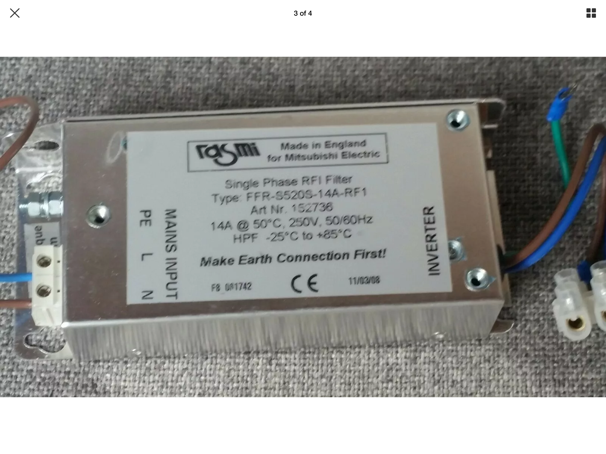

2 Attachment(s)
Hello.

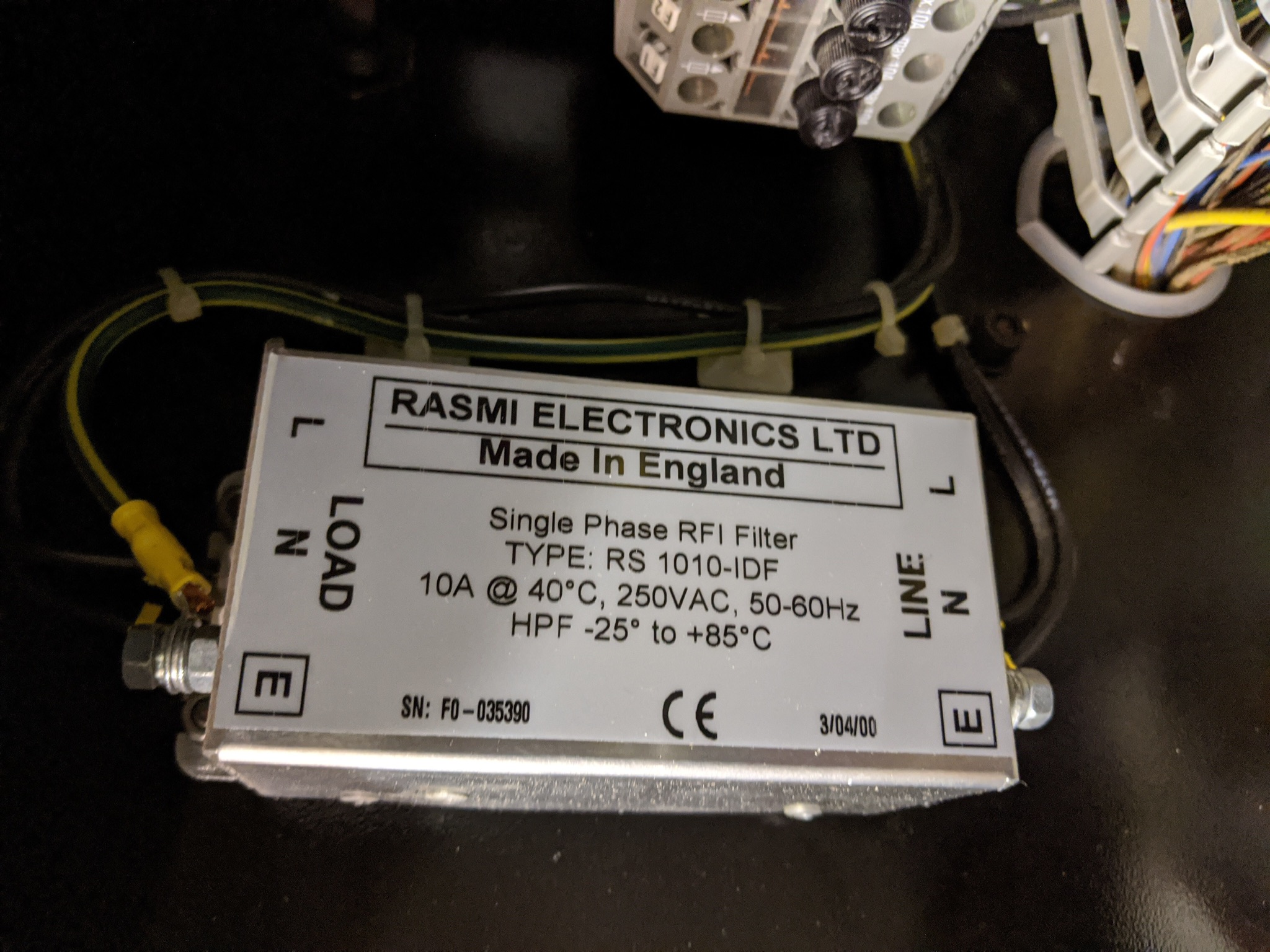

I’m creeping towards the finish line on the milling machine conversion and have hit another snag, while trying to find the stall point of the x-axis I managed to cook the ‘single phase RFI filter’. I’m looking for a replacement, but can’t find an exact match. I don’t know much about these, would someone mind advising how to find a suitable replacement please?
Here’s the info on the one I smoked.
Single phase RFI Filter
Type: RS 1010-IDF
10A@40C, 250VAC, 50 - 60Hz
HPF -25C to + 85C
I’ve found this one on eBay, but it’s rated at 14A, will that be an issue?
https://rover.ebay.com/rover/0/0/0?m...2F112625692608
Many thanks. Dan
Attachment 26999
Attachment 27000
A higher current rating won't be a problem.Its only when you go lower that you have to be careful.

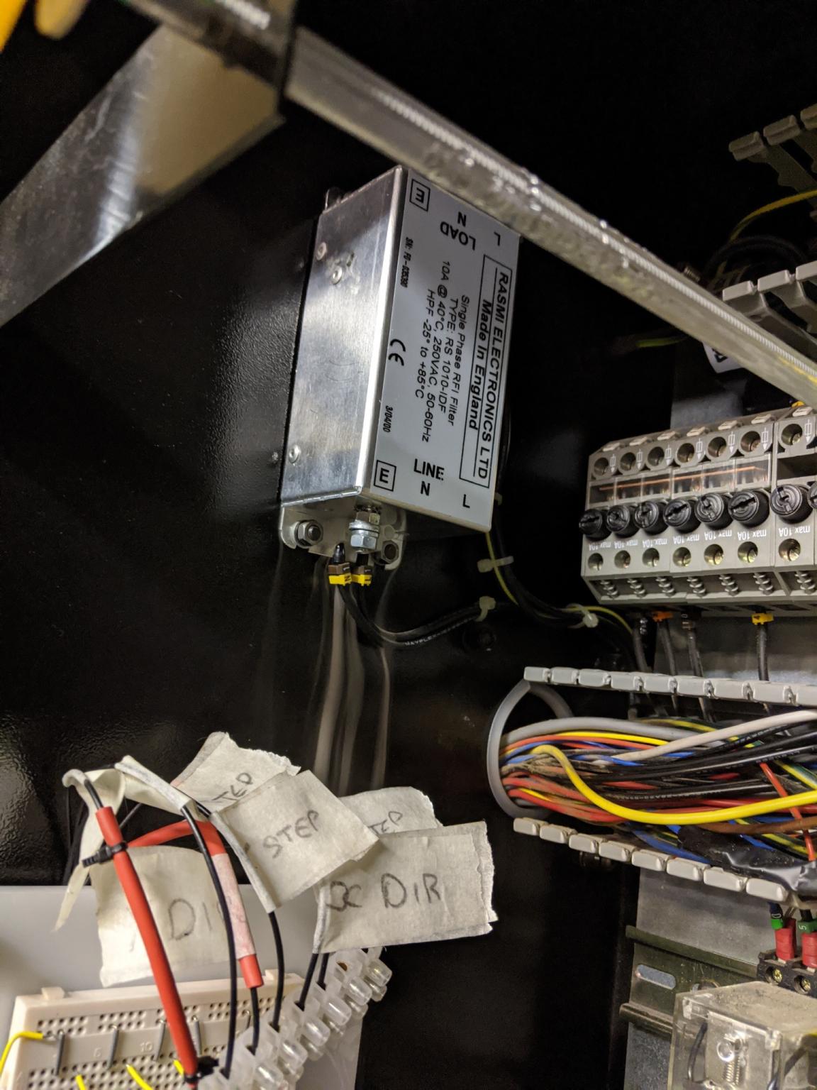

Thanks for the help Sterob. Just to confirm, because I really don’t want to buy the wrong thing and trash over a years work. The one on eBay is labelled ‘Mains input’ and ‘inverter’ where the one I have removed from my machine is labelled ‘load’ and ‘line’.
Am I right to assume ‘line’ and ‘mains input’ are the same and ‘inverter’ and ‘line’ are the same? I’ve attached an image of the eBay item I’m referring to.
Attachment 27006
Dan
You are correct
