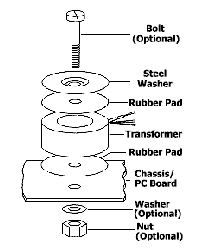

Sometime i read about how not to mount one of these transformers but i dont remeber now.
Would this be a bad way? The top metal disc would be connected to the cabinetchassis if i do it like this.

yes, the diagram in post 6 is the usual way to mount an open toroidal transformer
if its fitted in a low profile metal enclosure just make sure the lid can not touch the bolt head and form a shorted turn !

Feeling stupid now but, make sure what cant touch the bolt?
The chassis would be in contact with the screw by mounting it in it or am i missing something?
Re: About my Thoroid transformer...
Any connection between the bolt head and the chassis will result in a shorted turn
but if its fitted in a low profile metal enclosure
then it may be possible for the top to be deformed and touch the bolt head if pressure is applied !
Attachment 26393
John

How about the lower end? The nut will be in contact there right?
the lower end is OK as the chassis , bolt and top mounting disk don't form a complete turn around the toroidal core
its only when you close the loop by connecting the mounting disk to the chassis by a conductor outside the core
