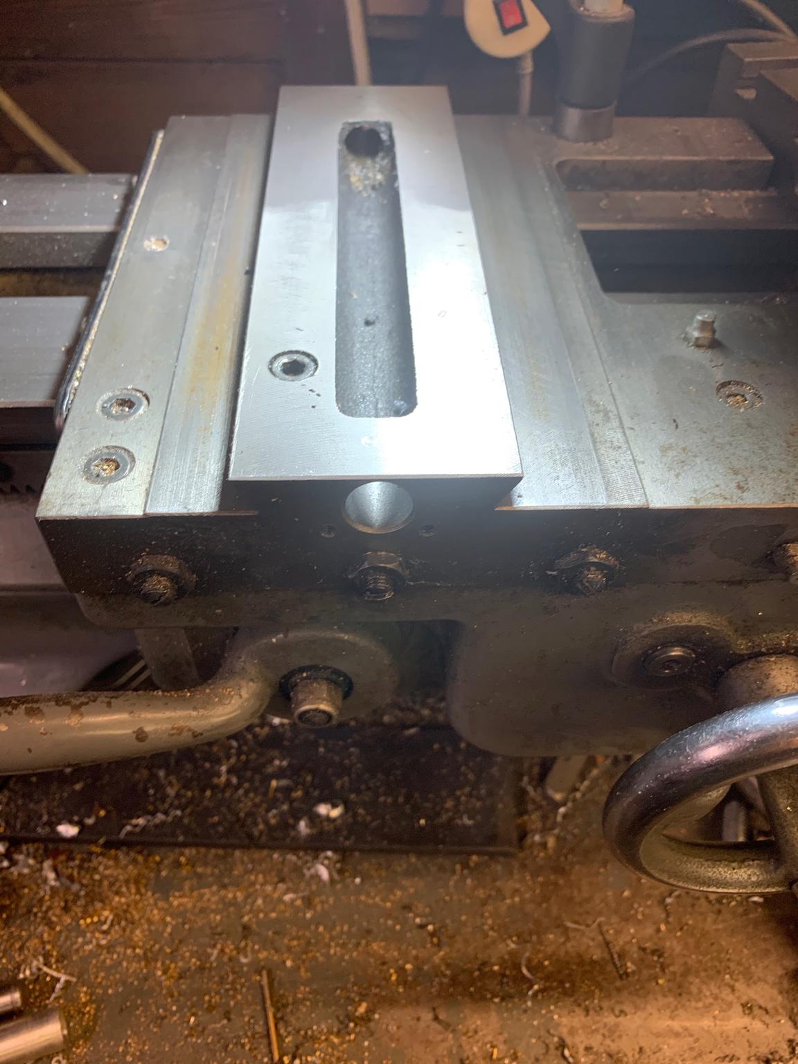

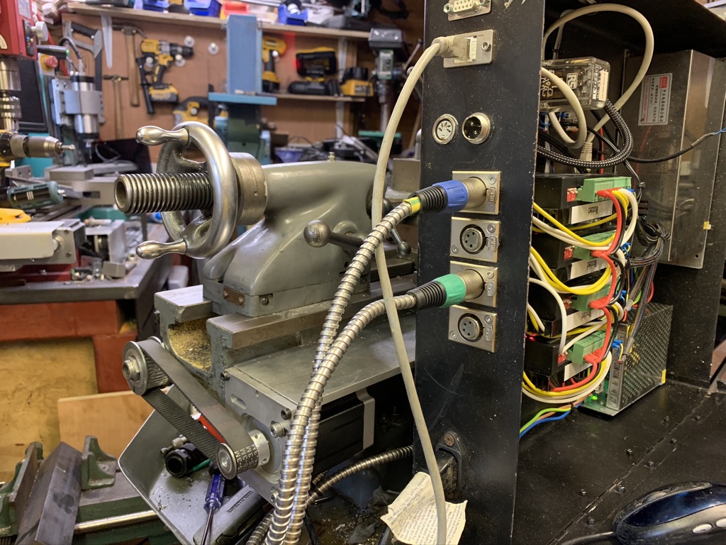

Okay, mixed thoughts at the moment. I'd started with the Jeffree conversion for the Z-axis some time ago, and over the last weekend knocked up a more compact X-axis...
Z:
Attachment 26541
X:
Attachment 26540
Just for confidence and a break from the mechanics I've slaved up an old controller box (first pic) and an old XP box that had the driver for the ethernet controller for the control box from storage.
It proved the concept, but I'm somewhat puzzled by the noise from the Z stepper...
https://youtu.be/1vNJAK9A6PI
X is as quiet as you might expect. Z is bloody awful. I've tried fiddling with the stepper driver with micro steps from 1/2/4 and the current from 3.2A through 5A. It just sounds awful. Part of this is transmitted through the bracket onto the lathe bed, but unbolting the motor from the frame its still not great. The motor has been in situ for the last, maybe couple of years, with light manual use of the lathe (so powered traverses using the lathe gearbox) into an unpowered motor, with stripped ends to the motor wiring that may have been shorted from time to time (just rolled up and stowed under the motor bracket). To me, it sounds very mechanical and internal to the motor. I do have a smaller motor available to replace this... in fact I should have an identical one but not seen that for a while. Whilst I tidy up the shed a bit has anyone heard a stepper sound quite so bad - is it likely goosed?
Re: ML7 : To convert, or not...
Sounds like it's the gearbox making the noise, can the leadscrew be disconnected or gears moved to a neutral position, i don't have a gearbox and can just move the quadrant out of engagement.
Mike
Nah, I've pulled the final gear from the gear chain - it's not that. I've also pulled the belt from the motor and the motor still grinds under power. Removing the motor from the mount and it still feels aggressive under rotation, but it's the coupling of the motor to the mount that generates the awful noise. Perhaps some weird harmonics.

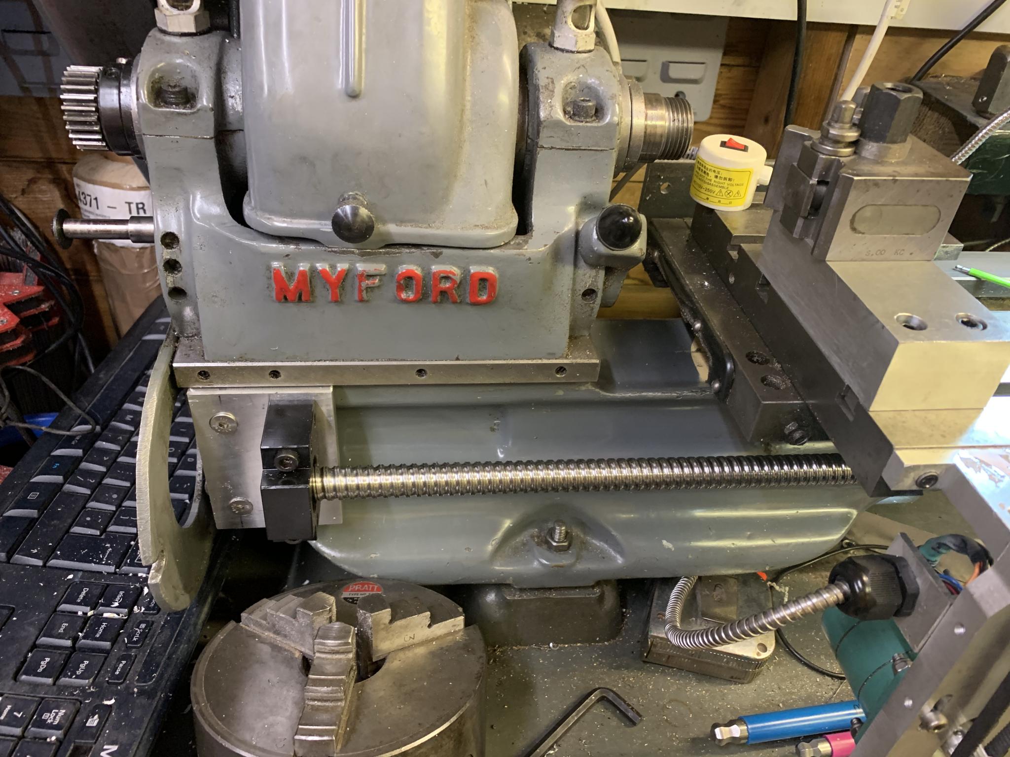

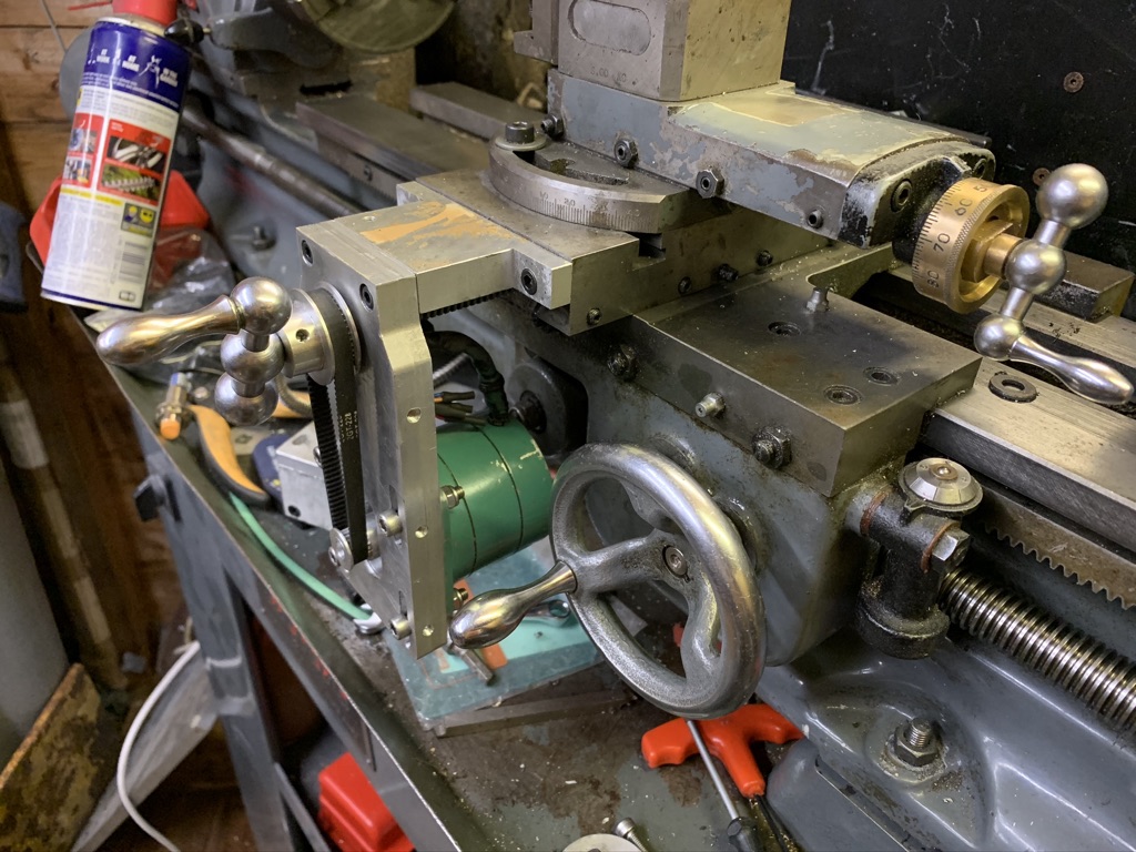

2 Attachment(s)
There comes a point in your life where you say "sod it!" to playing with backlash, and decide to go for it.
Attachment 26663
Attachment 26664
So, removed apron and acme screw - and you know what?, it all became easy from that point. Also, removed the top slide with a fixed tool post (I don't see much point for CNC and it removes some weakness from a rigidity point of view) - undersized to allow me to change my tooling from 8mm to 12mm shanks.
I can slew the saddle from spindle nose to end-stop easily by hand. I need another pulley (on order) and to measure a new belt, but I think this was a necessary way forward.
Will recover to an operative state when I get a belt and take it from there.
