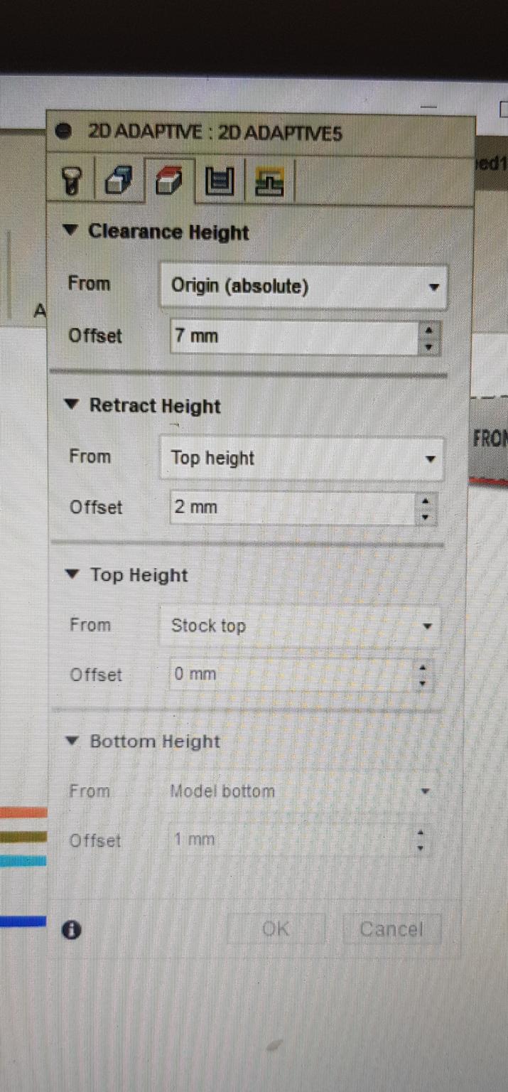

Z axis out by 2mm mach3 or fusion360 problem?
Ok guys I posted something similar to this the other day but the I go about explaining thing isn't the best 😂
Anyway here goes, I have just moved from linux cnc to mach 3 and the issue I am having is after i have zeroed all the axis and start to mill, the z axis always starts off machining 2mm above my workpiece, I use fusion 360 as cad and cam and when I simulate the tool paths everything looks fine.
I have calibrated the z axis over and over again and I also tried milling a simple pocket which turned out perfect. Could this be an issue with my "heights" setup in fusion360? I have posted a pic of my height setup.

Sounds like it's your Cam (G-code) but unfortunately, I don't use F360 so can't help.
However, if you want to check your moving correct amounts regard steps per then Zero the work Coordinate then goto MDI type G0 Z10 (or any amount you prefer) then measure to see if it moved this amount. Then G0 Z0 and it should go back exactly to point you touch off at.
If this works then it's your Code.

I use 360 and the retract height is the height the tool starts at for most operations. If your part has a flat top, you can set the retract lower as there is no danger of hitting the part as the tool is moved to the start of the next cut.

Then it's not Mach3 which answers half your question.! . . . There is one other possibility.? Check you don't have a tool height offset set in tool table.

can you make a simple program such as a 50mm square part, face it off and post the code so we can see what fusion is producing

I ran a test piece and it cut everything fine so a copied the hights I used in 360 that were pre-set and used them on the work I am having issues with and it still started cutting 2mm above the z axis zero height which has frustrated me even further, the readout on mach3 knows it is cutting +2mm

Explain what you mean by copied the heights.! . . Copied them to where.?
post the code your having trouble with so can check it out.
Re: Z axis out by 2mm mach3 or fusion360 problem?
I mean the retract height, stock height ect. The heights tab in fusion 360.
I will post the codes first thing in the morning
I think I know what is happening. You have your top height as stock top rather than model top. If there is stock left on in your setup then it will try to machine that away first by starting in free air above your zero. When you post your code tomorrow send a picture of the stock tab in the setup so we can check that out too

You can edit the post to chop some of it out.
Look at you Z values at the start of the code
G1 x-34.534
g17 g2 x-34.831 y1.008 i0. J0.297
x-18.801 z2.9 i8.015 j0.
X-34.831 z2.8 i-8.015 j0.
X-18.801 z2.7 i8.015 j0.
X-34.831 z2.6 i-8.015 j0.
It starts the cut at Z=2.9, unless you are setting your zero in Mach3 3mm below the surface of your stock then it's going to cut 3mm of air before it reaches the stock.
