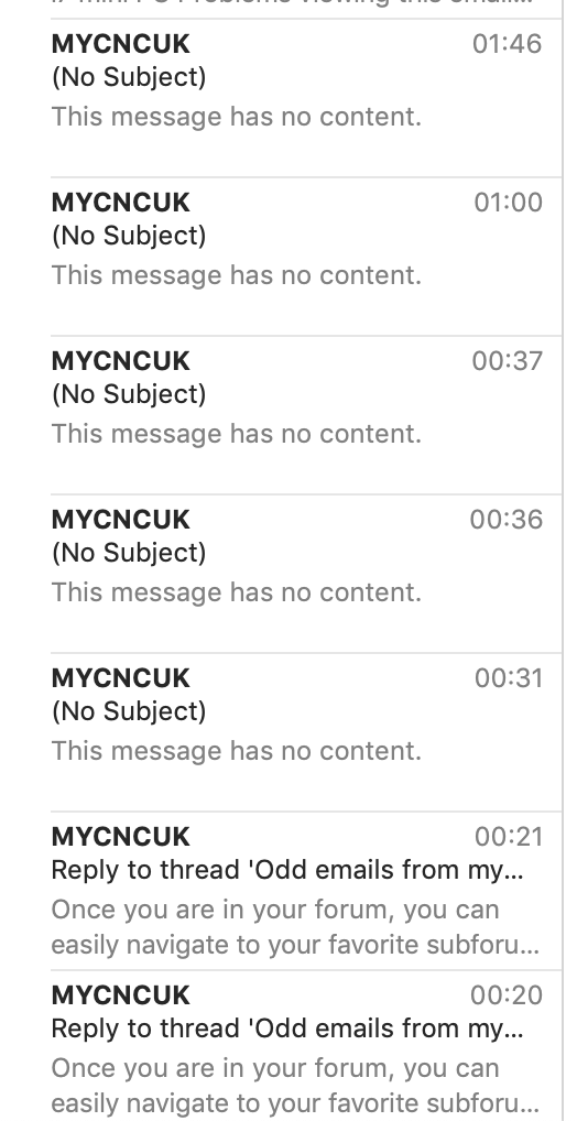

Heads up, I got another tonight around 21:59
Edit...
and...
Attachment 26476
Aye, thanks for trying to sort this out Lee. Looking through the message source I forwarded to you I can't see anything worrying, so at the most it's a very slightly irritating bug. Oh and BTW, I got another 5 between 00:30 and 01:45 - at the exact same time as the ones Doddy got - so it looks like this is a "group email" or "all members" email problem??

I've now had 5 emails this afternoon suggesting that Lee has posted to the Lichuan stepper thread, but I can't see any entries there ....

This message is the body part of the email and the email not only has a subject line, that subject line also contains quotation marks around the words "Easy Servo"...how cool is that?!?!

“This message has no content.” error when viewing an email on an iPhone or iPad using the Mail app
Issue
When opening an email the message text/content isn’t displayed and is replaced with a message reading “This message has no content.”.
This is a common issue with iPhones and iPads and is known to Apple – https://discussions.apple.com/thread/5406637 – if you need assistance with your iPhone we would suggest contacting Apple directly or visiting an Apple store for assistance.
