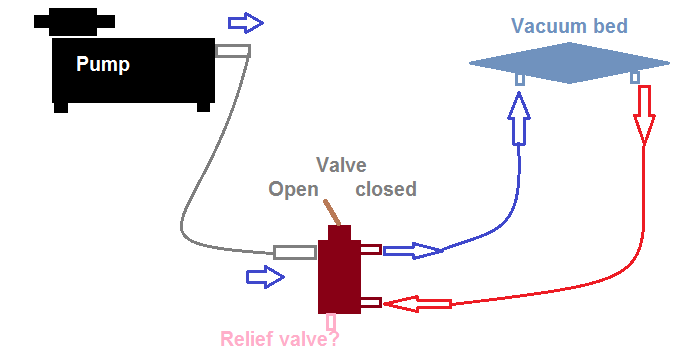

About the vacuum surface, it's bakelite and I have LOTS of neoprene gasket. What I don't know is the system layout:
at the moment, I have the Pump connected to a on/off valve that has a 2 way connection to the plane. Is it ok or do I need a relief valve?
seems that in the on/off valve there is a possible relief valve but I'm not sure, and I haven't connected yet the pump to the power since I don't wanna brake it.
here is the system layout:
Attachment 26525
is this ok or is missing something?
I'm not sure if the relief valve is there, can you recommend a way to test it?

		If you only intend to machine aluminium,you should have bought a mill.I fear that you may be introducing difficulties by installing 12NM steppers as the machine was  built to hold the workpiece in place with 8NM applied to the drive and you won't be able to increase atmospheric pressure by 50% as easily as you can bolt a new motor in place.You also need sufficient surface area to allow the workpiece to remain in place and a piece of wood occupying most of the table would be enough a small aluminium component or a machine vice wouldn't have the area.While you could bolt a machine vice in place,it would lose a proportion of your Z axis.
I have only used two machines with vacuum systems and only one of those had a pressure relief valve.It only operated if we turned off all the valves to the zones of the table.The other ,smaller machine had no valves to table zones and no pressure relief valve-we just turned the pump on or off with a push button switch.

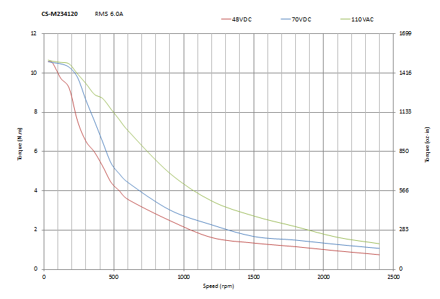

		You need to do a bit reading up about servo and stepper motors.
Those servo motors you've removed, are 1.2Nm continuous stall, and will deliver that torque all the way to it's maximum speed of 5000RPM. They also have a higher instantaneous/peak torque, which gives you a boost for fast acceleration.
Stepper motors on the other hand, only produce the rated torque at zero speed. As you increase speed, torque drops of very quickly.
I couldn't find a speed/torque diagram for those HSS steppers, but Leadshine have one published for their similar motor -
Attachment 26526
Running with a 70VDC supply, torque has dropped to around 1Nm at only 2400rpm, so you have under half the performance of the servo motors you've removed at continuous torque, and probably under 20% once you factor in the instantaneous torque available with the servo, which is where servos excel over steppers.
Those servos you've removed are around the 600-750W power, however you'll struggle to get modern AC servo motors that spin to 5000 (one major benefit of DC motors, is you can spin them very fast with primitive technology!).

		good to know for the relief valve, I'll try to have a go to see how my vacuum system works.
As you pointed, I'm not sure I'm going to keep the vacuum table.
But before deciding if maintain it or not, I want to test the axis; so for the moment, I'll leave the vacuum bed there
		Re: Rye Router upgrade (w Picture) - Agors
		Forgot to mention, I'd guess the vacuum pump will be some kind of simple design with high leakage, so it's unlikely any kind of valve is needed. You just need to plumb the pump to the bed, although depending on the bed design, it may be better to put it through a manifold to control zones (if the bed is machined with zones?), and also some kind of filter to stop anything being sucked through the pump.

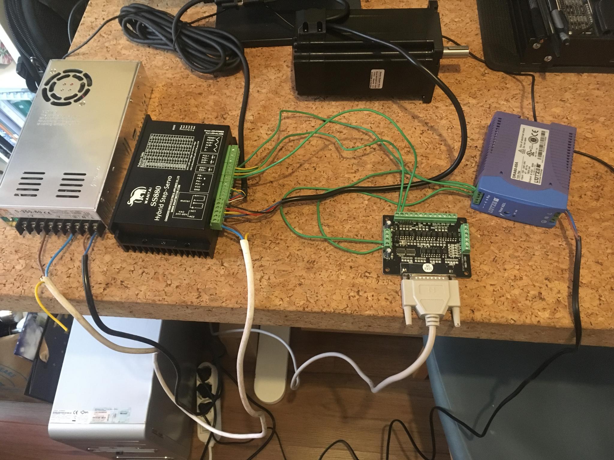

		I'm thinking at what you said and I did a couple of calculation,
So I'm thinking at alternatives,
		If the servos have only be running of 70VDC, then they won't have been running at the full speed anyway (for electric motors, voltage = speed, current = torque).
Those leadshine drives do look like they'd be capable. CNC Drive also do suitable drives (http://cncdrive.com/DG4S_08020.html for 80VDC/20A version).
The key to using those will be making sure the encoders are suitable. You need quadrature encoders, not resolvers which your machine might just be old enough to have.
For modern servo drives, the tacho output from the motor is generally not needed.
Z axis you can do however you want. It's not likely to have a lot of travel, or need to move that fast, so a suitably geared Nema 23/4 motor is likely to be a good option. You will however still need a driver for it.
You'll also need a breakout board of some form, but I would advise against using a parallel port, as it won't be fast enough to get the maximum benefit from the servos.

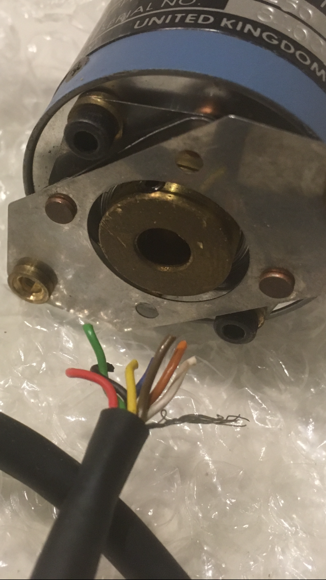

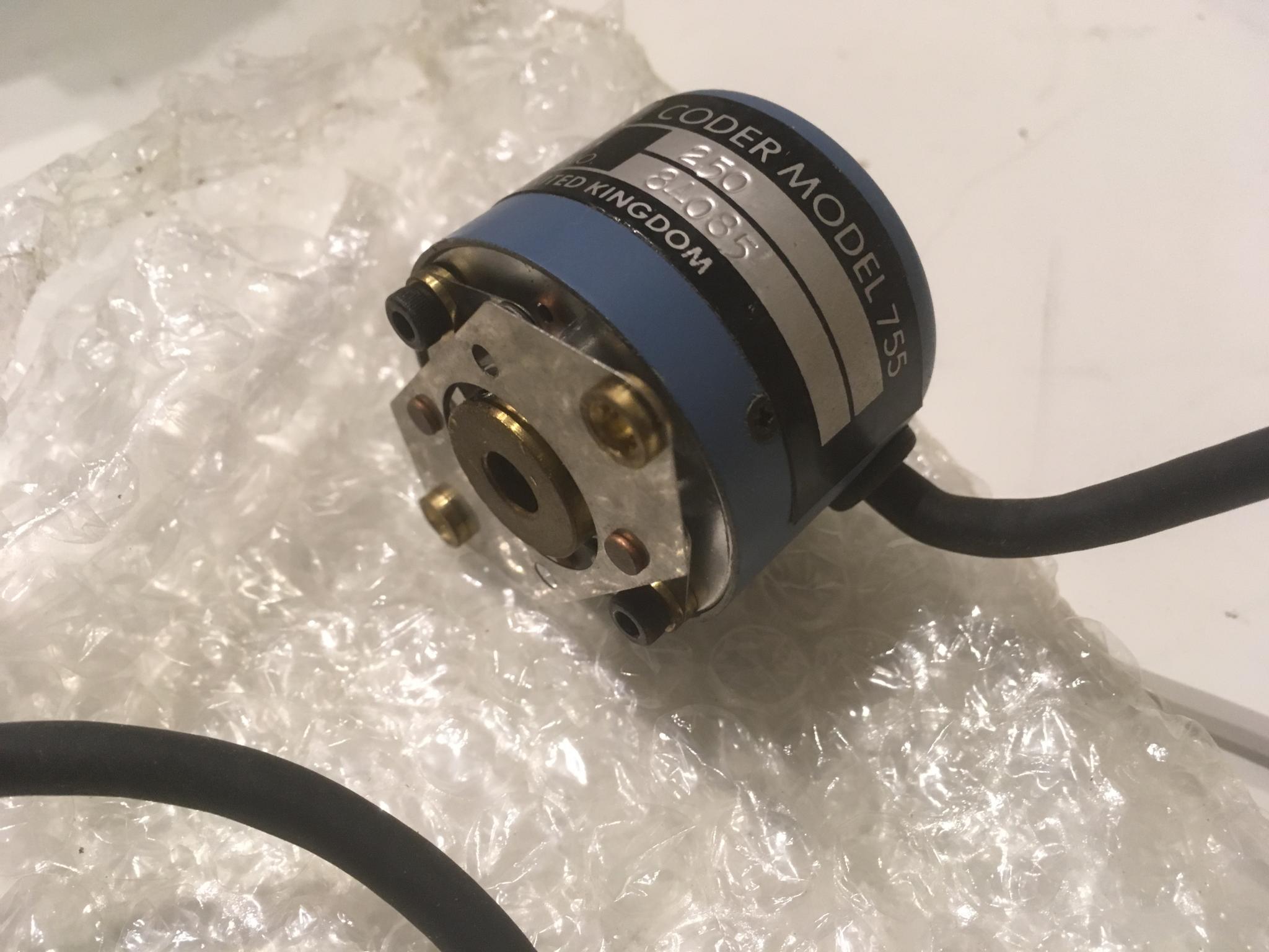

		Do you know if the encoder below are quadrature type?
Accu 755 1000 pulses/rev
Attachment 26534
Would you recommend to follow this route to a newby or the risk of failure is too high?
agors
Attachment 26534
 I would guess that is a quadrature output incremental encoder, however searches have not found any manuals for a 755 encoder.
How many wires does it have?
Ideally you want encoders with differential outputs, which means you're looking at a minimum of 6 wires (+V, Gnd, A-, A+, B-, B+), plus possibly an index pulse (Z-, Z+).
Everything has the potential for failure, but provided you're willing to learn, then most things are possible.
		Re: Rye CNC Router upgrade (w Picture) - Agors
		9 wires;
I’m a bit worried to follow a servo based approach;
I’m uncertain on what to do...
Attachment 26542

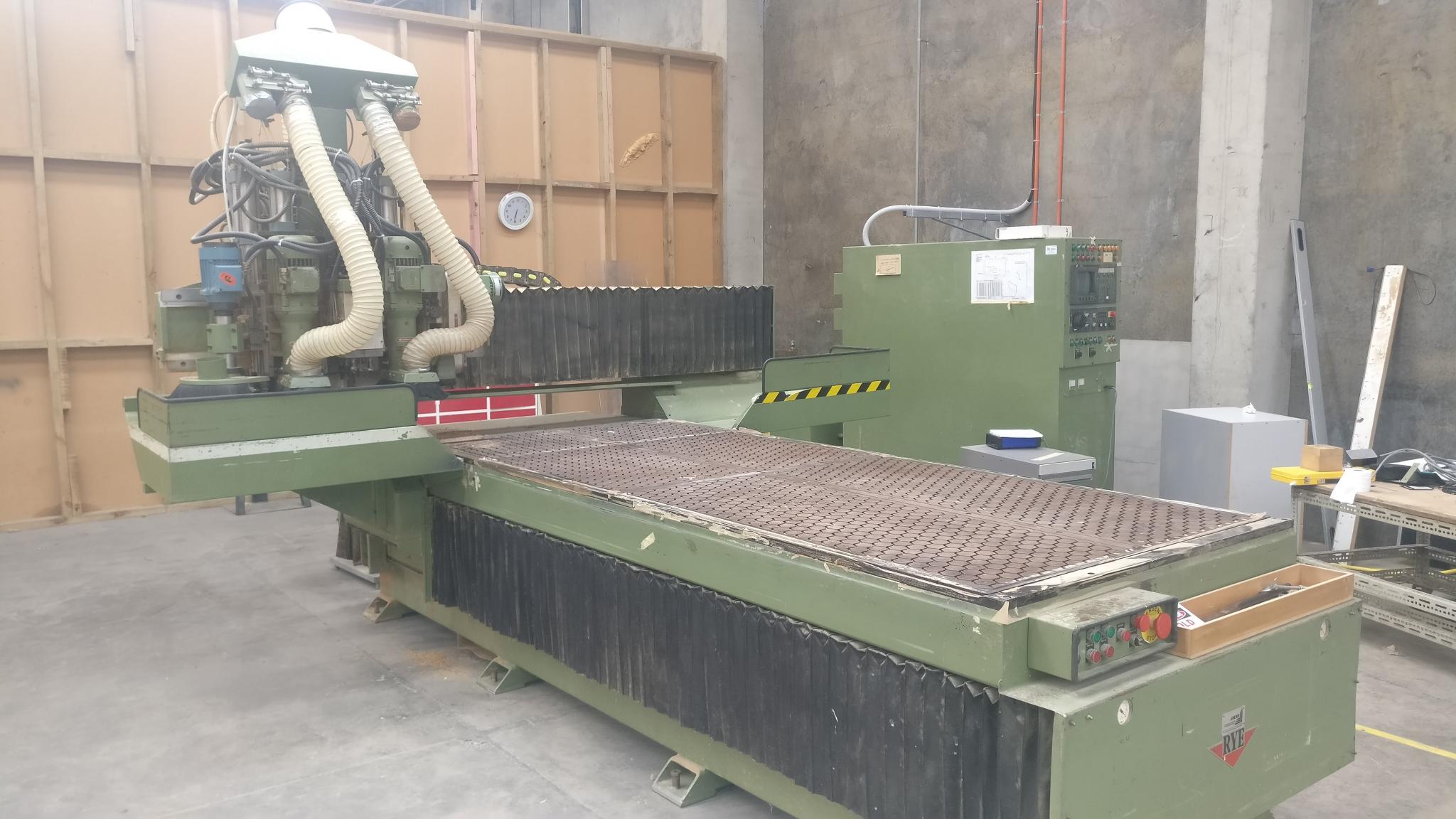

		Hey Welcome to the Rye club from New Zealand!
Here is my Rye MG3000 which we acquired about a year ago. I am currently doing a full rebuild and retrofit of the control systems, moving to a DSPMC/IP, keeping the original Servo amplifiers and Tachometers in place. There is a lot of work in it!
Hope all goes well with your machine they are quite rare!

		Here I’m with some updates;
all new electronics and motors;
looking at the coupling
Attachment 26667

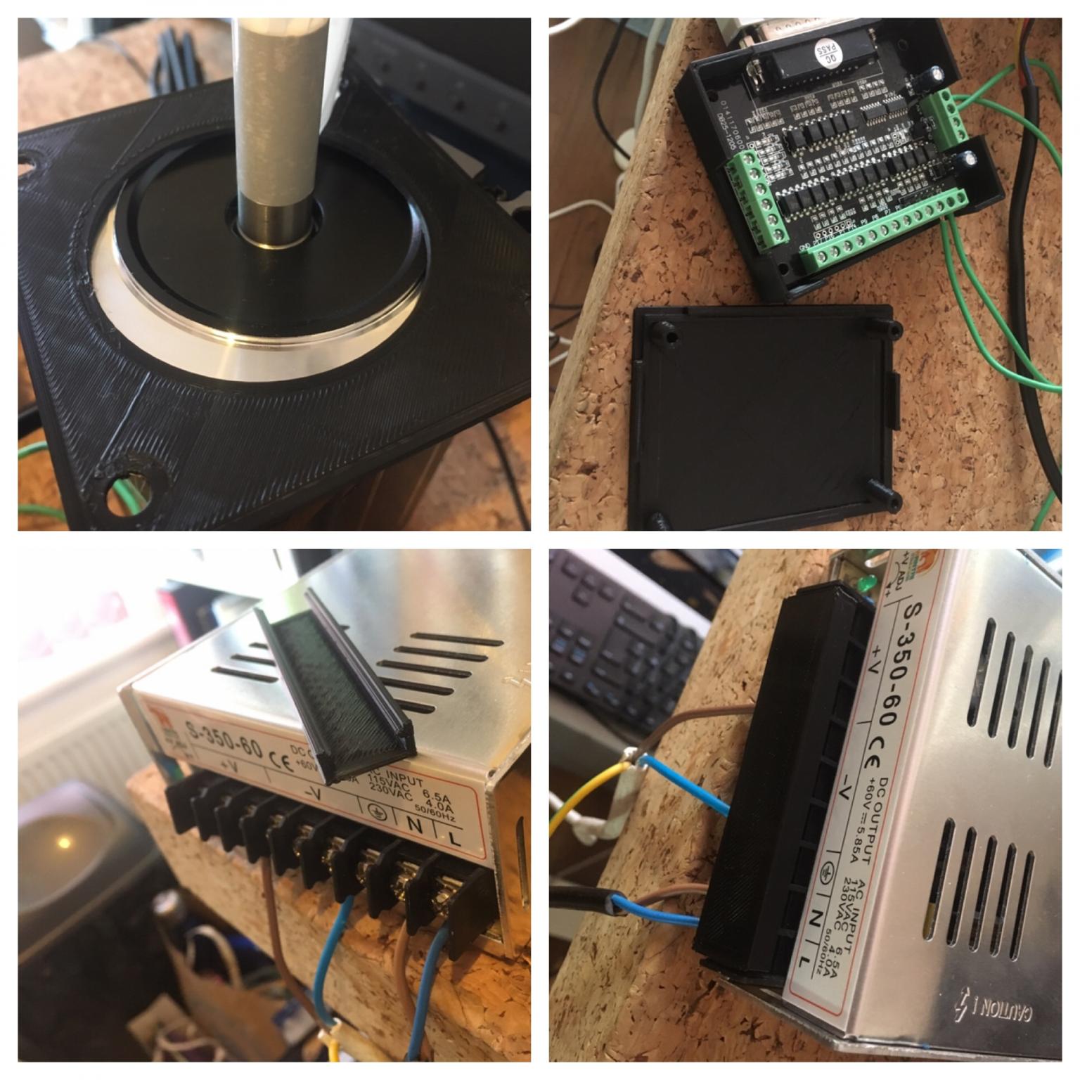

		Today I worked on some stuff mainly for safety;
- plaque to allow the motor to sit perfectly flush on the Cnc frame (there is a 2mm step on the moto housing)
- cover for the power supply, so that the risk of touching the 220v cable is lower;
- case for the BOB (not my design)
I’ve also made a mask so that the new motors will be perfectly centered respect the old motors.
Attachment 26670

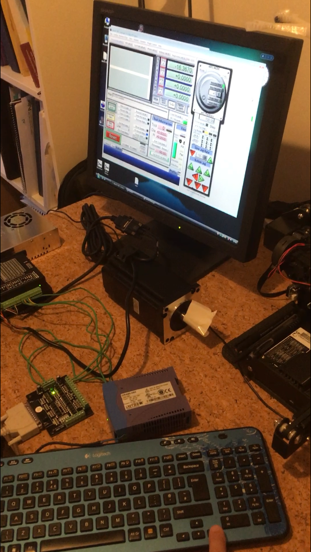

		More things done, soon other updates
		machine perfectly running thanks to a colleague

 These bring back fond memories i operated these machines for some years.
