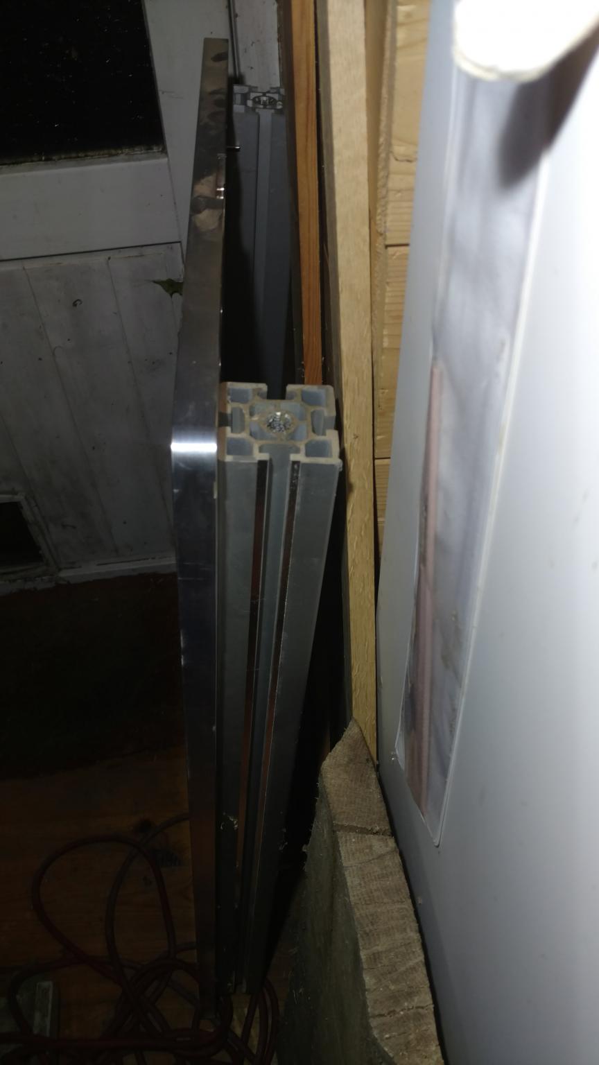

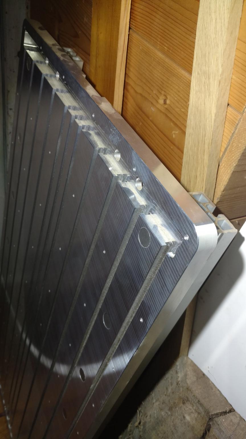

2 Attachment(s)
Re: Using granite blocks for a supporting base for a cnc router ?
Hi All
I think i'll give up the idea of tie rods and just epoxy or cement the two blocks into a steel welded frame. Does anyone have any ideas as to fixing the base onto the granite. I figured just drilling some holes through the granite and connecting them with bolts and t-nuts into the ali extrusion. I've attached a couple of photos of the base plate. It's machined flat the base is 20mm thick and the ali extrusion is 60mm square. All comments gratefully acceptedAttachment 26686Attachment 26687
I believe there must be a mechanical connection between frame and granite. Not just glue or epoxy as for me it will defeat the purpose. Best would be to be clamped somehow to bottom of the frame. But if clamped comes the danger for breaking so a thin layer of polymeric glue will help. Which again makes me doubt the whole purpose.of the operation.
Anyway, for that exact machine polymeric glue will suffice. The kind of glue that fixes metal to metal or metal to stone. It must be sticky like sh_t, not the ones that look like silicone at the hardware store that say xxkg of force, blah blah. I dont know in Uk but in Spain you find that at a place where constructors buy their stuff. Cheaper and much better than epoxy for the purpose.
