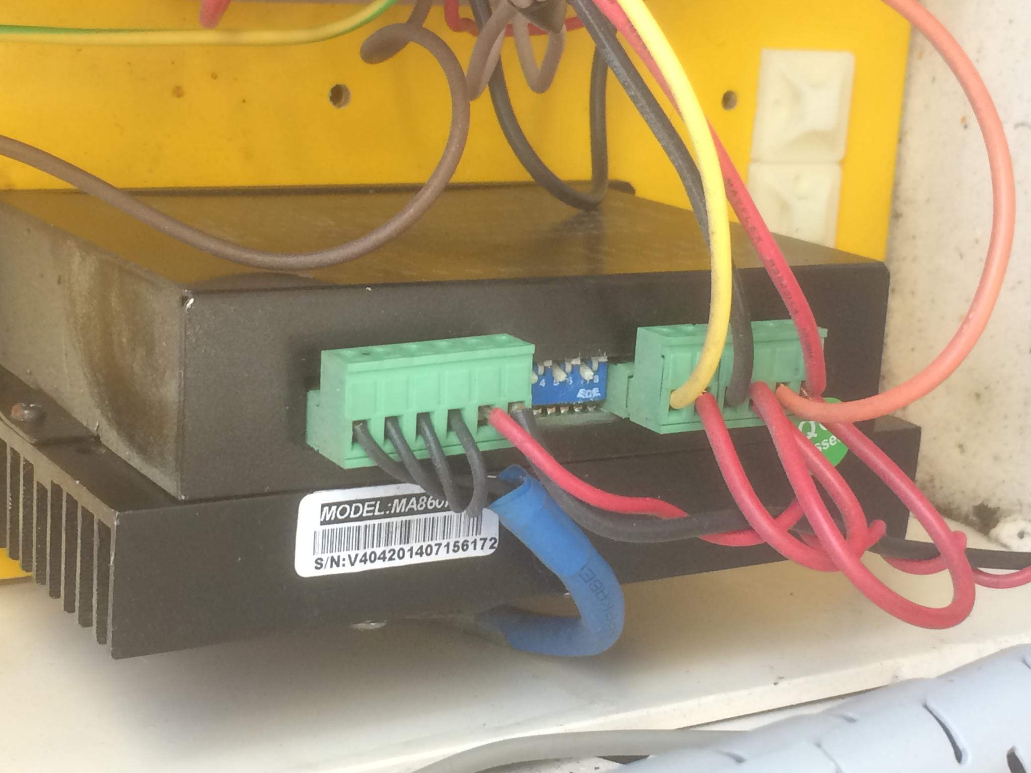

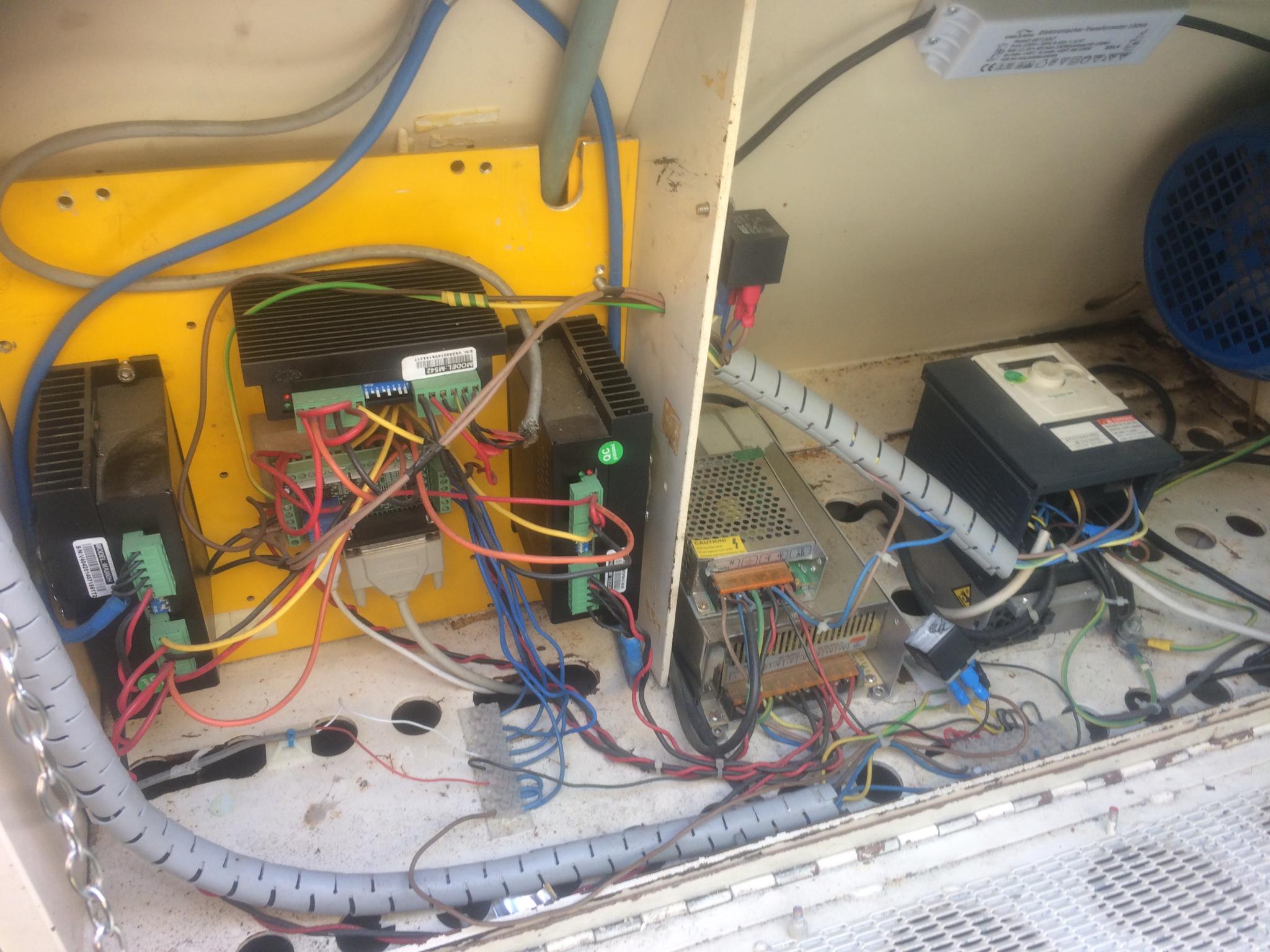

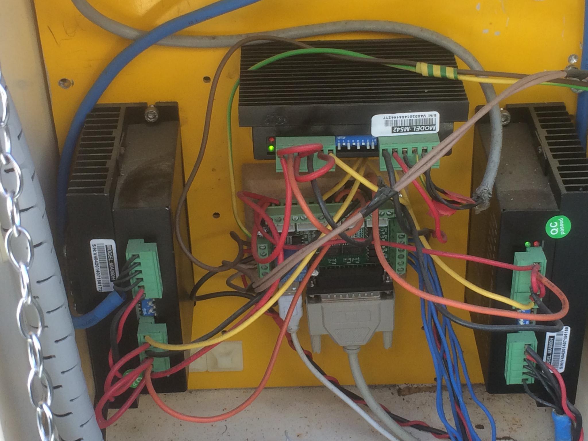

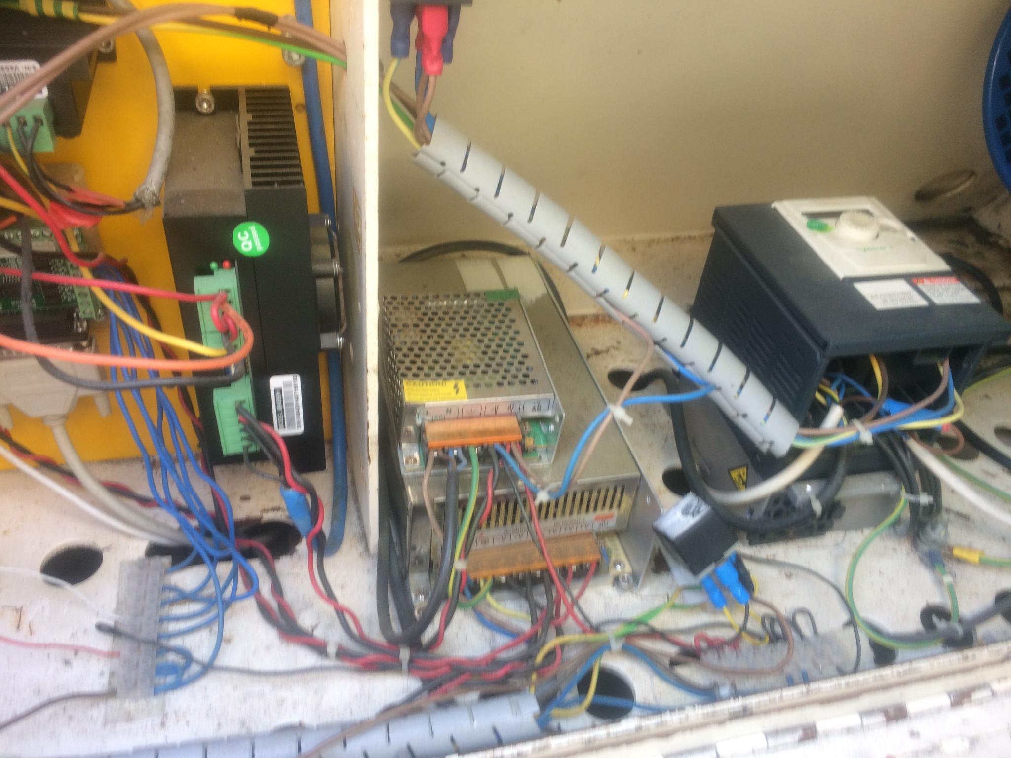

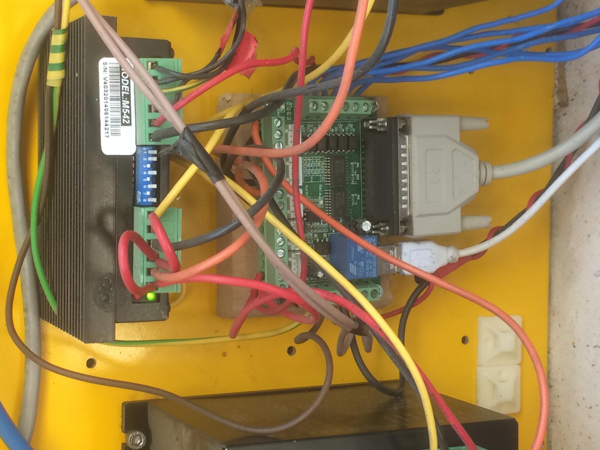

		6 Attachment(s) Re: mach3 wont reset keeps saying external emg stop requested
		now the weather is find and we are in lockdown i have moved all the crap and taken back wall of the shed out to get to the electrics please see pictures cant see any fuses and two relays
 Attachment 27675
 Attachment 27674
 Attachment 27676
 Attachment 27677
 Attachment 27678
 Attachment 27679
 two of the black boxes have leds showing green the other box does not have leds on it

		1 Attachment(s) Re: mach3 wont reset keeps saying external emg stop requested
		Ok regards the PS controller that's about what I expected because it's just software driven and your problem is hardwired. So, unfortunately, you are going to have to do a bit of detective work and start tracing wires.
 Now because the Home SW doesn't work and Spindle won't start I'm thinking your problem could be the BOB(breakout board) and it's I/O (input/outputs).
 Looking at the pictures I'm pretty sure this breakout board needs a separate voltage source for the I/O to work. The pictures also show 2 PSU, the smaller one will be the low voltage for this and the relays, etc, the large one for the drives. So first check you are getting power out of the smaller PSU, it's probably 12 or 24Vdc.
 and that it's getting to the breakout board.
 To be honest I'm quite confident your problem lies here with the voltage to the I/O but if you are getting voltage to the BOB then I'd 99% say your BOB is dead. But it's always worth tracing wires for damage or loose connections.
 After this I can't be much more help without being infront of the machine.
 EDIT: The two middle connectors on this block is were you need to test for voltage. 3rd from end near USB is Gnd and 4th is Vcc.

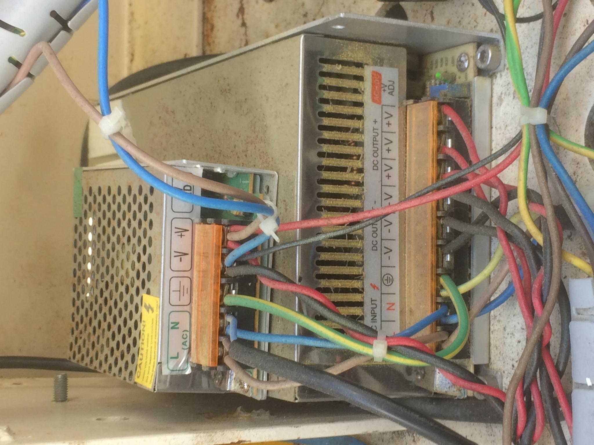

				Originally Posted by  Geoff57
hi Jazz
 is the BOB, in my second picture the board in the middle i noticed today there is a red led lit up
 sorry but what is PSU i have a multimeter so i can  check voltages
 Geoff
 Yes Geoff, PSU = power supply unit. It will be the small one in this picture and test the V++ V-- highlighted in pic. The PSU will probably have sticker telling you the voltage Output. 12 or 24Vdc
 Attachment 27681
 Edit: Opp's didn't see Clive beat me to it, same as what he said...Lol

 on the two psu s there  is a  green led on the larger unit it is lit up on the smaller unit it is not, does this mean the unit is dead ?
 thanks Geoff
morning all
 thanks Geoff
 Geoff.  Do you have a DVM ? a meter to test the voltage AC and DC .  If so can you check what voltage you are getting from each PSU  on the DC terminals.
 The smaller PSU should be putting out about 12-24V if it is not doing so then you need to check if it is getting 230V AC on the input.  There may be a loose connection or a fuse blown.

 Ok, then you have found the source of your problem. If the small PSU as a fuse checks this, also check wires are not loose(do this with power off). If not fuse or wires then it's dead.
 To replace you will need to find what power output it was giving you. The BOB will take between 12-24Vdc but it could also have been powering things like relays so it's important to know the output and replace with the same size. Looking at the relays in the box I'd guess it's 12Vdc because they look like Automotive relays which will be 12Vdc.

		ok i have 240v going in but nothing on the output so it looks like the unit is dead goes with the led not lighting up      out of interest what normal goes on these psu
 once again many thanks for your help Geoff
