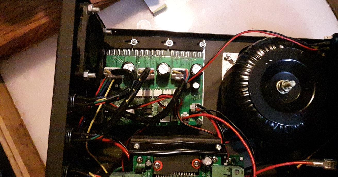

Photos. Lots of photos.
Trace where the spindle plugs into - either a PCB or a large box - photo. Trace where the motors for the XYZ drives plug into (not just the enclosure, but inside the enclosure where they run to a PCB) - photo. Trace where the computer plugs into the control box - photo.

We need actual photos you've taken of the wiring and electronics on your machine. Everyone's setup is unique, so to figure out what settings you need we need to trace each wire and see where it connects to. A stock photo doesn't help with that!

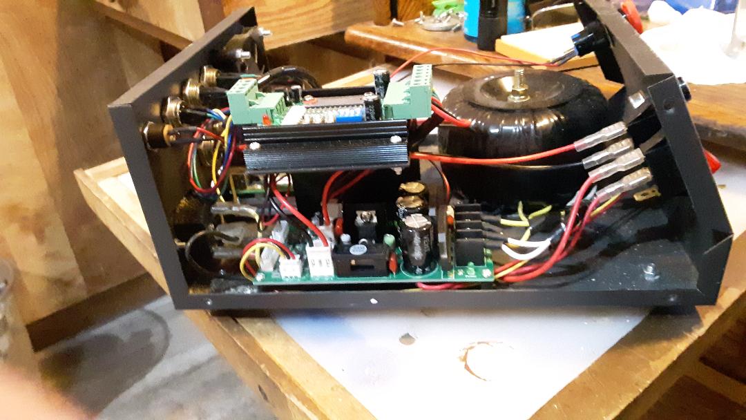

Sorry for your frustration. Keep in mind that I am not a techie. I'm just an old machinist who is retired, and wants to learn something new to keep myself busy. I took off the black box lid and this is what I got. Hope it helps.Attachment 27101Attachment 27104Attachment 27102Attachment 27105Attachment 27105Attachment 27106Attachment 27106Attachment 27107Attachment 27108Attachment 27109Attachment 27110Attachment 27111
Re: Trying to get this thing to work

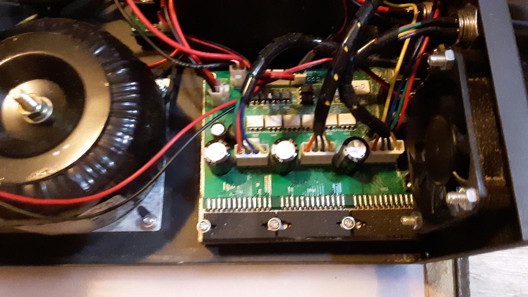

2-pin spindle connection on the back goes to a JST on the PCB located low down, between the fan and the toroidal. That PCB also has the parallel port and USB port on it, so I'd suggest its just a case of identifying that PCB and finding a manual to determine the pins.

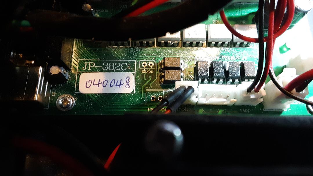

GeneO, can you see any markings on the board in the middle of your first photo? The one that sits right behind the fan. I'm looking for a model name, number, manufacturer. Something like that. There seems to be some writing above the handwritten label on it, but its hard to make out from the photos.
Looks to me like a low power DC spindle, so the exact RPM is going to be a bit subjective.

On the pcb behind the fan there is a number it is JP-382C . Also there is a hand written number that is 040048 (see pic)

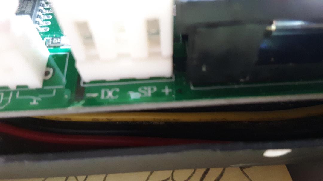

the wires that go to the spindle plug has a -DC SP+ (see pic) Can you tell me what voltage the spindle motor is? It has no labels on anything. Hope this helps. Attachment 27115Attachment 27116

The JP382C is the CNC control board. The two boards stacked together are the 4th axis and Spindle board. Top one JP1635A is 4th axis the lower JP1482 is the Spindle/Power board.
This board rectifies the AC power from the transformer for the drives, The fans, and the Spindle. As well as doing the PWM for the spindle and from what I can tell the Spindle is 54Vdc. The Drives are 27Vdc, which fits with the TB based drive Chips. Here is a link to schematic for the Spindle board.
