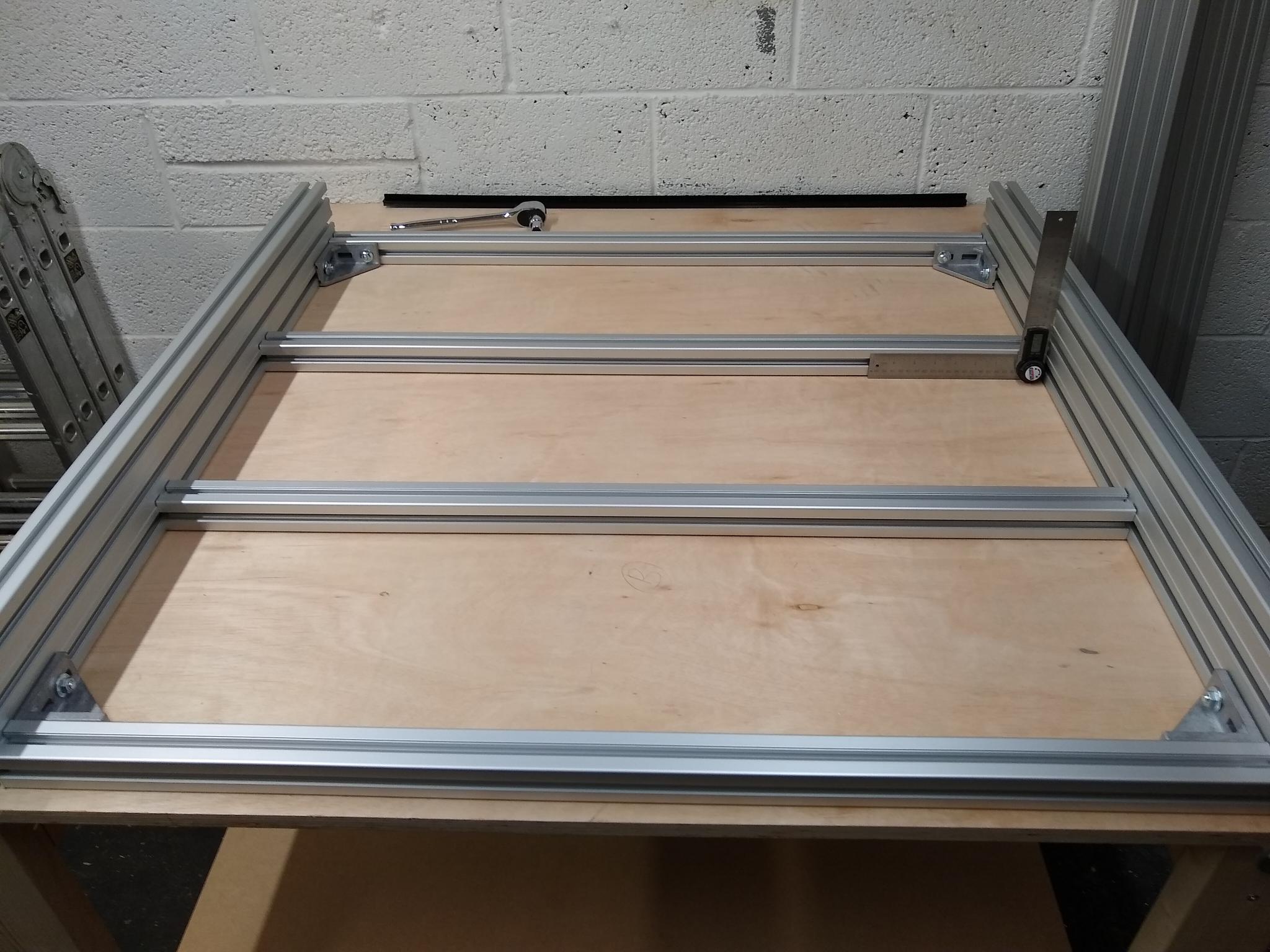

 First post on this forum and CNC in general. There seems to be a huge amount of knowledge on this forum, and I feel very out of my depth but learnt a lot lurking here for the past couple of weeks, from a base of zero !
 Not sure if I should be creating my own build log as its just a couple questions for now.
 So I'm looking at building a CNC router for perhaps 75% soft/hard wood, 25% aluminium use. I mainly work with wood on a hobby level.
 I don't have any CAD drawings etc yet, all just paper! sketches but the plan is in the style of the 3d tek heavy mill with some inspiration from here.
 wasteboard size 1080 x 1000mm
 Here are the parts I'm planning to use this far;
 Hiwin 20mm Linear Rails/ HGW20CA Carriages @ 900mm (for X & Y Axes)
 2005 Ball Screws @ 900mm for X and Y ( 2 on Y axis rails)
 BF15/BK15 Mounts
 1605 Ball Screw for Z Axis
 Z Axis TBC, but likely SC16LUU type bearings
 4 x Nema 23 4NM stepper motors
 Purchased so far: Aluminium Profile
 2 pieces of 40 x 120 @ 1000mm (Y axis)
 4 pieces of 40 x 40 @ 1000mm (X axis supports)
 1 pieces 80 x 80 @ 1200mm for X Gantry (will rest on aluminium plate on linear rails)
 Parts which I need some assistance with (so far...)

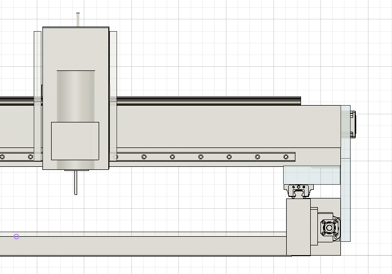

 I'll be trying to draw this in a shareable format soon. But design steps wise, can I design/build the X/Y axis and gantry to a good standard, then consider the Z axis as the next "module" or is that a bad idea!
 If I know the motors to be used, I can pretty much leave electronics until the build progresses, and certainly won't buy anything related to that yet.
 Will my existing 120 x 40 profile with 40x40 cross pieces suffice for X/Y axis with extra bracing?
 And with the L design for gantry - just thinking how I can incorporate the 90x90 profile, perhaps a 60x60 attached to it at the back?
 Yes you can but I wouldn't recommended it because your better designing the whole thing in CAD to see if anything clashes.

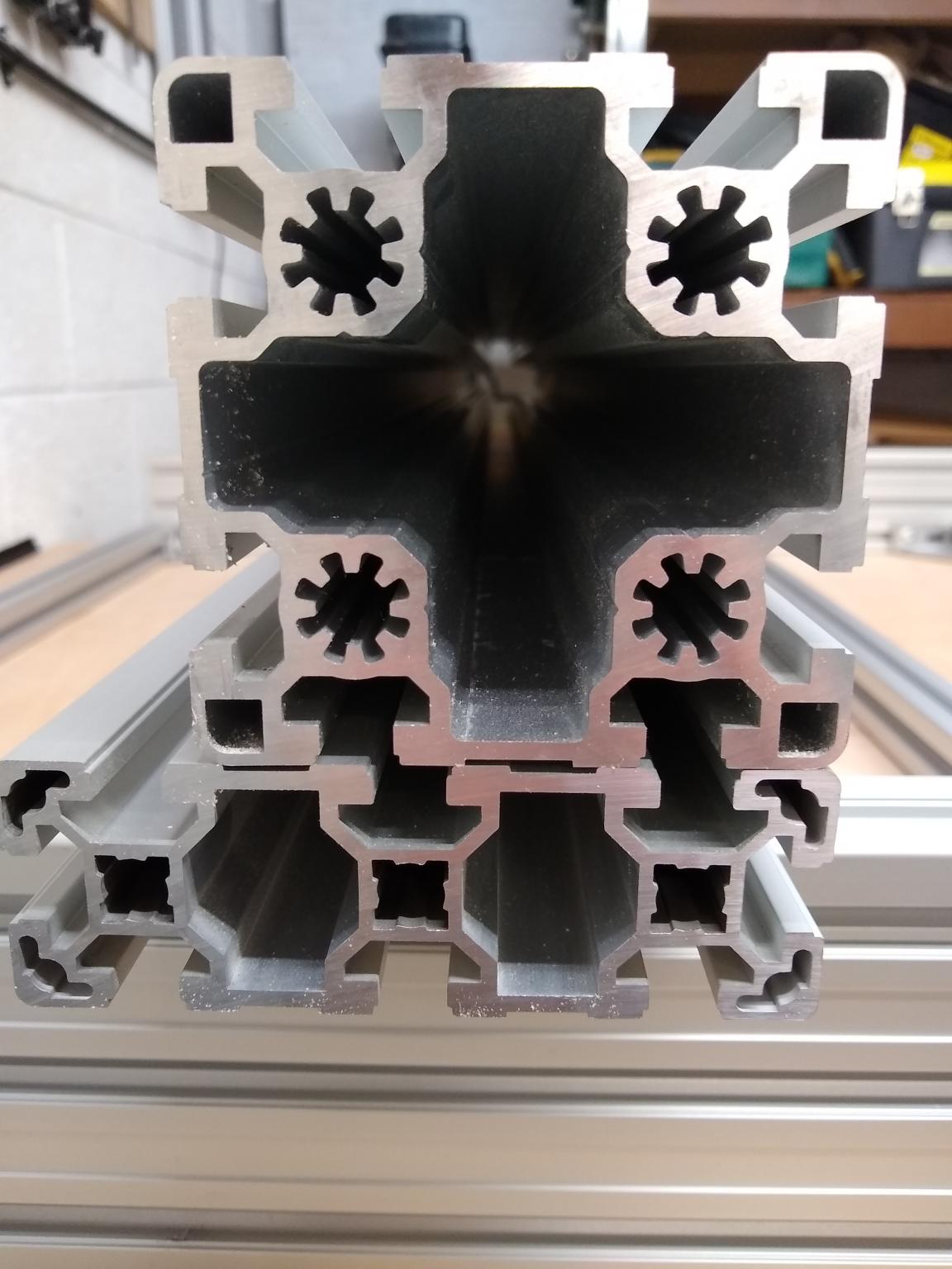

 Yes, the 120x40 and 40x40 could be used for the frame with bracing.
 Regards the Gantry then Bolting 60x60 onto the back won't do anything other than add weight. To get the stiffness and height you need one piece flat with the other bolted on top. So either buy a wider piece for the bottom and put the 90x90 on top or start again with 2 x 45 x 90.
 I'm assuming that your using BR range profile because of the 90mm. This is good because when using 16mm screws then the BK End bearings mounting holes will line up with the 45mm slot spacing. If you used the IR with 40mm slot spacing then you would have to make plates or drill the profiles to bolt the bearings on.
 It's these little things that catch you out and cause more work. Hence why drawing in CAD can save many wasted days and money.
		2 Attachment(s) Re: Aluminium Profile Type Router - Initial questions
				Originally Posted by  JAZZCNC
Yes, this is the L design I was suggesting, most of the L designs you'll see are based off my original design or someone else's who took from mine, it can be used both with or without Gantry sides and makes for a very stiff gantry with easy rail mounting etc. When mounting directly to the bearings just bear in mind access to the bearings bolts when deciding the bearing plate length. I've seen several designs that missed this little detail, which is why it's a good idea to draw it in cad to catch these things.
 No closed loop steppers have an encoder on the back which goes to the matching drives. Also often closed loop steppers are 3 phase steppers with smaller step angle of 0.9 or 1.2 deg whereas typical stepper is 2 phase. with 1,8deg step. The difference being closed-loop are smoother.
 All you really need to know is the motor frame size ie: NEMA 23 or 34. Now I've seen you mention Nema 34 is what you need.! This would be bad for a machine this size and mistake often made by new builders are thinking bigger is better, it's not.!
 NEMA 34 motors require a much higher voltage to get the RPM needed for a router. A 4Nm NEMA 23 will perform much better than a 4Nm Nema 34 at the same voltage.

		OK so I've figured out enough of Fusion 360 to model something - not going to win any awards but at least it's clearer and I can edit the design as needed.
 Attachment 27376
 Attachment 27377
 Attachment 27378
 Attachment 27379
 Attachment 27380
 The blocks on top of the X carriages are set to 40mm thick currently
 All rails are 1000mm , to be adjusted if needed
 Aluminium profile on gantry is 120 x 40 with 90x90 on top.
 The purpose of the ballscrew and ballnut running inside gantry plate is to allow an L angle (or perhaps long brush) to be fixed to the extrusion above the screw and cover the ballscrew from dust/chips
 Issues I'm thinking of so far is the the Z axis clearance isn't huge,  125mm from top of baseboard to bottom of gantry, although probably OK for my needs.
 The Z design with rail on front and top is based on the fact Z clearance would be even lower if I put rails on top/bottom of profile. I plan to add extra C shaped plates to side of Z axis to strengthen - will it be enough/OK design?
 Y axis travel is limited by how far forward Z is - losing about 275mm so probably need to bring the carriages closer together and gantry plates narrower, maybe mount motor to back of gantry extrusion instead with pulley.
 Any comments on those bits? thanks

		3 Attachment(s) Re: Aluminium Profile Type Router - Initial questions
		Hi All,
 I've spent some more time on the design - moved the dual X motors to the back, and added a pulley based drive to the Y axis (borrowed from Andy's build log!)
 Also shortened the plate fixing gantry to Y rails to give more Y cutting area. I expect I'll get 750mm out of the 1000mm total Y length.
 Attachment 27423
 Attachment 27424
 Attachment 27425
 For my Z axis, I'm planning to make this 350mm tall with 350mm rails and 265mm ballscrew.
 I think I'm ready for a quote on linear components - would appreciate if someone could take a quick look and advise if there are any glaring issues?
		On the model, you show BOTH ends of the ball screws using BK bearings which are the fixed end bearings, which is the best way to fasten, BUT it's not the standard way. Usually, you have a fixed end BK bearing and a floating end BF bearing, so if you want BK on both ends you will need to tell Fred at BST otherwise they will machine them to standard.
 Also mention you want the "F" Dimension which is the coupler portion at 25mm otherwise they will machine it 15mm.
 Tell Fred you want the best BK/BF bearings not the cheap ones.
 I stole it from Joe, who I'm sure stole it from someone else. I'm reliably told it's called development!
 Great progress Ryan, it's coming along.
 Jazz's comments are spot on, and also your BK nearest the motor is back to front. Mention to Fred that your dimensions are for the screw part not total length else you'll end up short!
 I'd recommend an F length of 30mm on Y and Z to give more room for those pulleys. Don't know if Jazz was saying 25 for the X couplings or the pulleys? Either way just gives more room to align that pulley.
 I've noticed your gantry vertical plates are wider than the distance between carriages - the angle continues further than the carriage. Might be worth trimming that because it's essentially cosmetic in its current form and will be costing you when you order the plate.

 Thanks Jazz - the BK bearings in the image were more just to guide placement and I'd just been copying the same object in fusion 360 rather then using the BF, but I do intend to do it the standard way.
 OK - will request a bearing upgrade too. As mentioned in another thread, no idea if BST are shipping out at the moment, so will check on that. Just being impatient to start building something:)
 Does the design overall look OK? It's heavily copied of course with a few tweaks!

 Thanks Andy - feels like the design is almost there now, drawing in CAD certainly makes things easier to tweak/measure and figure out what should work.
 Yes good shout on the gantry - I've reduced the width slightly (50mm approx) so it can be cut from a smaller piece of aluminium.

		So the build has officially started - I should probably convert this to a Build log if that's possible!
 Attachment 27460
 So the profile was joined using the self tapping M12 core screws, where the head slots into the 10mm profile slots and a hole is drilled though the profile to allow the T50 key to be inserted and tightened. This worked OK but I managed to almost break my wrist using a cordless drill and even a (cheap) impact driver struggled! Got there in the end and re-enforced with brackets.
 I don't have any precision measuring tools at this point, but using the digital angle measure is 90.0 degrees on all angles and to 1mm across all dimensions.
 Issue #1 - In my haste to add an extra piece of profile to my order (to have an L shaped gantry profile) the 2 profiles have different slot spacing. As far as I can tell the main issue is joining them. If these are joined simply by using the side gantry plates and socket head bolts to hold the pieces in contact is that a terrible idea? Could it be enhanced with some strong adhesive between the pieces to compensate. Really wan't to avoid wasting money on the extrusion if I can help it.. Any ideas?
 Attachment 27461
 I've also placed the order with BST Automation - Thanks for the recommendations. All smooth so far, Fred seems very responsive and helpful. There are expected delays due to the coronavirus but it sounds like production is just slightly slower then usual.
 Only linear motion components so far - 1610 ballscrews and 1605 for Z. 20mm Linear rails and Carriages. Flanged Type for X axis for stability as I'm using a wide plate.
 For the blocks which will mount to carriages - Is Ecocast type aluminium recommended here? Quite pricey for 50mm thick block so want to be sure it's worth using this.
 Also thinking of what you mentioned Jazz - adjustability. Would slightly oversize holes be the usual way to achieve this?
 On electronics - I'm considering Hybrid steppers now, certainly on X due to the dual X motors and potential stalling. Any recommendations on models here?
 Thanks!
 Is the bottom section a different Series? They both should be the same...ie Series 45( 45 mm between slots )?
 Hi Stereob - yes correct, it's a different series. I hadn't realized until too late:( Hence seeing what I can do as a workaround..
 It's not the best of ways but if you bolt the profiles together along there length as well as the ends it should be ok. Obviously, because the slots don't line up you won't be able to use the slots to lock together but you should be able to drill and tap them together from underneath with a few bolts.
 Don't use adhesive.!!

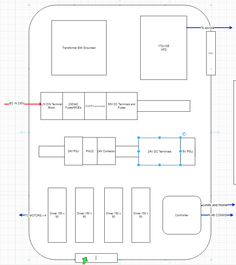

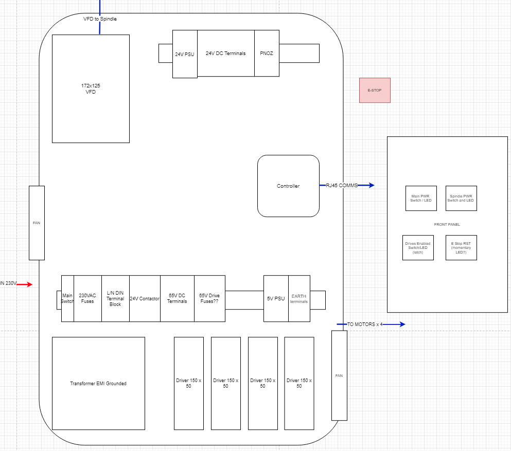

		700 x 500 x 250mm steel cabinet arrived today from TLC. Very solid and heavy @ 20kg.  - hopefully everything will fit in based on previous builds on here! I see Andy had 800x600 which had a little space spare.
 While I wait on the linear motion parts from BST - electronics are being planned, really steep learning curve here for me and hoping I can figure it all out with some of your help.
 With the LCDA86 driver Jazz recommended, what voltage would be ideal. Its up to 100Vdc and I see a few people have used 68V - so would give some margin but would that be at expense of too much power?
 LC60H2112 is listed as 5.6A current, so with 4 motors do I need 22.4A x 68V = 1523VA PSU? Sounds huge.

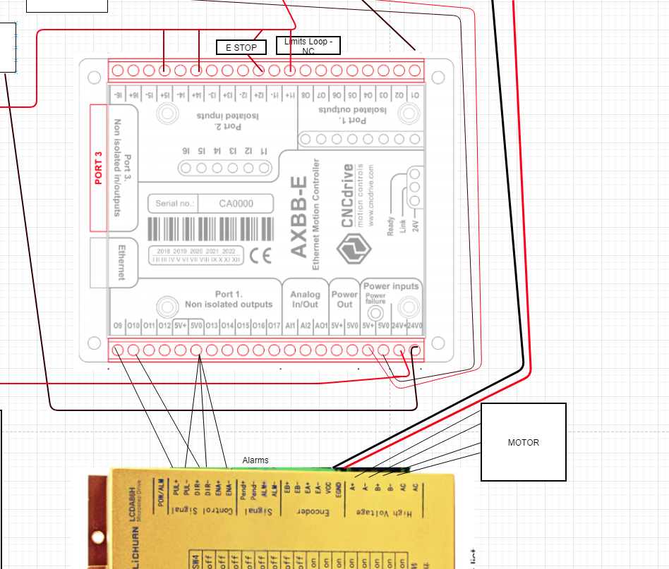

 I'm trying to take each component in turn and map out the connections - first the driver to AXXB-E. Except for ALM I can't figure out which other terminals need to be connected if at all ? For example ENA+, Pend, and the Encoder E* ones.
 AXXB manual refers to just Step and Dir.
 Attachment 27524
 Edit..Just realised VCC/GND wrong colours on that IMG..
 Good plan. Generally speakings, Step and Dir are the two required ones.
 Enable turns the drive output on or off to prevent the motor turning without killing power to the drive, usually when left disconnected the motor is just enabled by default.
 Alarm should output a fault signal to the AXXB if something goes wrong. Best to have it connected somehow if you can, but there are a lot of options about exactly how you wire it up. E.g. it could estop the system on fault, or just tell the AXXB to pause.
 Pend appears to be 'positioning completion signal', encoder and the motor phases should be the wires from your motor.
 Start simple, if your not used to wiring things like this don't try and wire it all in one go it will just blow your mind. Start with basics first and do it in stages.
 I would start by setting up the main latching E-stop circuit and getting movement just with Step & Dir. Forget, enables and alarms at first they can be added later.
 Next wire in Home/limit switches. This then gives you the basics or a working machine.
 Now you can start adding other features like Alarms, enables etc and controlling any external devices using outputs etc like spindle control.
 My favourite saying is "Treat it like eating an elephant, one bite at a time."
 Edit: With the cabinet don't stress out over this either, concentrate on layout and wire routing , the main thing is to keep low voltage signal wires away from higher voltage wires as much as possible and make sure you use Star grounding. If your using a VFD and thinking to put in cabinet just pay close attention to where the main spindle cable goes, I'd also suggest you don't put it near the main controller.

 I have this for the cabinet layout - does it look OK or any issues?
 Three things spring to mind:
 -  VFD Spacing against internal walls. Read the manual for how far it should be away to allow adequate air flow.
-  I'd keep earth near Line and Neutral, thats where it comes in after all, and a lot of the big ticket earthing items will be mains voltage.
-  You've made a good start trying to separate voltage levels, but the 5V PSU should be at the low voltage end of the cabinet rather than its current position near 65V DC.
-  Think about air flow through the cabinet - At the moment your drivers will get decent flow, but the VFD won't. What direction are those fans? I orientated my drivers to allow maximal air flow through their heatsinks, at the moment your heat sinks are at 90 degrees to the air flow.
 Will it work in its current state? Sure. None of these things are big issues, just minor points.
 Attachment 27535
 You need to think about how the wires run and trunking. how you have it there would be awkward for running wires etc.
 I would move the drives away from the Transformer and bring the DC PSU and MCB's etc down near the Transformer so all together in one area. If you have room even bring the VFD into the same area, this way all the high voltage stuff is together.
 I would have the drives and controller close together to keep Signal wire runs short as possible. Separate the high power stuff from the Low voltage stuff by placing high and low in the case with Terminal blocks and Relays etc along with trunking between them, essentially dividing the case into 3 areas.
 This doesn't matter if it's separated horizontally or vertically, for instance, I often run the drives along the sides of the case vertically as it's easier to wire them. On the opposite side, I will place VFD at the top and PSU, etc below. In the middle will be Terminals and Controller.
 Also, I would think about having 2 fans in the case to create a positive pressure in the case to push hot air out.
 Edit: Noticed that you have a Pilz relay shown, you don't actually need a safety relay. A normal Relay will work just as well and save you a lot of money.
 Lastly, looking at your drawing the scale looks wrong on the parts shown so be very careful when planning out the box because it's SO EASY to run out of room. Often the case will look massive when empty but it quickly fills up. Also if you haven't got the box to measure from then allow a little extra because things like hinges or Earth clamps etc can rob precious space and easily screw up layout plans.
 Also if not got a case and solely planning layout in Cad or on paper then I'd try to get exact dimensions of any components because again can soon run out of space and no matter what you do or how you twist things around it just won't fit.!
		1 Attachment(s) Re: Aluminium Profile Type Router - Initial questions
		Attachment 27555
 Attempt number 2 - tried to separate Low/High voltage more and incorporate some other suggestions. Airflow intake at the bottom and out at the top, by VFD fan.
 I checked the scale and believe its correct - cabinet is 700mm x 500mm . Although the DIN rail items are NOT to scale yet, the DIN rail is. I'll take some photos when parts physically arrive..
 I think the conclusion is that fuses are v unlikely to be a negative addition, and probably positive, I'll add these between transformer output and Drivers AC input - probably 5/6A.
 I did buy a PNOZ already as I made an ebay offer on one new much below "retail" price and got unexpectedly got accepted.
