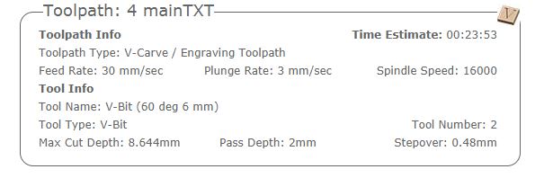

2 Attachment(s)
Re: Which machine for headstones - please help.
PCD on Granite ramp in slow as cutter is very brittle.
Attachment 27363
On stone you can increase the feeds depending on detail needed.
Attachment 27364
