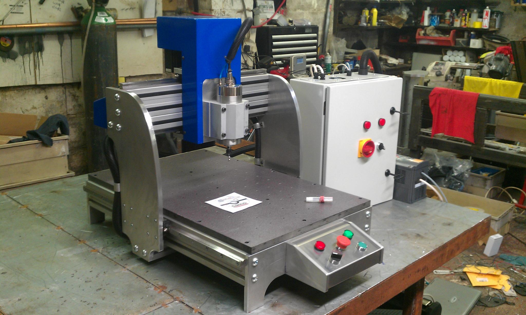

Here's a 6040 sized machine and it easily cuts everything up to Aluminium. I've built several machines this size which cut everything from MDF to Carbon fibre parts for RC cars and Clocks which require fine tolerences so don't worry about it being upto the job.
The best profile to use is 45 x 90 because it makes things easier with mounting ball-screws. However, 40 x 80 will work on smaller machine but you'll just need to make plates to mount BK/BF bearings on for ball-screws.

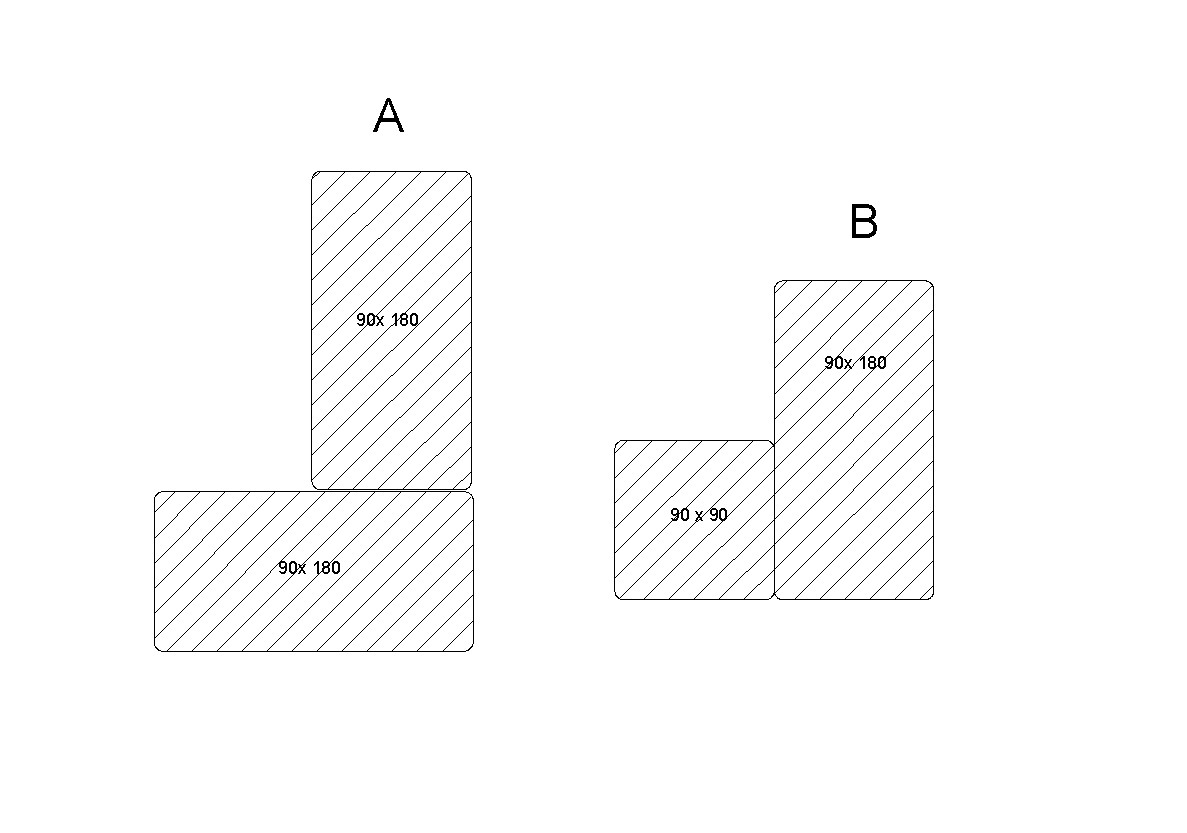

In the mean time, it seems that some supplies do not offer an intemediate size, ie 90 x 135mm.
This means I have to use a different sizes for the Gantry.
I was wondering if there is a difference in the stiffness of a Gantry between these 2 options?
Steve
Attachment 27489
Option B is my preference, if joining on the back is acceptable to do.
I'd have said option A will lead to a stiffer machine, simply because you've increased the mounting distance between your rails? What does the gantry deflection calculator tell you?
What size machine you building because 90 x180 profile arranged in L shape will make for a BIG gantry. To give an example I've just built a 10 x 5 machine with 2mtr wide gantry and it's only using 80 x 160.
Also, The point of the L shaped gantry is to have the bottom profile laid flat which is the stiffest direction for the cutting forces.
Its basically a 6040 sized bed but the frame will be larger so the tool will reach the whole bed area ( at this stage. )
Re: 90 x 180, yes I agree it will be huge. Most suppliers don't seem to offer anything between 90 x 90 and 90 x 180.
I have seen 90 x 135 ( and that is my preference ) but that seems uncommon.
