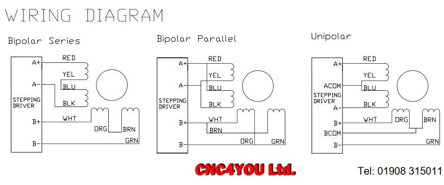

Wiring an 8 wire Nema to 4 core CY cable to an AM882
Hi I have a pair of 4nm Nema 23's I want to swap on my bottom axis of the router, 4 core CY cable to run off a pair of AM882.
Here's the wiring diagram
Attachment 27439
I want to wire for parallel, guessing 2 wires from the Nema connect to 1 wire in the CY cable but which ones lol?
Re: Wiring an 8 wire Nema to 4 core CY cable to an AM882
Could be any wire you want so long as you connect it to the right phase on the drive but here's what I would use.
Wire # 1 = A+ = Red+Blu
Wire #2 = A- = Yel + Blk
Wire #3 = B+ = Wht + Brn
Wire #4 = B- = Org + Grn

The middle one. bypolar parallel

Thanks Jazz, that worked perfectly luckily I twisted the pairs on these motors when I first fitted them so when I swapped the wiring it was super easy to work out the pairs. It worked first time and even both motors went the right way so bonus ;)
I went from being able to move the dual motor axis at 4m/min to over 15m/min without firing fault protect on the AM882's, 20m/min worked but that screw looked scary lol so I dialed it back.
25m/min and it fired fault protect had to try, 1610 ballscrews with cheap ass mounts but am going to buy a set of proper angular ones from BST.
