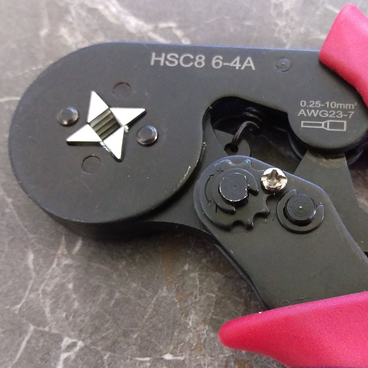

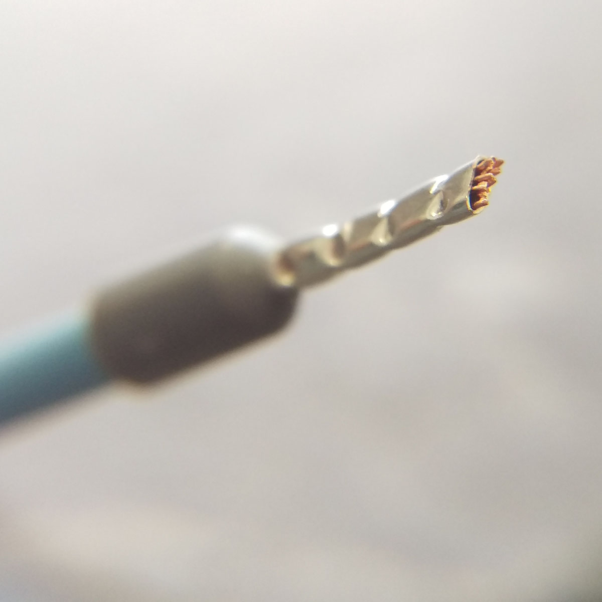

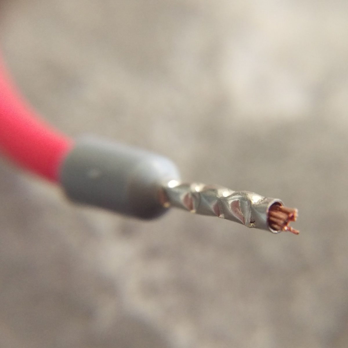

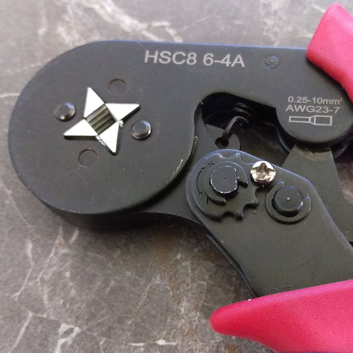

3 Attachment(s)
Re: Bootlace crimping tool recommendations
This may come back to bite me on the arse, but I've had no problems with my crimper (- that sounds weird...) Just spent a couple of minutes trying to pull a ferrule off and it's on solid as - not budging...
I have a little '+ & -' adjustment wheel on the crimper that appears to set the level of squeeze - if I'm doing thin wires I'll ramp it up (+) and dial it back for the fatter gauges. Pff, I dunno - like I say, it appears to work a treat, but I'm a noob with very little experience..!
Attachment 27576 Attachment 27577 Attachment 27578
Wal.

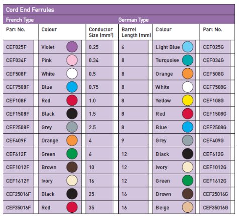

One issue I see far too often, is everybody likes to default to blue insulated crimps (they're designed for 1.5 - 2.5mm˛ cable), when they should be using red ones (for 0.5 - 1.5mm˛ cable), which means they don't crimp correctly and you end up with bad connections.
For the cat5 flex I use the white But not sure if there is any stardard
Attachment 27580
I think some confusion between the ferrule colour coding and the spade terminal ("automotive") crimps.
Both of you are right, but you're talking cross-purposes :)
