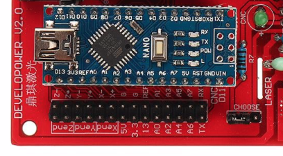

Please find attached a picture of my board. It says: Developower V2.0
ThanksAttachment 27575

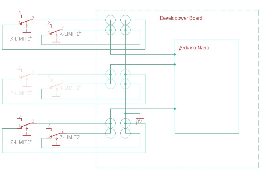

3 Attachment(s)
Re: Help with CNC 3018 from Banggood
EDIT: I've reread my post and realise that I've thrown a number of names into the equation: The "MEGA" or "AT-MEGA" or "ATMEGA328" is the micro-controller chip that sits on the "Nano" or "Arduino" - which is the small board about the size of two postage stamps. That board is the daughter board that sits on the larger "Developower" controller card. [END OF EDIT]
Cheers for the photo - that's confirmed pretty much what I've found on Banggood. I've tried to find a schematic of the board - there's a few people working on this but from what I've seen - if to be believed - it's pretty much confirmed my suspicion. I've yet to find a manual for the board but from what I can tell the 6x2 header for the limit switches presents the X/Y/Z axis inputs on two pins (total 6 for 3 axis) - presumably for up to two switches - one on each end of travel, and the other parallel pin header provides the ground "return" signal. The X/Y/Z input pairs are each commoned (shorted-together) for three separate signals that are passed to the micro controller - a generic Arduino Nano board.
The best I can work out is that the limit switches are wired something like this...
Attachment 27581
Now from what I can see physically on the board image, and from other people's attempt at schematics, I see no pull-up resistors on the board. The Arduino (the ATMEGA 328 microcontroller chip) can be configured to provide a weak-pullup that is required to set a logic "1" on the input - and then the limit switches, if active, pull that to ground (a logic "0"). That's the principle of operation. And, in a low-noise environment that works.
As soon as you get any induced electrical noise on the limit input, if the input resistance is very high (as it is with the internal pull-up resistors on the ATMEGA) then the signal will be superimposed on the silly-low current signal on the input with the result that a voltage of only a few volts will swamp the behaviour of the internal pull-up and present a false reading to the ATMEGA. Signals above and below the supply voltage of the MEGA would be clamped through internal protection diodes to the supply lines - so these are unlikely to damage the device, but you are still able to get spurious readings.

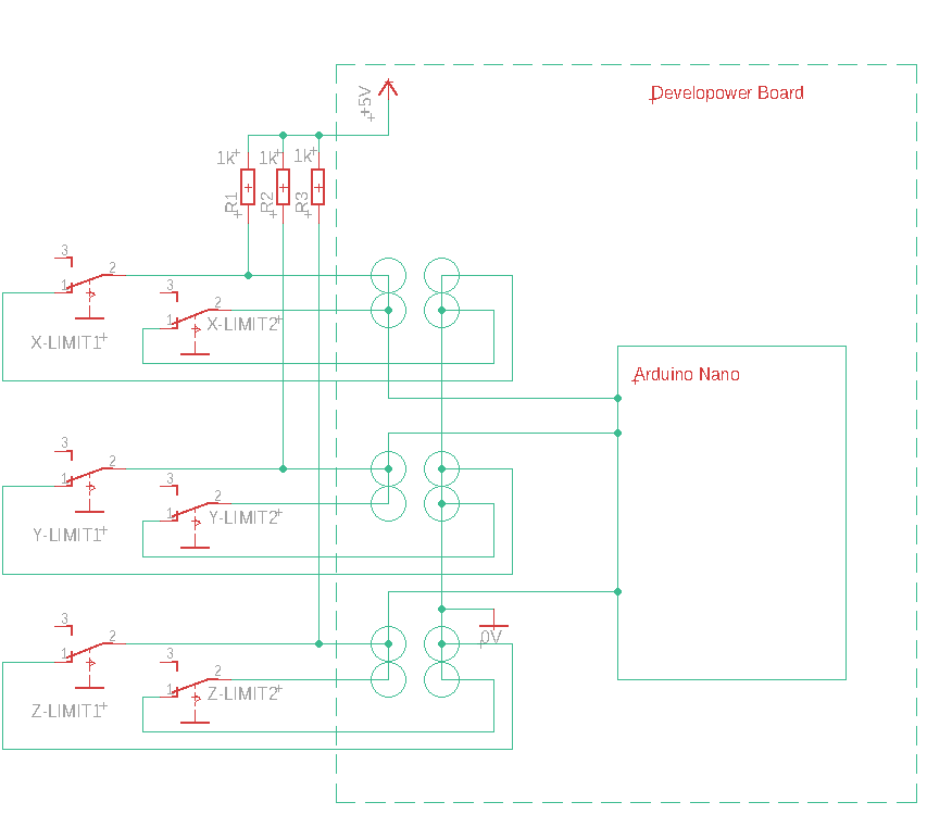

So, my recommendation - and this is a bit of an experiment but it makes sense to me at least - is to reduce the pull-up resistance, which has the impact of, in the case of induced noise, providing a much lower resistance to the power-supply, which is a convenient low-resistance path to ground (at least for the AC-analysis). This means in practical terms you can dissipate a lot of the induced noise into the PSU and not into the input pin of the MEGA.
But, we cannot change the internal pull-up resistor - that's internal to the MEGA, but we can add a resistor in parallel - and the effect is the same. So, what I suggest is adding three resistors, one to each of the axis inputs, pulled up to the MEGA's 5V supply line. Something like this...
Attachment 27582
The only problem is sourcing a 5V supply from the controller board - this is not present on the axis-limit switch inputs to the board, but is available elsewhere. Looking at another image of a (different) board...
Attachment 27583
There's a clear silkscreen label of "5V" on a header pin next to the axis-limit switch inputs. Use that to export a 5V line to the choc-block that you have all your limit switches wired to.
From there, buy 3 resistors - I've said 1k but the actual value isn't particularly important. The lower the value (e.g. 470 Ohm, or 220 Ohm.... common values) would give better noise immunity, but at the expense of higher current draw. At 1k, the current through each resistor will be 5mA and power dissipated would be 25mW (this means you can order 1/8W, 1/4W, 1/2W etc, resistors without fear - to be honest, that 25mW is not going to overload any resistor that you'll be able to buy). A 220 Ohm would be drawing 25mA per resistor and I'd be worrying about the thermal impact this has on the local 5V regulators on the Arduino board). So, for now, I'd stick with 1k values.
Wire a resistor from the 5V line that you've just added, into the X axis input. Repeat for Y and Z. So, you'll have three resistors.
Test.
If you still have problems, try the software debounce as before. If you still have problems then try wiring two resistors in parallel for each of the 3 axis (so, a total of 6 resistors). This would have the result of lowering the 1k value to 500 Ohms, and improving the clamping on the induced noise, but hold a finger over the regulators (the big black rectangular things on the controller board) to make sure these don't get too hot.
If you still have problems, then I'm an idiot and I've wasted your time, and about $1 of resistors.
Let us know how you get on.

One thing!
I can't work out from the silk-screen labelling on that board which of the axis-inputs are ground and which are connected to the inputs to the micro controller.
If you have a multimeter (and you really need one for this - even a cheap one from Amazon) - you need to check which 6 pins in line on the axis-limits inputs are all connected together - these are the ground returns. For the remaining 6 pins, I expect each pair, for X/Y/Z to be shorted together - these are what you connect the resistors to.

Aha, thanks to Kitwn for making me realise that you're already well aware of the pin layout on the board - I'd missed that bit of your reply in my haste to reply. Hopefully you should be able to understand my earlier ramblings and ignore the bit about identifying the ground-returns on the board.
I've just had a closer look at the picture and the blue board at the bottom is an Arduino Nano microcontroller board (or clone thereof). If the inputs from the switches are connected directly to the Nano without any other external circuitry then the inputs will be high impedance, floating unless they are specified as ' PULL-UP' in the software configuration.
Kitwn
Completely agreed.
My gut feeling is the the inputs will be (for god sakes!) configured with internal pull-up. But that is insufficient in this type of environment (it's barely good enough for bench-level development). The problem is not the ATMEGA328 chip, nor the Nano, but the implementation of the Nano onto the Developower board where the use-case should have been well understood by the designer. That board should have had pull-ups/downs on each input to the Nano. It's a poor design, destined to fail and cause frustration wherever it is used.
