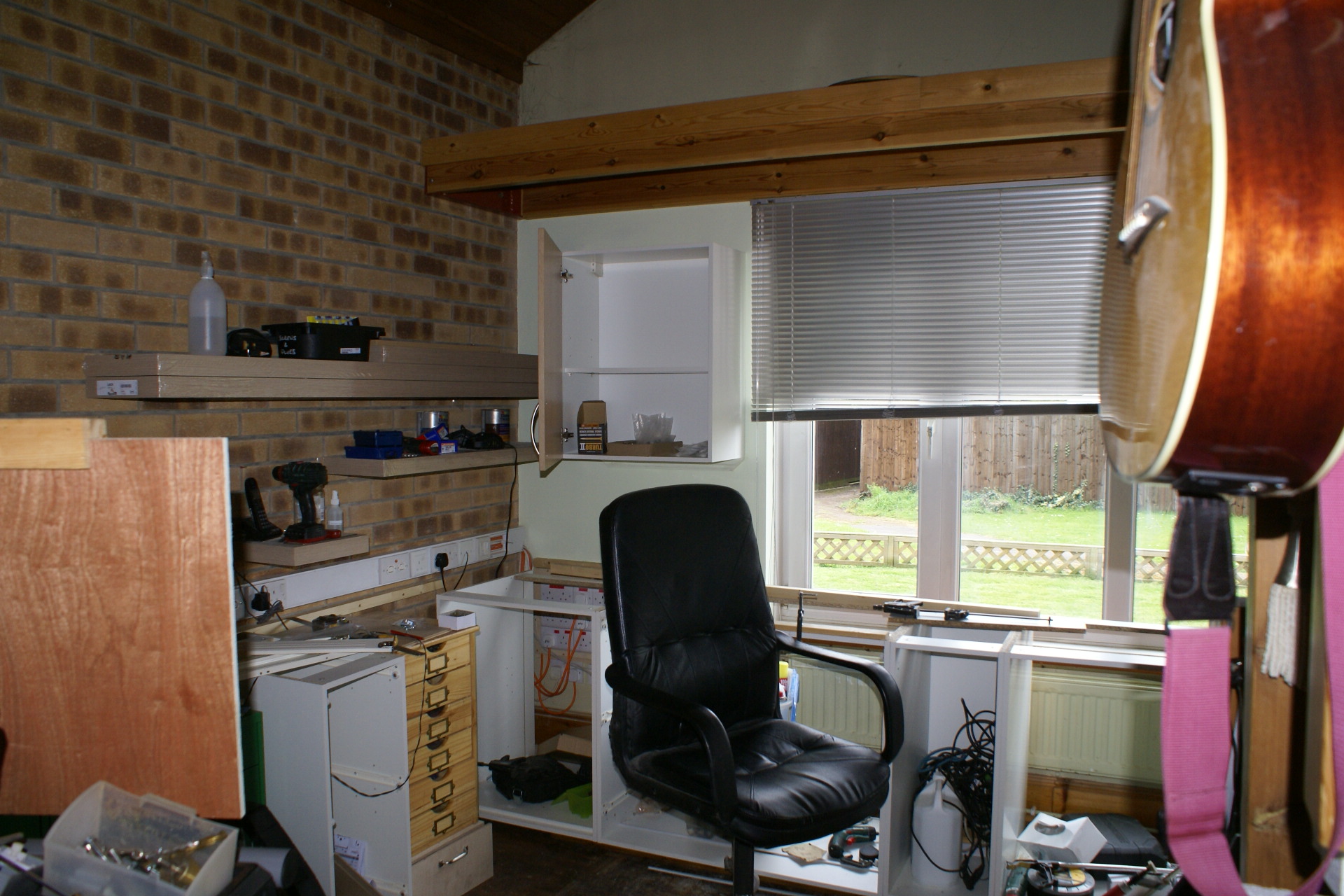

Does Mach3 disable limits when homing, or is this an option?
I am not able to look at my machine as it is currently on the floor in my office, which I am refurbing.
Attachment 27706
Looking back through threads (to 2016), I sort-of answered this question, but left doubt. I use a NO inductive switch for homing, but a NC microswitch for limits and I just thought that a break in the homing circuit could cause a crash if the limit is deactivated.
Re: Inductive Limit Switch problem
cropwell
Attachment 27706

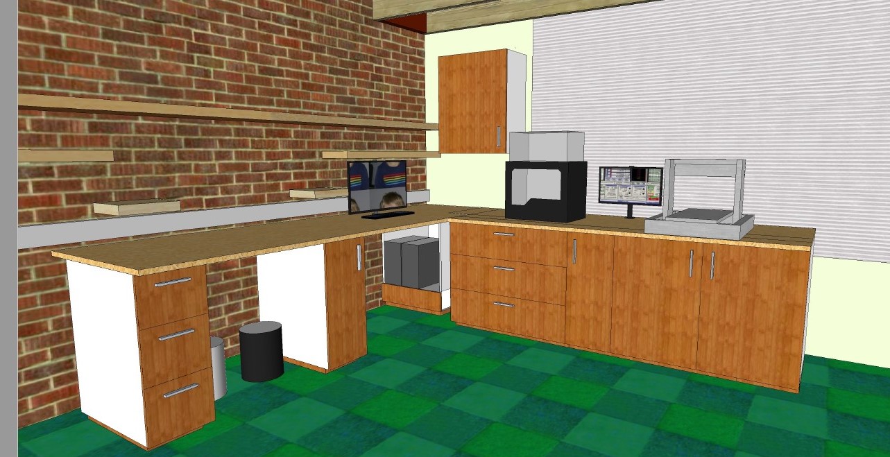

Wow, using CAD to plan your workshop refurb!
OK, after serious consideration my priority has to be getting the #$%^*&^%$#@ing machine actually working so I can make some stuff with it. Playing about with circuit ideas is fine, but...
I'm not wasting a long weekend off work waiting for RS to send me some new cable and other components including 2mm pitch plugs for the PCB headers, so I've made a circuit board which connects into the existing screw terminals without the need to remove/replace surface mount components on the BOB itself. I expect it's going to work. If so, it'll do for now and I'll make a more reliable change to the wiring later. This machine is after all just a toy in my shed rather than the heart of a commercial operation.
Watch this space for details if it works!
Voicecoil
Notice that Mach3 is already loaded :biggrin:
Attachment 27707
Thankfully, I had all the cabinets and worktop (25mm moisture proof MDF, 800mm deep) delivered before lockdown. All the carcases are built and in position. Next job is the worktops, and they are heavy sheets.
Anyway, My question is about homing and limits and I cannot find any reference to the query in the Mach3 reference manuals.
