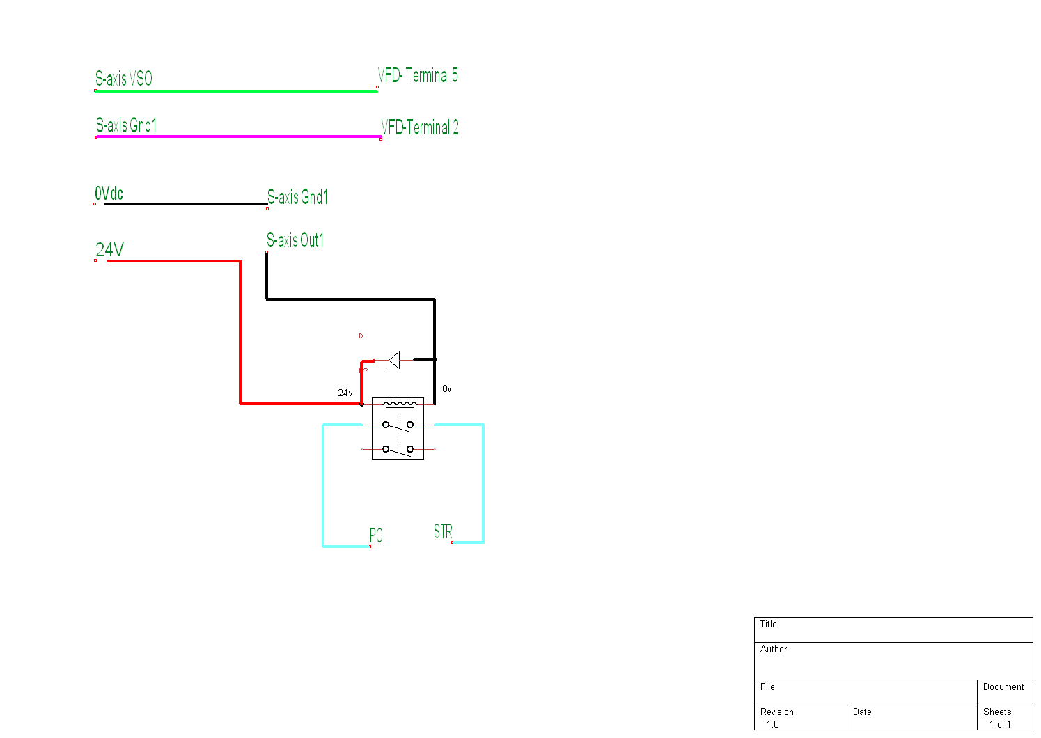

4 Attachment(s)
Re: N0VUSUN and Mitsubishi-D700-SC
Nvem S-Axis out1 Orange and White twisted pr goes to STF on the VFD..... through relay
Nvem S-Axis out2 Green and White twisted pr goes to STR on the VFD.......through relay
S-axis /Gnd1 goes to terminal 5 on Vfd which is Analog Gdn
S-axis/VSO goes to terminal 2 on VFD which is 0-10V.
So do i keep the above connections but with the addition of a relay,
i have these relays that came with a box of parts i ordered.
Attachment 27763
Attachment 27764
Attachment 27766
Attachment 27765

I use these Omron MY4N-J and they typically pull about 36ma. Dave if you have a meter that can read current then test on the bench to be safe.
2 Attachment(s)
Quick and dirty schematic:-
Attachment 27769
First option if the NVEM will source enough current to switch the relay. There's a reason why it might not, and I'll put this on the bottom of this reply, but try that first. The diode is connected across the coil, it's purpose is to protect the NVEM from back emf. I'll let you google the reason for this rather than lying. It's important.
Attachment 27771
The second option introduces a transistor (any general purpose PNP would do with a VCEO rating of 30V, Ic of 50mA, and a hfe (gain) of at least 100. That describes pretty much any general purpose transistor. I'd guess at a 2N3706 but any similar would do. If the output from the NVEM is switched - it goes low - that will drag the base voltage on the transistor significantly below the emitter voltage (24V) and the transistor will conduct C-E, and the relay will actuate. The current through the NVEM will be in the order of 1mA.
The reason why I'm uncertain if the NVEM will source the current for the relay directly is centred around Lies, Damned-Lies, and Data-Sheets.
The EL3H7 opto-isolators internal to the NVEM are rated at 50mA Ic (collector current). That is, beyond 50mA you risk damaging the transistor. But, the actual Ic is a product of the CTR (Current Transfer Ratio) of the device and the forward current through the LED internal to the device. Typically designed around 10mA, could be 20mA, but the CTR is specified as between 40% and 320%. So, guessing a 20mA current flow through the opto-isolator LED, the actual transistor current will be between 40% (4mA) and 320% (64mA), depending on the manufacturing process. So... 4mA won't switch the relay, whereas 64mA would (though the relay coil resistance would limit this to 36mA).
That's why you'd be best doing a bench-test on the relays first.

Sorry, I meant that as means of example of interfacing a digital output from the NVEM to the VFD. That's the control for... STF. Repeat for Out2 and the STR input the VFD (if you think you'll use reverse - you can omit this otherwise). Then the analogue 0-10V output (and ground) is as Jazz said.

This should help, it's basic setup with a diode across the relay to stop back feed from blowing the output up. See Doddy's rough top sketch for diode details.
Attachment 27775

Can't see any reason why not can't use those relays, you won't be using all the contacts but that's not a big deal. Infact depending on the spindle and if water cooled you can actually use one of the contacts to turn on water pump when spindle starts or Vacuum etc.
Yes just use 24v Nv PSU.

JAZZCNC
Attachment 27775
This is the wiring i have followed
Attachment 27830
this is the diagram i have followed
so between GRD1 and OUT1 on the s axis there should be no voltage, this circuit is closed by the controller when spindle is switched on in mach3

Good, this is very useful. The relay you have (MY4N-J) is a 24VDC relay, to answer Clive. That the LED on the relay illuminates, dimly, when "on" answers the question of whether the driver is configured correctly - from memory the driver is a very simple thing that doesn't really respect the ports/pins settings in Mach3. So that looks good. You've tried manually energising the relay and that works as expected - so VFD wiring and settings are good. This leads me back to my questions, and a hunch that I have.
First one - photos of the relay, I wanted to check if you've wired the diode correctly, but if you hadn't then you wouldn't be able to manually energise the relay (not without blowing the 1n4001... not entirely unlikely if it is wired the wrong way around).
Secondly, the voltage on the out-1 pin on the NVEM. If it is low, at 0V or maybe up to 2-3V then I'd say the opto-coupler output (internal to the NVEM) is switching as designed. But that would give you a bright LED. If, as I'd rambled about earlier, it doesn't switch effectively (low CTR) then the opto-coupler driving the NVEM output will have a high resistance, and the terminal voltage at OUT1 will be some proportion of the 24V supply. The higher the terminal voltage, the lower the voltage across the coil (and the internal LED) and the less energy to switch the relay. My question of the measured voltage - if above more than a few volts then I don't believe the NVEM is effectively switching the relay and we have to look at a current amplifier. I (or many others here) can help you sort that.
