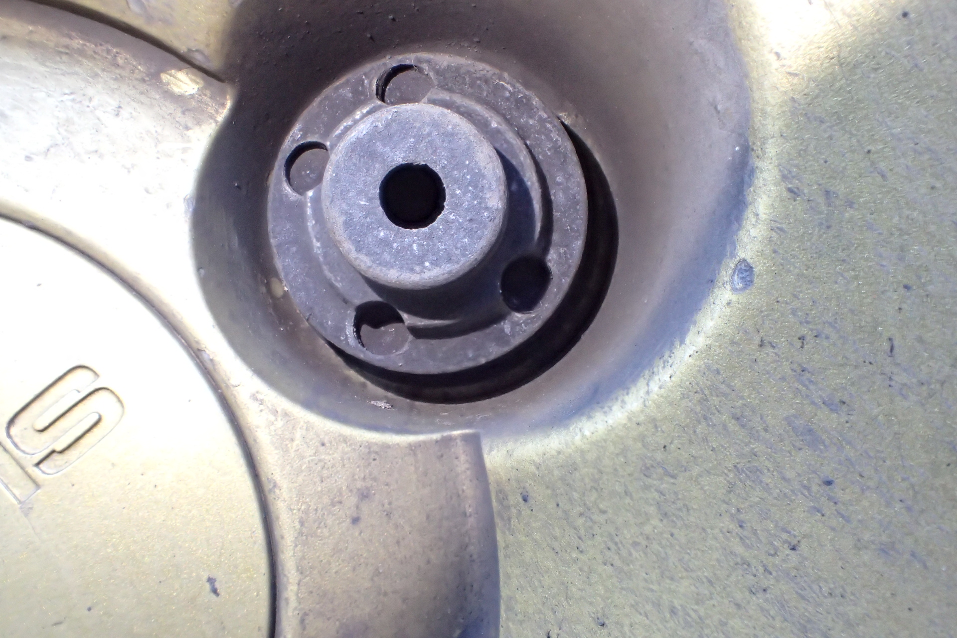

I have a little emergency project on the go - re-creating the locking wheel nut key I unknowingly lost a few weeks back and now need!. I've sorted out the design OK, but the only suitable material I have knocking around is some 25mm 304 stainless round bar, which is likely 50HRC absolute tops, probably less as I cut a billet off the rod with a hand hacksaw no probs. Now I have a couple of the above mentioned cutters which might do the job, but has anyone ever tried them on stainless, and if so what sort of DOC and feed worked best please?

What style of locking wheel nut?

They're the 4 pin style, like the cursed Peugot things, with a centre boss that's designed to shear off if you try welding anything onto it :thumbdown: Thanks for reminding me about the quirk of stainless, I learned that a few years ago when making an underwater camera mount for one of the Springwatch guys: yeah once you start you just have to keep going 'til you're through, no job for the fainthearted ... which was one reason I want to get a decent strategy planned before I press CYCLE START.

No, I'm not sure how well they'd work on this type - it will depend on the size and spacing of the pins: there's basically 4 off 4.4mm holes on a 60 degree, 90 degree and 75 degree interval on 19.0 diameter, and a centre locating boss: but thanks for the suggestion anyway, if I can find one locally I might give it a try.
Attachment 27805
If you could get 3 or 4 pins in each I guess it would likely work, if it's just 1 or 2, I suspect not, the local garage have done them up well tight.

Perhaps I'm missing something but it looks to me more like a job for the lathe (to make the fundamentally cylindrical body), followed by the mill (to position and drill 4 holes), then bang some pins in the holes. How were you planning to use the end mills?
304 isn't actually very hard (typically HRB 70 ie it doesn't even make the bottom of the HRC scale) - and being stainless you can't through harden it either. Machineability is different to hardness. Some form of carbon steel would be a better, allowing you to machine it easily and then harden it with a torch and a bucket of water. Then you'll get something nearer HRC60.
If it's an emergency and you are short of carbon steel, how about using an old cold chisel, crowbar etc as a donor. Cut a bit off with an angle grinder, heat it up to a cherry red and let it cool. Then you should find it easy to machine. It's easy enough to harden up again using the bucket of water etc. You can get tools like this at Aldi etc for peanuts if you don't have any.
While you are figuring this out, you could be letting some penetrating oil slowly do its business....
Re: APT High speed, high hardness end mills - anyone used them?
+1 regarding Muzzer solution/ turning first op (don't machine the counterbore yet)then setup for dividing and drilling the four holes (drill right through so you can fuse the ends of the pins to the body) return to lathe and do the counterbore, make and fit pins.

Thanks for the input guys. Yes, I was looking to do the counterboring on the lathe, then start the 4 pin holes on the CNC, followed by drilling to full depth (cobalt drill, thankfully I have some from the previous project). The other task for the CNC is to cut a hex on the other end of the tool to put a spanner on. Sadly I don't have anything carbon steel of suitable diameter that could be sacrificed, about 18mm seems the biggest and it's far from straight. Normally it wouldn't be a problem, I'd go round to the local agri engineer and scrounge a bit - but of course things are not at all normal at the mo, and the nearest town is a bit away - not that I'd want to go there anyway. I do see one or two eBay metal traders still functioning though so if I can get by for a few more days of topping up the offending tyre that might be the way to go.

After a couple of delays due to other stuff I finally had the opportunity to have a go at it today, and I have to say I'm impressed with the APT cutters. Sequence of machining was:
1) Turn down outer of bar to size ont' lathe, spot drill either end for centering.
2) Peck drill pilot holes for the 4 pin holes on the CNC, 4mm cutter.
3) Transfer to drill press and drill pin holes to full depth.
4) Drill a 10mm centre hole for the recess (lathe) - this made the subsequent milling much less arduous.
5) Enlarge centre hole & machine counterbore on the CNC - I didn't do this with lathe as my boring tool was a bit shagged.
6) Flip it over and machine the hex at other end.
I had to quickly turn a couple of pointy things that fitted into the collets to achieve the centering, but they'll be useful in the future no doubt. Seems to have turned out OK, accuracy is fine (apart from a small centering error on the centre hole) and the finish is pretty good -not that it matters really, it's only a tool - but nice to know for future work.
