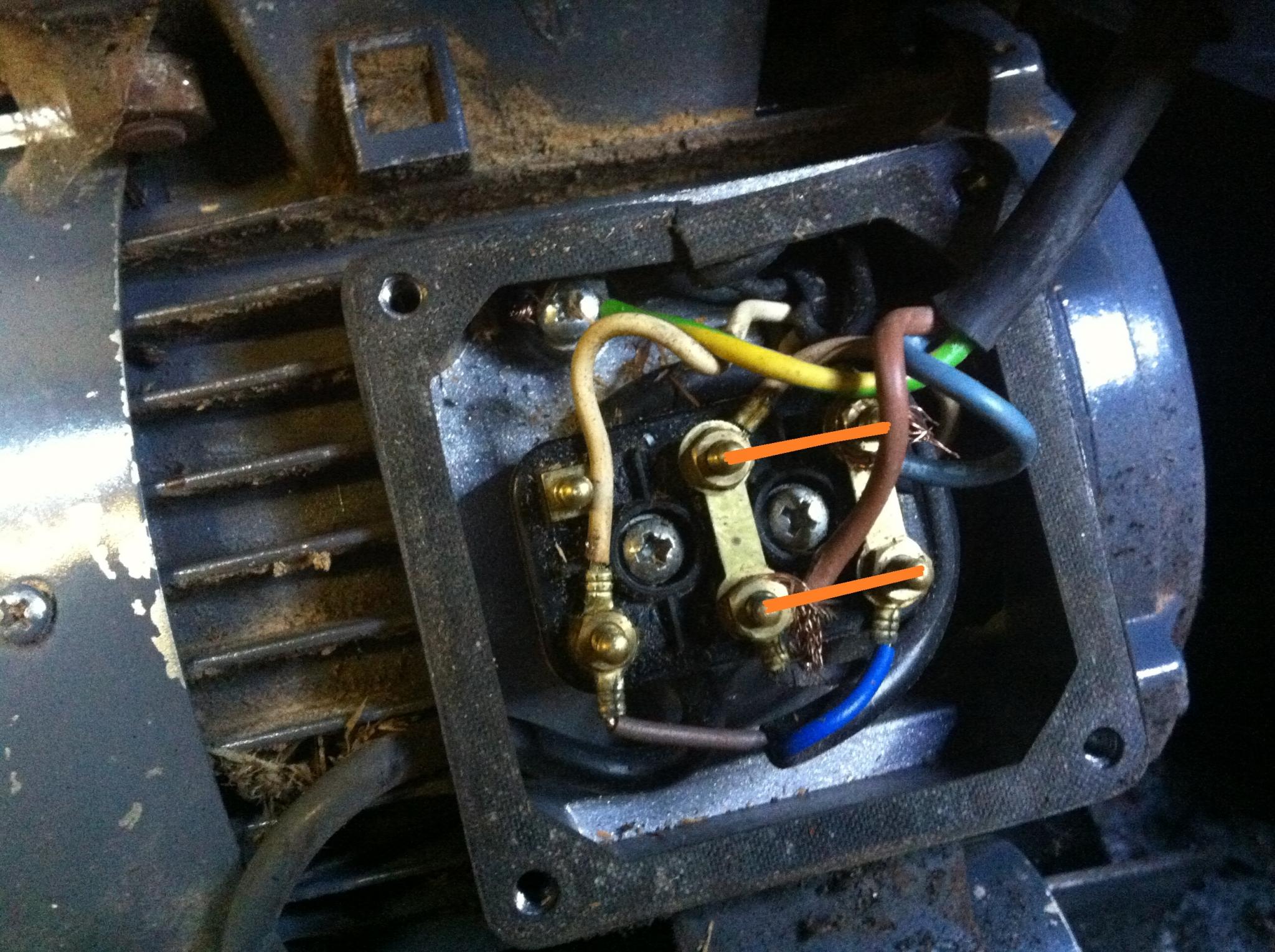

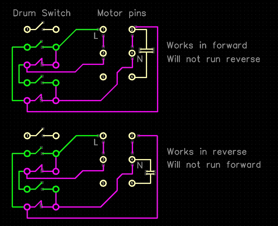

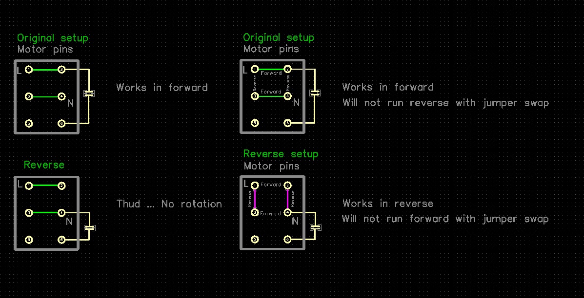

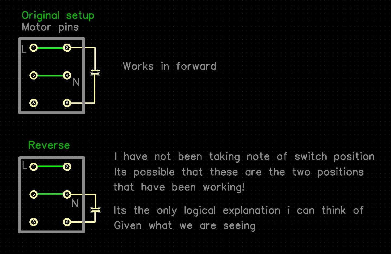

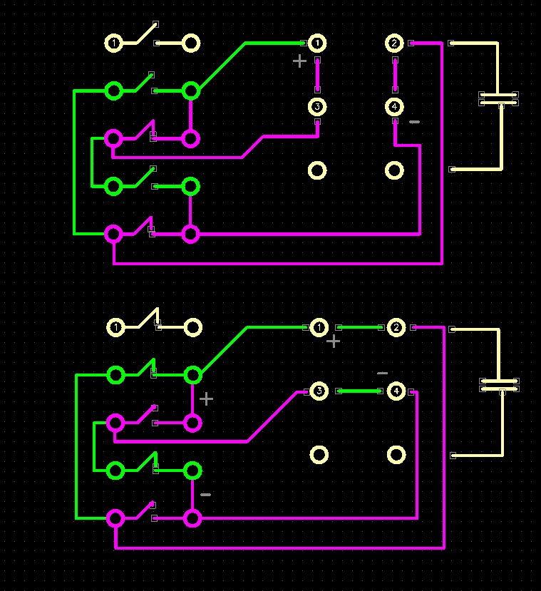

That was a nightmare.... I had a dud contact on my (cheap as chips) rotary switch.
I thought I was going mad, the logic had gone all twilight zone!
I now have a lathe that works in forward and reverse.... CHEERS GUYS!

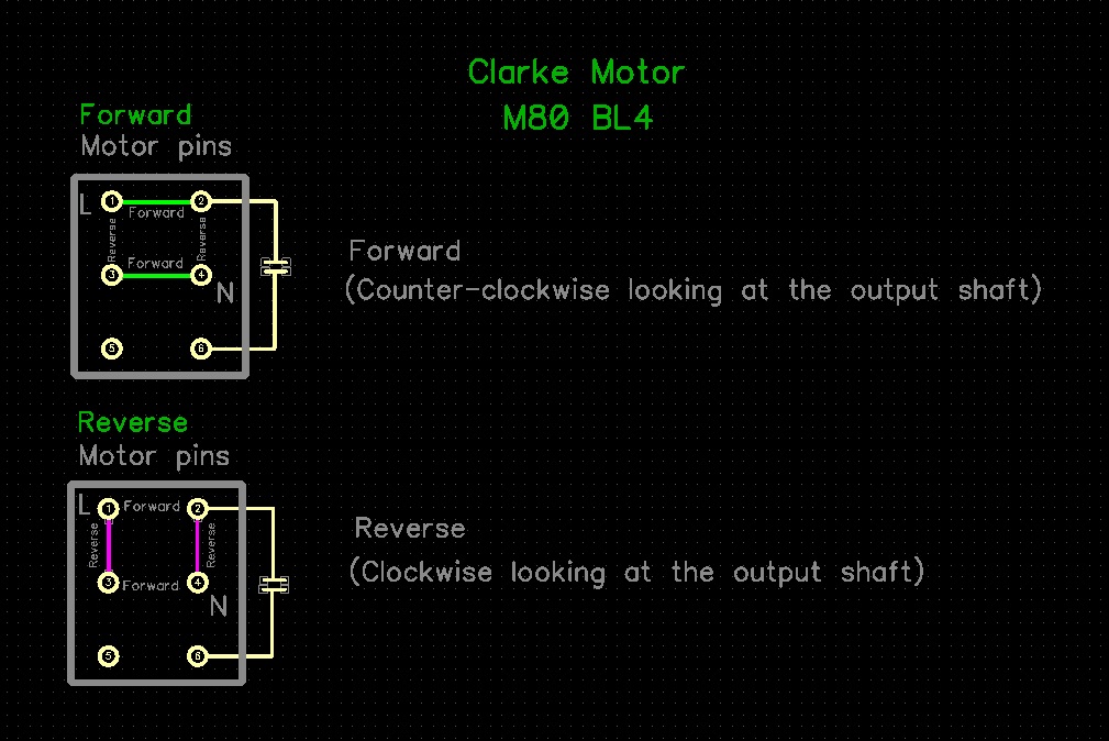

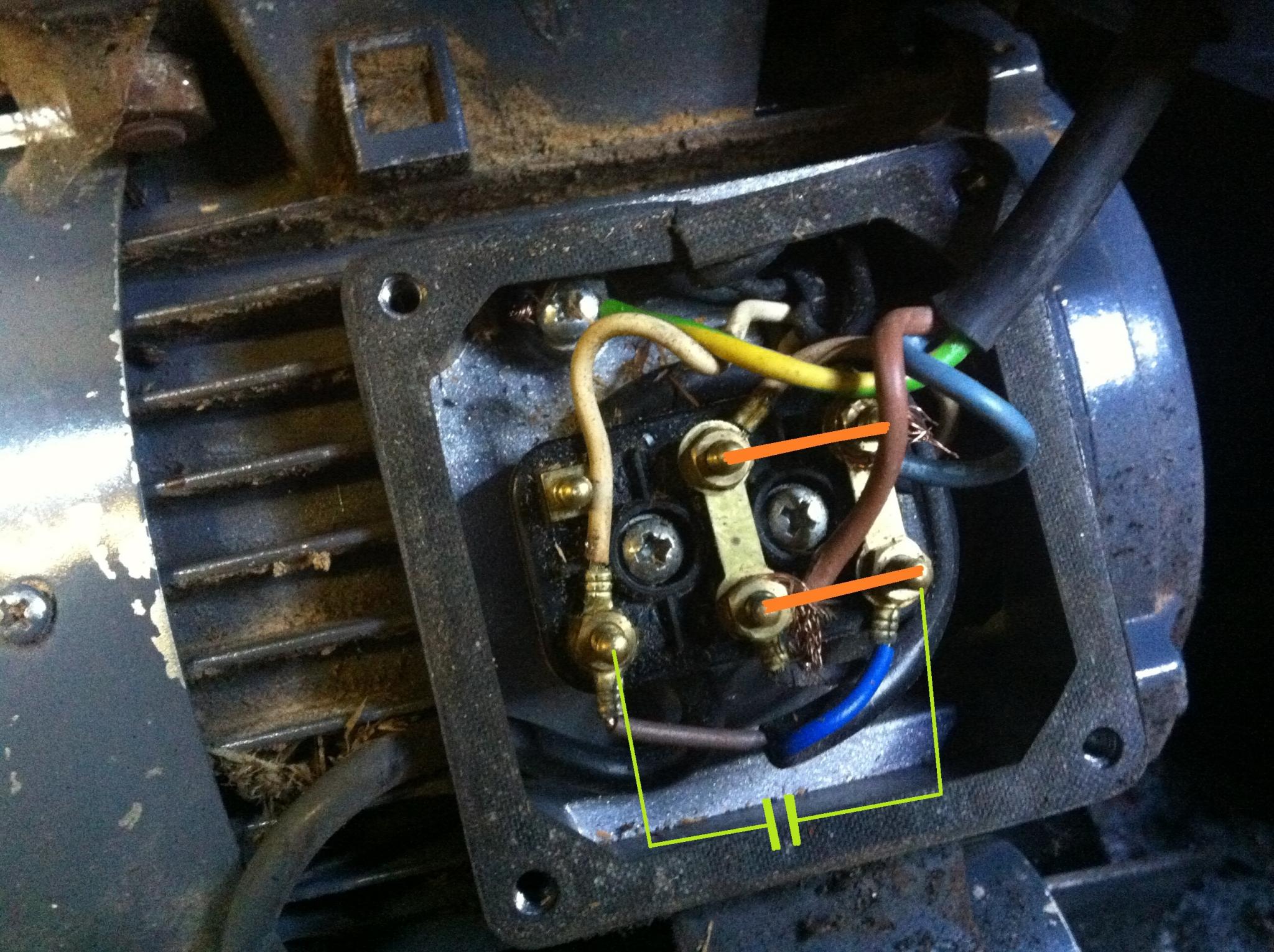

It is just a simple case of moving the two jumpers / bus bars through 90 degrees on this motor (or adding a switch to do just that)

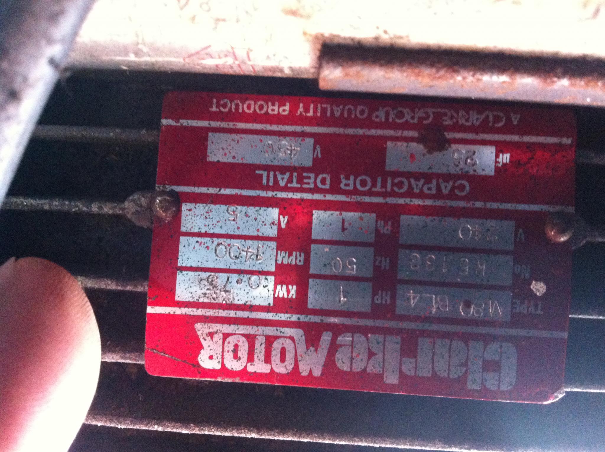

Clarke Motor M80 BL4

I was going to pull the motor out and measure all the winding wires but I thought I would give it one last run through as the logic seemed to be pointing to an strange anomaly or fault somewhere.
