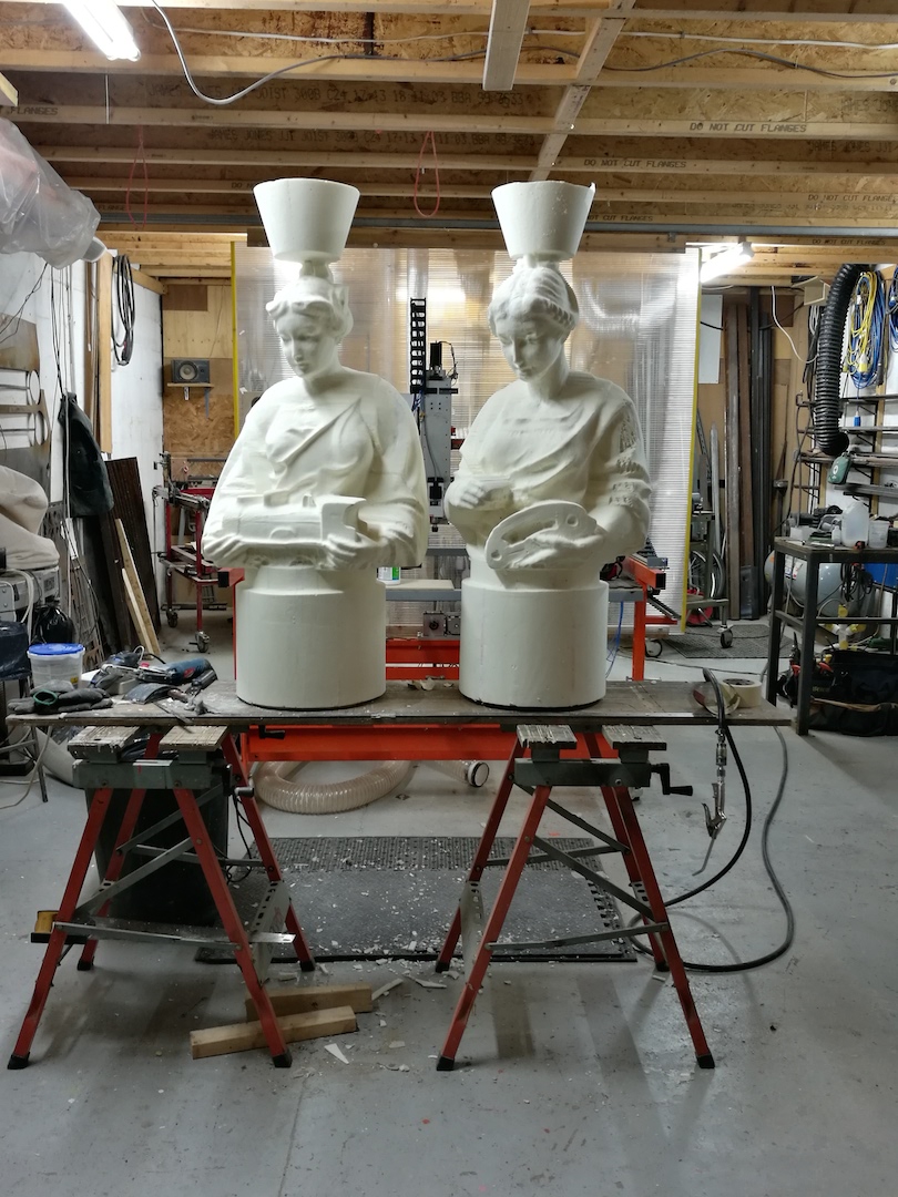

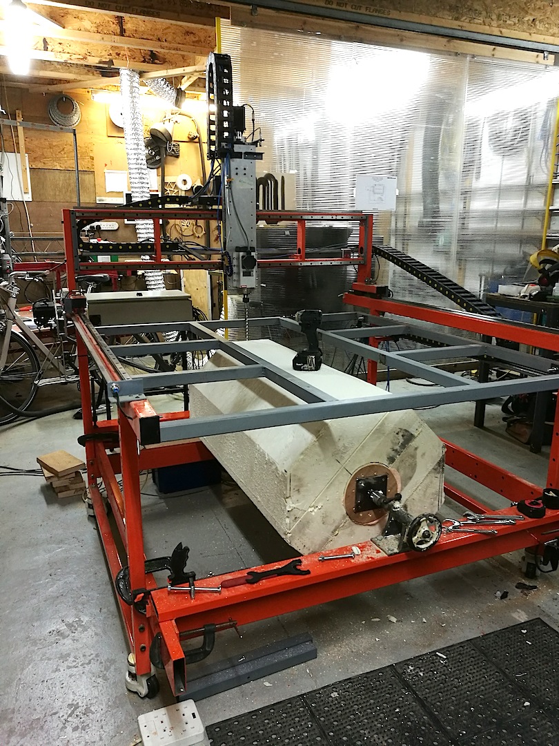

Just out of interest this is the kind of outsized 1200x600mm block of foam I attached to the 4th for milling out a sculpture in the past. Strictly parallel milling right down the centre of the 4th axis.
Attachment 27997
Re: 4th axis brake enquiry
Wow - you're not joking about it being "outsized" :-o What were you carving out of that may I ask?
Voicecoil
Wow - you're joking about it being "outsized" :-o What were you carving out of that may I ask?
I was asked to make copies of two sandstone statues from a building in Glasgow from photogrammetry captured models.
Have you posted about this before, or have I read about that somewhere?
I seem to remember reading about models being made from photos in Glasgow..
Thanks for the feedback. Hmm I might have posted before about the big 3D foam milling, probably not this particular project though, see pic.
I’ll start to look into the custom brake On/off coding and see if its something I can think incorporate without too much hair loss :). Yeah bigger motor could do, similarly the gearing as not concerned with speed just needs to work within the motors torque sweet spot.
I was actually thinking not for this machine but another about making a big manual 4th/5th axis trunnion for a post lockdown job coming in. Something in which I can manually orientate large foam blocks, to orientate the part to mill a 5 sided objects using indexing milling strategies. I can just program each face separately, orientate the block, lock it off and run the file. As these will be in foam a small amount of rotational deviation will be ok and saves me tonnes of work and money trying to make a electromechanical version at short notice. As long as the tool tip is set accurately to axis centre/s should be ok.
Attachment 28005

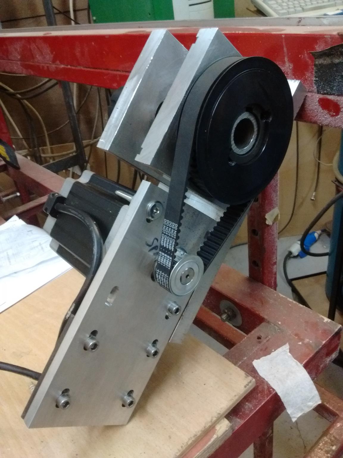

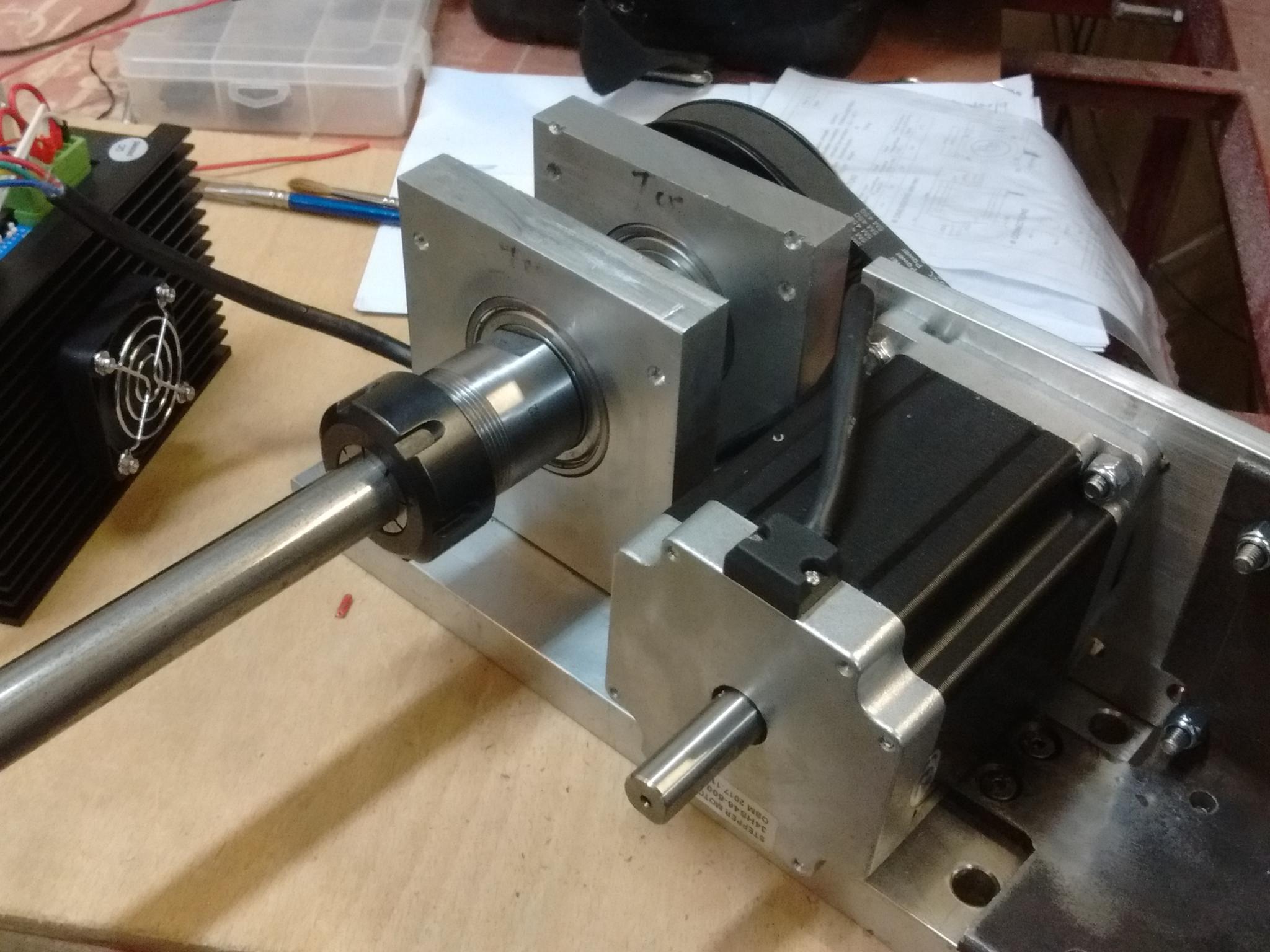

Current 4th set up
3DM860, 24~80VAC 30~100VDC 7.5A 20KHz PWM
Nema 34 , 8.5Nm, 5Amp
80V + 600W switching power supply.

I was in the workshop today trying to learn how to program simultaneously 4th axis and had a bit of wood on the 4th. When I put some pressure on the edge of the wood I can see a small amount of movement at the motor. I’ve got a digital driver on that 4th and wonder if it might also ‘have a go at’ self correcting, not as good as a closed loop thought i’m sure.
From the movement I could see it looks like the wee pulley on the motor needs some mechanical advantage help so I think your idea of the rotary table might be better. I see people using 30:1, 100:1 gearing, what kind of gearing is on a rotary table. At this point I wish I knew more about mechanical engineering. ..
All things considered was pretty surprised my attempts without using specific kinematic actually worked to program some simultaneously 4th axis action just using a basic mach3 post processor?!

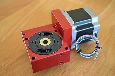

I just remembered I bought a few of these a few years ago. Very high quality wormscrew mechanisms. Might be worth a tryout
Rino Ondrives Worm Gear Reducer 30:1 Vexta Nema23
Attachment 28019
They look like a top bit of kit - accurate to about 0.1 degree if I've read the Ondrives data correctly.
They're certainly worth trying.
Voicecoil
Looking at the OnDrive website for Nema mount version, it looks like you can get either an 8 arc minute, and a 30 arc minute version, which is 0.1333, or 0.5 degrees.
It all depends what kind of accuracy is needed. 0.5 deg works out about 1.3mm of movement at a 300mm diameter. Off course the 0.5deg figure is the worst case scenario.
