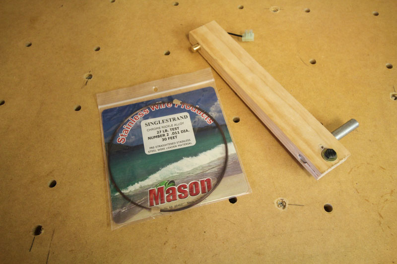

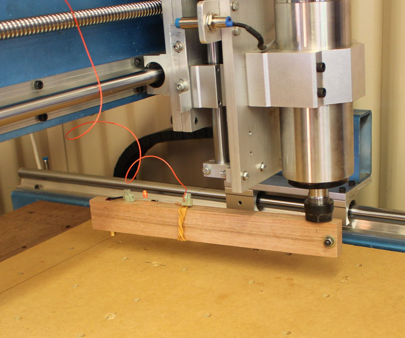

Here's a quick video showing how the measurements are made...
https://vimeo.com/414191935
Any difference between measurements on the two wires means the gantry is leaning forward or backwards and shims are required on both the front or back mounting bolts of the gantry.
If the difference is different at each end of the Y axis (the rails mounted on the gantry) travel then the Y rails are not parallel and shims are neeeded under one of the rails themselves.
An average of each pair of measurements relates to the height of the spindle above the wires. If this average is different at the two ends of the gantry then the gantry is tilted to the left or right and shims are needed on both mounting bolts at one or other end of the gantry.
The DRO on LinuxCNC displays to the nearest micron. Somewhat optimistic since 800 steps/rev on a 16/10 ballscrew equals 12.5 microns per step, but I think the readings are going to be useful enough to get the machine rather better aligned than it is now.

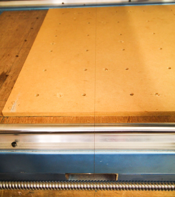

Some results! Numbers are to 2dp to avoid going way off for calculations but in reality there is some interaction between the effects of different errors and I will need another set of measurements after the first round of shims go in. At least I have some ballpark figures for cutting the required shims.
There's a 1.78mm change of height between the two ends of the Y travel. Obviously skimming the base will hide this for some jobs but therewill still be a geometry error with the Z axis. A little over 2mm of shims will be required at one end of the gantry.
The measured diference between the front and back wire measurements varies between 0.44 and 2.23mm so the gantry is both leaning backwards and the rails are not parallel. 0.44mm over the 600mm between the wires equates to shims of about 0.1mm at the rear bolts of the gantry base.
The difference between the differences of the measured values calculates out to require shims totaling 0.42mm at one end of the lower Y rail. Since the whole rail will need some pretty thin shims at each fixing point I'll correct for the gantry leaning back here as well. This will be the longest and most tedious job but it will be possible to fit a shim, make a measurement, correct the shim, move the spindle, make a measurement, fit a shim..........
To put the twist in the Y rail plane into context, the measured error works out to cause the tool tip to make an unwanted move of about 1mm along the X axis when the Y axis is moved between it's two extremes. When squaring up my gantry using the draw-a-square-and-measure-the-diagonals method I have never been able to draw a square with the two diagonals equal in length to better than about .5mm. This is probably the reason.
Once the gantry is sorted out then the Z axis can be aligned as well.

This has been a day of measurements, fitting shims, making measurements, adjusting shims, making measurements... repeat and repeat!
I've never done a job like this before and it's been very interesting to go round and round slowly, but very surely, getting closer and closer to optimum each time. The measurement process using the Z axis and it's DRO as the measuring device is not as accurate as a dial gauge but has proved very effective and easy to use. Repeatability has been better than 0.05mm which is hardly world class engineering but is entirely adequate for this job and probably matches the accuracy available from the usual YouTube tramming methods involving leveling a piece of glass on the machine base or simply skimming the base and testing for ridges. We will see when I skim the base of this machine and see how smooth it is.
Having got the gantry rails as accurately aligned as I can it is possible to adjust the spindle bracket vertical. There is significant play in the mounting bolts but by positioning the gantry so that the spindle axis is directly above one of the wires it is possible to adjust the exact position of the bracket so that the probe just touches the wire on each side, indicating the spindle is vertical in this plane to within about .05mm in 600mm (twice the length of the probe). The wiggle room provided by the mounting and it's bolts allows a variation of approximately +- 10mm in the height of the probe relative to the taut wire.

I haven't used wires along the long, fixed axis of the machine (this is the X axis on my machine which might be some of the confusion) but have assumed these rails are straight enough. Checking they were coplanar was done using a precision spirit level and adjusting the feet of the frame which is not especially rigid. Sometime in the future I will make a suitable camera mount and use Joe's method to get these rails as perfectly straight as possible, but for now they will have to do as they are. My aim for this work was to get the gantry better aligned than it has been since I've always known this was the least accurate part of the machine.
Based on YouTube research, tramming the spindle with dial gauges usually involves some way of creating another plane using a piece of glass and shims that is coplanar with the fixed rails. This seemed overly complex and prone to error, hence going for the taut wires across the rails themselves. I think the video shows this best, though the opening still actually shows the gantry positioned for the final measurement I made for checking the spindle vertical as you mention.
In practice it has proved an effective method. Averaging front and back measurements allowed me to shim the gantry height at one end to remove any end-end tilt and taking the difference of the same measurements indicated a front-back lean. A difference in the differences indicates a twist in the plane of the rails on the gantry (Y axis). By taking measurements with the Z axis assembly positioned over each set of Y rail fixing screws it has been possible to shim the upper or lower rail at each point quickly and easily.
Some iteration was required but a day's work has got pairs of measurements all along the gantry to match within 0.3mm over a 600m measurement base. Hardly the highest engineering standards but more that an order of magnitude better than I started with. Using the Z axis DRO as the measuring device has limited accuracy but made measurements quick and simple at no extra cost!
I've since been able to square the gantry so that the diagonals of a 500mm square are exactly equal as far as I can tell using a set of made-for-purpose dividers. This is a noticeable improvement from the past when it has never been possible to get them within 0.5mm, presumably because of the distortions in the gantry set-up.
