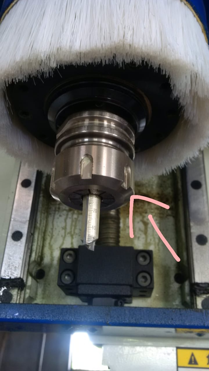

here are the videos that show that the spindle does not turnAttachment 30867
NB:it turns perfectly but, without noise, everything is perfect
