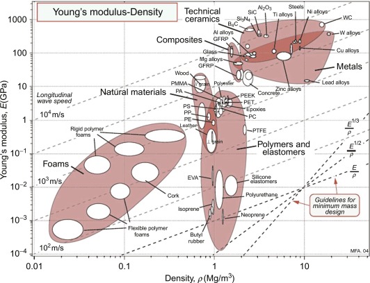

I don't think you will get better than PU resin for dampening without going to heavier materials which will bump up the mass which you don't want for moving gantry. But if it's fixed gantry then filling it with concrete will be your best option as it's about the highest up the Stiffness/density chart without getting silly about it.
See this Young's Modulus- Density chart it graphs which material gives what performance comparing Stiffness to Density. PU is right about in the Middle.
Attachment 28074

I'm not sure there is a clear relationship between modulus, even shear modulus and shear loss factor. So that's why I'm unsure the best resin or material to use.
Does high shear modulus translate to high shear loss? Probably not or a stiff solid would be best.
