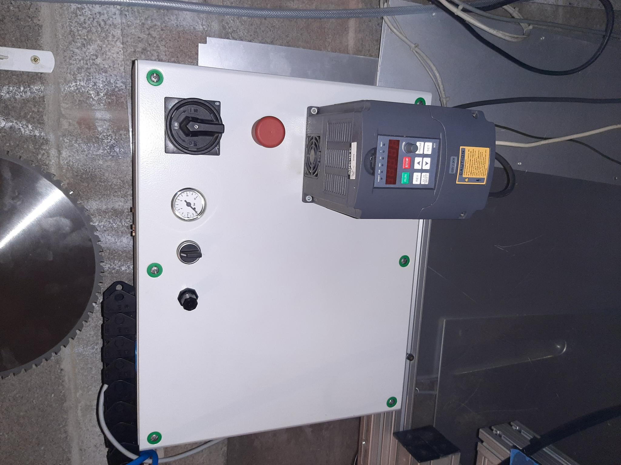

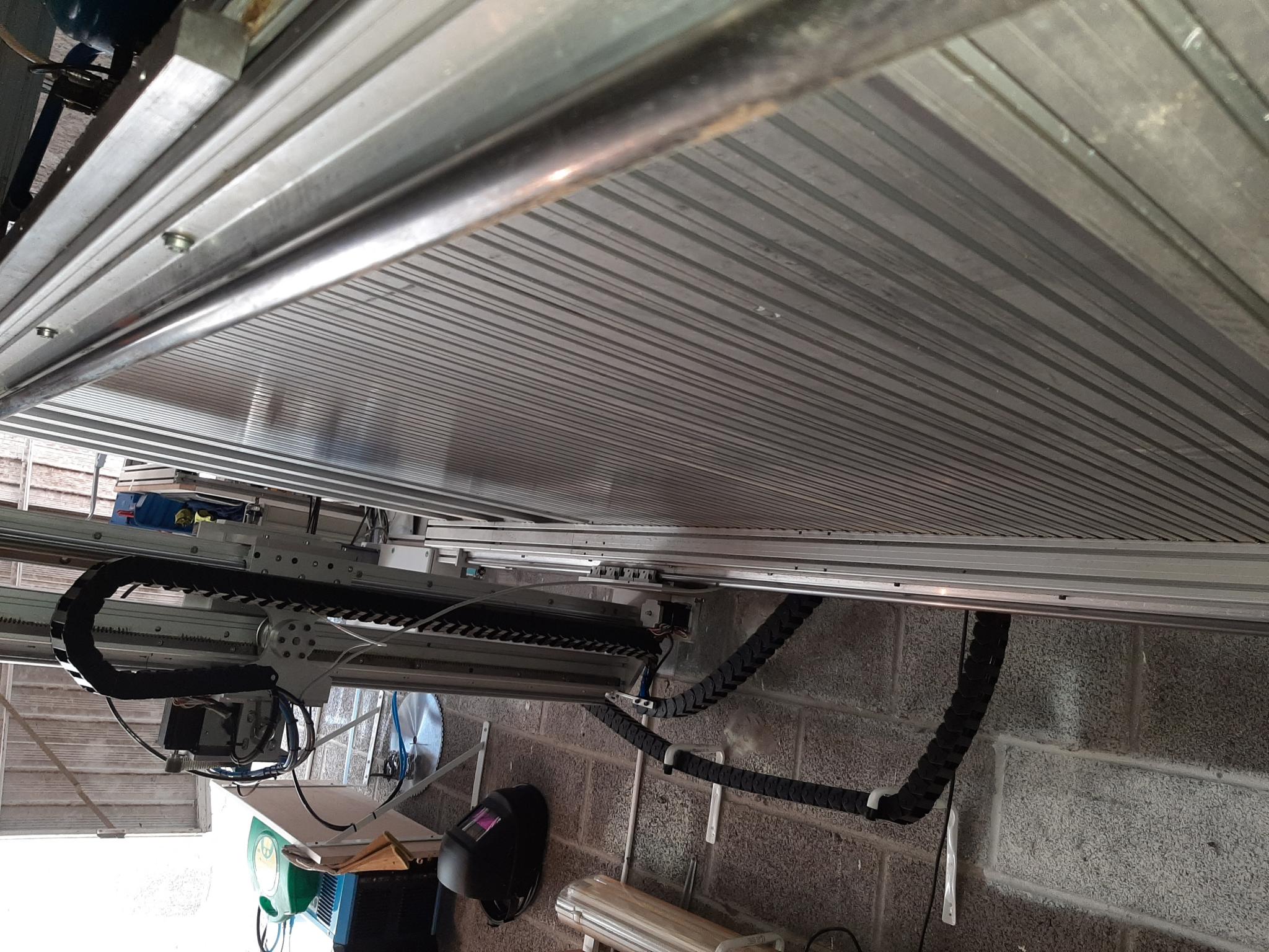

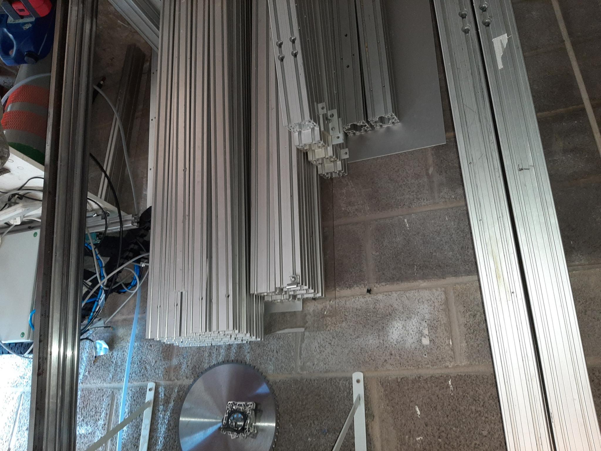

Howdy..... I have made a decision that most on here would think to be a crazy idea. Totally strip down a full size and fully working home built 3m x 1.5m Cnc Router and build smaller machine !! Some may think it madness as most people tend to make their machines bigger over time. This is exactly what I did a few years back. I went from a small desktop machine bodged together from scrap and started building bigger better parts until I reached the point of a full size machine capable of cutting full sized 2.4m x 1.2 m sheets of mdf etc.
The reason for my madness is simple...... Space!
My machine has been pretty much Idle for two years since I completed her. It got to a stage that I had run out of space in my small garage. I had no room to move or to actually bring in full sized sheets due to the layout. Anything stored underneath the machine was getting covered in sawdust, metal shavings and cutting fluid.
When I started this adventure many years ago I had this insatiable urge to have a full sized machine but when I got there I realized I did not have any need for such scale. What was I going to make with it??? I still don't know!
A few words of warning to those who want to go big big big. Make sure you have the room to build such a beast and plenty of room for sheet storage and an assembly area for stuff you make on it, otherwise you will end up like me. One final word of warning. Make sure you can walk around or easily access all sides of your machine. One of my biggest issues was that i had built right next to two walls (Back and complete side of machine)and found I had no way to fix or lubricate should the need arise. "And it did"........ Given the fact the she was several hundred KG at that stage and impossible to move.
With the above in mind I have made the decision to downsize and maybe make her 4 or 5 axis. For the moment I will concentrate on 3 axis as I would need a functioning machine to make parts for the additional axis upgrades down the road.

I will attach some images of the current machine and update as I make progress. Let the fun begin!

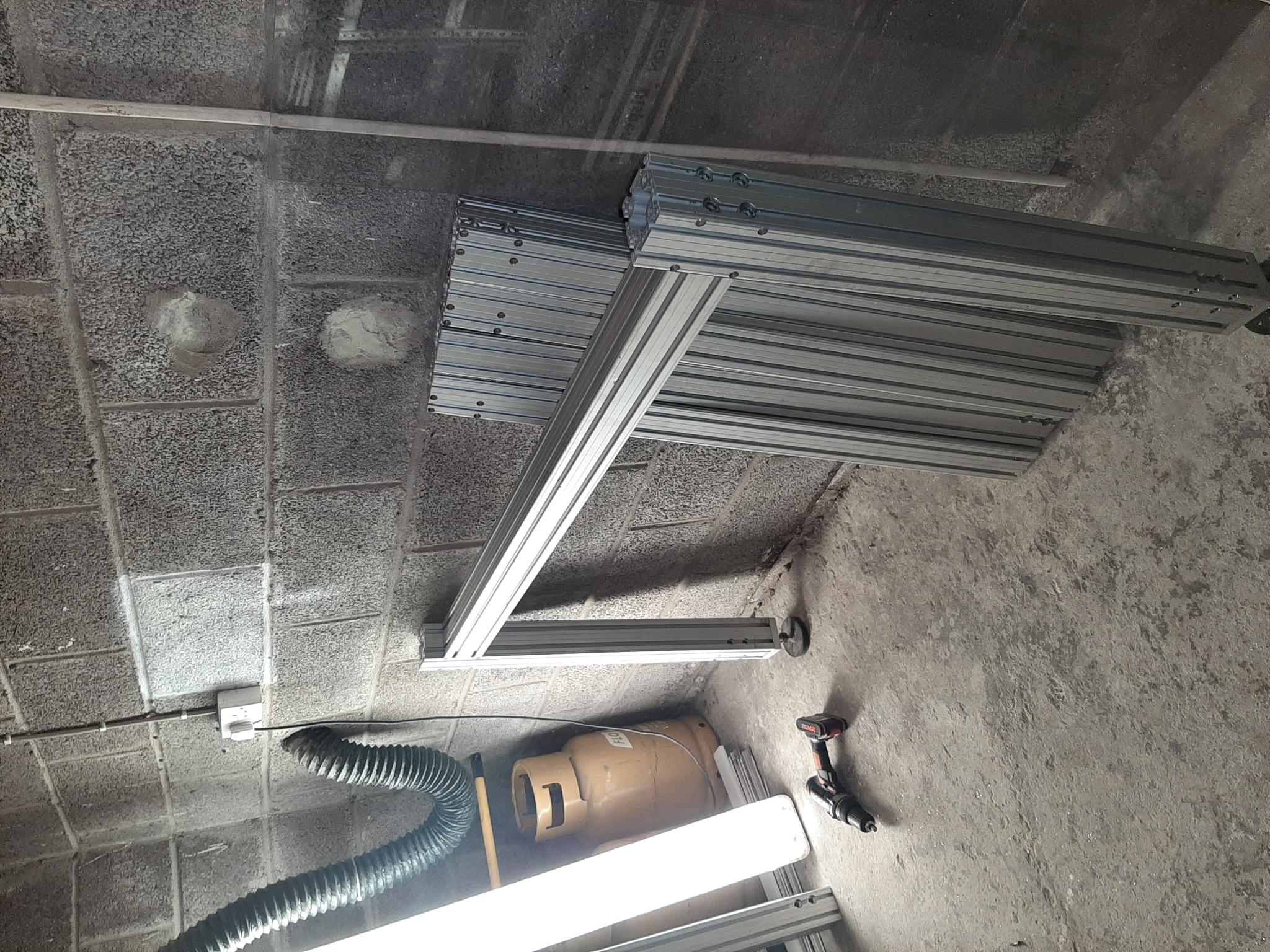

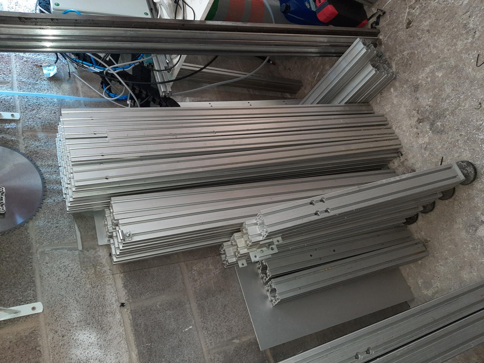

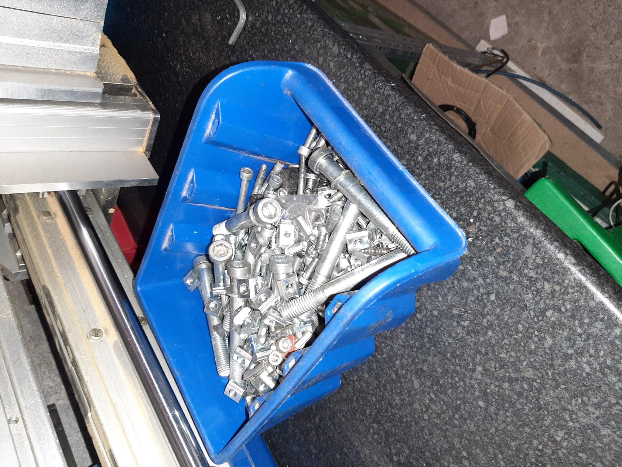

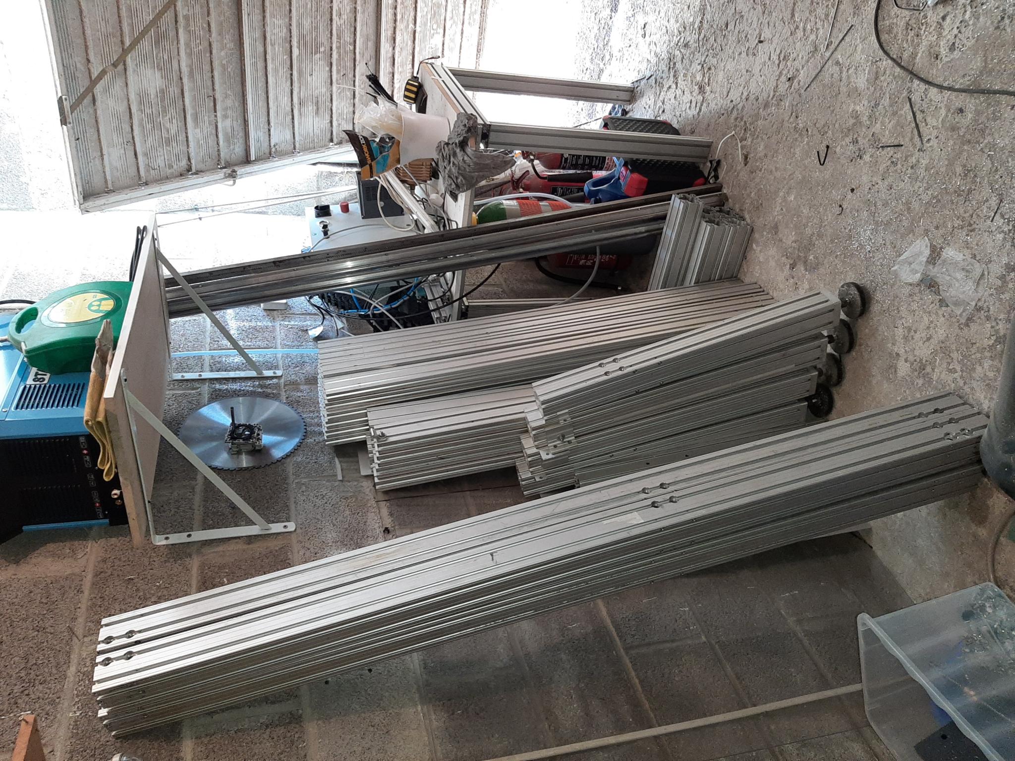

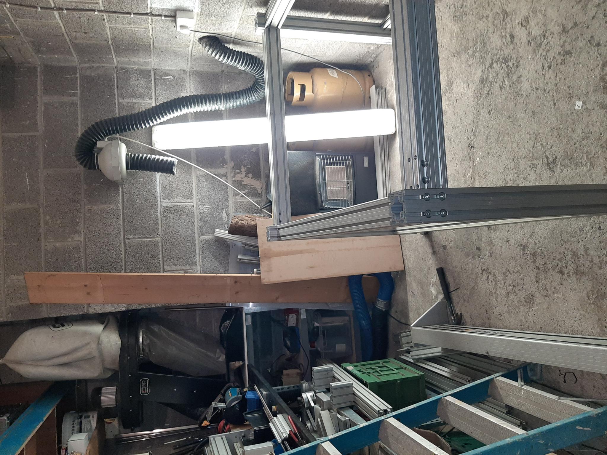

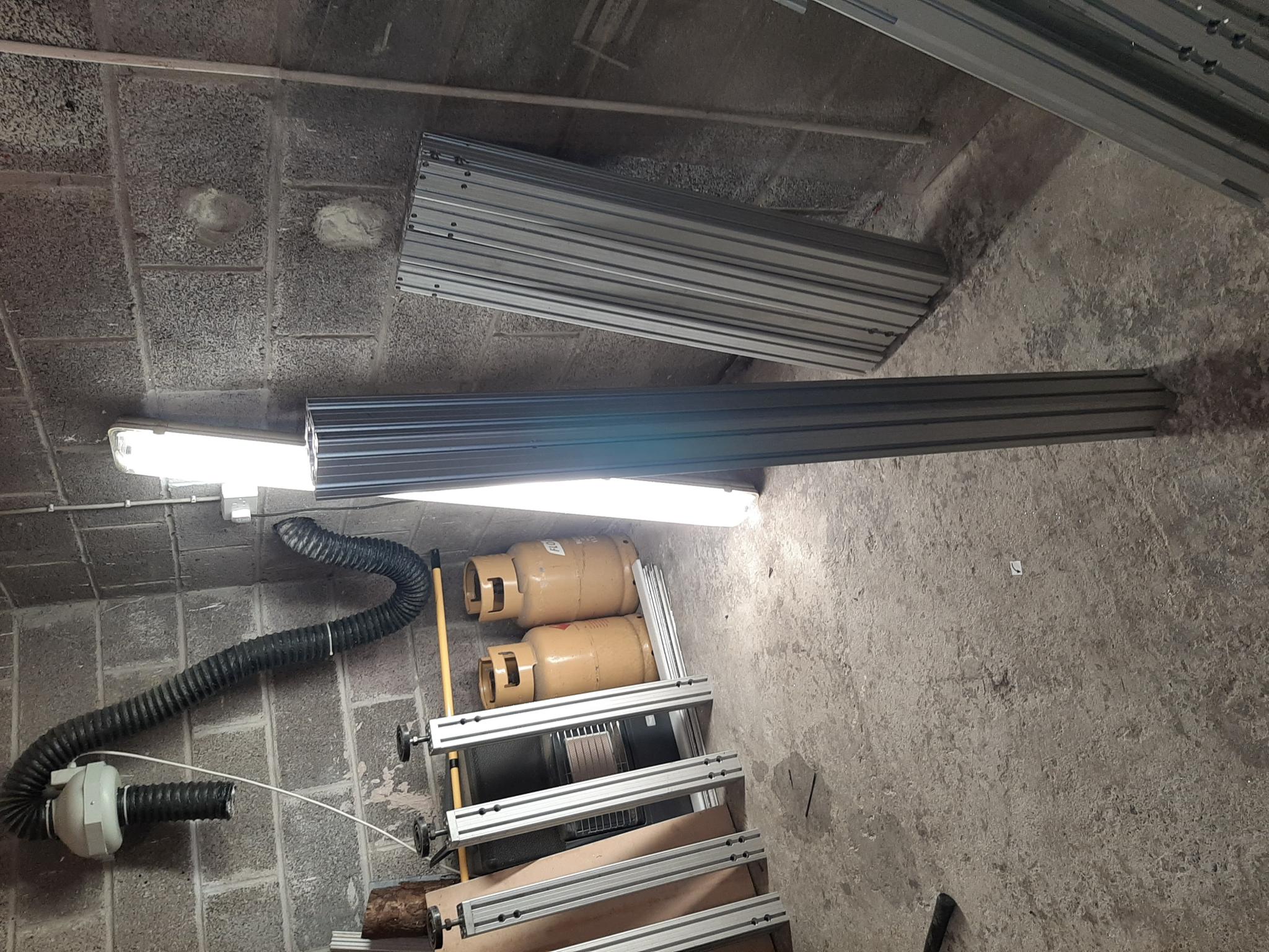

4 Attachment(s)
Re: Down Sizing to 5 axis.
I actually have more than 300 mm space in the garage now !!! I didn't realize there were so Attachment 28101Attachment 28102Attachment 28103Attachment 28104many machine screws in her...

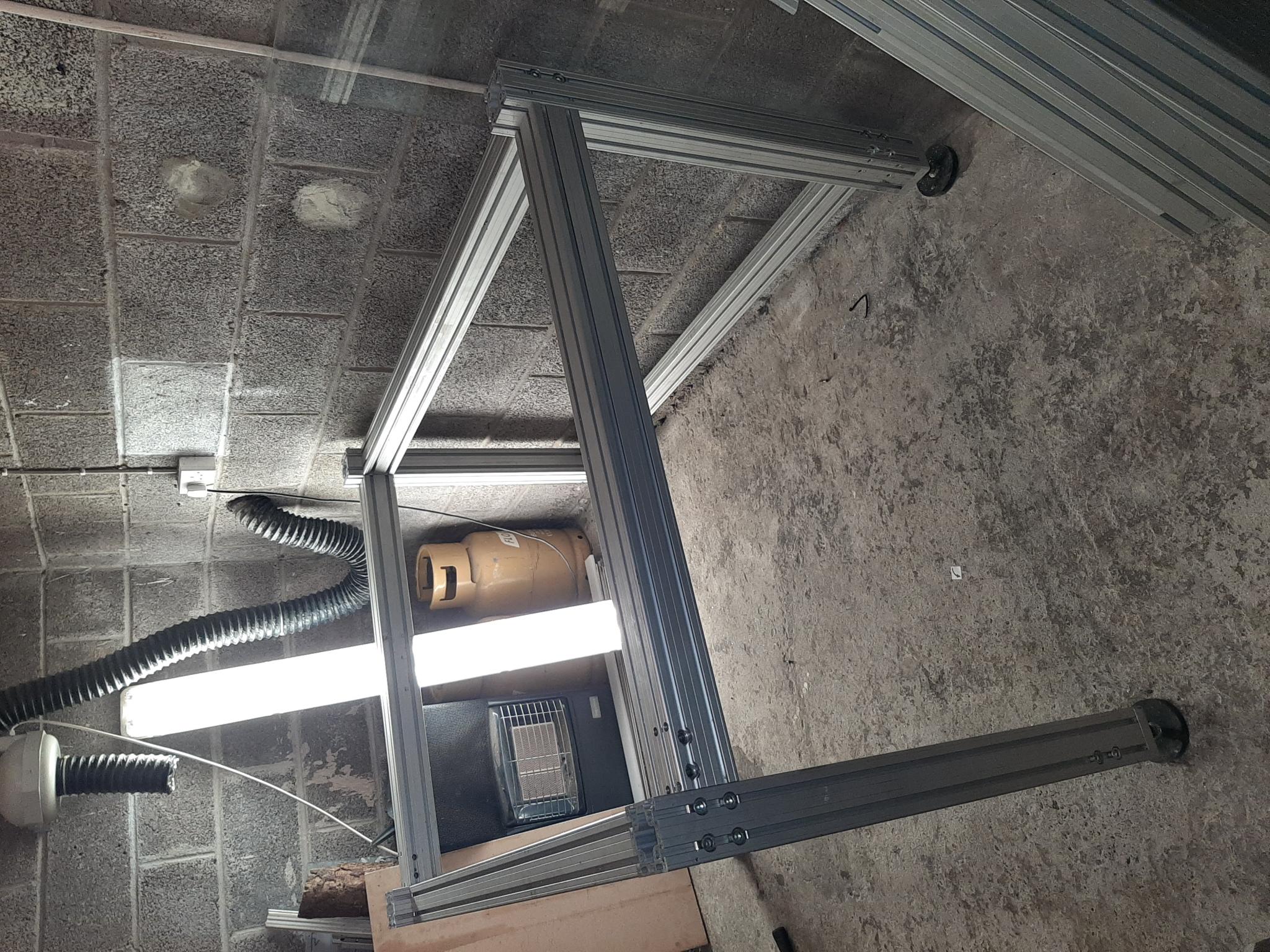

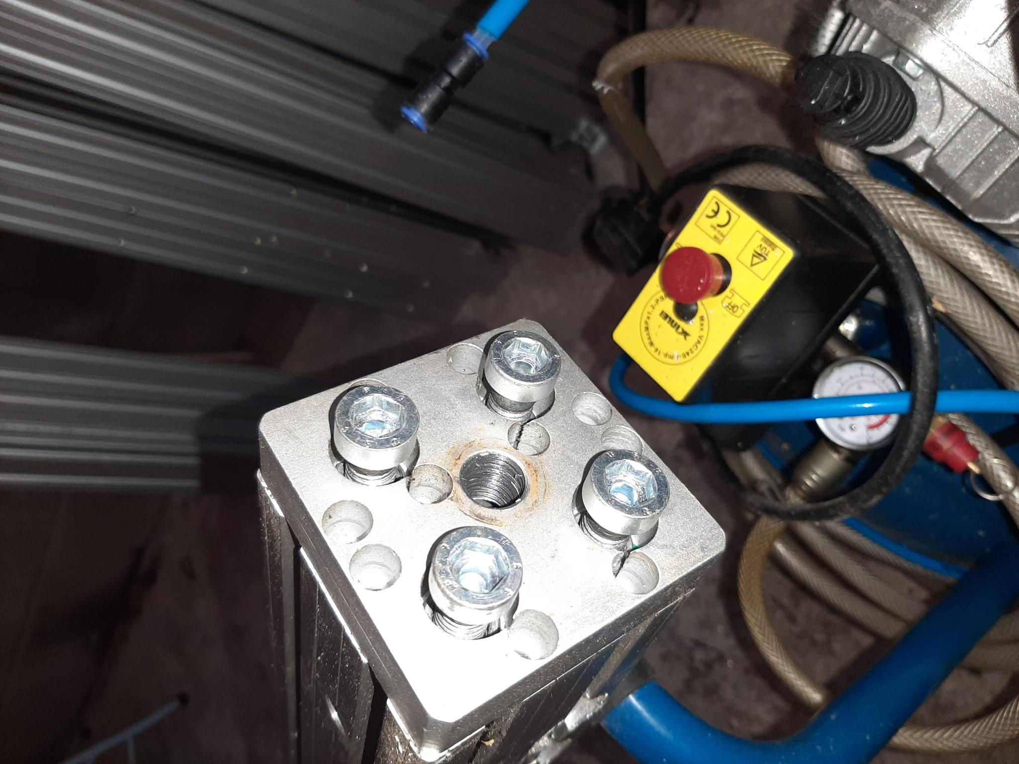

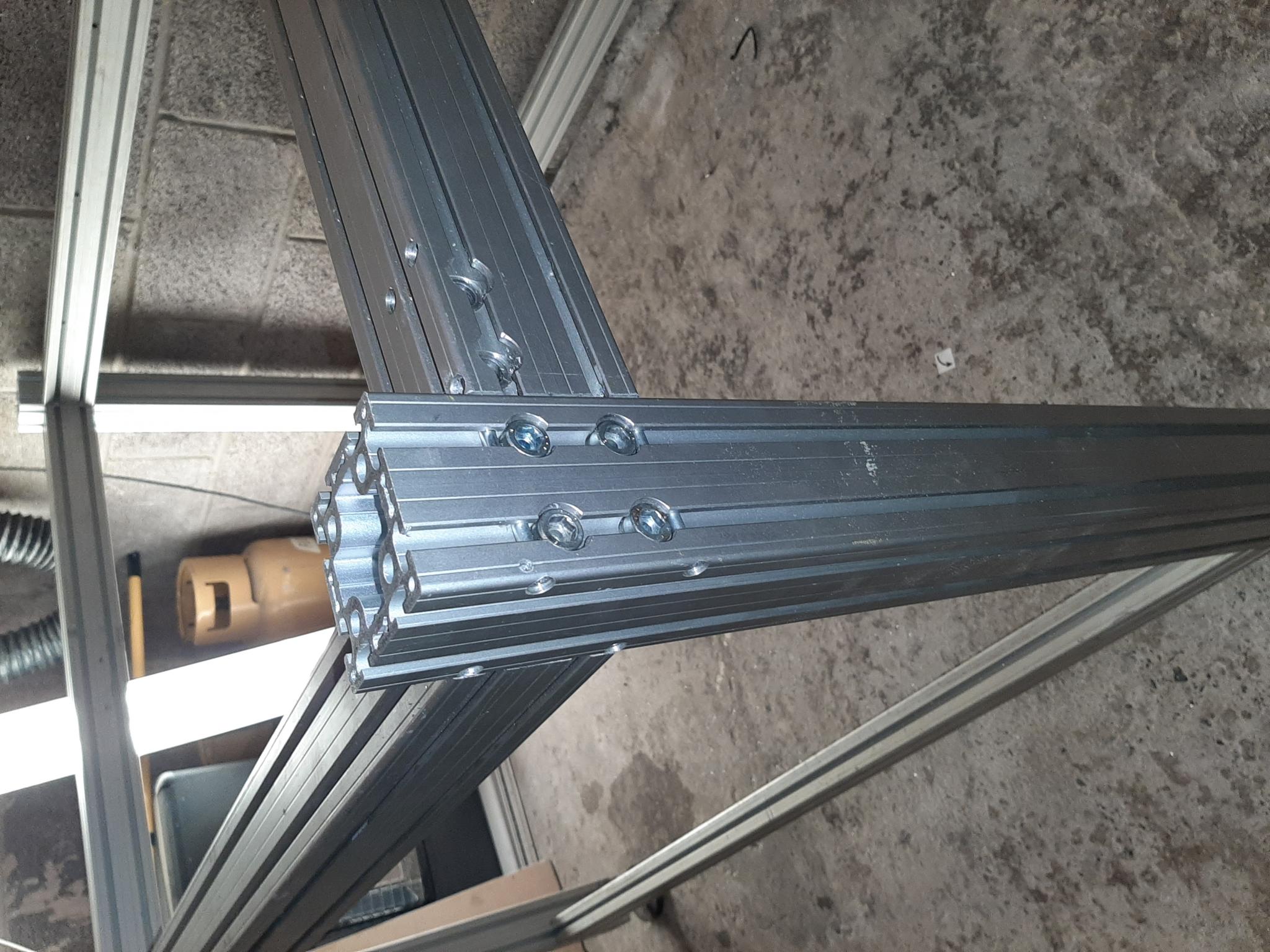

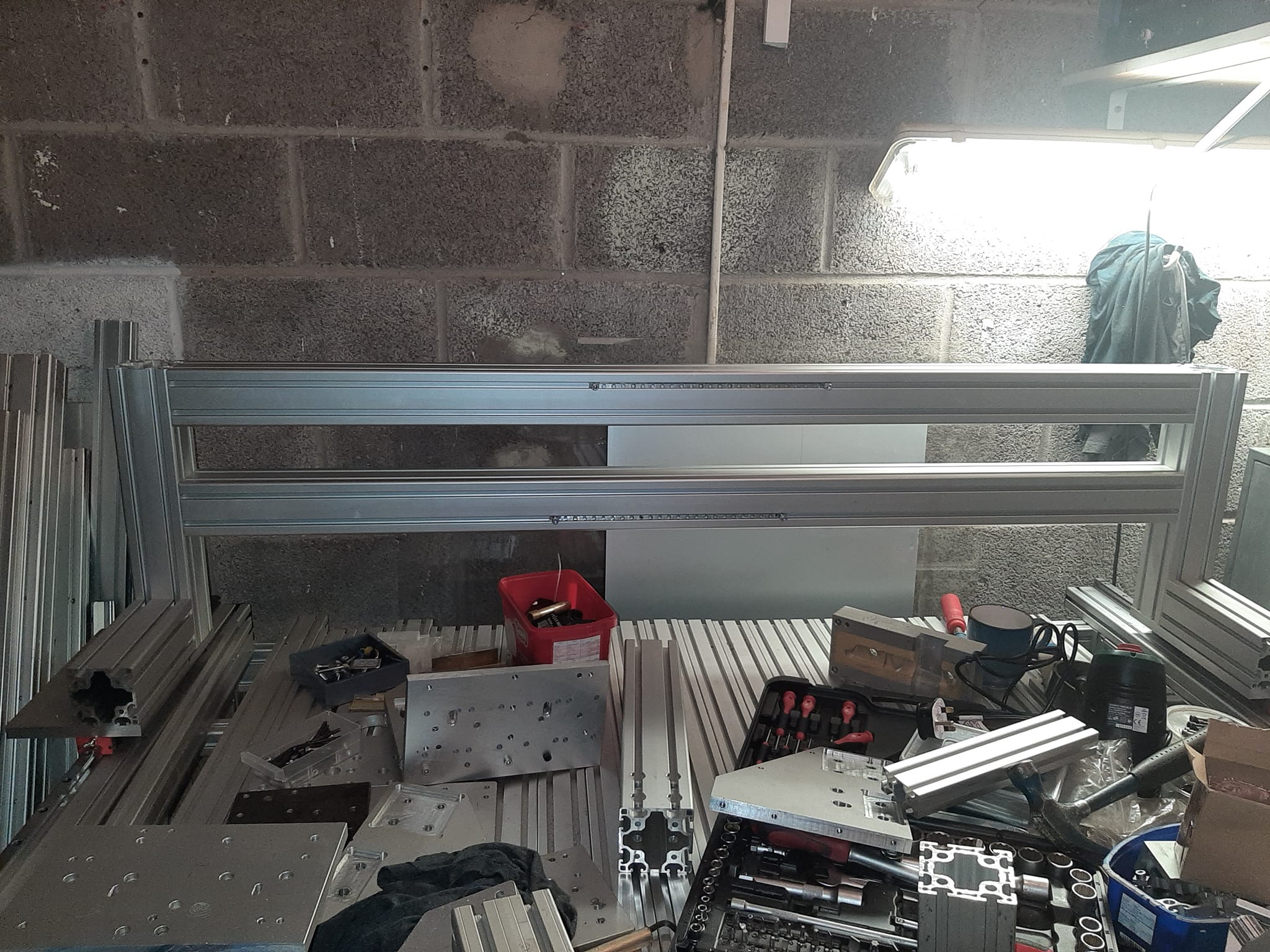

7 Attachment(s)

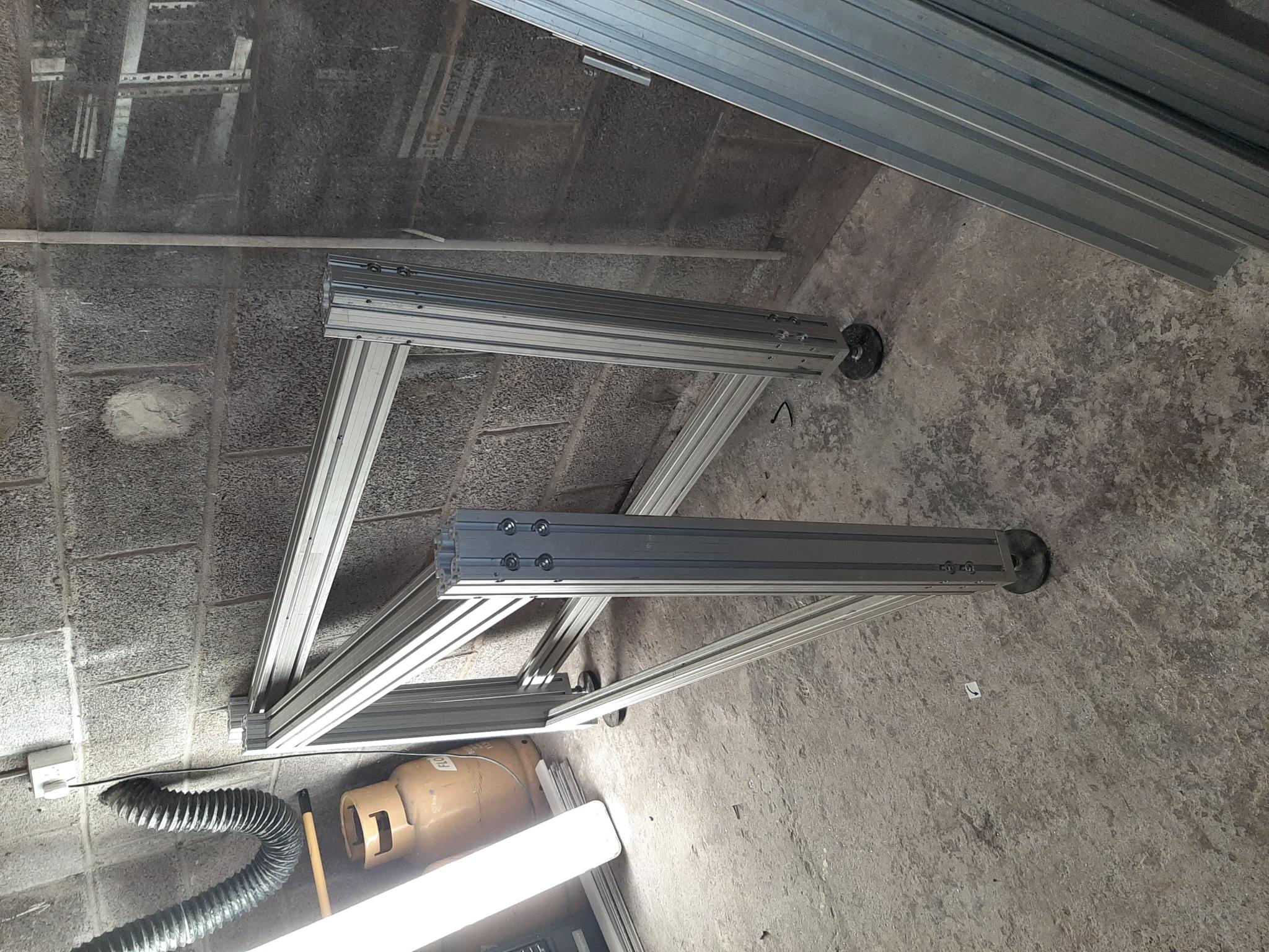

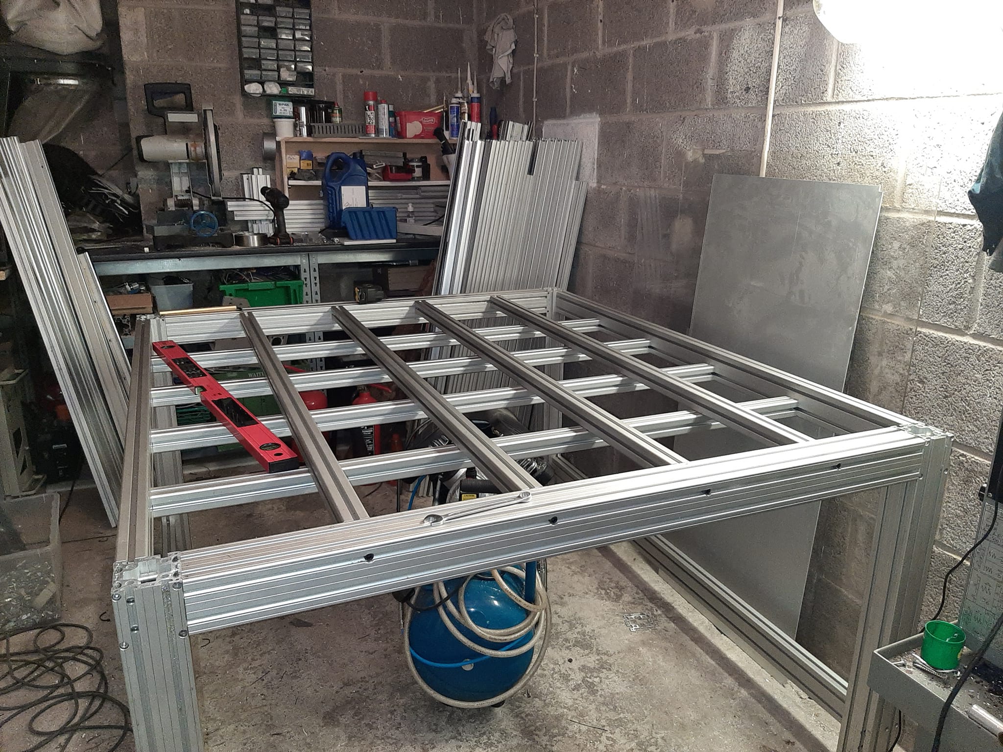

Hey Bert, Yes it nice to look at and I am lucky in a way that a lot of the required tapping etc is already done. I'm guessing I made the neighbors a bit unhappy today with the metal saw!! The design is going to evolve.. I kind of have the idea in my head but because I am hoping to spend zero money on this make over it will change quiet a bit. I plan to use as much stuff as possible that I have about the place. Bits and pieces of older scraped machines and skip salvage etc.
So today I started the base and at least I have some Idea of the dimensions. Although I had a good bit of profile to play with the sizes were not ideal.
After a diet of tungsten carbide saw teeth she has slimmed down from 3m x 1.5 m to 1.450m x 1.2m Approx. This is a much more manageable size for me due to space restrictions.
For now I have the base frame mostly done. ( bottom supports to be added shortly ) and as soon as they are added I will level and square off the base before proceeding with the table supports.
The legs are higher than the base as i will attach an enclosure to stop coolant/chips flying out of her when cutting. This will happen towards the end of this phase of the build as it will help with access for the moment.
That is it for the minute!!Attachment 28108Attachment 28109Attachment 28110Attachment 28111Attachment 28112Attachment 28113Attachment 28114

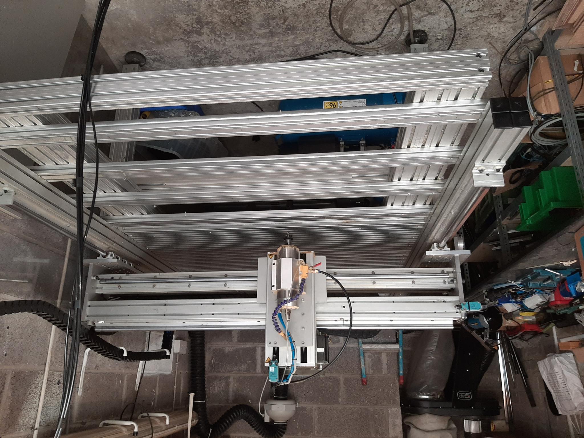

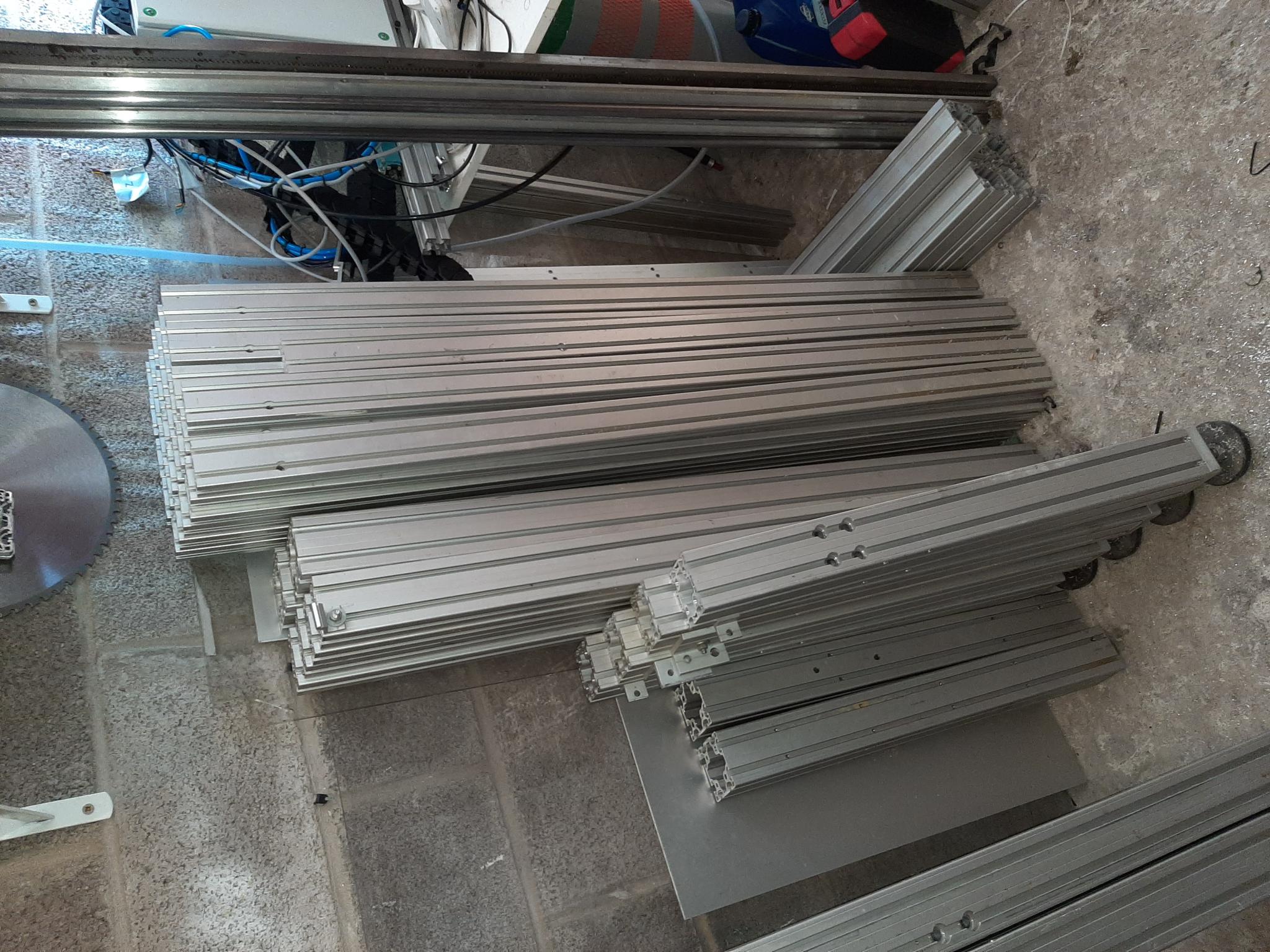

5 Attachment(s)
A little update. Due to the whole corona thingy delivery of materials and parts have been very slow indeed. She has grown a little from what I had originally planned but it is well within the space available in the garage 1500 x 1700 including the side mounted ball screws and motors etc.. Her predecessor was way too big for practical use. I am slowly getting through my wish list.
To do for the moment:
The table bed supports have yet to be pinned together and I will do this as soon as the machine is squared.(currently 1mm off square in one direction). Dam wobbly crooked floor!!!! Water table/Coolant containment to be fitted as soon as the table is pinned and squared. I plan to sandwich the polyethylene sheeting between the table supports and the mounts for vices etc. Might be a crazy idea but I will try it none the less.
Finish off fitting both y axis ball screws/mounts and as I have only started the gantry so still a lot of work to do on that side of things. The new motors and ATC are still at least 2-3 weeks away from being delivered so plenty to do in the mean time. I will use my existing z axis for the moment and when she is cutting I will be able to machine the bigger/better z axis that i need for inclusion of the ATC.
Thats pretty much it for the moment. Lots to do!:tennis: Attachment 28410Attachment 28411Attachment 28412Attachment 28413Attachment 28414
