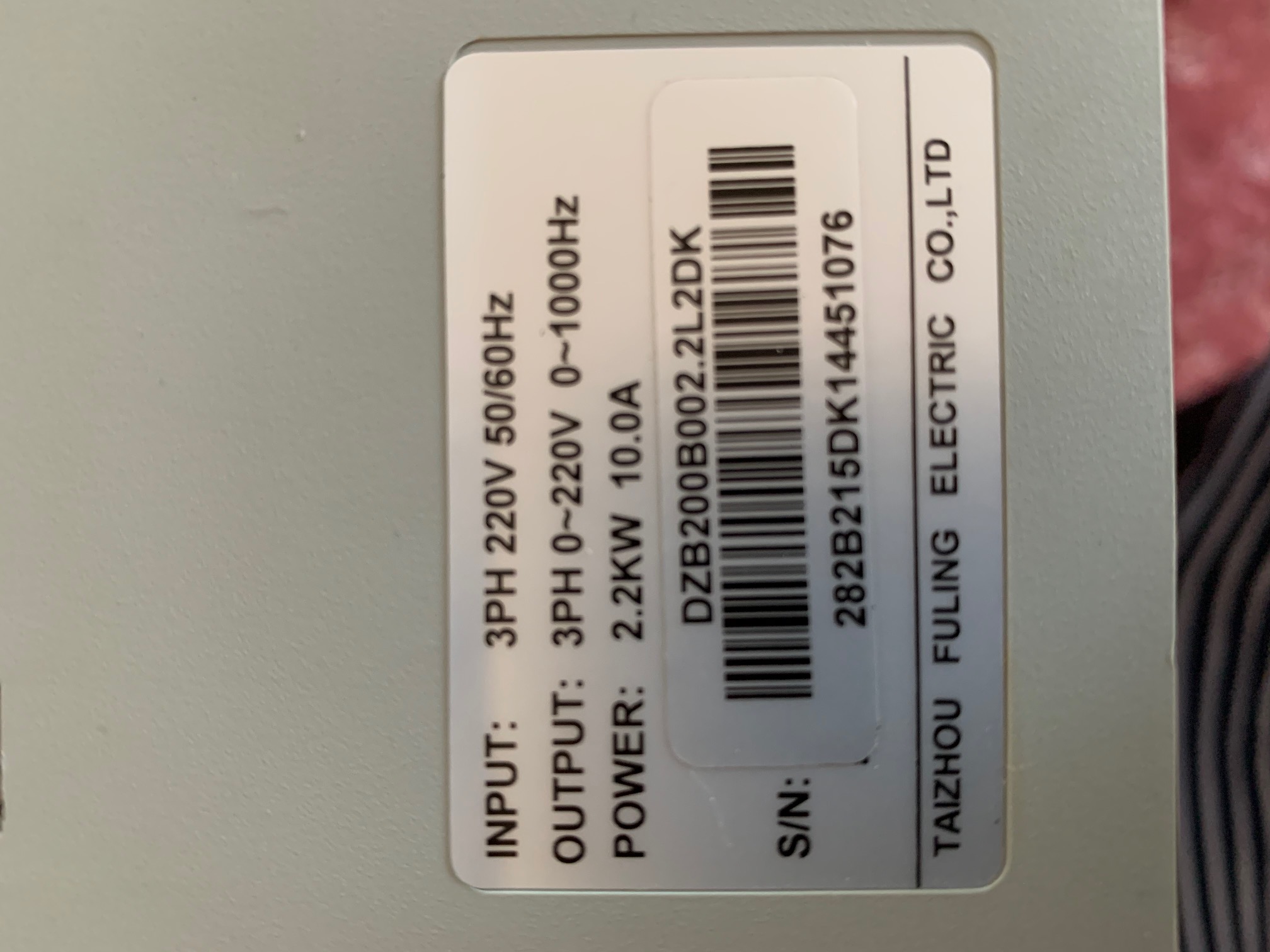

Thanks, I've attached a photograph of the nameplate from the inverter the manual was downloaded from another forum Attachment 28248

From what I'm seeing the VFD model you have is designed for three phase to three phase... The R, S, T terminals are for three phase, if it were designed for single phase input it would have L and N.

That is not correct. There are plenty of these inverters that has a three phase input and you can use any of the three phases to connect the single phase to.
IE. R,S or R,T

No It's not. All the Fulling VFD's and many of the other Chinese VFD's come with R S T inputs and you just connect to any 2 of them for Single phase. They also accept 3 phase input.
I have just fitted the same VFD to single phase supply.
