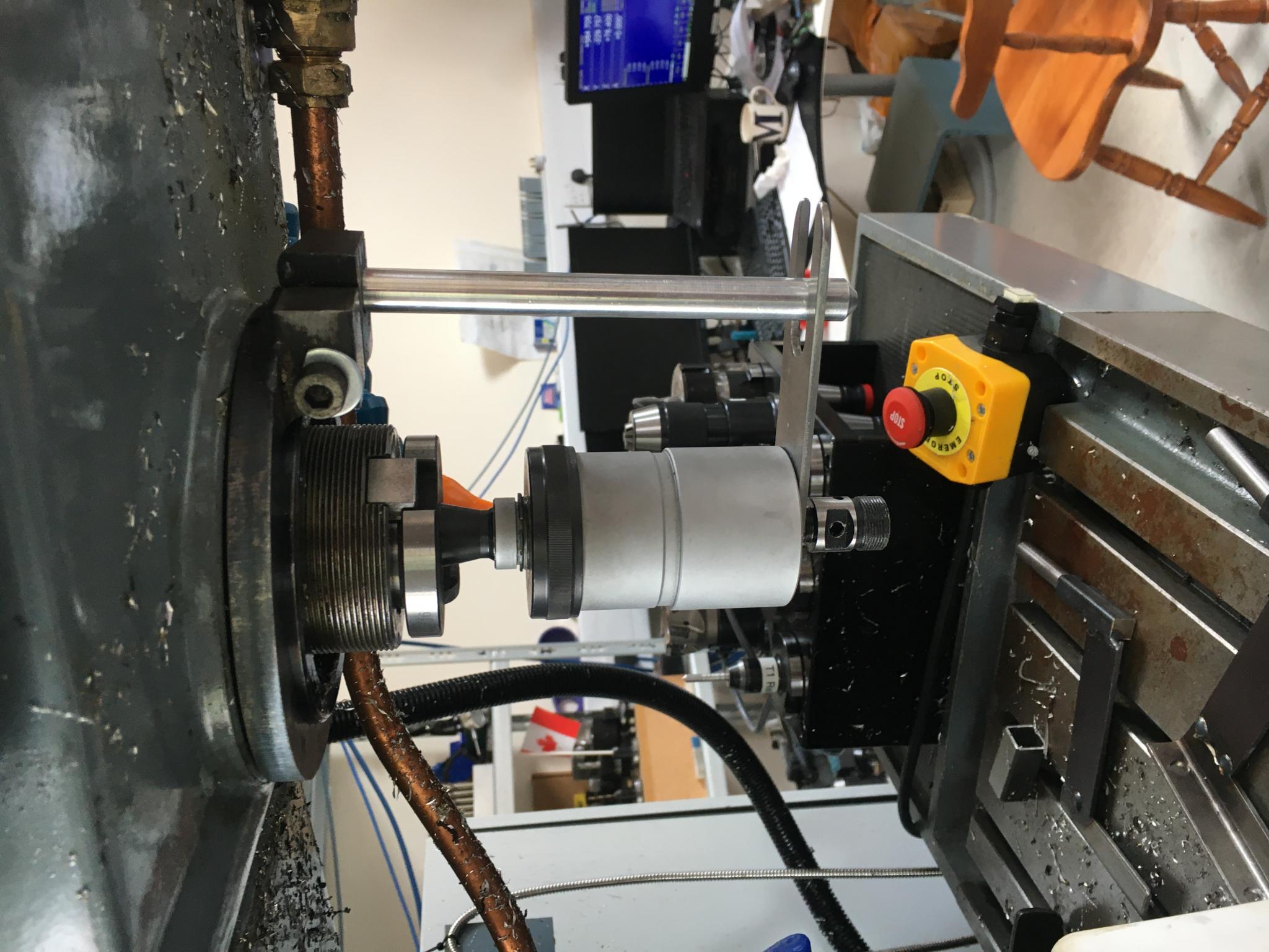

I was up Dawn's crack this morning before the Domestic Manager got up and as a result managed to get some workshop time in.

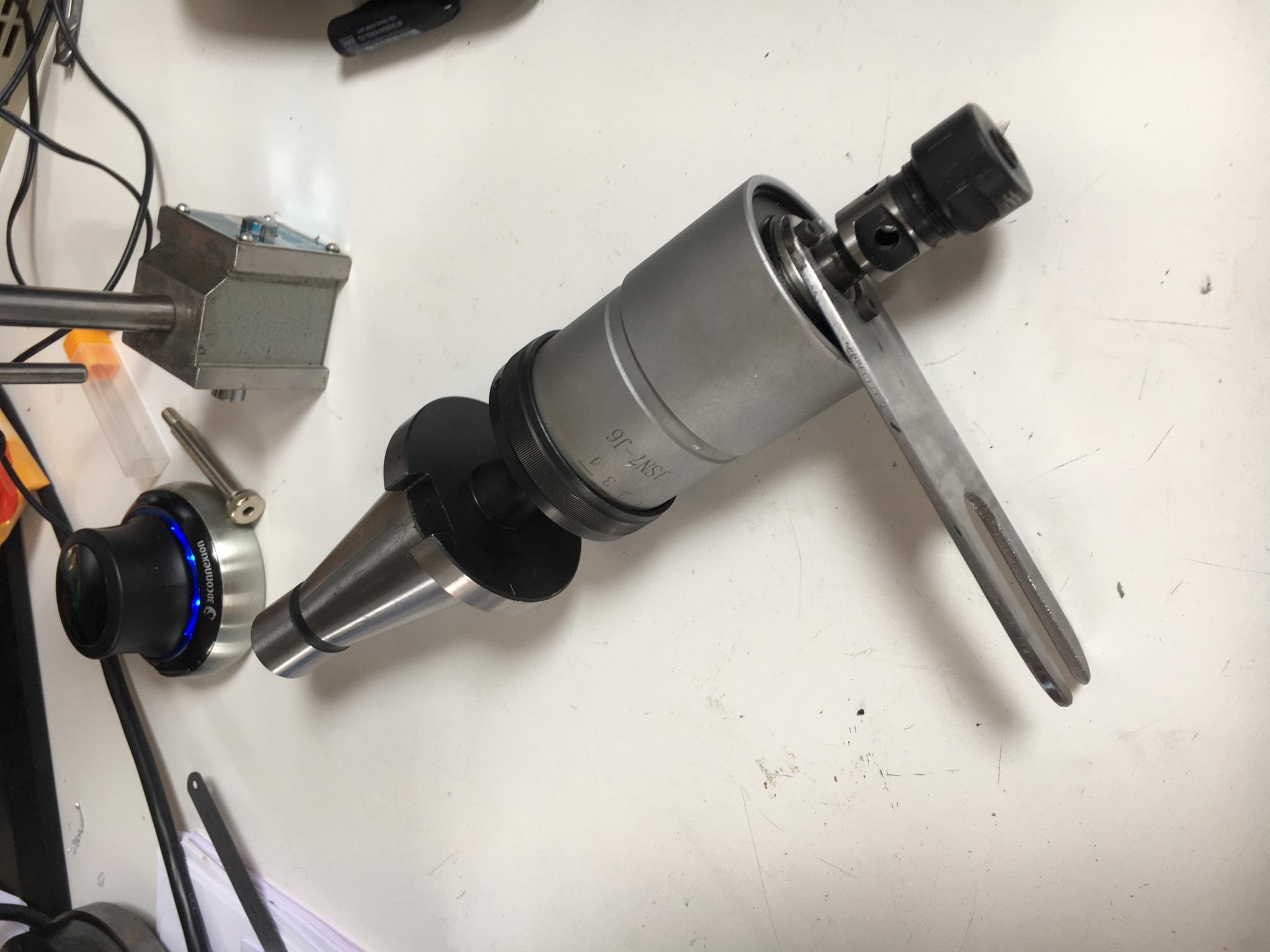

In fact I find there's enough of the quill nose poking out in the parked / homed position to get a pinch collar on there. I bought a spindle speeder from JohnS a few years back that fitted his Beaver mill. I haven't used it yet, as it's imperial (NMTB40) rather than the metric of my power drawbar (ISO40). However, being a speeder it also has a reaction arm and came with a pinch collar thing for his machine. Turns out his quill was a couple of mm smaller than my Shizuoka quill, so I was able to bore it out on the lathe and Bob's your auntie - I have a solution. John must be smiling on us from his workshop up there.
I bodged a short length of steel strip into a reaction arm and I screwed a short pillar into the collar to pick it up. So I can remove the pillar when not in use and the tapping head is otherwise self contained. The pillar is made of loominum as it was ready to go but I may change it for steel at a later date if this works out.
Scarily, I have now got a tapping head ready for action and have come to believe that the CAM might be reasonably straightforward. That requires less talking and more machining. I'll think on that as I waste the rest of the day failing to be a plasterer and perhaps give it a go this evening on a piece of scrap.....
Attachment 28304
Oh good. The photo has rotated during upload.
Attachment 28305

I made some useful progress on this. Although Fusion appears to allow different values to be specified, the post simply generates a G84 tapping macro command, which doesn't pass the retract rate. The alternative, closely related tapping / boring canned cycles all use either the rapid retract or the same as the infeed.
The tapmatic would work but the head has to soak up a fair bit of axial movement as the spindle withdraws at the wrong retract rate. May be fine in most cases but for longer holes and coarser pitches it could get a bit iffy. Other issue for my machine is that the reaction arm collar mounts on the threaded nose of my quill that holds the main bearing in place. During the retract, the reaction arm tries to unscrew it, which wouldn't be ideal if it succeeded.
Given these and the fact that I also had a tension compression head and a fair selection of collets, at this point I changed my focus from the tapmatic method. Although I got it working I've now put it back in the cupboard and may bring it out later for use with the Bridgeport.
