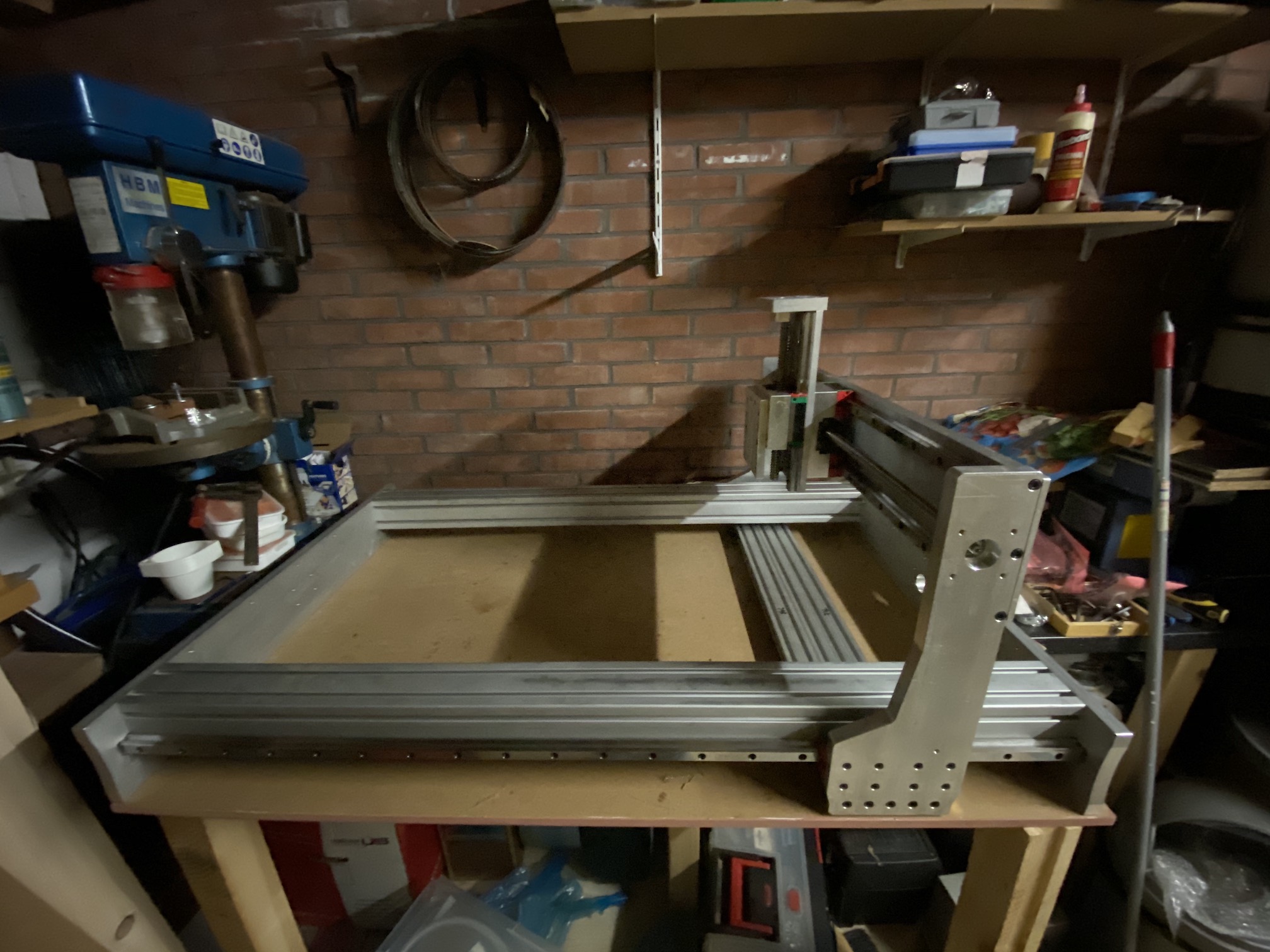

3 Attachment(s)
Re: Xzero Raptor CNC build - linear rail and ballscrew selection
Thanks Andy!

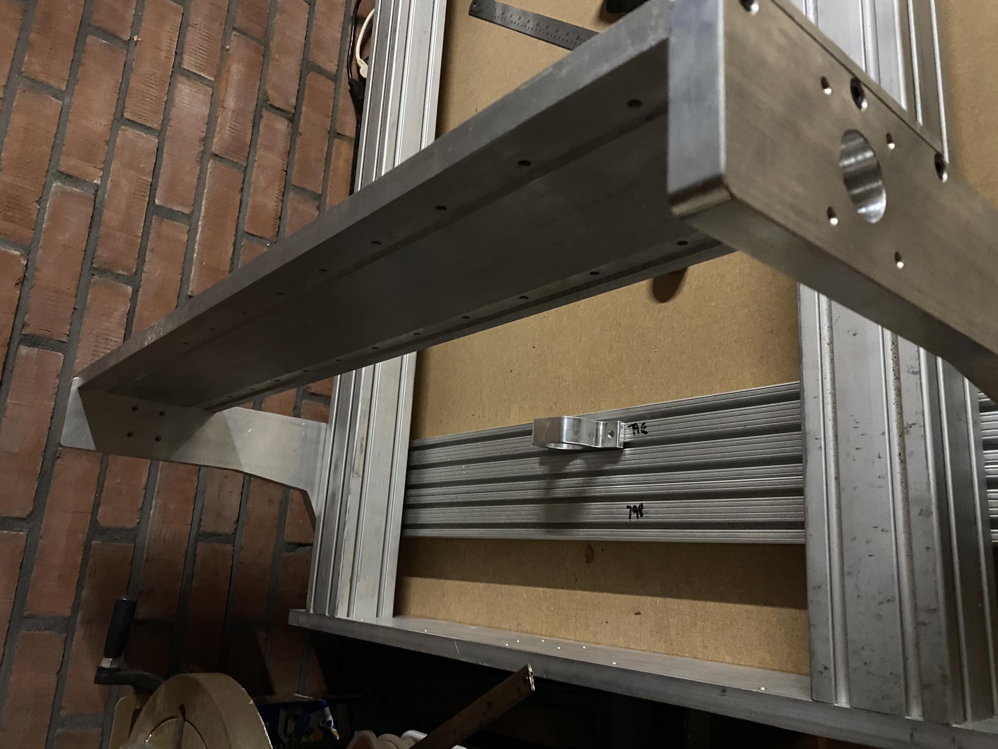

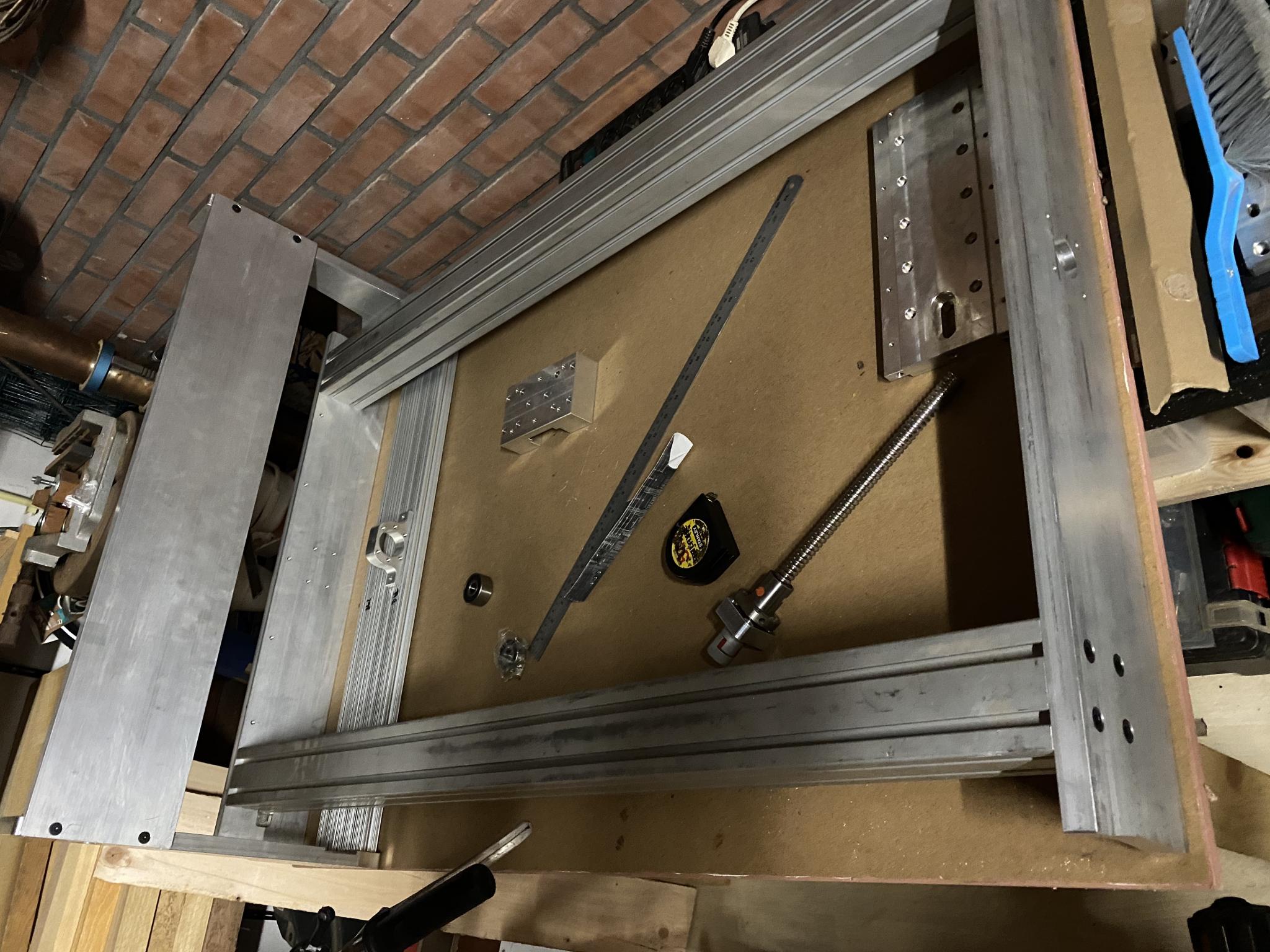

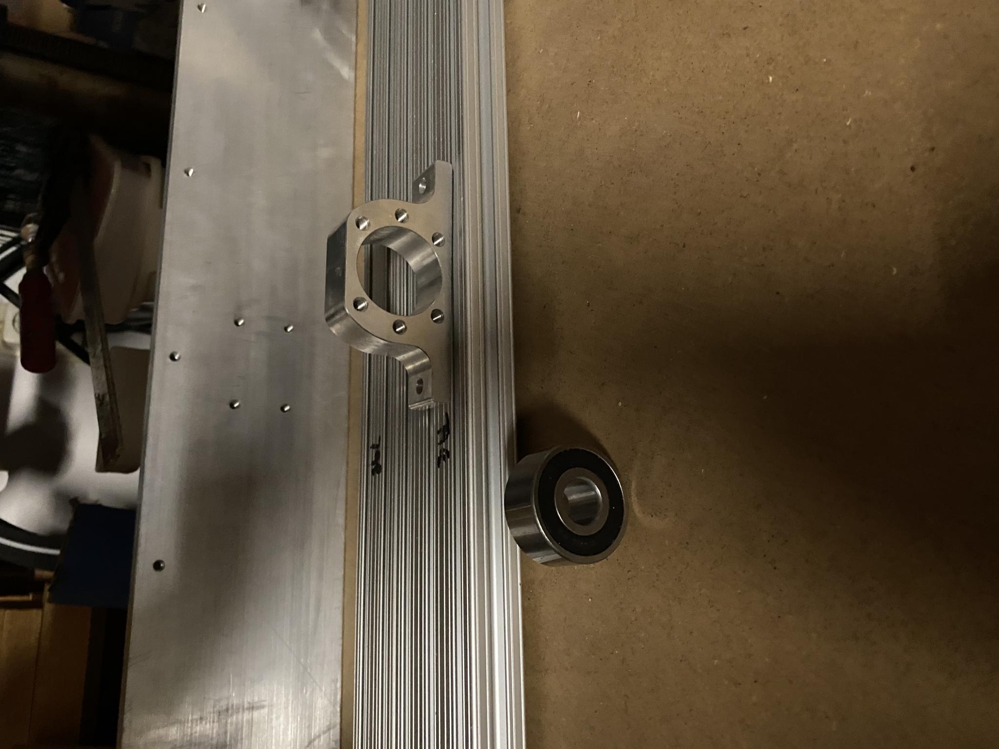

To spice things up and help draw some interest, here are a few shots of what I have - I've put together the gantry and base (just bolted it up, no loctite, no attempt to really level or line things up) just to get a sense of the size of the whole machine, and to get accurate measurements of the clearance between the 8080 profile and the gantry sides to figure out the required linear rail bits and pieces. Once I've got a little further down the road I may start a build log to document things for my future self and simply for fun, and to get some input if/when I get stuck along the way.
Attachment 28450
Attachment 28451
Attachment 28452
The ballnut housing has a 40mm diameter hole, which suggests a 25mm leadscrew to me. That would line everything up with the machined holes in the endplates. Overkill, perhaps, but what would the major downside be other than the need for a lot more power? I need to dig up all the other bits and pieces and pre-assemble the Y and Z axes to see if I even have all the required hardware for mounting everything. If not, that's going to take some interesting reverse-engineering, or re-engineering. The backing plate and uprights on the gantry are milled aluminium, the base (which the ballnut housing is attached to) is 2020 profile, bolted in. Being a woodworker, I'm mostly impressed by how heavy things made of metal end up being. The plan (and mounting bits and pieces) is to fit a Teknomotor electrospindle (2.0 or 2.2kw), which weighs a good 8kg. The Z and Y axis run on 20mm HGR rails with 2 'long' carriages (50mm bolt spacing) per axis, the gantry runs on 20mm rails with 4 'short' carriages (36mm bolt spacing). The Y-axis ballscrew seems to be a 1610 with supported bearings on both ends, the Z-axis bottom is unsupported. The machine is very similar to this one, which is a slightly different variant by the same builder/designer:
Mattia
The only slight draw back is lower acceleration, a thinner lighter screw will accelerate quicker with less power required. Depending on what motors you fit this will be hardly noticeable for the most part unless you are doing lots of point to point moves or short moves like in 3D jobs.
Bigger isn't always better or can be called over kill, because all it's doing is crippling the performance and costing extra. It adds nothing to the machine but weight and money.!
If it was me I'd be fitting 2020.!
I'd also be looking to stiffen up the gantry. Although the Aluminium cross plate may look strong because it's a thick piece of aluminium it's actually not because it's just a flat and unbraced so at that width it will vibrate when cutting, this vibration will transfer into the spindle so will show in the cut quality.
Also don't be fooled into thinking the rails will stiffen it up because they won't and don't. What it needs is a perpendicular brace across the back to make it like "T" on it's side.!

Ok well when I said 2020 I probably should have given you more info to why and how I'd use them, also I didn't know the motors you where using so didn't want to go too far with it. But with you using Servo's then it's even more important, esp those motors so I'll explain more.
I would use a larger pitch mostly so I could put a ratio(2:1) on the screw to reduce the rotation speed, this lowers any chance of whip on longer screws it also increases the torque, thou this is offset slightly by lower torque of higher pitch. A 20mm pitch with 2:1 ratio will give you the same Resolution and speed as a 10mm pitch but half's the screw rotation speed.
This will become more important to you because your using 3000Rpm motors which is way too fast for a long ballscrew and the fact your thinking to use 25mm which have a lot more inertia it becomes even more important.
Also I don't think those motors are powerful enough to handle a 25mm ballscrew with direct drive, or even 20mm for that matter. They are only rated 0.57nm, I've looked at the manual and I can't see any where the peak rating. Thou Often it's 200% of the rated value for a few seconds which means at best you'll only have just over 1Nm for a few seconds to accelerate and de-accelerate the axis which isn't enough for a heavy gantry changing directions at higher feeds.
However, with only 36V I don't think they will be the most powerful things in the world so I doubt they will give you high peak rating for any usable length of time. If they had decent Peak ratings I'm sure they would have stated them, even if just as a marketing tool.
Now If they where 200V 180W or 200W Servos then they would just about be ok, but even still with a heavy gantry and 25mm screws direct drive it would a close thing.!
If it was me and you really wanted servo's then I'd go with proper 400W servo's. 200w would work but you can get 400w for nearly same money.

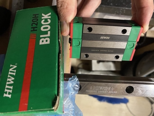

Based on your recommendations, I ordered the rails and carriages from Fred at BST - excellent communication, great pricing and quick turnaround. Time from payment to delivery was 8 days (paid Sunday evening, received Tuesday the following week).

Do you guys lubricate the carriages before putting them into operation? They feel like they're a little 'dry' out of the box, but not sure if that's the ZA preload I'm feeling?
Grease them when your ready to use the machine, there is enough grease inside them for setup etc but not enough for running.
The stiff and notchy feel is quite normal, when greased and in use under weight they run smooth.

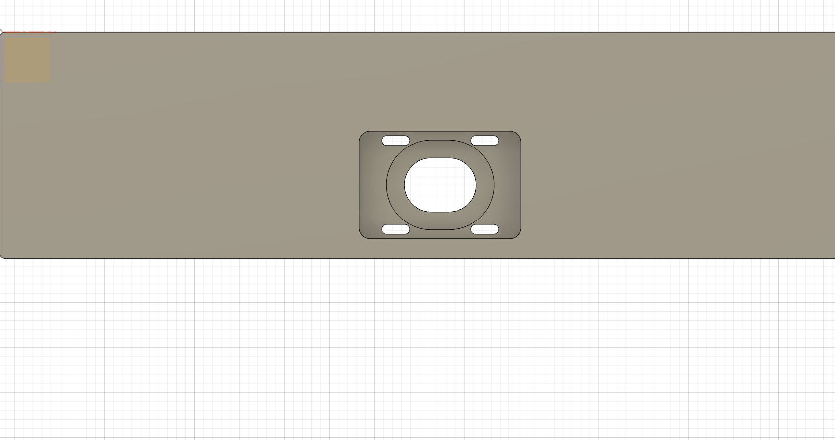

Thanks all! I've dry-assembled the Z axis, didn't get around to the other two just yet. Looking and feeling good so far. I've been dabbling with Fusion360 (not quite 'got' it yet, but working on it) trying to come up with a design for mounting a pair of 200w servos for the x axis (on the assumption that two 400w servos for a gantry this size would be rather overkill).
What I'm considering is mounting two 2020 ball screws inside the frame alongside the extrusion, face mounted to the end frame pieces using FK/FF mounts, having the lock nut on the fixed end recessed into the frame. Then mount a 40 tooth HTD5 pulley on the ballscrew. The idea is to find someone who can machine the end frame for a recessed 60mm motor mount with elongated bolt holes to allow for tensioning the 20 tooth pulley on the motor.
Attachment 28565
Attachment 28566
The way I've sketched it now leaves 7mm thickness for the motor bolts, with a 3.5mm recess for the round flange surrounding the motor's shaft. I'm guessing I should oversize the slots and recesses somewhat since it doesn't need to press fit in place and I'm not sure how tight the tolerances on the average 60mm frame motor are (0.5mm per side, or total? Suggestions welcome). Will this leave enough meat for the motor? Would 5mm be enough as well? How long would you leave the slots for belt tensioning? I've gone with 6mm slots for M5 bolts that are 16mm long. Too much? I'm a little concerned about the clearance at the edge of the hole to the recess for the plate around the shaft. Also need to work out exact positioning for this so the belt preferably does not run across the bolt caps, though an offset mount would mean less leeway in terms of taking up belt slack. Comments on this plan welcome. I'm also wondering whether to start a separate build thread or just keep all the questions here - I'm finding the dialogue very helpful in making decisions!

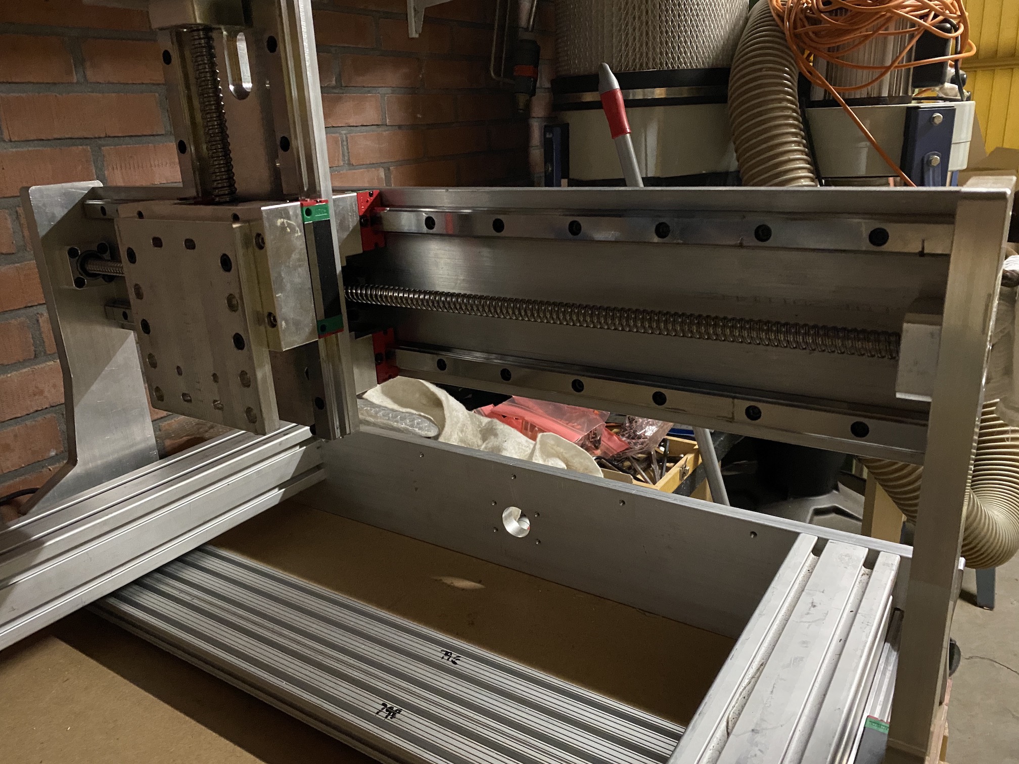

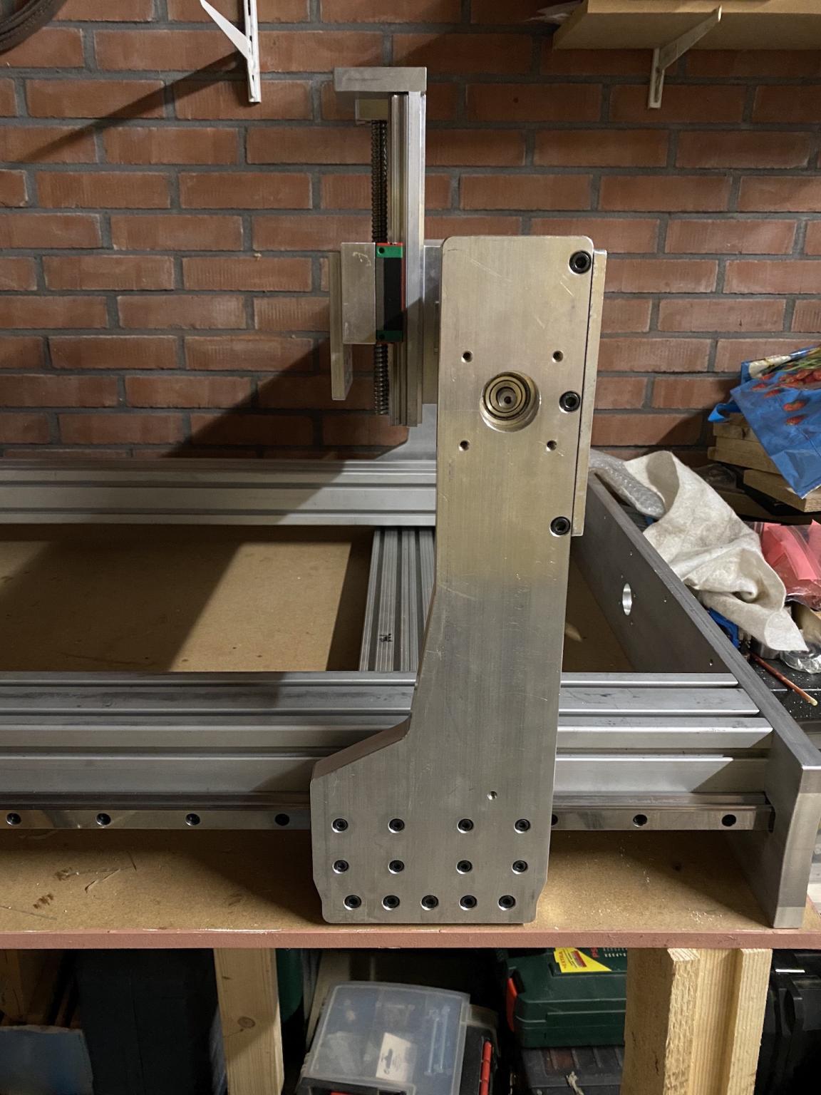

So I've dry-assembled the gantry (all the mechanical bits except for the currently missing X axis ballscrew(s)). I was hoping I might be able to convert at least the Y axis to 2:1 belt drive as well (placing the motor on a bracket on the to-be-built gantry brace) but the ballscrews I have feature some pretty non-standard machining. Both ends are simply turned down with a retaining C-clip in a groove on the floating end, which is a nice snug fit in the holder; the fixed end is apparently only 'locked' in place by the flexible coupling, no retaining nut of any kind. Since the coupling can't fit through the machined holes as is (the bolt stick out just a little, need to file a small corner into the frame so it can pass), the Y axis is particular simply slips back and forth. The fixed ends do have a tapped hole in the end. Not very reassuring in terms of being able to adjust for backlash.
Attachment 28609
Attachment 28610
Attachment 28611
Thoughts? I guess this works well enough considering there are quite a few of these machines floating around out there, but it isn't super reassuring. I'll use 'standard' FK/FF machining and supports for the X-axis. But I may request a quote for a new Y axis ballscrew at least.
