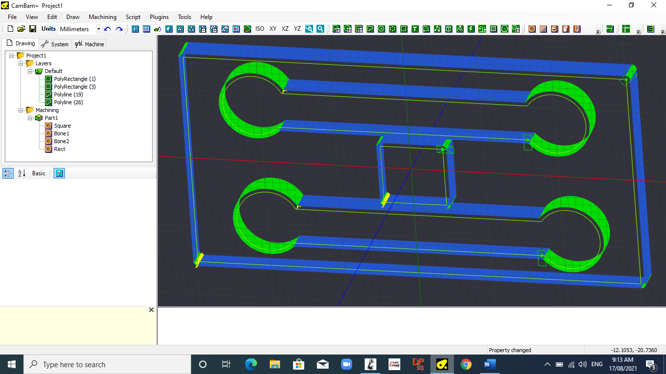

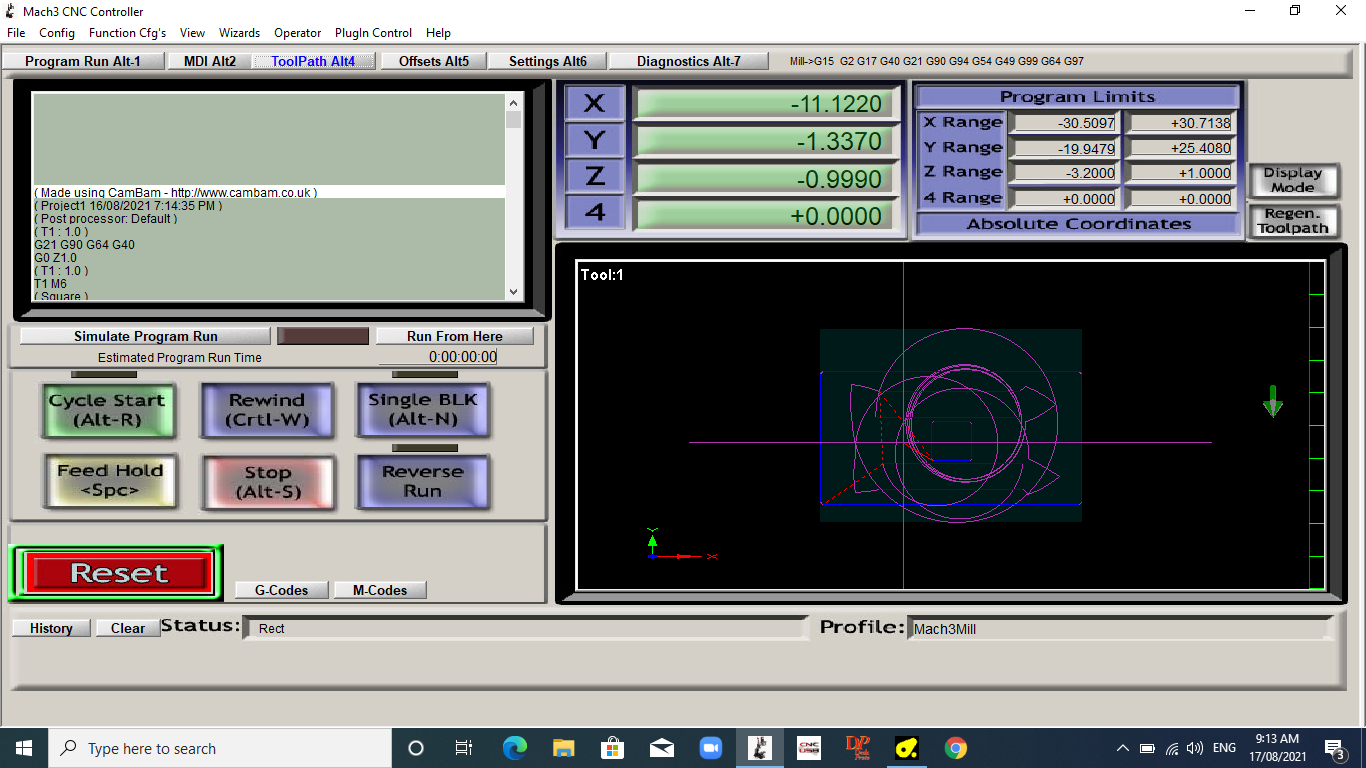

Hello, I am new to CAMBAM and having an issue whereby Toolpath movement get executed on stock when loading GCode on Mack3 Attachment 30338Attachment 30339

Hi Wael
Sounds like you may be suffering from what are known as "Crop Circles " A few of us have been caught by them and a search will probably turn up some topics (worth a read)
In Mach, go to config / general config /
In Arc IJ mode you have the options of abs, or inc . Whichever is now selected, choose the other, then try loading your code again
Re: Cambam forum
Hello dear John,
I do not know how to thank you, it is working by now. have a great afternoon ahead.
