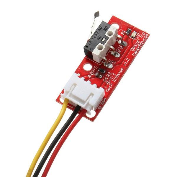

I bought a set of these switches (based on the recommendation of Cosmo Channel); https://www.banggood.com/10Pcs-Geekc...r_warehouse=UK

The switch document says that;
"Red line connecting VCC (ramps of +)
Connect the black wire GND (ramps of -)
Green line connection Signal (ramps of s)" - which I can't say that I understand.

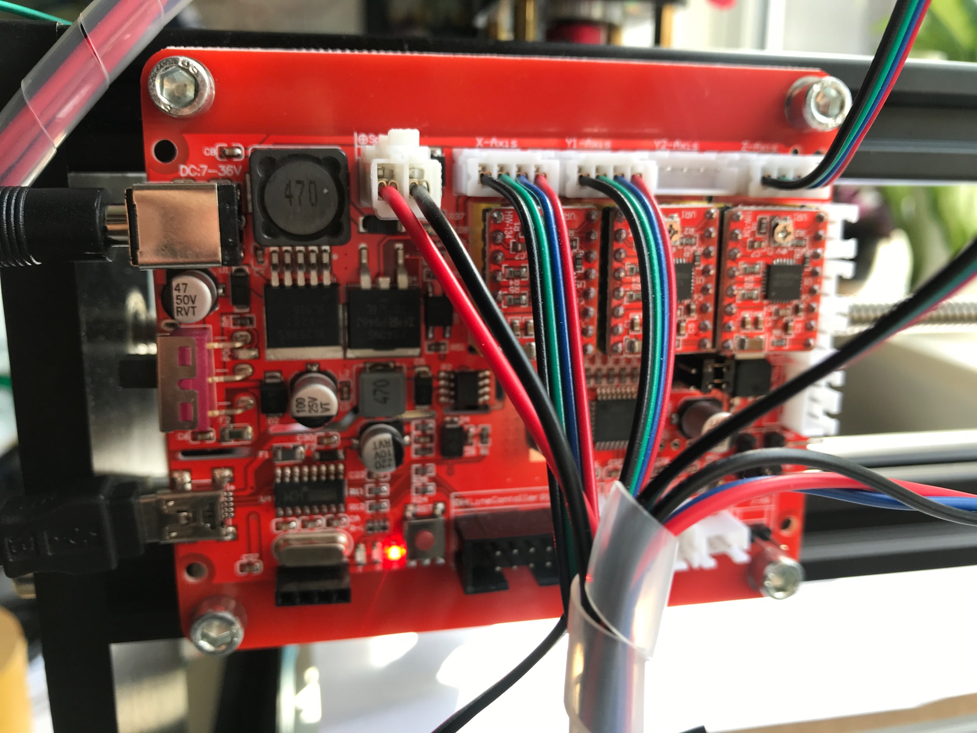

Attachment 28567Attachment 28568

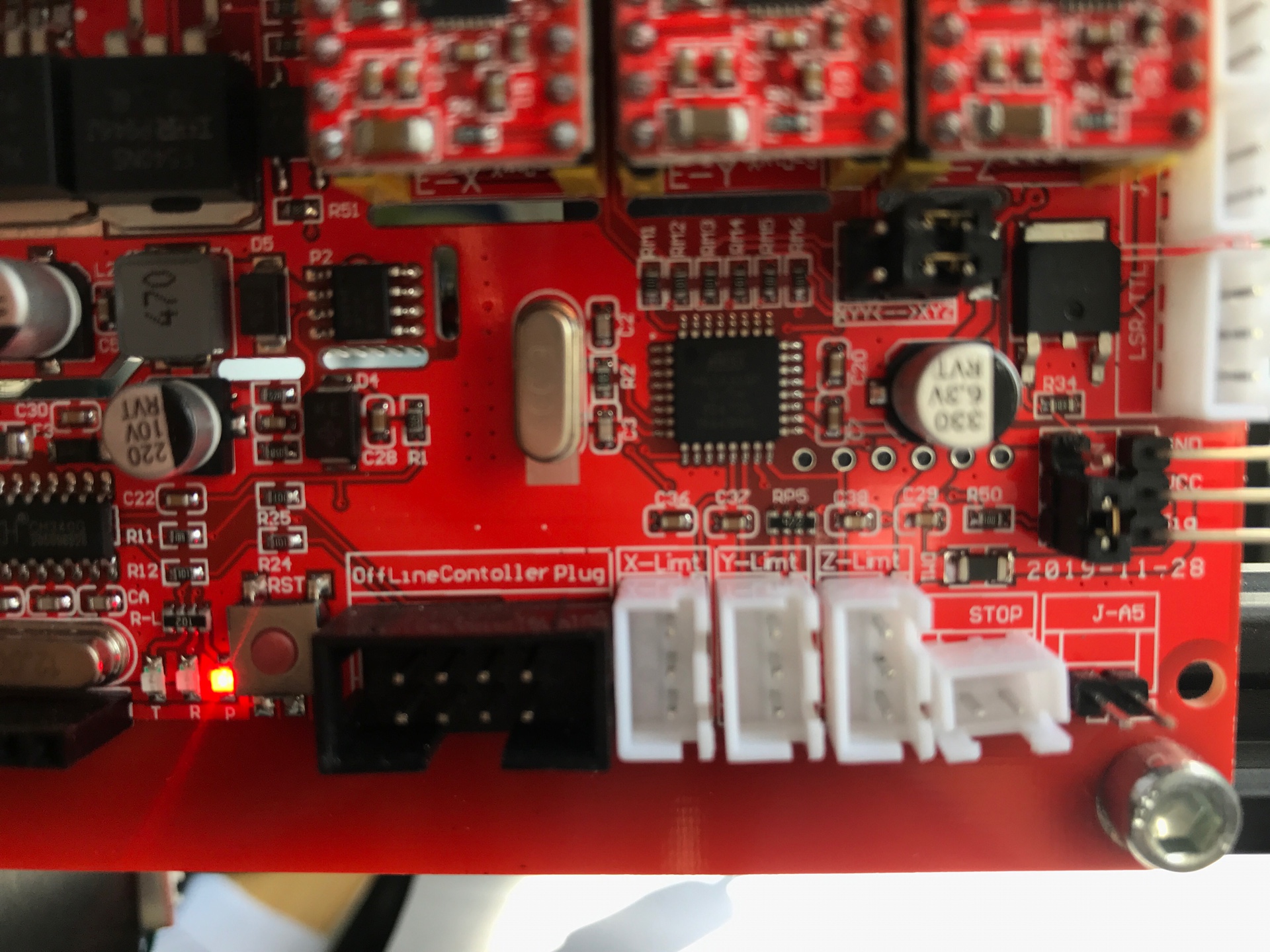

Here's a couple of photos of the controller board, not sure what else would be helpful to provide.

The limit switches on the control card should have 3 pins - get us a photo of that, or just review what you've done with the above in mind. I wouldn't power the machine until you've done that.

I've attached photos showing the relevant part of the controller board.
Attachment 28569
"Green to +, black to -" - yes, this is how I had it previously (and red to S). So it perhaps seems like a simple case of having put the plug on upside down onto the controller board?
Attachment 28570
This is the actual switch I have (though just to add to the confusion, it's shown there with yellow in place of green, black and red are shown correctly).

Yeah, those connectors provided with the switches aren't polarised - Orientate them with red=+, black=-, green=S. Ironically the connectors on the controller are polarised (different connector) so blame the accountants for penny pinching.
You shouldn't have damaged anything... much (perhaps lifed a microswitch or two), provided the PCB has survived.

Re: Help requested - installing end stop sensors onto my chinese 3018 Pro
Thank you - the connectors to the board can be plugged in either way, so it was a simple enough job to turn them around. It now seems to be working as I think I expected - when I'm connected (using UGS) and I manually drive it into any switch, I now have an error returned;

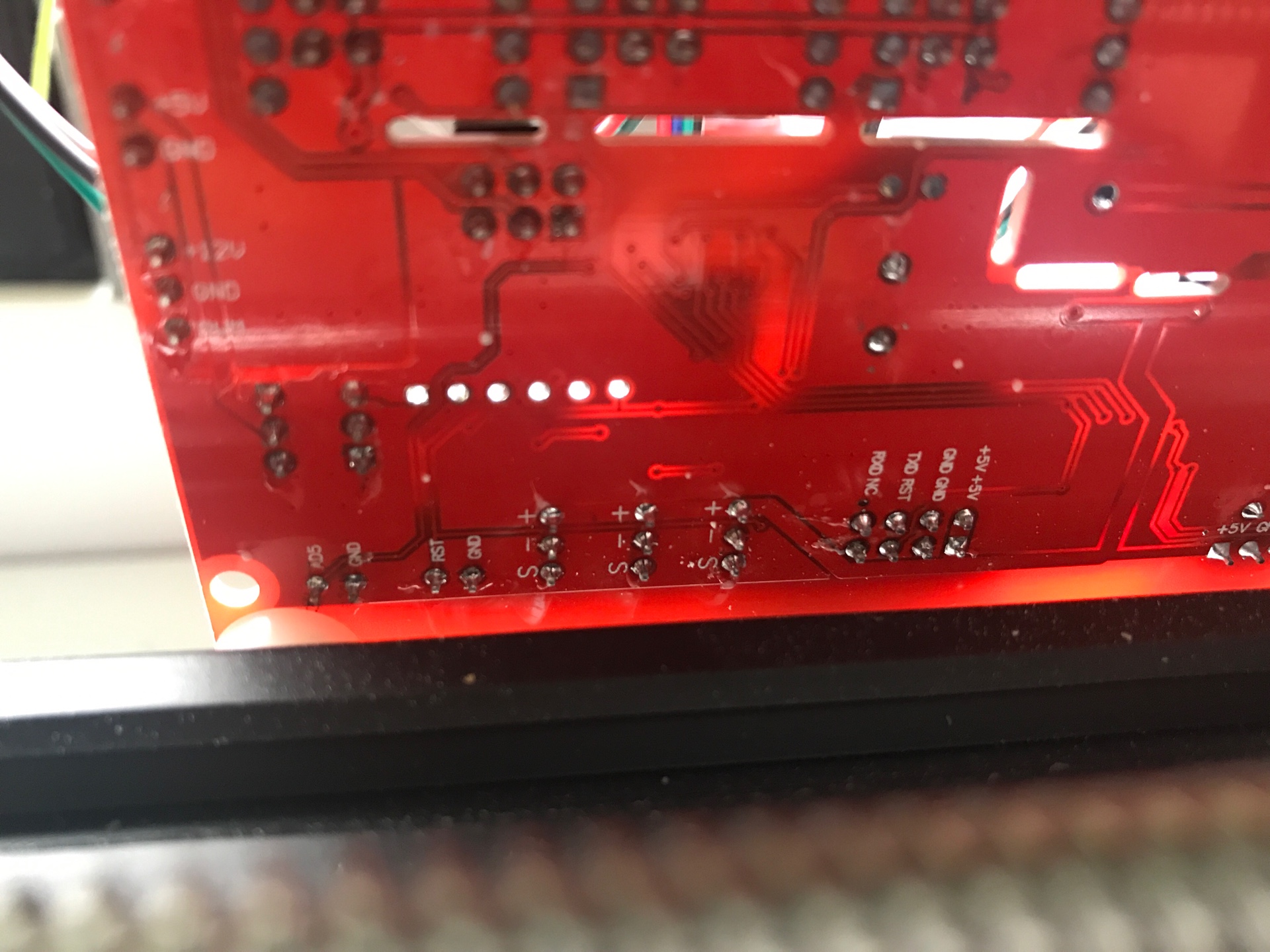

My issue is that the labels on the board mark the limit switch connector pins as X+ve, common and X-ve.
Attachment 29224
This suggests to me that one pin is for the limit switch at the positive end of travel and the other for the negative end.
Against that I have now got one switch connected for each axis and they all work fine.

Because you have a Gnd then (+) / (-) I would be confident it's (+) limit and (-) limit. But it's easy to check, just connect Gnd and either + or - wire to one switch and flick the switch and it should show on the screen (-) Limit triggered or (+) Limit.
What control software is are you using.?
What switch type is it.?

Here are some pics of the switches I have plus I found the actual switch component from Hiaihua online.
Attachment 29227
Attachment 29228
Attachment 29226
The switch complete does have an LED which lights up when the switch activates.
I have plugged in 3 switches - one for each axis - with the 3 wire connectors/cables supplied with switches and they work fine. I just don't know how to connect the remaining 2 switches at the other end of the axes.

The Banggood images confuse the hell out of me - they've mirrored one side of the board. Never mind.
JBaz, have you access to a multimeter, and if asked to measure resistance across the pins of the limit switch board do you know what to do?
(What I'd ask is to measure the resistance from white-to-red, and white-to-black, for the switch in the not-pressed state, and in the pressed state... 4 readings in all).
(My confusion is with the BG images apparently showing the NC contact to sense, and the NO to ground - that's... peculiar... at least with a Sunday brain). Ultimately what others have said is correct, and all we're looking to do is wire switches either in parallel or series, but I'm being (too?) cautious trying to make sure there's no risk of shorting anything out with different switch positions.

Doddy - using the multi-meter, when the switch is in the not-pressed state the white to red reading is zero and the white to black is 4.75v. With the switch connected and in the alarm position (led on) both readings are 2.25v.
HOWEVER (!) triggering the switch is no longer causing the status in gbrlControl to go to Alarm, although the console is still showing ALARM: Hard limit etc and I have to go through the reset process.
