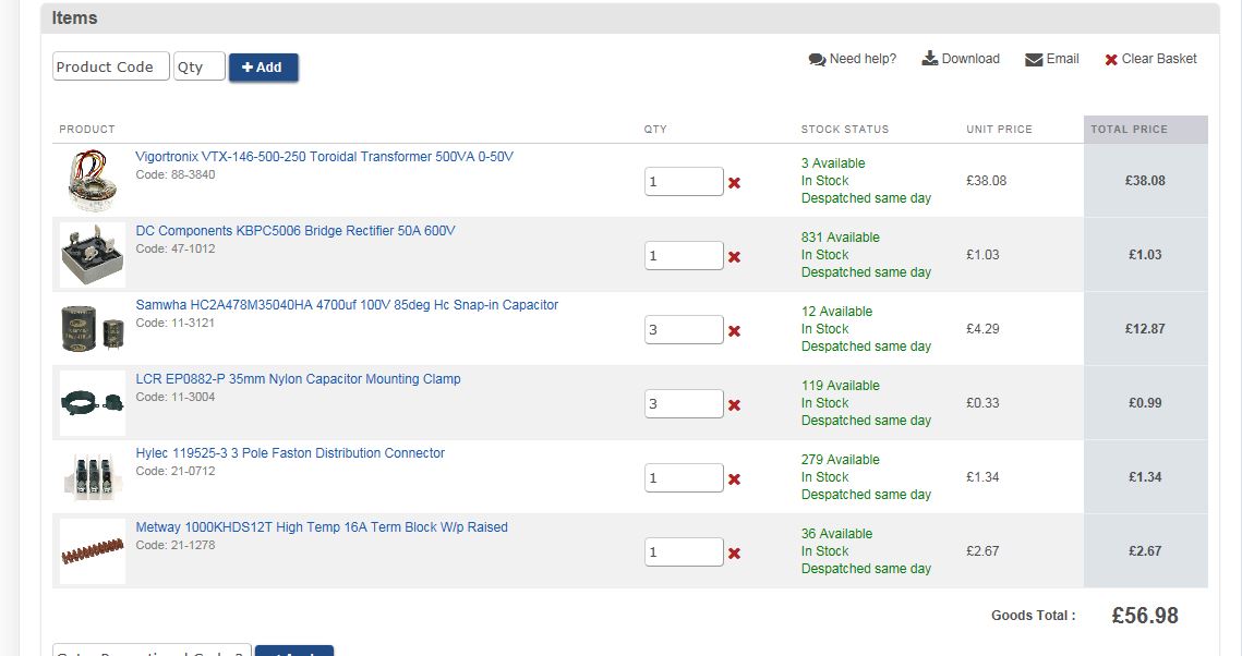

1.which controller do you recommend I would like one that's able to run on windows or a MacBook Pro. I believe ethernet is the most stable way to run but I am not sure.
2. Can you point me in the right direction to a circuit diagram for the power supply.

Joe on here as done a nice vid
https://www.youtube.com/watch?<br />...zD30sZjtp_VyqYAttachment 28654

Follow Clive's link to Joe's setup.
