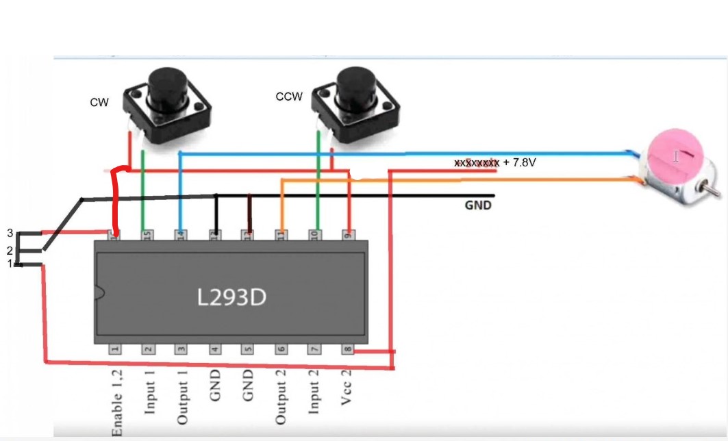

		L293D used to reverse motor direction 7.8 vdc
		I have a setup that uses 2 x 18650 3.7V 4000Mah batteries in series ( producing 7.8Vdc. Im trying to control a 6-9V dc miniature motor with 2 buttons 1 button to CW and the other to CCW
Ive been told that a L293d will work but ive blown up 5 so far
I think the problem is im imputing too high a current into the Vcc1 (pin 16) which calls for 5V (max 7) attached is a diagram i found with basic setup I would appreciate someone confirming the setup IF I REDUCE INPUT TO 5VDC
Also if i connected something to the end of the + 7.8v feed to reduce the current to 5V .
Im not electronics savvy so appreciate any help
Thanks Richard

		You will need to put the 7.8V onto pin 8 (VCC2) and all your switching and VCC1 have to be 5V. So you need a LM7805 voltage regulator to derive that 5V.

		No, you don't need a separate input, you can connect the 7.8V from the two batteries to VCC2 and the input of the LM7805 (pin1). Pin2 connects to GND and connect the out put (pin3)  to VCC1 and all control  inputs through the switches.
		Re: L293D used to reverse motor direction 7.8 vdc
		Hi so as drawn now OR does the feed go straight to 8 and no feed to 9 ? if so does the common power for switches come off pin 9 or am i wrong again. appreciate the help
		5V output of the lm7805 goes to switches.
		Thanks very much so im actually switching 5 v thru the switch but the output to motor 11 14 is the 7.8V ?
		Apologies - I started to reply to this earlier before work but somehow lost my post. This is an abridged version:
I'd be concentrating in the first instance on establishing the logic supply (the +5V) to the L293 - without this you're going no-where. Add decoupling caps if you've not done so already (ref. the LM7805 datasheet for detail). If you can, measure the current drawn by the L293 - the standard 7805 can source 1A, and will current limit somewhere above that (by dropping the V-out). The L293 datasheet suggests the logic supply should be 60mA, max - above this and you have a problem - either wiring, or a knackered L293. Any metal tab on the 7805 is internally connected to common (ground/0V) - so take care that this doesn't short to something that it shouldn't.
I wouldn't even worry about the motor wiring etc until you stabilise the 5V logic supply.
If you find you keep blowing the L293s, I would consider removing the motor and channel-by-channel testing the circuit/switches with a DMM to ground.
The circuit is trivial (I mean that in the sense that there's little to go wrong) - it should be straightforward to diagnose with the above. If you report back we can take it further.

 The caps should go as close as possible to the input/output pins on the 7805 - you might find that it's possible to mount them physically to to the 7805 pins.
The behaviour of the caps is the stabilise the operation of the 7805 - which can go into oscillation in the absence of these - that is bad (I'm not suggesting that's your problem - although I could imagine you reading a different voltage on a DMM than 5V if the 7805 goes into oscillation). If I've time tonight I might try testing a 7805 with/without capacitors to observe the behaviour.
The 7805=5V dropping to 3.8V on connecting to Pin16/L293 is very significant, and I'm thinking that's the thing we need to fix.
Can you take a photo of the electronic assembly - I just want to eyeball what you've done wrt the schematic, take out any uncertainty on my side. Also, the underside of the board (I'm assuming some form of breadboard/vero board). In particular there I want to make sure that you've isolated pins on the same row on the L293 (1-16, 2-15 etc).
Re "Inverting" - the only reference on the datasheet is the non-inverting inputs on the L293 device. This simply means that if the input voltage is "high" (near 5V) then the output voltage will be "high" (near VCC2). If the input voltage is "low" (near 0V) then the output voltage will be low (near 0V),
The L293 is a suitable device for what you're trying to do.

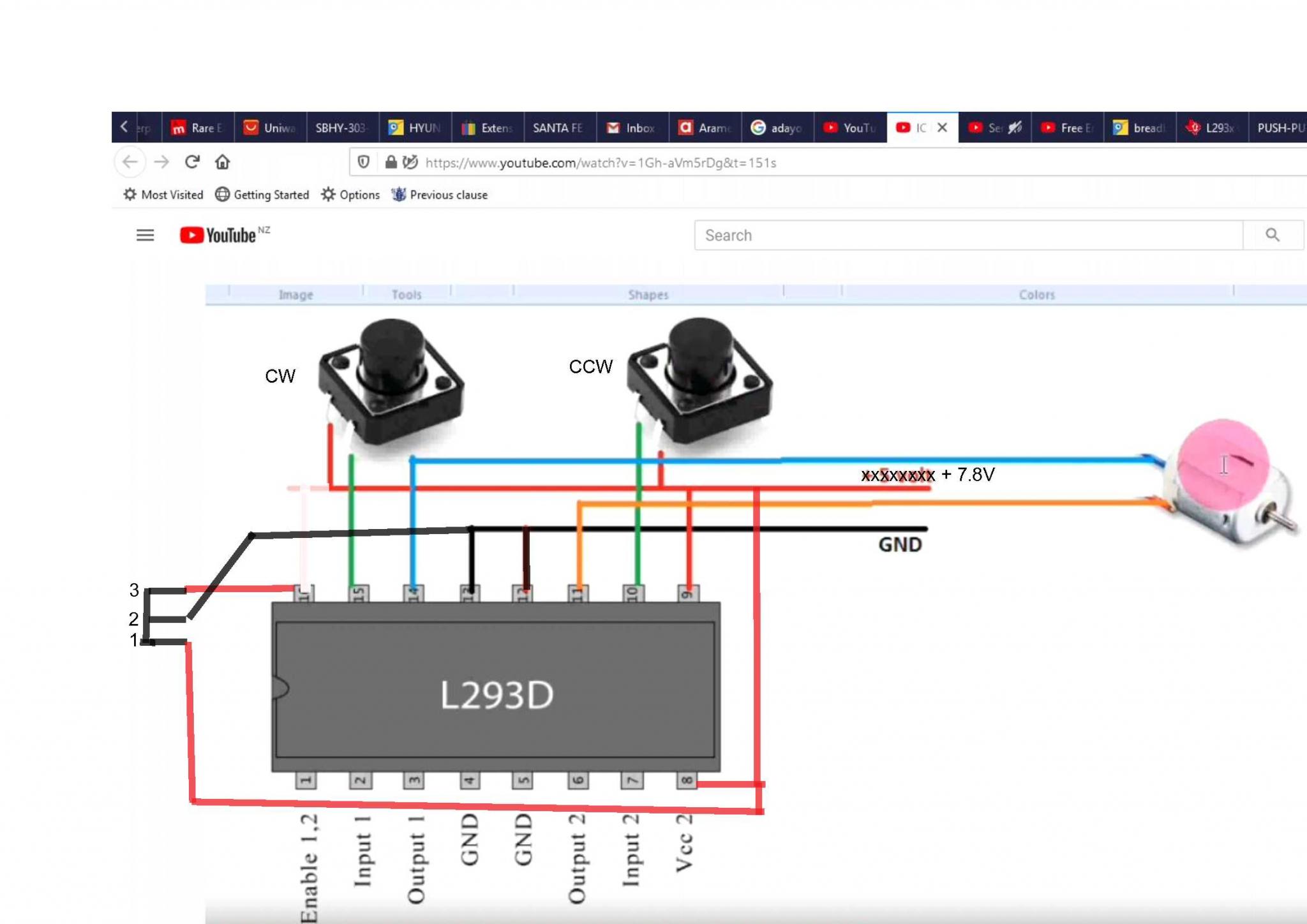

		Doddy
im not using any breadboard etc im soldering directly to the L293d pins i dont physically have the space to have a breadboard
Ive been super careful to keep the heat down and not shorting with the solder ( between pins) that said the photo would not be clear enough
ive recreated with 5 no L293d and 3no  lm708s and get identical readings and problems so dont think its a soldering problem
I dont understand why the power feed from 16 is looped thru push button + to pin9
is the drawing fundamentally wrong?

 Pin 16 (VCC1) is connected directly to Pin 9, according to your diagram. Pin 9 is the 3,4 enable pin - if HIGH (5V) then the outputs 3,4 (pins 11, 14) are enabled. if Low then outputs 3,4 go high-impendance (Read: OFF). So what is concerning you?
The other contact of the switch (marked CCW in your diagram) goes into the pin 10 (input 3, "3A") which drives through the driver chip one side of the motor to either +VCC2 or GND.
Describe the behaviour of the 5V supply - does it drop to 3.8 V in response to a button press?
EDIT: Just a thought as I was about to leave the house... wiring directly to pins, as far as I understand from your description you're completely disregarding the thermal requirements for the L293D - read the datasheet.
