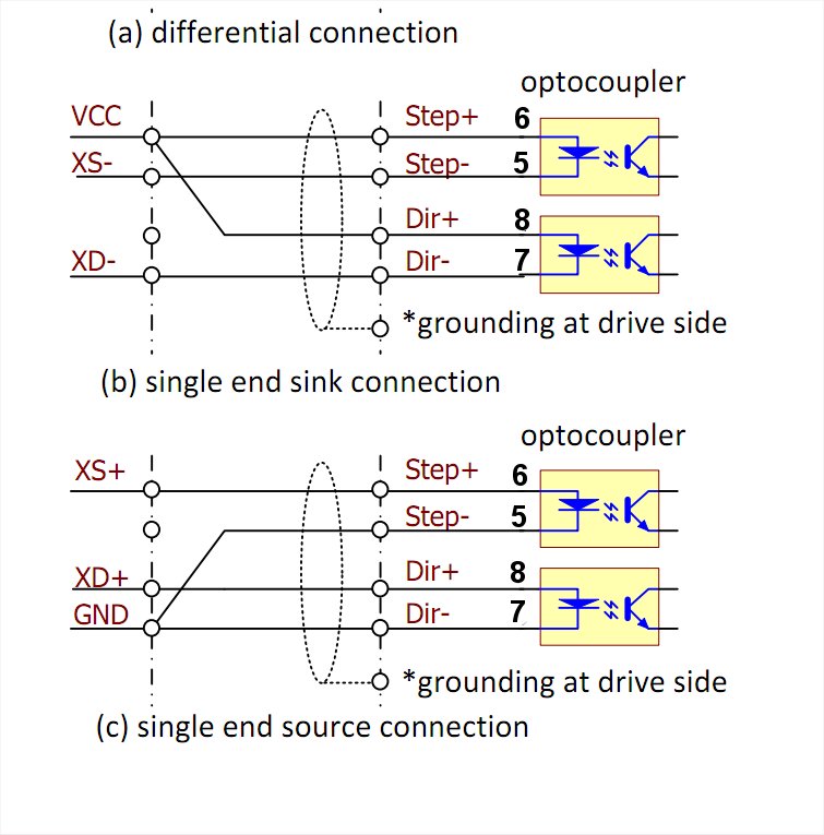

Edit: just found a better diagram (helps me understand) in the MB3 documentation:
Attachment 28744

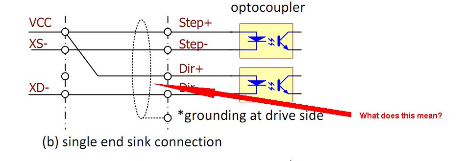

I added the pin numbers from the Panasonic doc, does that look correct? How can you tell that pins 5, 7 are ground? (the scan shows order from top down (6, 5, 8, 7) as per my latest attached diagram.
Do I connect a dedicated 24v to pin 11+ and 28- ? For single ended? and not differential? Both or none?

One thing that sort of confused me when i first looked at the diagram - twisted pairs? You mention connecting Step/Dir pins to 6/8 and ground to 5/7. The diagram is confusing, it shows a single pulse going in e.g Pulse A and it terminates on 6 - 5???
The differential lines are - not clear admittedly - intended to show the interconnect between your control system (MB3 in your case) and the servo controller.
Attachment 28744

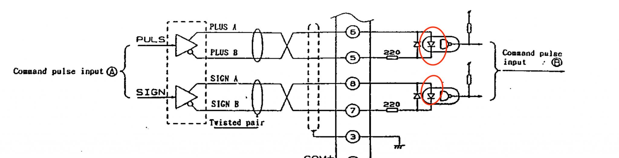

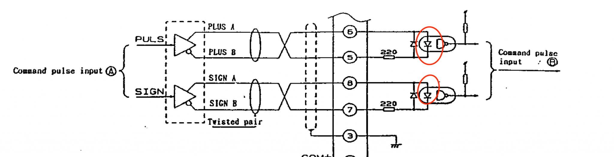

Attachment 28745
The bits circled in red - these are the LEDs of the opto-isolator inputs. The lead connected to the triangular bit is "+", the bar crossing the pointy bit of the triangle is ground. Hence - ground is 5,7 and the signal positive is 6,8. To the immediate-left of these are similar symbols, but reversed - these are normal (non-light-emitting) diodes intended to protect the LEDs from a reverse voltage as would be presented by a differential drive (LEDs are susceptible to damage like this).
Also, confusingly, over on the left - the triangular line drivers - the bottom output wire has a little dot on it - denotes an inverted signal. So "PLUS A" (ignoring typo) is PULS - non-inverted (active = high), and "PLUS B" is PULS - inverted (active = low). You could interpret (wrongly) the cross-over in the wires as the wires swapping - that's not the intent of the diagram - it's supposed to show an indeterminate length of cable. The drawing is designed to confuse.
EDIT:
12-24V between pins 11 & 28 - these are required for the control inputs shown, nothing to do with step/dir but likely required to provide control to the driver.

Attachment 28745
EDIT:

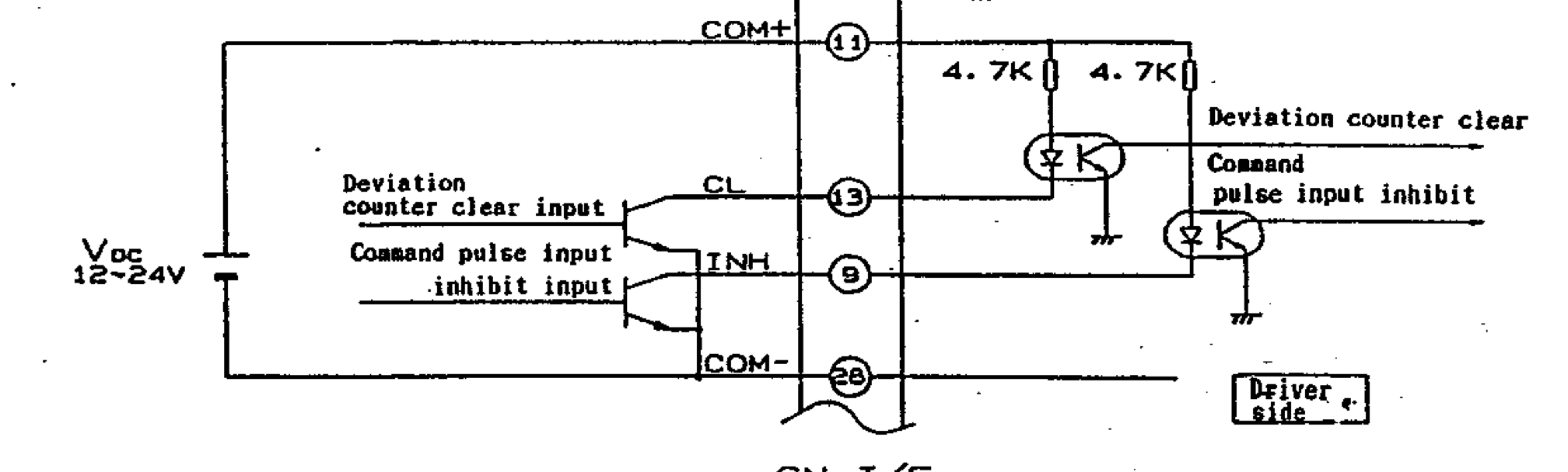

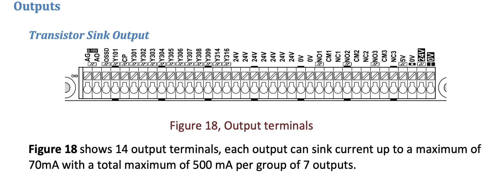

3 Attachment(s)
Re: MSD043A1XXV Panasonic AC Servo Driver 400w - MB3 connection help
This image refers..
Attachment 28746
This is an example of two open-collector drives from the "Deviation counter clear input" and "Command pulse inhibit input". This is just an example intended by the author to show how to switch the input. The real needed behaviour is shown inside the servo controller - there are two corresponding opto-isolators, each with a 4.7k resistor for current limiting. The anode (+) of each LED inside each opto is connected through the resistor to the 12-24V supply, and the cathode (-) is switched to ground by the input circuit - depicted as an open-collector driven system. That works, and should work well. If the driving BJT is ON, the open-collector output is drawn to ground, which allows the LED in the opto isolator to switch the internal gubbins. If the driving BJT is OFF, there is no current path for the opto-isolator LED, and the switches off the internal gubbins.
You are not required to drive using an open-collector output, but you are required to provide a current path to ground (or something substantially lower than the COM+ pin), you could use a push-button connected from the input to ground perfectly well.
More likely, you'll be using the MB3
Attachment 28747
"Sink" refers to the ability to allow current to "sink" to ground. If you see the term "source" - it refers to the ability to source current from the +V supply.
Attachment 28748
This shows that the MB3 has a number of open-collector outputs available to you.

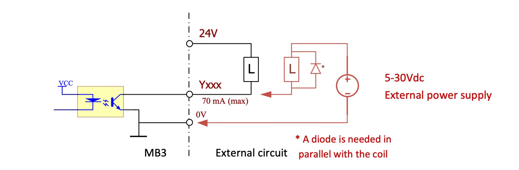

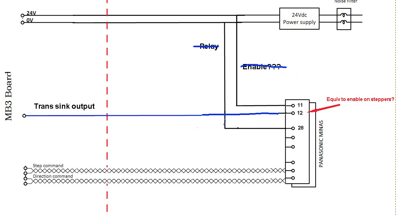

2 Attachment(s)
OK - saw another diagram in the MB3 documentation that I *think* helped me. This is what I have:
Do I need more? Or should the the 24v going to the controller be sunk to a ground like the cabinet chasis frame (with a relay)? Like the old 2 stroke motorbikes?
Attachment 28751
I am also struggling with:
Attachment 28752
Any help is really appreciated
Edit: I will be adding diodes to the 24v supply to driver as wrong polarity can damage it apparently.
2 Attachment(s)
Your diagram is a little confusing - thoughI think I know what you're trying to do.
It's F1 Qualifying on TV just now - and hour for me to snooze, I'll sketch something for you after that.
The indicated dotted ellipse - that's indicating a screen on the cable to reduce EMI (often a braided sheaf under the first layer of insulation).

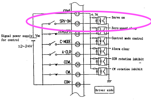

The question on pin 12 - "Equiv to EN on servos" - kinda - but it's more the command to the servo controller to start/enable the servo. It looks to be pulled low to be active. Page 11 indicates the internal equivalent circuit - another example where you can use the open collector output from the MB03 directly (no need for a relay).
EDIT:
This is how I'd be connecting the MB3 to the servo controller...
Attachment 28757
So, you have a common 24V supply to the Servo controller and the MB3 card. That's all good. The internal circuitry of the Servo controller, as page 11 ...
Attachment 28760
Shows that pin 12 is connected to the side of the internal Opto isolator that needs to sink to ground to enable it - that's the signal path that you're providing with the MB3.
So far you've discussed the servo enable line, step and direction signals, there's every chance you'll have to look at some of the other inputs as well, or you may need to ground them (read up about each of them).

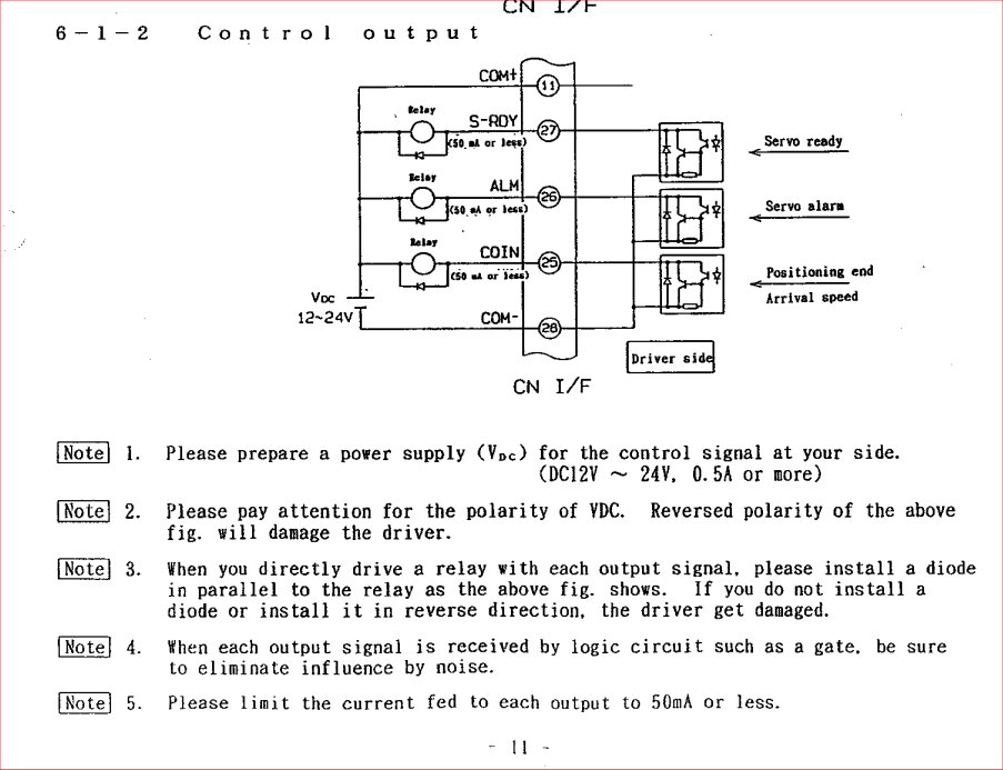

As per pic... as I was going to add a relay to control what I thought was the equivilent of the Stepper "Enable" I was going to do the same
I was looking at note 2 and 3
Attachment 28761
Okay, if you'll forgive the explanation. The information in the manual is accurate, but again, doesn't particularly try to educate the reader. I think you're looking at 2 + 2 and getting 5 - please don't be offended by that.
Note 2 in the diagram ("Please pay attention for the polarity of VDC. Reversed polarity of the above fig. will damage the driver") is to ensure that you connect 11 and 28 to +V and ground, respectively. You *could* put a diode in series with one of these, but to get the diode right you pretty much have to have wired it correctly anyway. So to me the diode is a little superflouous.
Note 3 in the diagram ("When you directly drive a relay with each output signal, please install a diode in parallel to the relay as the above fig. shows. If you do not install a diode or install it in reverse direction, the driver get damaged") refers to a completely different beast. Inductive loads (the relay coil is one) have a behaviour which, energised creates a magnetic field (in fact, that's how the relay switches - it's an electromagnet that attracts the contactor that provides the electrical switch). When the driving power is removed from the coil, the electromagnetic field collapses, inducing a voltage into the coil of the relay. This flows in reverse and is proportional to the speed at which the driving current is removed - fast = big voltage. This can present a voltage at the OUTPUT of the servo controller that far exceeds the 24V you've connected, and destroy the circuitry. The purpose of the diodes in the diagram you included essentially clamps that current flow between the coil and the diode - safeguarding the servo controller.
So, in that diagram, the diodes are not really to protect wrong polarity, but to protect the servo controller from what's referred to as back EMF.
Fun experiment: Get a relay, connect the coil to 12/24 V as appropriate. Put your fingers (on one hand if you want to be semi-safe) across the two pins of the relay coil, then remove the power from the relay coil. Make sure you're not within striking distance of anything fragile... or hard.

So looking at the Servo On diagram you posted... then looking at this:
Attachment 28763
Then I just do the same for the other pins and make the hi or low accordingly?

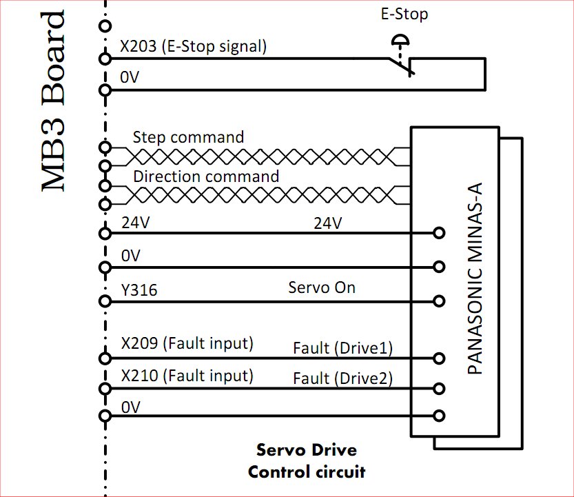

I found this for a MB3 to a panasonic A series.
Attachment 28764
Seems literally just the "servo on" for that one - as you posted in the modified picture.

Perhaps you can see what a minefield processing information from tinterweb is (for a newbie in this area). Hence why I am triple checking everything before diving in. :redface:
Doddy
The servo inputs, apart from the step/dir, are intended to be driven by the 12/24V supply to the servo driver, and through current sink inputs. The step/dir are intended for 5V differential, or single-ended supplies.
If you want to understand the difference - look at the resistors attached internal to the servo controller on page 11-13 of the manual - the step/dir are 270R (from memory), and the other inputs are 4.7k (4700R). Each opto-isolator device has an internal LED (the term opto-isolator is a bit confusing - they provide electrical isolation, by using an infra-red light between a LED and a photo-transistor across an air-gap, so the mechanism to drive this is to drive the LED 'on'). The LED will have, from memory, around 1.8V forward voltage drop. For the step/dir, 5v-1.8V = 3.2V. Through a 270R resistor, that's around 12mA (Ohm's Law: I=V/R). Typically drive current for a LED like this is around 10mA (max 20mA), the optical power is broadly proportional to the current - the choice of 270R is a standard value in the E3 etc range of resistor values - it's a "rule-of-thumb" resistor value). Now, the other inputs, with 4700R resistors - again, drop 1.8V across the LED, and if you're driving the stepper controller with 12V, then 12-1.8 = 10.2V, I = 10.2/4700 = 2mA, or at 24V then 24-1.8 = 22.2V, I = 22.2/4700 = 5mA. Actually, the currents a little low, but obviously it works - but hopefully you can see that if the 5V works on the Step/Dir at 12mA, that the other inputs with 4k7 resistors are perfectly safe at 24V because of the choice of resistors selected by the designer. being honest, I think the designer has been a little cautious.
Again, it's information provided by the manual that takes a bit of background knowledge/understanding to interpret properly.
But, yes, unduly worrying - the Step/Dir are designed for 5V signalling, the other controller inputs designated for current-sinking through a 4k7 resistor are designed for 12-24V signalling.
Fantastic information - thank you very much!!! Your time and effort is really, really appreciated.
2 Attachment(s)
Hi, just managed to get back to this... :uncomfortableness:
Still having a problem with where the 24v Power should come from for the servos. My problem is that the the Y316 input will only sink 70mA. Could someone please explain what would be the safe way to do this without me damaging the servo and/or MB3.
thanks
Attachment 31050
Heres another diagram for the MB3 - so you can see what I mean... just unsure which 24v I should be using.
Attachment 31051

https://industrial.panasonic.com/con...s_manual_e.pdf is my "source of truth" here - please confirm yourself that it's applicable to your servo drive.
From that link, page 11, fig 6-1-1 shows the intent of the 24V supply - though in that link it's referred to as COM+ and COM-, and specified as 12-24V. This is the feed to the isolated inputs to the servo driver, and the purpose is entirely to manage that interface. For this, use the same 24V supply as you use on the MB3 for the servo COM+/COM- pins. If you look at the schematic in 6-1-1, you'll note the series resistor on the opto-isolator inputs - 4k7, a quick bit of Ohms law resolves that as you need a sink capacity of around 5mA per input, so with your schematic with the MB3, Y316 needs to be able to sink 5mA - it's rated at 70mA, and will be fine. (I'll not bore people with the maths here, by all means IM me if you need that explaining, Nemo.... oh, looking up, I think I did in the earlier post).
