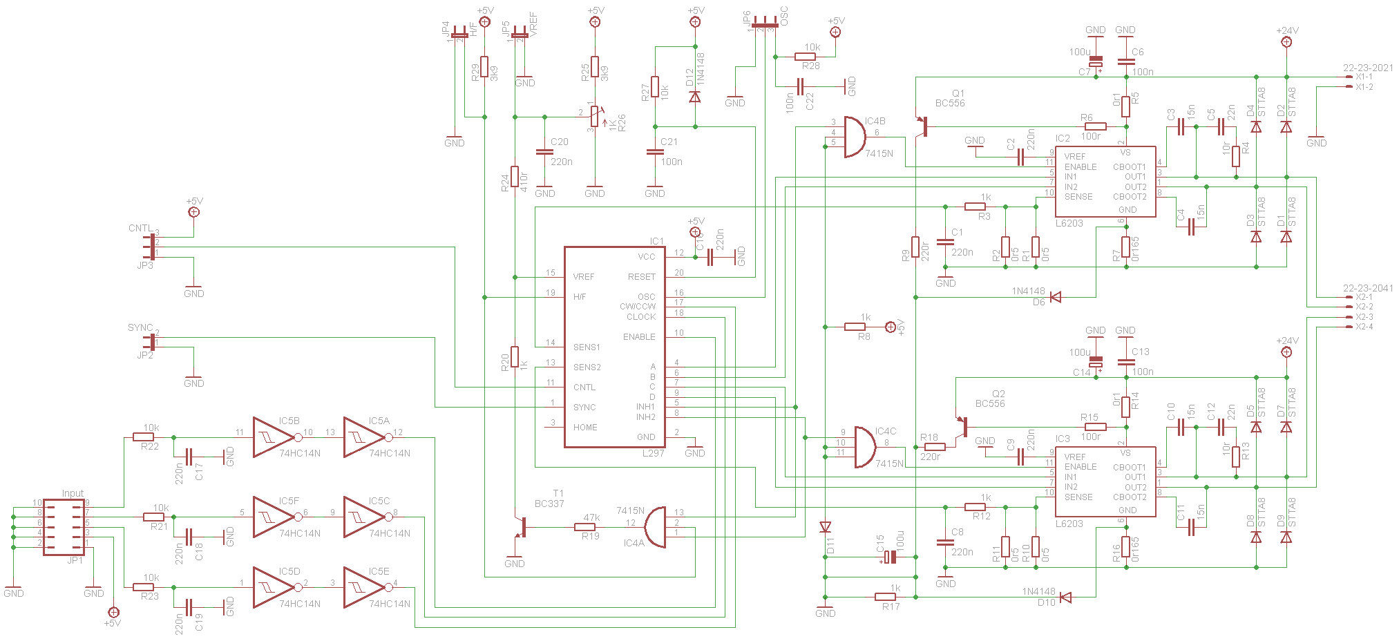

Hi All
Im looking to build a new stepper driver for my mill project. The original board used an L297 driver and 2x L6203 H bridge output stage. I'm hoping to build something similar and have found a few circuits on the net.
I have also found some nice additions to the basic circuit like overload protection for the output chips (good idea since I fried them on the last board :smile:) and varable voltage for VREF to increase Half step torque.
The circuit i have used i heavilly based on one I got from an old thread on cnczone but I'm unsure what the Pic chip dose (i asume it detects the clock pulse and varies the VREF accordingly)
So Question 1. can anyone help with a replacement circuit for the PIC chip as I dont want to use PIC chips for this project.?
And Question 2. Can some check over my version to make sure it works or suggest an alternative?
Thanks in advance

Hi
I'm not sure about the PIC - R23 is adjusting Vref (driven by Q2/IC5A) into it's GP4 input (which for the '675 is analogue input 3).
But it also does take the CLOCK signal that goes into IC3 (L297).
I don't think it's doing anything to Vref, so it must have the capability of driving CLOCK instead. Otherwise, there's not a lot the PIC could do - all the other IO pins are grounded. Do you have the code for the PIC? That would give more of a clue as to what it's doing.
Any particular reason why in yours you aren't using optoisolators?
D11 on yours should be a triac instead (T1 on the original, middle-bottom).
C15 on yours is the reverse polarity (+ve is going to GND) - next to T1 on the original (C27).
I see you've omitted the power supply circuit (top-right) - are you going to power it from the CNTL port (JP3)? I can't see any other method of providing +5V...
Apart from that, it looks good - but I'll have another look later on.
Edited to add: I suppose the PIC could do things with Vref - although the only things it could do are:
- Power GP4 high
- Power GP4 low
- Pulse GP4
- Leave GP4 open
It might power down the stepper controller if the clock hasn't been used for a while. GP2 is also the INT(errupt) input on the PIC. In which case, I suppose a resettable monostable could do the same job.

At a guess i would surmise the PIC is detecting the clock to the L297 and after some timeout after the last clock pulse is pulling Vref down to reduce the current in the motor. A 555 set up as a monostable with say a 5sec delay and triggered from the clock line might do the trick...

Thanks for the replies
Tribbles
Im not using the optos as i plan to make modular set up with a master board for the optos. Thank for spotting the mistakes, thought it was a funny looking diode :whistling:
The +5 is supplied from the input connector, Bottom left.
Irving
So is the Pic just earthing the 5v supply to the VREF making it 0v which means there is no holding current? I presume it would then revert back when a pulse is detected on the clock line?

Well if that was the case it would be pointless IMHO. I had a quick scan round and can't find the original design writeup for this circuit. I am wondering if the PIC modulates the VREF rather than just shutting it off...
Re: Help! DIY 4 amp L297/6203 driver
I'd missed that connector for some odd reason :smile:
I suspect that VREF does indeed go to 0V.
Q2 on the original can pull it low based on IC5A, and the PIC can pull down pin 3 of R23 (original).
I suspect that you may be able to get away without the PIC at all - it would mean that it would be powered up continually though (so you may need to get some meatier heatsinks).
It could do that - it would reduce the holding torque for the motors as a result. It would then provide the "full" VREF when it's being clocked. It might be a very short pulse...
Modulating the vref would make sense as no holding current isnt much use. Is that why a Pic is used rather than a 555?
I did find another cuircuit that uses logic gates to trigger 2 separates trim pots but the control signal came from an external source or the software. would it be possible to use a 555 chip to trigger this circuit?
This would make more sense and be easier to setup
Simply dropping VREF to 0 would probably drop the output current to 0, which is probably what Q2 is being used for (I'm not familiar with the L297 itself).
If INH1, INH2 and JP1 (pin2) are high, then VREF would be 0.
If the PIC's modulating VREF, then it would allow the holding current to be varied - it was probably felt by the designer to be more configurable than other circuitry (and I would be inclined to agree - you could do some cleverness like make the holding voltage [current] drop off over time the longer you don't use it, and then stabilise at a set value for the minimum hold you need). C23 would smooth the signal.
In your latest circuit, the whole left hand side appears to be doing the work of the PIC - and that's a fairly large circuit. Are you sure you don't want to use a PIC (why not?)

The purpose of IC5,Q2 (IC4A, T1 in circuit 2) is to reduce Vref by 1/3 approx on 1/2 steps to even out torque and get a better 1/2 stepping. This is because, without those additions, the current on half steps (both coils on) is 1.4x current on a full step (one coil on) (sum of the vectors). In circuit 3 the left hand side is a charge pump that detects when the clock pulse train vanishes and switches Vref from Imax to Ihold after a short delay, however its complicated by additional circuitry to force Ihold when the driver powers up.
Whats lacking is the actual code for the PIC, only then can we determine what its doing... should be on the net somewhere...
I'd forgotten that 410R resistor off of Q2. That makes sense.

Unfortunately, without the code for the PIC, it'll be effectively useless - it would be possible to write something, but it would probably need a bit of tweaking to get it right.
I'd be tempted not to use it at all and see how you get on. The motors would get hotter because the power will be on all the time.

Shouldn't be too hard to create the same effect without the PIC. I see a monostable to define the timeout, and an astable with variable on/off ratio to provide a modulating switch. Could be done with the two halves of a 556 I reckon...
Then again, why not just pull Vref down rather than modulate it?
I will think on it...
I think you'd want to modulate it in order to adjust the holding torque.
But you're right - a 556 would provide the timeout and the reduction in torque. Although a 555 and a suitable transistor/resistor should pull VREF down to a suitable amount (much in the same way that Q2 does it).
Hell, you may even get away with a simple RC timer - assuming the clock's quiescent voltage is 0. That I'd need to think about (analogue electronics isn't my forté).

I found a circuit that uses a 555 to pull vref down after 10s, its from a unipolar design that uses an L297 so i presumed it would be ok.
I'm not sure if I fully understand the timing delay, I presumed that the control circuit would activate the lower vref so soon as the clock stopped? but looking at this I think it only works after 10s of inactivity. so in most cases the current will be full power?

The delay could be made adjustable, but that circuit would do the trick. It needs a lot more parts than the PIC, that is the attraction of using the PIC...
I dont think a PIC program would be hard to create, using a 16F84 or equivalent...they are only a few pence now and programming them isn't hard (I can do it, so can at least 2 or 3 others)

Well lets think this through...
Whats the slowest meaningful step rate, 1 step/second? how long after the last step do we want to wait, 10 seconds?
So every time there is a clock pulse, reload an 'n' second counter. when the counter reaches 0 start a PWM output with a frequency of 100Hz say, and a mark/space ratio controlled from 2 dip switches giving 100 (off), 75, 50 and 25 settings
Use a couple more DIP switches to set the initial delay 'n', say 20, 10, 5, 2 seconds.
Pseudocode:
Interrupt routines:
If INT0 (external)
read delay value
reset main counter to delay value
set PWM output high (open collector)
reset INT0
return
If INT1 (main counter reached 0)
read PWM value
initialise PWN registers
start PWM running
reset INT1
return
Main program:
set PWM frequency
set PWM output high
configure counter clock divider
configure INT0 on external trailing edge
configure INT1 on counter timeout
read delay value
enable INT0
enable INT1
halt
obviously, depending on the chip used you may have to synthesise the PWM function with counters and a lookup table to determine the correct counts for each DIP setting.

3 Attachment(s)
Progress so far is three options.
1. Basic . as per data sheet but with half step boost and ne555 controling the idle current reduction
2.Ideal. as basic but with PIC controlling the idle current reduction and shunt reg to stop over voltage (not sure if I need to include the mosfet from the original as well?)
3. Complete. as above but with output short-circuit protection. (not sure about that now as it is quite different fron the data sheet! posted earlier)
Any thoughts, omissions or additions?
There is an error with the Vref circuitry with the 555... Vref should be connected to the slider of the pot...
Cheers thats the advantage of a fresh pair of eyes :smile: I thought I'd fixed most of the errors.
Any thoughts on using the short circuit protection and if i need the mosfet in the shunt regulator?
I've only had a quick look at this thread and the circuit, but imo the pic is simply controlling VRef. It's possible it is modulating it to provide variable VRef - but I think this unlikely since there's not a lot of point with the voltage divider if that's the case.
What I've done in the past to control a 297 is run the output of the PWM through a two stage RC filter to set the current, but doing this means there is no need for anything else around the VRef pin.
I think if I were working on that circuit I'd consider replacing the 297 with the PIC (albeit a slightly fatter pic). I'd use one of the comparators along with the PWM brought out as above (other side fed via the the current sensing resistor as per normal). Think I'd probably do most of the work in the interrupt probably using change on port ints to detect comparator and clock change. Should be possible to include microstepping etc - along with the current control stuff.
Failing that, why try and match exactly the circuit? Do as others above have suggested and simply use a 555 as a charge pump to keep the motor in high power mode.
All you really have is two supplies to your VRef pin - one permanently at 5v the other switching 0 to 5v. Run them both through a resistor (possibly the 555 output through a diode to make it easier to figure) and to the potential divider. If the resistor values are matched then roughly speaking when both are on the current will be double that when only one is on. Obviously you can chose resister values that give you the ratio's you're after.
Hope that makes sense.
[edit] I see above there's a circuit using the 555 ;-)
AAhhgg, more options. Thanks for your input tho. I like the idea of replacing the L297 with a pic as this is apparently the main cause of the buzzing. but way beyond my capabilities at the mo.
Ive been looking at the follow up thread to the A3986 debate (big can of worms) and it seems that PWM is better than the chopper control of the L297. However there was also a comment on a similar theme that suggested that the L6203 isnt the best choice for the h bridge either :rolleyes:
Looks like I'm going round in circles.
Steve
I believe the pic is lowering vref only when the step signal stops. In normal use the trim pot is setting the Vref.I agree that the 555 option is the easiest but the pic option uses less components so helping with a smaller board and slightly reduced costs.
Thanks again
