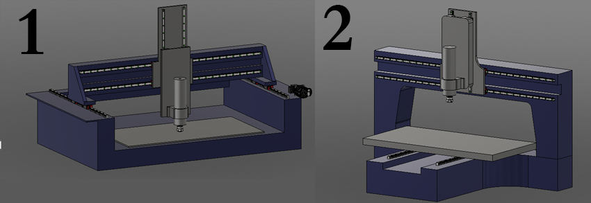

I am in the design phase of my new CNC machine. I am aming to 120x60 cm working area, And most of my milling will be in Aluminum, Brass, And some steel!
The frame will be epoxy granite and a welded laser cut steel skeleton inside.
I prototyped 2 design to choose from, Here's my 2 prototypes
Attachment 28848
I really like the U base design (#1) its easy to enclose & Chip control is great.
But, Is the design #2 stiffer?
Which one should I go to ?
Thank you all in advance (:

		Why put a steel skeleton inside?
If the steel is for stiffness it is better to put it outside. Material at or close to the neutral axis does very little for stiffness.
Save the money you would spend on laser cut steel and put it into more epoxy granite for bigger sections.

 How do you arrive at that thinking? most things have the skeleton inside for strength of the main structure and appearance there would be very little point of having steel outside of Epoxy granite other than to cut down on resonance of a steel box frame you could fill the box with epoxy.
Phill
Edit: I would be tempted to go for No2 image
 Thank you for your replay.
Yes, design #2 have many Advantages, Easier to align, Easier to machine flat,  uses 3 motor not 4.
But will it add any more stiffness more than the #1 design ?
Re: Big Epoxy Granite machine, Which frame is better ?
		I believe it will, a fixed gantry has got to be more stable than a moving mass gantry, the only thing is you need more room for the moving table.

		Personally I think a structural skeleton with the intention of adding strength is wasted money as it could have negative effects long term and interfere with resonances which is the main reason for epoxy granite. If the skeleton is to hold mounting plates etc and was a minimal wireframe affair then that's slightly different.
Where I think most go wrong with Epoxy builds is not putting enough effort into the molds, I would Save the money for laser cut steel and put it into a better quality and strong mold which would hold mounting fixtures, etc and allow for good vibrating. This is how the Big boys do it.!
Regards the Moving gantry or fixed then from the 2 you show then I'd say the Moving is the better stronger option. The fixed Gantry model has too much overhang on the table and when cutting at the outer edges you'll get vibrations.
If you support the table better along its full width then the fixed Gantry is by far the stronger choice but not how you have it drawn.!

I think I'll go with the fixed gantry design, I'll make the process easier than the other design

		Trying to stiffen an epoxy-granite structure with interlinked pieces of steel will only lead to issues due to the huge difference of thermal inertia. The steel will expand much faster than the EG.
Forget about the bracing. If after calculation the beam is not stiff enough to your liking, increase the cross-section.

		Indeed many hobby people put reinforcements in their EG structure. Probably because they don't really know the material and treat it like a regular concrete.
Look at how the big guys do it. Studer/Granitan, Durcrete/Nanodur, Rampf/Epument, ... You will never see reinforcements in their castings.
Only place inserts where needed to bolt things on.
