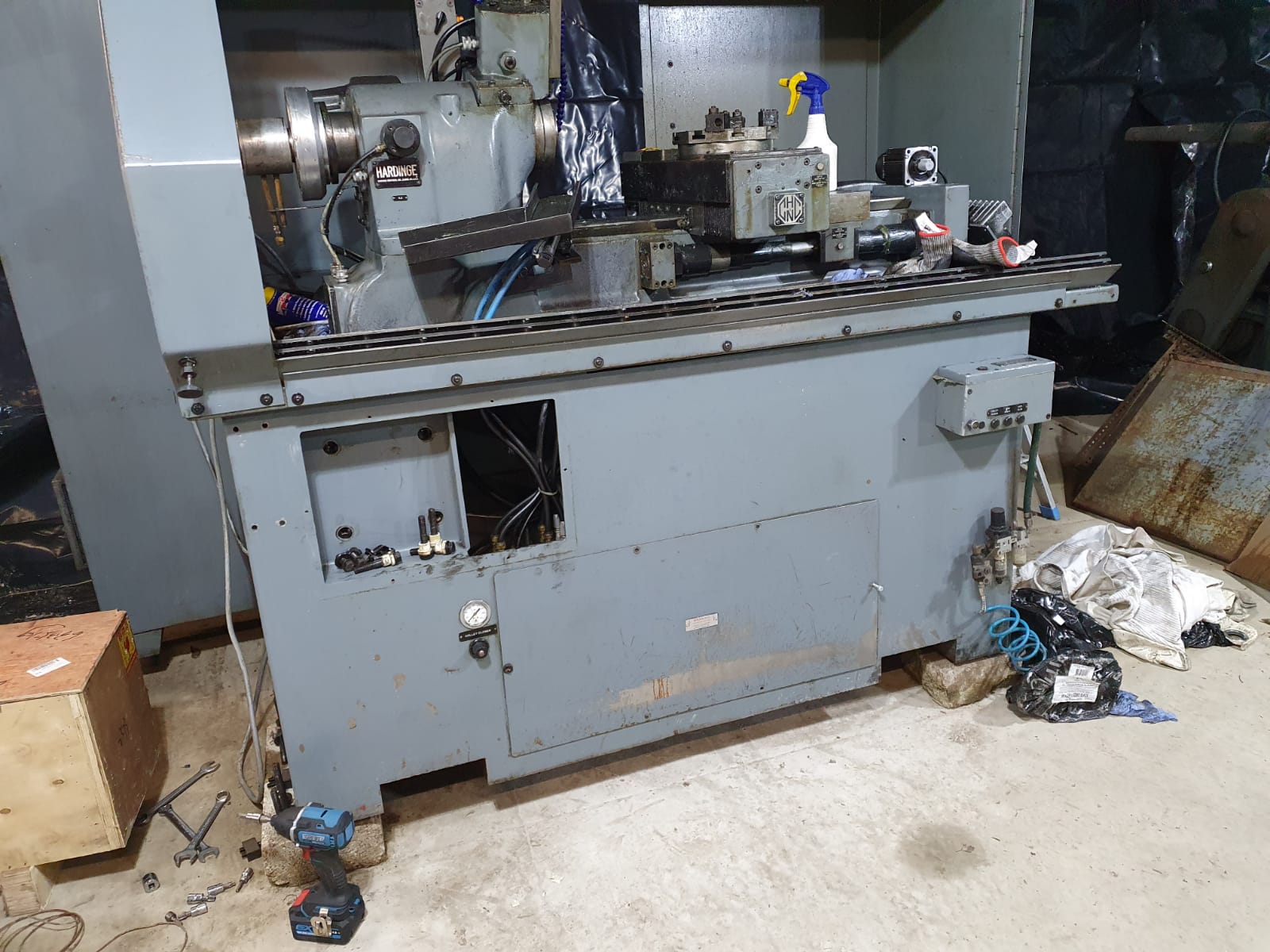

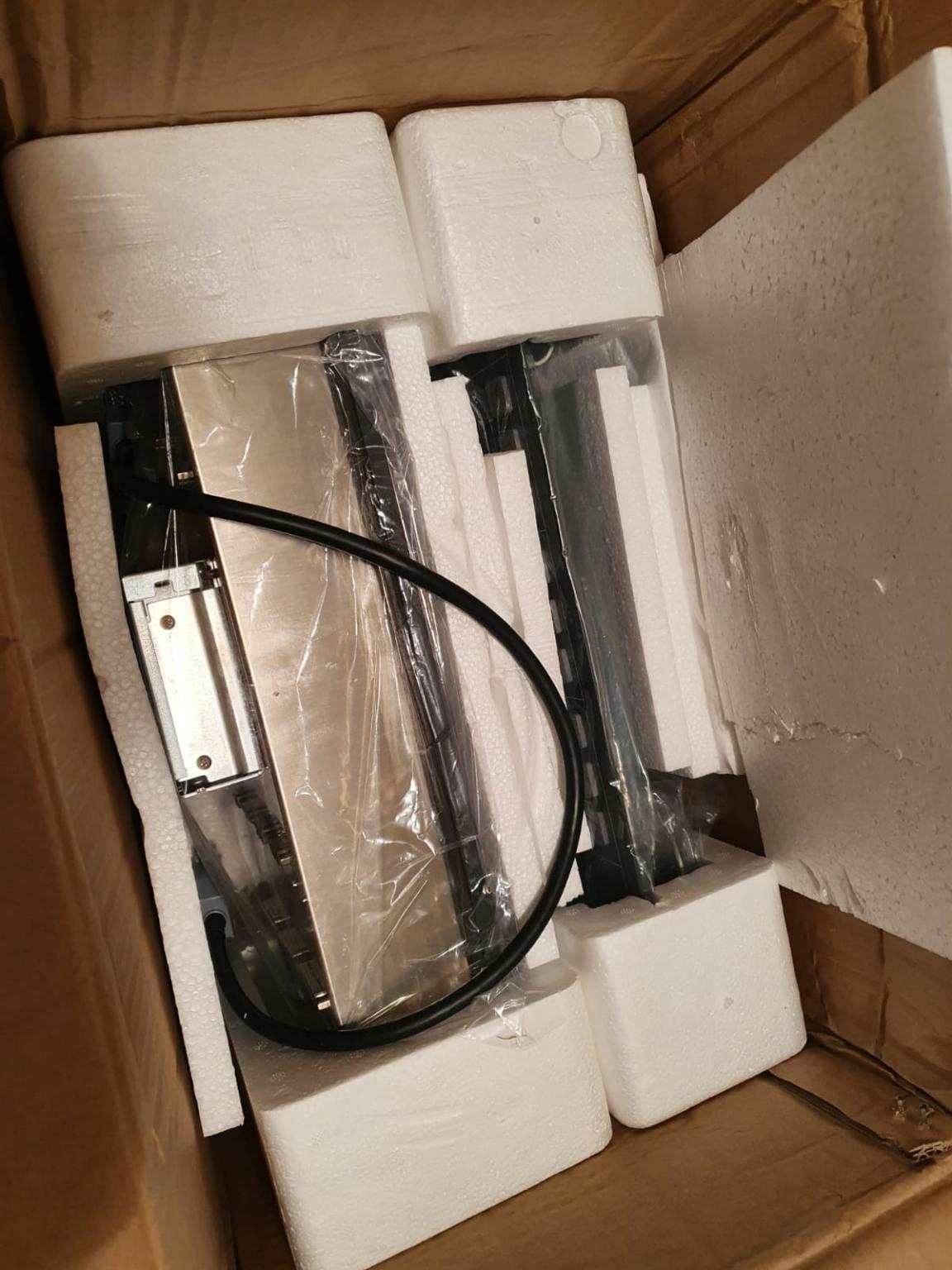

So I bought the Hardinge (and Herbert) lathes that Gary was selling a few months ago.
Fast forward and I have selected a controller, replacement AC Spindle (Im not going to fuss with the DC system) and AC Servos for the X and Y Axis from SZGH, inspired partially from JazzCNC's experience of them (and my own) as well as others such as Hood and other 'known' hobby folk.

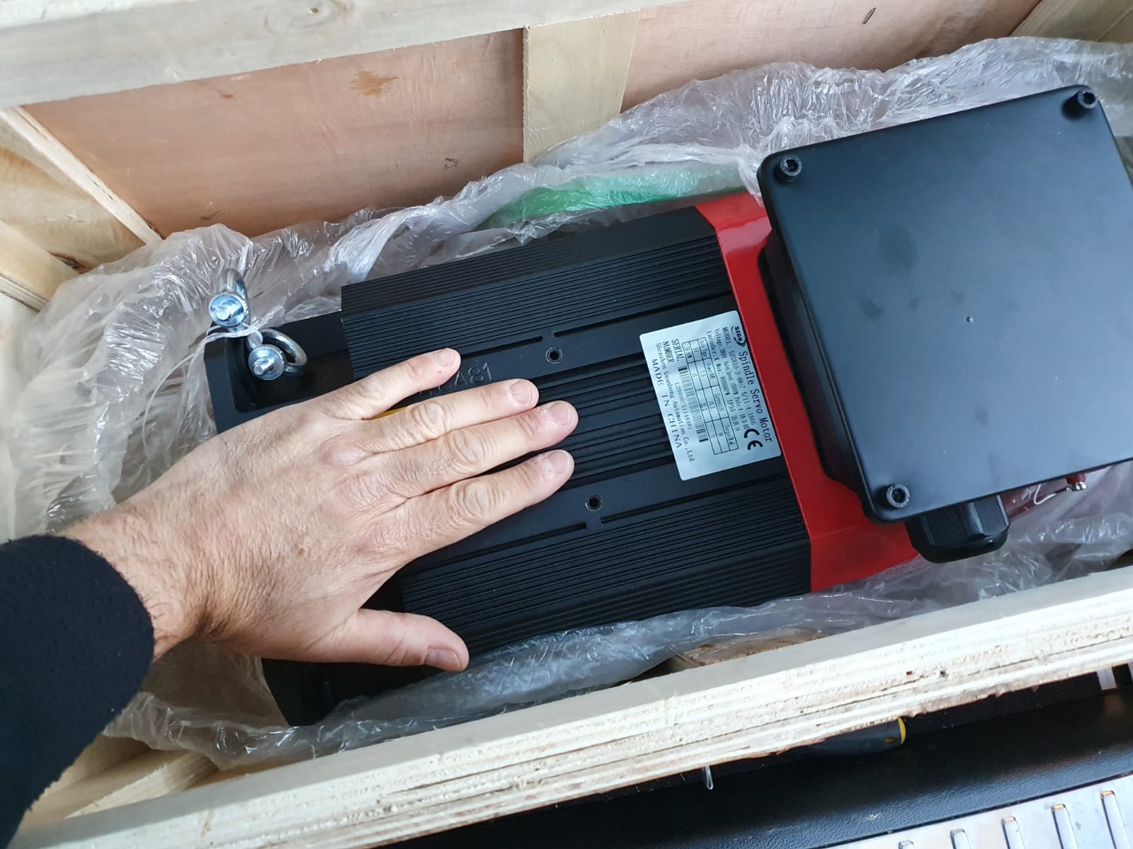

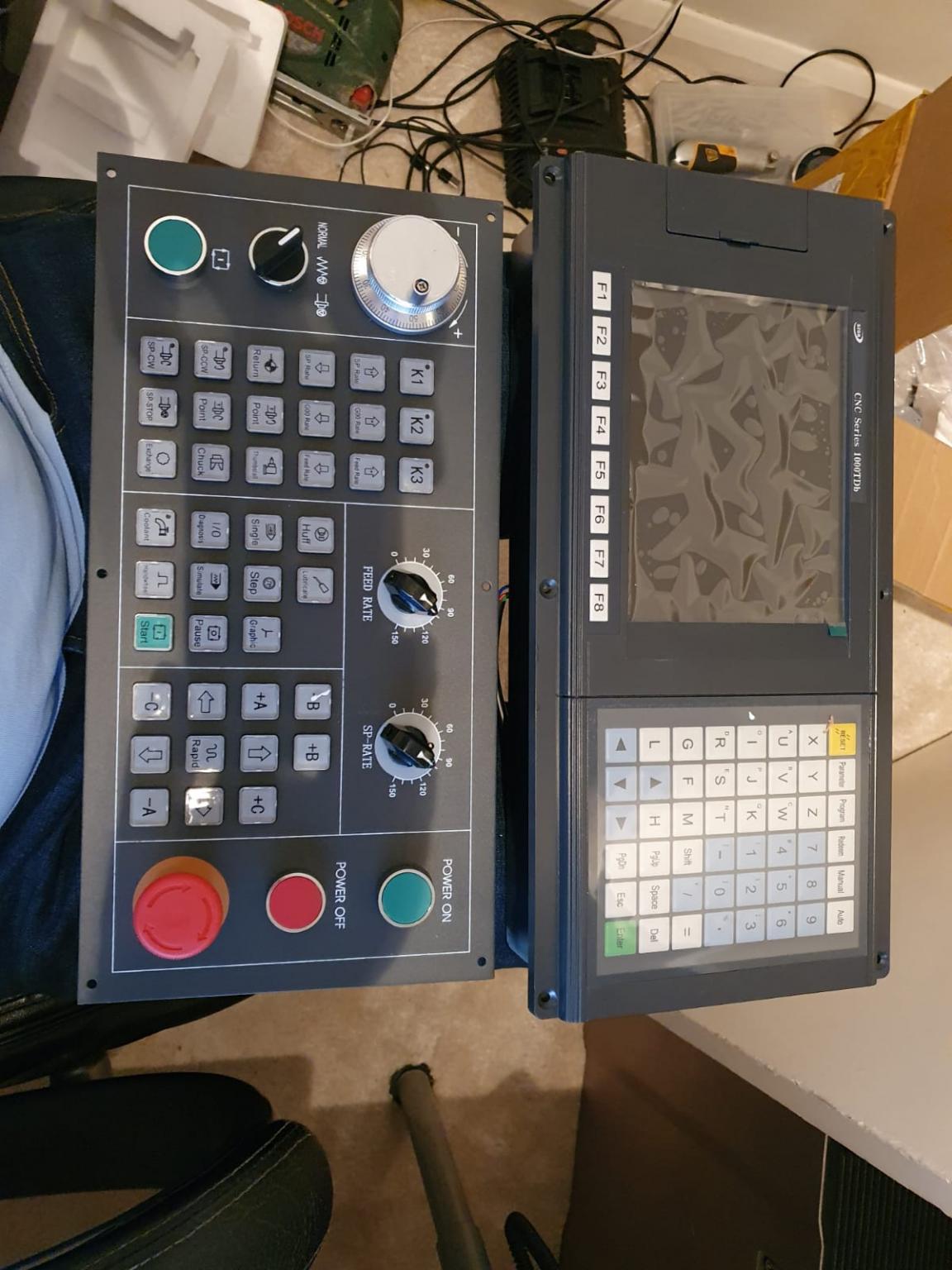

So, stuff arrived today, I think I am fortunate, I'm hearing of other people stuff from China being cancelled due to C19, so I think I was lucky.
The replacement items is the 2 axis control system with their 'C' Panel, 2 x 750W Servo motors and a 7.5 KW Servo for the spindle. The spindle is 'down' on the DC motor's torque figures however not by much. Going any larger would have needed major physical work on the mounting whereas here, I should get away with a simple adaptor plate.
The spindle motor on its own weighs over 60 kg, a beast of a thing. I dont have 3 phase yet, they have told me it will run off single phase (reduced performance) however that is enough to get the machine running and working. 3 Phase will be sorted at a point.
Attachment 28911Attachment 28912Attachment 28913Attachment 28915

When they say reduced performance on single phase, it shouldn't be by much. The main difference is that the input current is shared between 4 rectifier diodes rather than 6. The dc voltage ripple inside is slightly higher but of no concern. It should work identically, with a slight (10-20%) reduction in S1 continuous power rating. I'd be interested to hear what derating they recommend.
I'd be surprised if you got anywhere near 7.5kW continuous shaft power on a machine like this. I'm guessing you bought this for low speed torque as much as anything, at which operating point the input power will be a fair bit less than 7.5kW. Personally I wouldn't bother with the expense of installing 3 phase when you could spend that money on more machine tools....

Thanks Muzzer.
Ive been quoted around £4500 for 3 phase. I am limited at this type of machine at current levels but it remains an option.
Yep, I was willing to take a chance on this setup and running it on Single Phase. It will certainly use all the current available to it but yes, 7.5 KW of actual cutting load is a lot. If the machine is sold to someone else, at least they know its capable if connected to a suitable power supply but for my needs, I doubt Ill ever need that.
The hardinge has a belt / pulley setup so I Can mess with ratios to get what I need but yes, generally low torque for materials that are hard or like thread cutting where you might be using slow RPM but need the torque.

So, first impression of the kit is good. I agree with JazzCNC, the cabling is good quality and nice to see that its all included. There is also a dedicated turret input for an 'up to 8 way' location which is helpful.
I wasnt aware of the IO board, pity, would have ordered one but will manage without or get one at a stage.
I managed to get one of the motors connected and running. Was getting errors but didnt have a manual for the servo driver but was sent this over the weekend and it looks like it might just have been a connection issue to the encoder.
On the turret side, they will help write the macro once I explain the tool change logic. On the Hardinge theres a few solenoids but nothing odd as such. Fortunately Centroid have published a retrofit document for their kit which is useful and can be modified for use for this implementation.

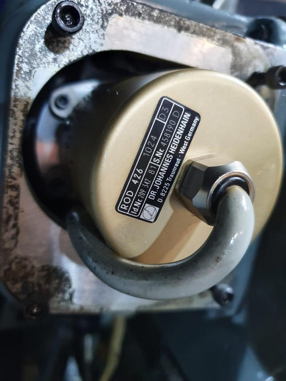

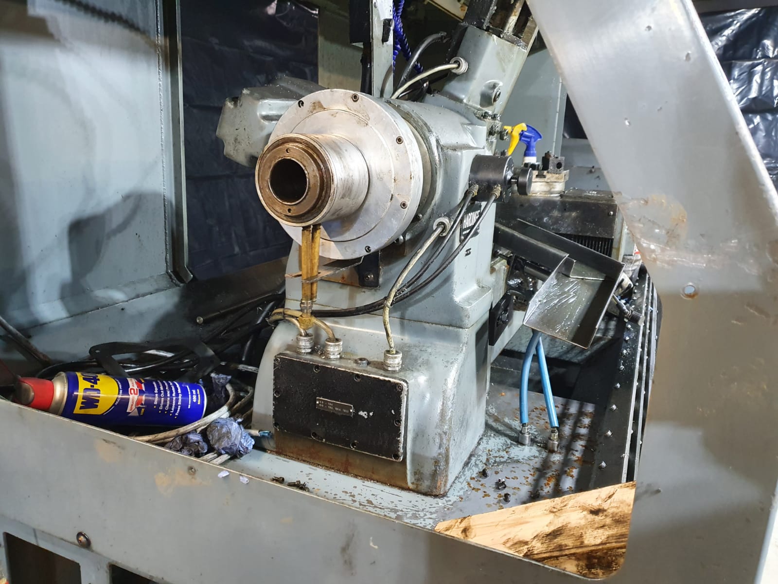

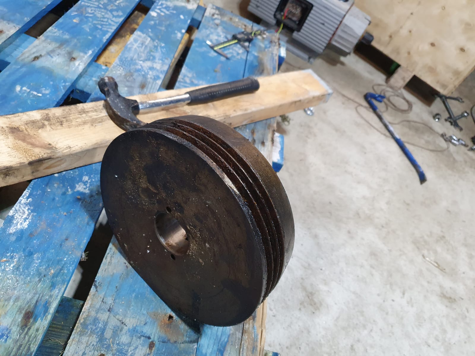

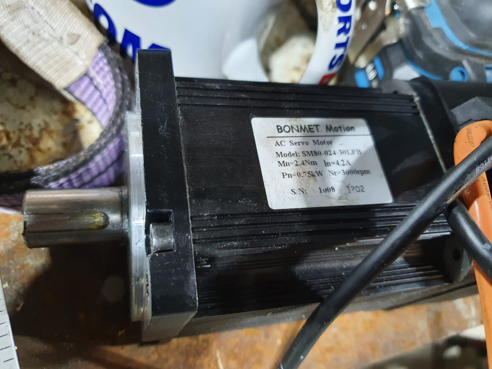

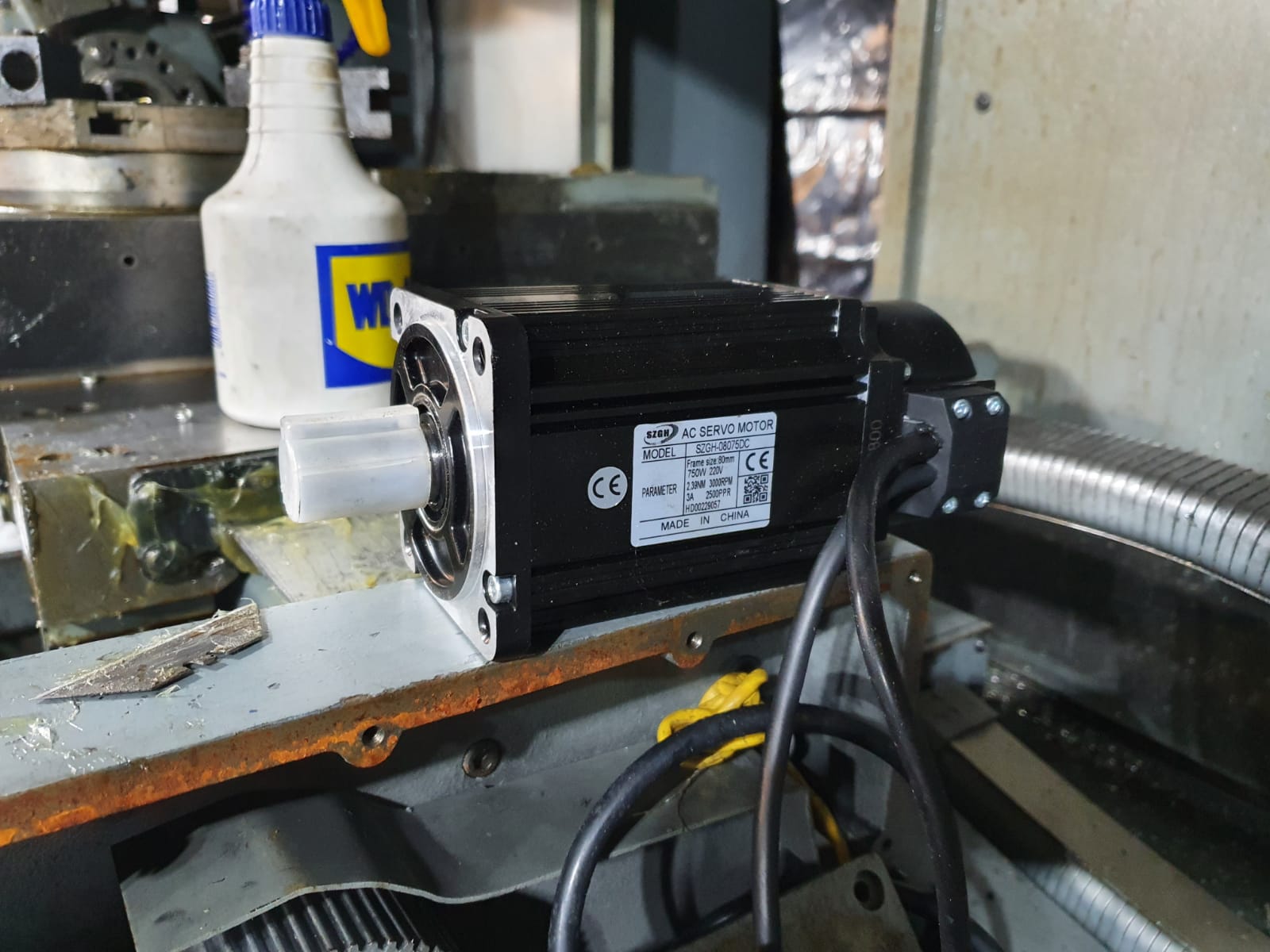

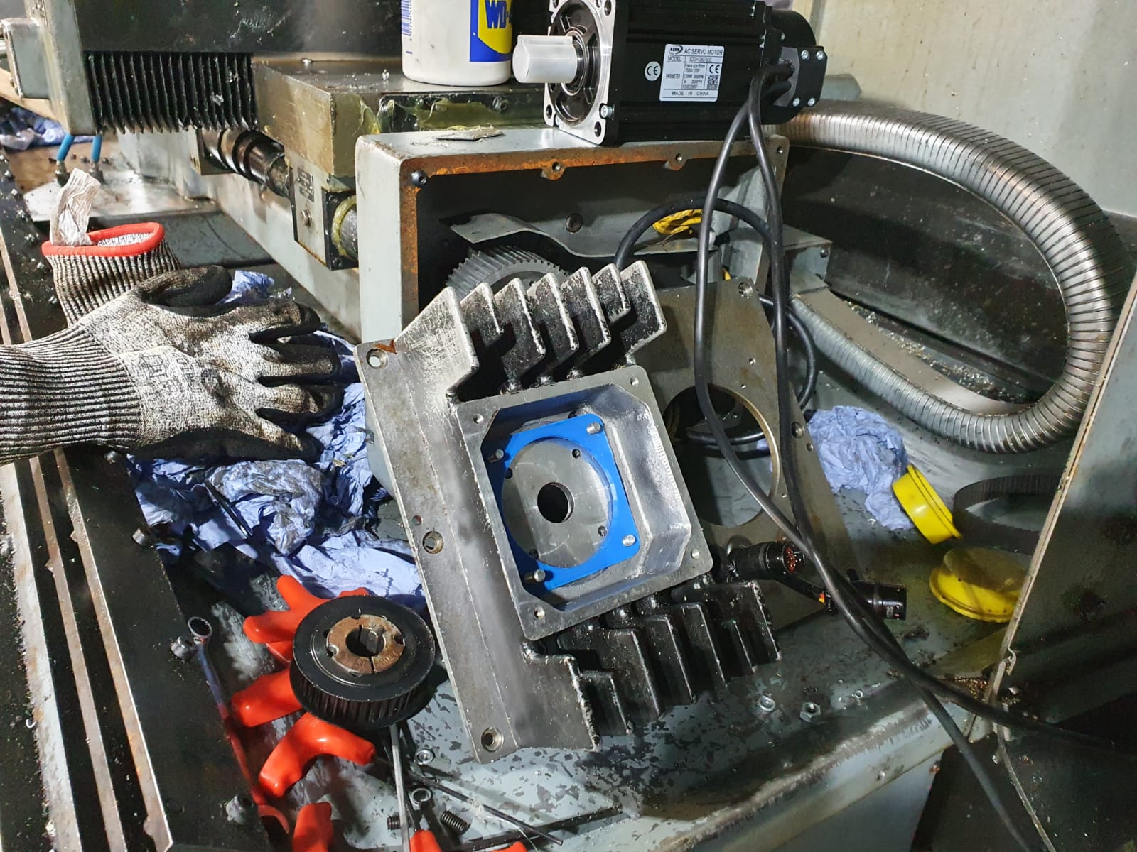

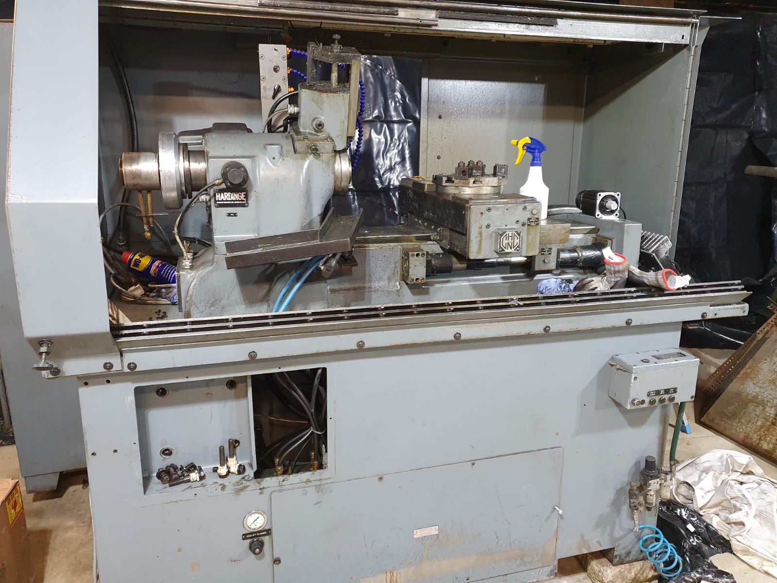

So started to look at the lathe in a bit more detail today.
The servo motors will be a direct fit exchange, courtesy of some spacers that Gary had already made. I'm not sure if the cables can be routed without taking connectors off (motor and encoder).
The spindle pulley wont work for the new spindle motor. Shaft size is now 38mm whereas on the old DC motor its around 36mm (or the nearest imperial size to that).
Found a replacement pulley / bushing which should work.

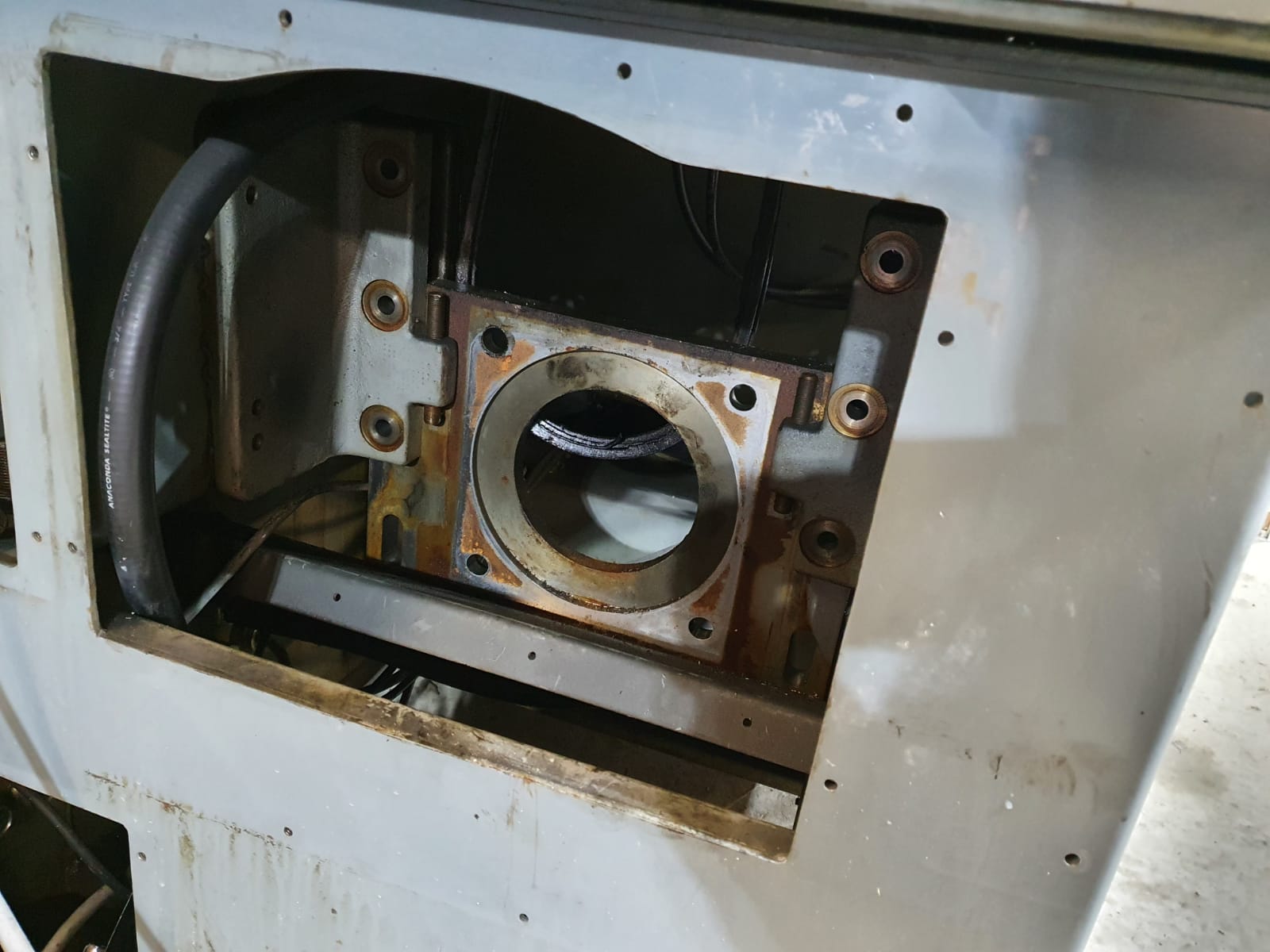

Was trying to remove the spindle 'mounting' system, removed all bolts, cant get it out. There's clearly some adhesive in places like a sealant, could be that. I'm hopeful making a adapter plate for the slightly smaller motor should be straight forward - just need to get one of my mills up and running.
I'd like to replace the V belts - any idea on how much work is involved to get them out - do I need to mess with the spindle (hopefully not).
Was fortunate to find a wiring diagram (and some notes) in the door, thanks Gary. Was looking for the limits / end stop but not found them yet - at least the drawing gives a massive help as wires / terminal blocks are marked. I believe these are all hall effect sensors so need to work out how to wire them up. I note too that there is X Coarse Home and X Fine Home marked in pencil, first time Ive seen that ..... will need to work out how to use these.

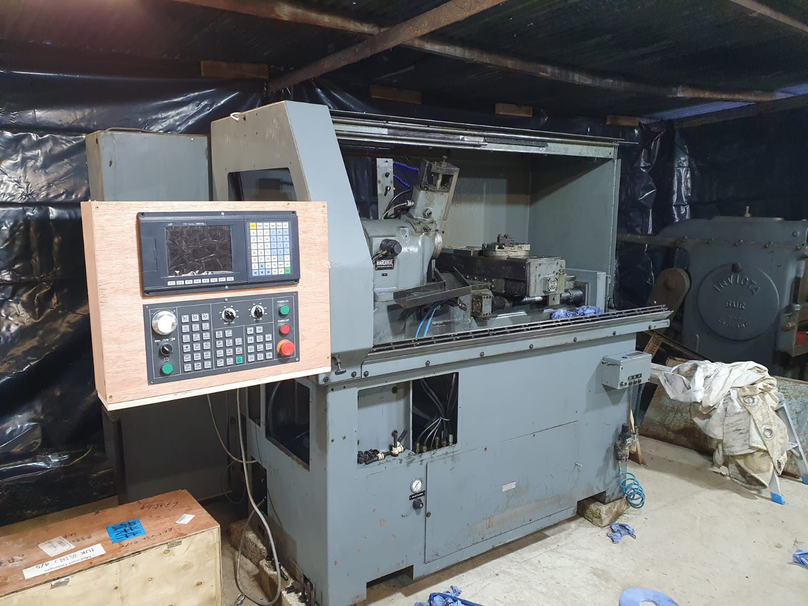

Quick update - built a temp box out of ply for the controller + MPG plate. Opened up the cover for the encoder and noted that the limits are not hall effect, took a quick video, there is a cam system depressing the limits.

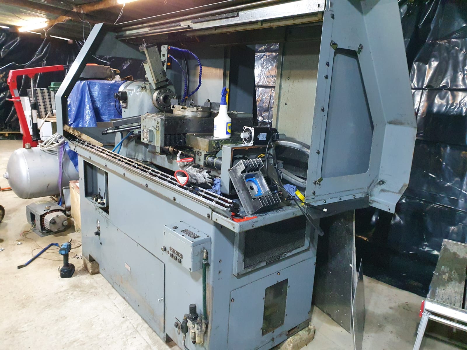

Have an issue with the driver for spindle. I discussed 220V single phase but the one Ive been sent is 380V 3 phase only. Pity, so will need to make a plan.
Spindle bracket modded and installed but I cant run the spindle yet.
