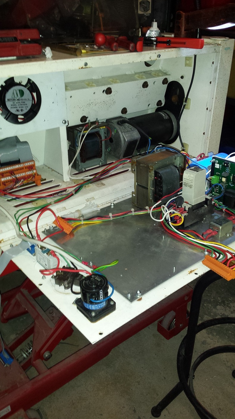

So in the absence of new advice, I have gutted the machine. Boards out , removed all limit and interlock switches. I will replace those I feel are really needed. Will put in a new Estop , and home switches, so now looking at what is left of the spindle control circuit.
This is me following the ancient Northern principle
"Let the dog see the rabbit"
Attachment 28946
Am currently trying to identify the wiring I am left with, so give me time on that one!
I will be building a new panel, with stepper drivers and BOB, and am not expecting too much difficulty with making X and Z operate from the computer .
Bit of trepidation though about making the spindle operate and vary the speed, in coordination with the traverses .
All suggestions considered !

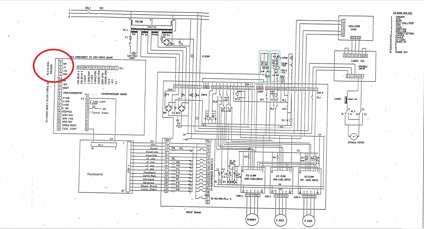

Right , So??
Circuit here and I will expand on my issues .
Please remember i am of the mechanical rather than electrical persuasion so Wiring diagrams are not part of my native language .
Attachment 28963
The spindle encoder Plugs into the processor board (highlighted red ) where I presume magical and mysterious things happen to the input , before it is sent on to the drive board .
RL1 (brown) which is integral then seems to shuffle things in a manner I cant yet get my head around via the forward / reverse (green box) and Latch /unlatch (blue box) which I am presuming is controlling the big grey external relay RL3 for spindle direction
So the function of the spindle seems to be dependent upon both boards ????
How can I chuck them out?

Hi John
For now ignore the green box you have drawn, they look to be a connection to the FWD/REV bulbs in those 2 switches on the control panel (most likely 2 thin wires going from rl3).
The spindle speed is reliant on a 0 - 10v signal coming from whatever control board you will use.
FWD /REV will also be dependant on the controller you use, at switch on Relay3 will switch to one position, this will be either Forward or Reverse. Lets for the sake of argument we'll call it default position.
You will need to copy the circuit with additional relays.
Most s / controllers have a relay on board for fwd reverse if so, there will normally be a nc / no and com connection.
So you would connect the com(mon) to 0v from pwr supply.
NC(normally closed or for the sake of quickness On as it is directly connected to the com terminal). would go to one ov side of Rl3
NO(normally open or for the sake of quickness Off as it is only connected to the com terminal when selected and at the same time Nc will disengage). would go to Tudder ov side of Rl3.
Sorry if it's too simplistic as i don't know your comfort level with electrics.

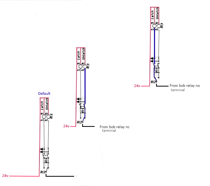

Now if you look at the diagram you posted you will see that one live terminal is also relay driven from RL1 , This is a safety relay to ensure lenze board powers up after the pc connection is made, However as you will be using your own electrics simply connect the new relay (make sure it is a mains spec relay as it will be switching the live supply to the lenze controller) and needs a dc coil ,connect the coil via the on off switch ,so the spindle only has power when that switch is on.
You can add another change over relay to the spindle drive in between rl3 and your bob relay, will attach a diagram for that option based on the circuit diagram but bear in mind you wont be using the boxford board so these relays will need to be sourced. (PM your address and i will pop an omron my4 relay and holder in the post to you, will be the end of next week though).
I also switch the mains through a relay via the E Stop switch as mine has 2 micro switches on it one nc and one no
Do one bit at at a time

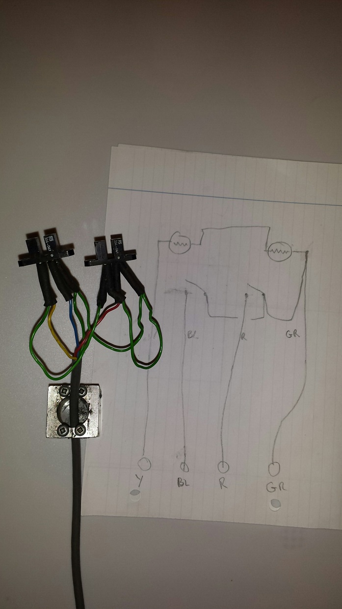

Forgot to mention the photointerupters, the photointerupters can be powered independently, so can attach to a supply board(not sure of the operating voltage so hold off for a tick.
You have 2 one changes state once per rev of the spindly the other changes however many times it sees the holes all around the disc ,I'm not going to count em ;), but the clue is in the naming of the signals on the diagram.
In mach or other software the single hole wire will be the index wire.
the multi holed wire will be the timing wire
Some software can't pickup the index pulse so then after checking the signal changes, you may need to open out the single hole, to i think 6mm wide ,but do it a bit at a time and retest until it picks that signal up in software's.
Hope it helps
a I've attached a diagram which should hopefully guide you in how the fed/rev relays work, bear in mind that rl2 represents the no/nc connection on a bob and although d
drawn with one wire in from 0v there will be two, i purposely left it like that so you can see hoe it works, the blue wire simply represents the way the 0volts is switched to trigger rl3.
Can i ask a favour, can you let me know which buttons on your control panel are ,on/of or momentary operation.

i have one of those spindle boards, as depronman said it's a good little board.
By spindle reversing relay i take it you mean Rl3 in your Boxford, if so the terminal numbers are printed/stamped into the relay holder ,just above the terminals so either use a mirror or take photos of the wiring and also take some more when you have removed the top set of wires.
Or if i remember tomorrow i can pop a pic of the base up
Re: Boxford TCL125. (Fresh start )
I think I have sussed the control wires to the relay now Inee, and I havent disturbed any others so hoping it will work when it gets correct inputs .

So being a bit pedantic here in trying to understand the difference between 0v, and Ground?? Remember I am not an electrician.
On the diagram included above, the Small DC voltages are shown as say 12v to 0v. AC supply is L,N,and E, and the 0v is connected back to earth anyway.
Some boards have both 0v and GND suggesting at least a subtle difference , And the TCL 125 control panel is a veritable spaghetti of green and white cables all of which seem to be connected to the metal chassis anyway. Is it OK to connect anything resembling 0v,,GND, and earth to the metal chassis provided that it in turn is securely connected to the incoming Earth conductor ?
I will be adding my new power supplies to my upper deck tomorrow and clearly it would be neater if these could be earthed to the chassis , and where a PSU has connections to L,N,E, and V- ,V+ is there any reason why I cant link E and v- and fasten to the chassis locally to the chassis locally?
Hi Paul
I had thought that the isolation cad on the lenze controller gave that protection.
If you look at the wiring diagram I inserted earlier in this thread , the 0v connection from the iso board ( term 5) come back to a common 0v buss which picks up the the drivers and rectifiers on its way back to a direct connection to the Mains Earth.
I will be using the Bob which was repaired for me by Doddy which has the facility for a 0-10v signal but only a make/break relay.
Does the DIYCNC spindle board generate its own signal output, so no need to connect the BOB 0-10 signal ? Or might it be better to take the speed regulation signal straight from the BOB and cut out the middle man as it were?

As far as i can see the index and timing sensor are wired thus .
Pin 1 is Green 10v
Pin2 is Blue sensor output x1
Pin3 is Red sensor output x Many
Pin4 is Yellow 0v com
This was based on pics on your other boxford thread , the pins/ use data is from the boxford manual
The pics i used are below
Attachment 29089
Attachment 29090
Inee
I think I may have blown the LEDs
they are labelled as RS 306-061 but no longer supplied by RS an I couldn't find a Datasheet
If it has 10v input I reckoned it would be safe if tried it with a 5v supply but saw no signs of light .
Tried with a 12 v I saw a single tiny flash then no more .
Then I found this data sheet https://www.silicon-ark.co.uk/datash...-datasheet.pdf
I am suspecting I may have zapped it with too much reverse voltage. could that be ??
Where to I go for replacements ? Can I select ones which would be oK with the voltages I have available , ie 12 v or 5 v

OK so I have ordered new switches and in the meantime had a closer look at these
Attachment 29091
So this might be surprising but looks like Boxford have chosen to wire these lamps like xmas tree lamps ie in series .
So our green supply wire seems to ring around the switch commons then on to the two lamps in series. How do I add the forward voltages in this configuration??
Now as Inee points out from the Boxford wiring diagram the input voltage is 10v and there is no sign of a resistor . Is it possible that the lamp resistances stack up so that no external resistor is needed . and how would that be affected if i chose to supply 12v? :distress:
Hmmm, you previously linked a reflective opto-coupler, (EDIT: Ah, I see what you did there - the linked datasheet has the slotted version later in the document) these are slotted opto-couplers (same premise, just a different physical configuration) - these more common with slotted wheels as shaft-encoders, etc.
For LEDs which typically outlive the service life of the machine, wiring in series is perfectly fine, and common practice. As you probably guess, you just need to add the forward voltage drop across the individual LEDs into the standard calculation for series resistor (the advantage being that you only need one resistor).
Where this conversation doesn't need to go, but I'll mention anyway, the forward voltage drop is not absolute - it'll vary across devices, temperature, forward current, day-of-the-week, and if you look at it funny. What that means is, you always design (calculate the series resistor) based on nominal values - and the slight variances fall by the wayside... what you can't do is drive an Led without a series resistor of some sort (or rather, a current limiting device or circuit) - as any slight variance in the forward voltage drop would have a significant swing on the forward current and could result in the destruction of the LED.
So, given a wet finger of 1.8V Vf for an IR LED, at 12V drive voltage and an If of 10mA, you'd end up with a series resistor value or 840 Ohm, or closest value of 820 Ohm in the E12 range of resistor values. But, you're overthinking things a little - you can wet-finger resistor values given a safe working forward current. So, whether it's one or two LEDs, and 10V or 12V, you'd probably just pick the ubiquitous 1k resistor. It's close enough. There's plenty of other factors in the system that will impact the performance more than 10-20% accuracy of resistor values.
I'm convinced to within a gnat's arse that there will be some method of current limiting/control in the Boxford board, regardless of the schematics. It's the done thing. And the cheapest (and most reliable) method is a series resistor. It *could* be that the original opto-isolators had integral series resistors for 5V operation (after all, once upon a time 5V was common logic supply voltage), but it's almost irrelevant here - you know the opto's you're buying, you can find the datasheet, you can determine the Vf, and then you can determine the series resistor. But 1k will do.
Your schematic is functionally okay, but remember both the LED and the associated photo-transistor are polarised devices - you need to get the wiring the right way around.
