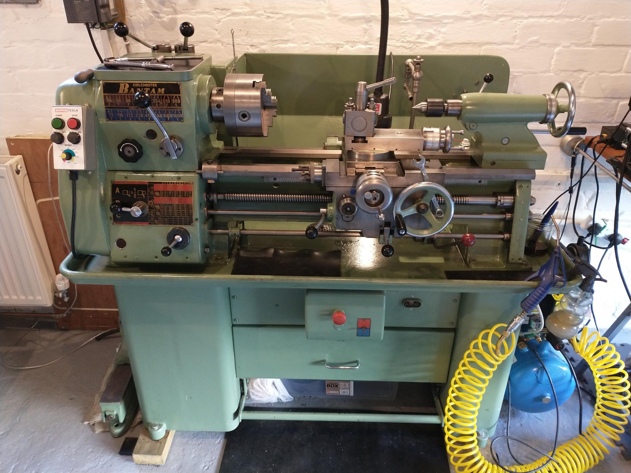

		Just thought I'd share this:
Attachment 28944
I have a few more jobs to do including wiring the suds pump (also hoping for some help with that) ,fitting an emergency stop and connecting the foot brake. Not sure I can do that with the VFD though...

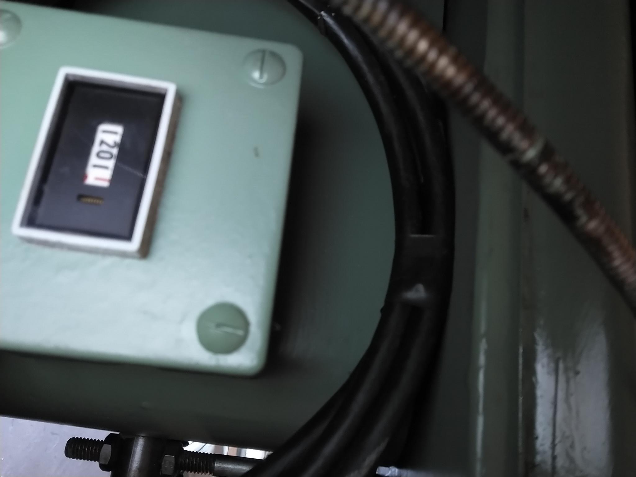

		Hi Muzzer,
I have a dial on the back of the machine as below, do you know what it indicates. I think its the hours it has been running but not sure ?
Attachment 28945
