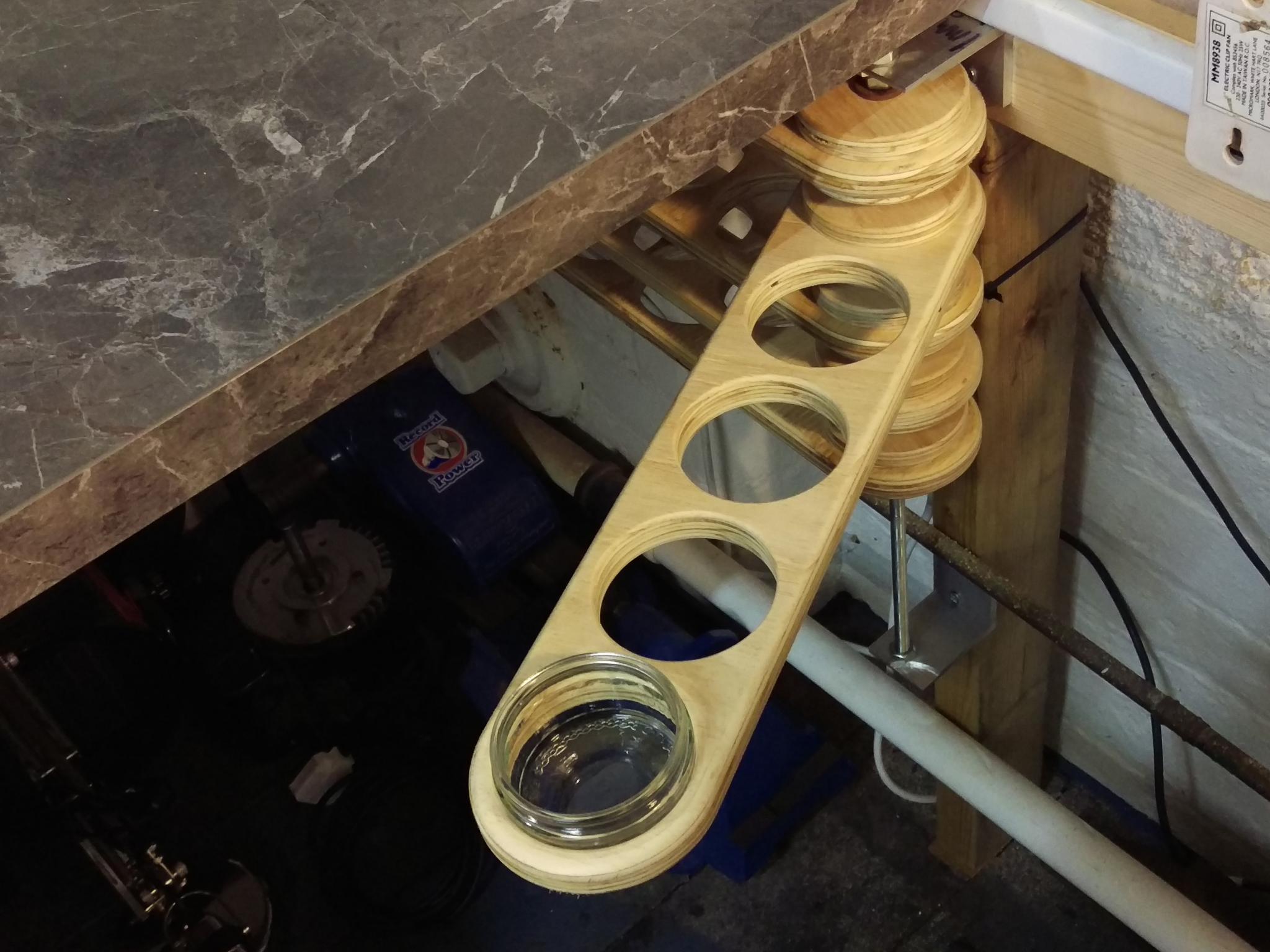

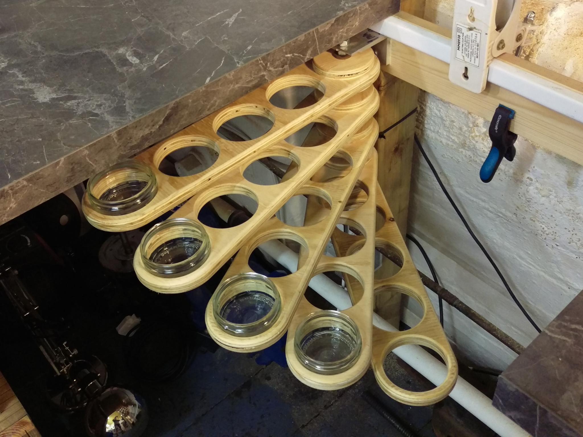

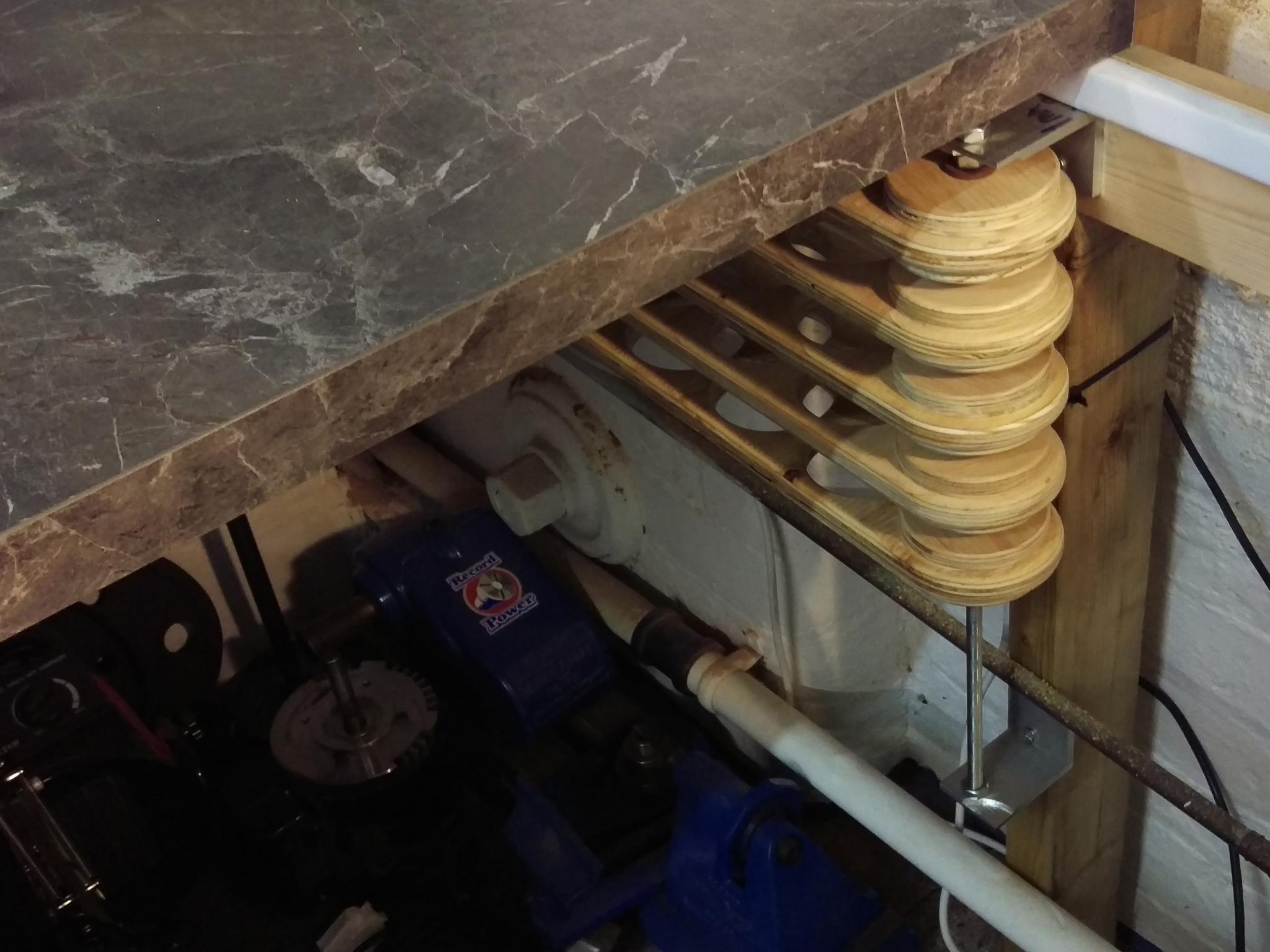

Hello all,

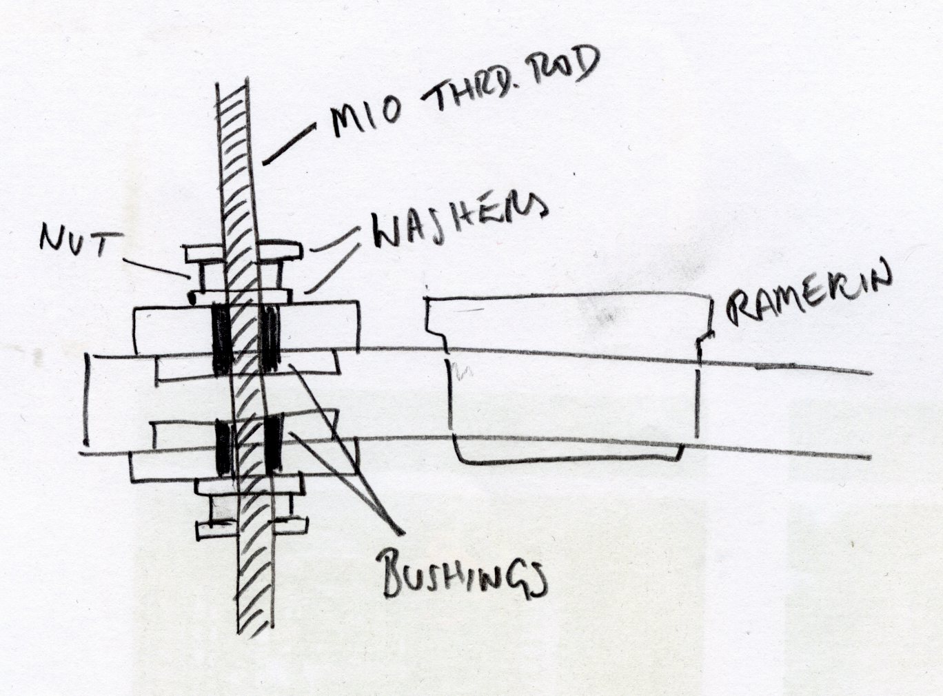

Had a load of long-lozenge shaped construction ply off-cuts left over from a recent job and thought it a shame to bin 'em. Picked up some 14mm (10mm ID) tube for the bushings from a scrap bin and had a bit of threaded rod lying about. The two L brackets were an old (sawn in half) motor mount I'd made myself for a bit of a project that never worked as expected and has since been disassembled. Only thing I need more of are the empty dessert jars... Shouldn't be a problem.
Anyway, here it is:
Attachment 28988 Attachment 28990 Attachment 28989 Attachment 28991
Wal.
EDIT: Nuts are torqued up to give a bit of resistance and stud-locked into position, each level moves independently.

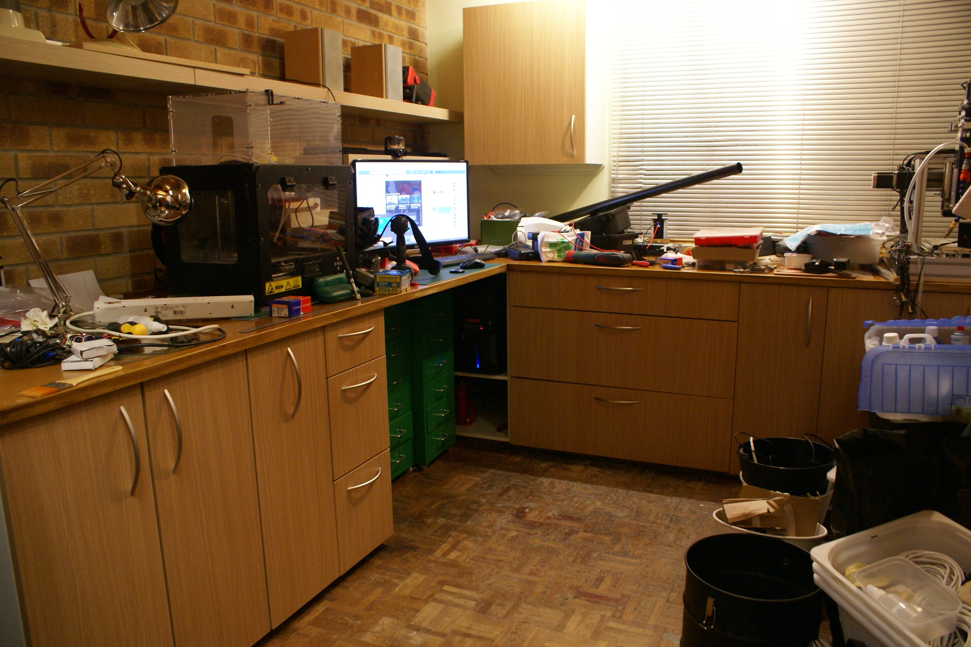

2 Attachment(s)
Re: Space Saving Under-Bench Storage
Well Wal,

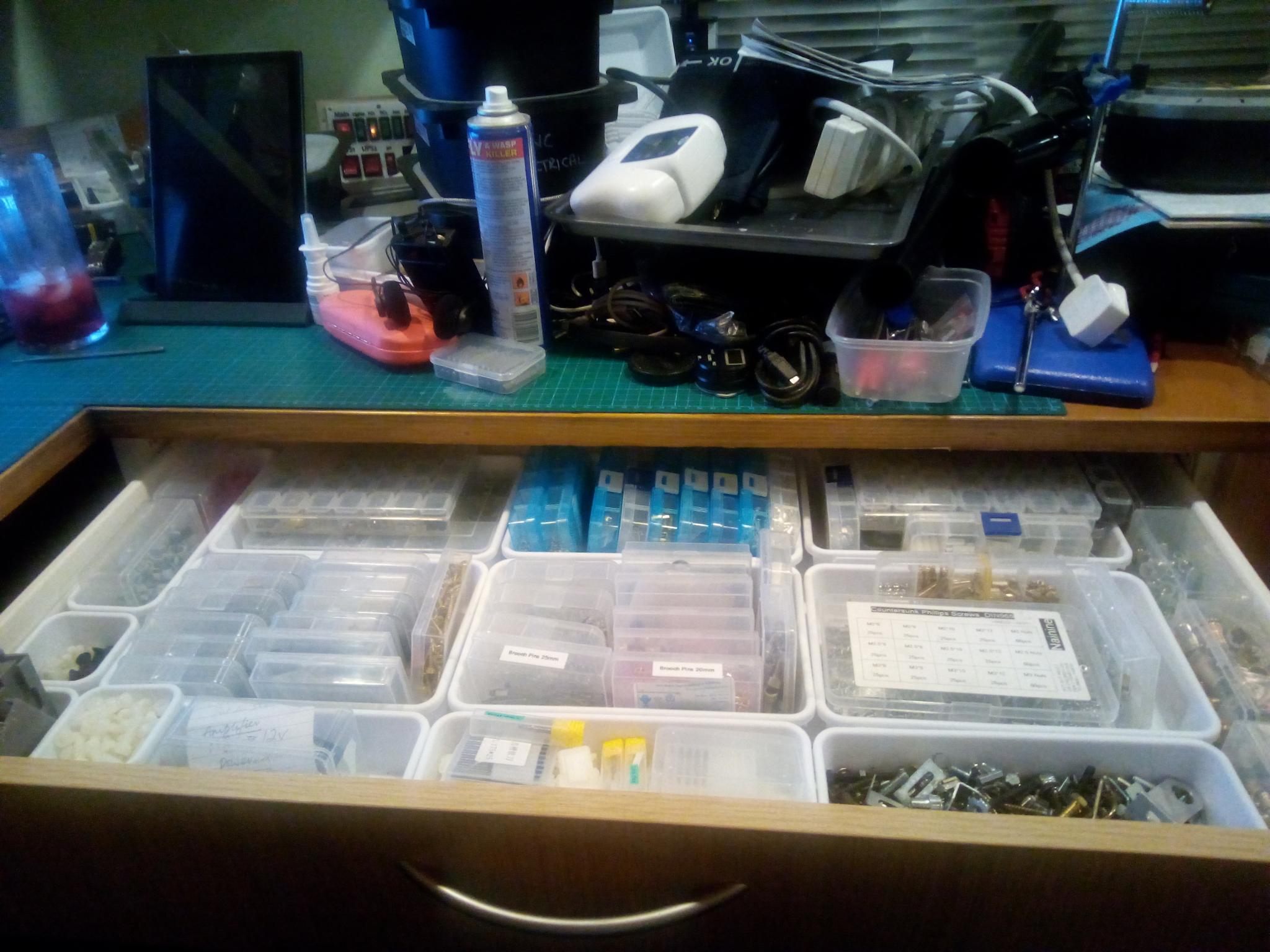

You have inspired me to organise my small parts storage (Drawer 1 of 3).
Attachment 29018

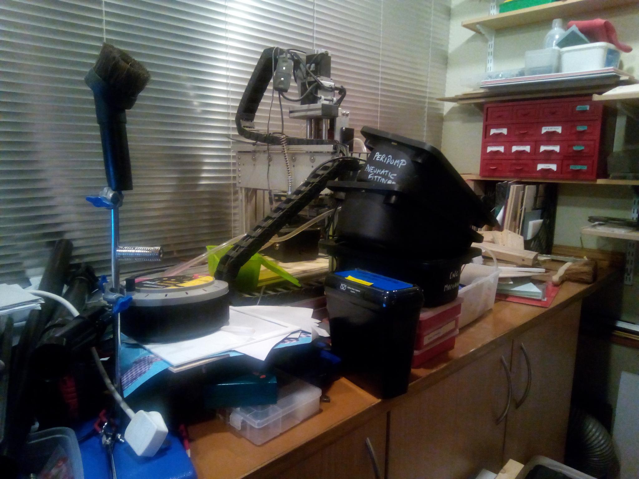

Rest of the bench is still a shitheap though...
Attachment 29019
This is part of an ongoing project which started in March...
Note the use of the soft-focus filter to give an extra dimension of dreaminess (I must clean the lens on my phone:witless:)
Rob

WIP Sir ! WIP. I have 48M of labelling tape and the label printer on standby. All part of the office rebuild Lockdown project.
Attachment 29020
Rob

You're doing a grand job, Rob - wish I had that much spare floor space in my workshop!
It is not so tidy now. I blame Boltzmann. I knew where everything was until him and his mate Heisenberg junked the place!
