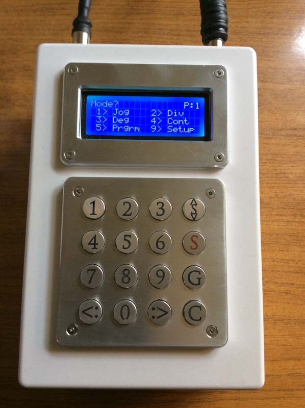

There is a small controller you built yourself that drives a stepper motor via a keypad with a small screen so the user does not have to input G-code or use a computer, all it takes is a key press that would work on this saw project for you.
You can set up a program with it to do division so a certain amount of turns of the stepper lifts the saw blade to a given height and same in reverse to lower, this you would need to workout yourself.

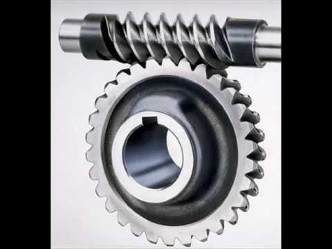

The mechanism that raises the blade is the one in the photo. Attachment 29015. The machines were build here half a century ago, so I believe all is metric.
The thing that bothers me when working, is getting on my knees to see the ruler indicator on the thicknesser and to position a metal ruller next to the blade when cutting tenons or other similar stuffs on the table saw. I had in mind the stepper motor approach, because a couple of years ago, with the assistance of some very patient guys on this forum, I managed to build a cnc machine, so I know a bit more about this things, rather than arduino. But it is on my bucket list to learn arduino, and conquer the world with an army of tiny drones..whuhaha. :P

I like very much how this thing looks. Just to make sure, I got it right. I need to order those 6 items, then do some soldering, then do some settings via the keypad. No programming required. No pc.
It totals around 100 pounds plus international postage in my case. Can be payed via paypal. Did I get it right? Also, is is possible to buy an already assembled unit, or this is the only way available?

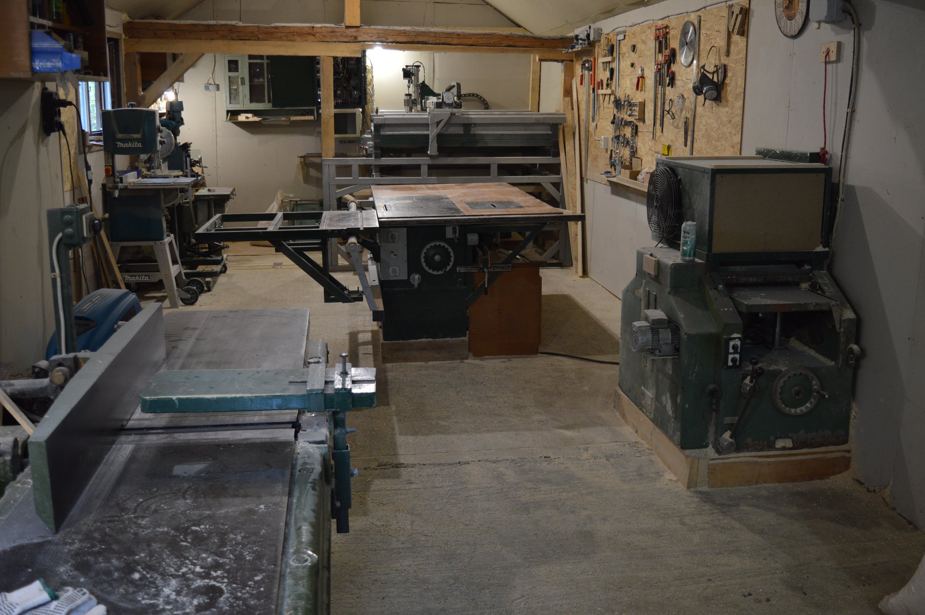

Just to add a bit more detaills to the topic.
I intend to build one device as mentioned above, for my tablesaw.
Also I need to build a simpler device for a sawmill. Any approach will do, as long as it has a motor coupled to one toothed wheel (the opposite one to the handle in the photo), implicit to the end of a lead screw, and two buttons. Up and down. To do just that, move the assemble up and down, exactly as the handle does now. Weighs around 90 kg, but it turns very easy by hand. Attachment 29023
