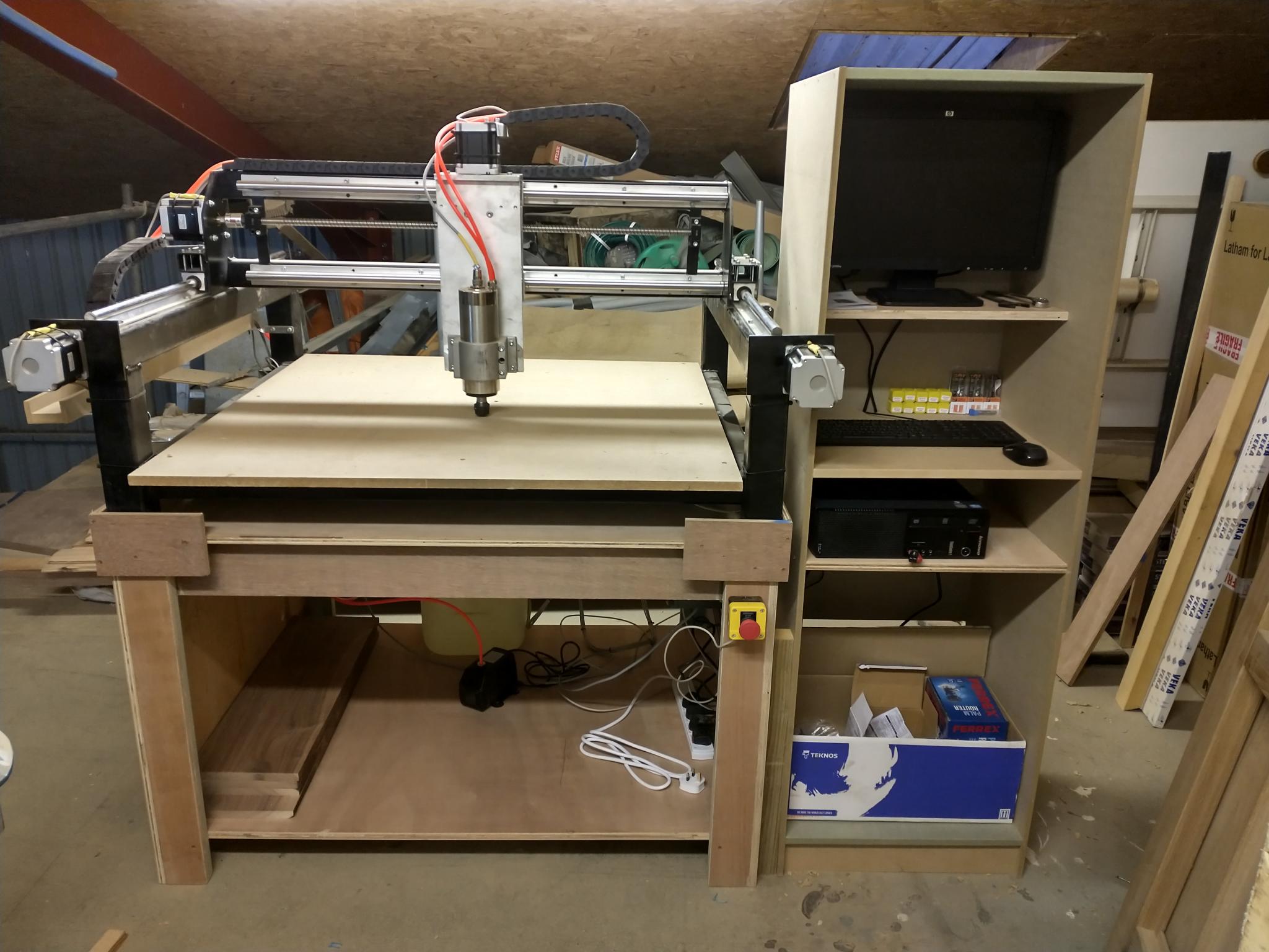

I bought a 3 axis cnc router from UK and comes with computer etc.
so finally managed to put together and try it out. I used aspire for doing my drawings and Mach3 for the cnc.
I`m new for this but have to start somewhere.
So opened my program and started o run without cutters in to see.
the spindle was sitting in to the middle of the table and started from there. My machine work area is 850mmx870mm and my program was running in 750x200mm. so i did surprised why not go to left because it wont fit this way......
anyway, let it run and when reached the edge I switched off straight away. try to send the spindle manually (jog) but wont react to nothin and the software was wont let to re set.
so I switched off and back but still no joy. Today I went back and find the solution to re set the machine (google was the answer) so now the jog is working but regardless what arrow I`m press the spindle only go one way... the spindle wont move up or down but the Software showing it is moving.
and I have Two motor to shift the spindle but only one working and again wont matter what arrow I press only going one way.
They got power i guess because if machine switched off you can move them but if power up and switched on they wont move non of them.
found out it was my mistake to not re position the zero point but i thought the machine automatically pick the sizes up from the aspire program....

Another Ebay machine from the guy in Peter lee I'm guessing.?
I've had a few dealings with his junk machines. You'll have more chance of getting a reply from the Queen than you will him.
The reason you crashed was that the machine doesn't have any HOME (or Limit) switches and because of this SOFT LIMITS cannot be set which would have prevented this from happening.
Aspire as nothing to do with the machine and knows nothing about where you are going to set your ZERO point on the table. Only the machine controller (Mach3) knows this and if it isn't set up correctly or has the needed switches crashes will happen.
All of his machines I've had dealings with have been the same, no homes or limits and poorly set up or not set up at all.
Now without seeing more and a better explanation of exactly what is happening or not happening it's hard to say why it's not working. BUT you mention Resetting the software.! Exactly what did you do.? because if you re-installed Mach3 then it's highly likely you have messed up the settings.
You need to give a better explanation of what you did and what's not working. We/I can help you but you have to help yourself by giving us clear information.

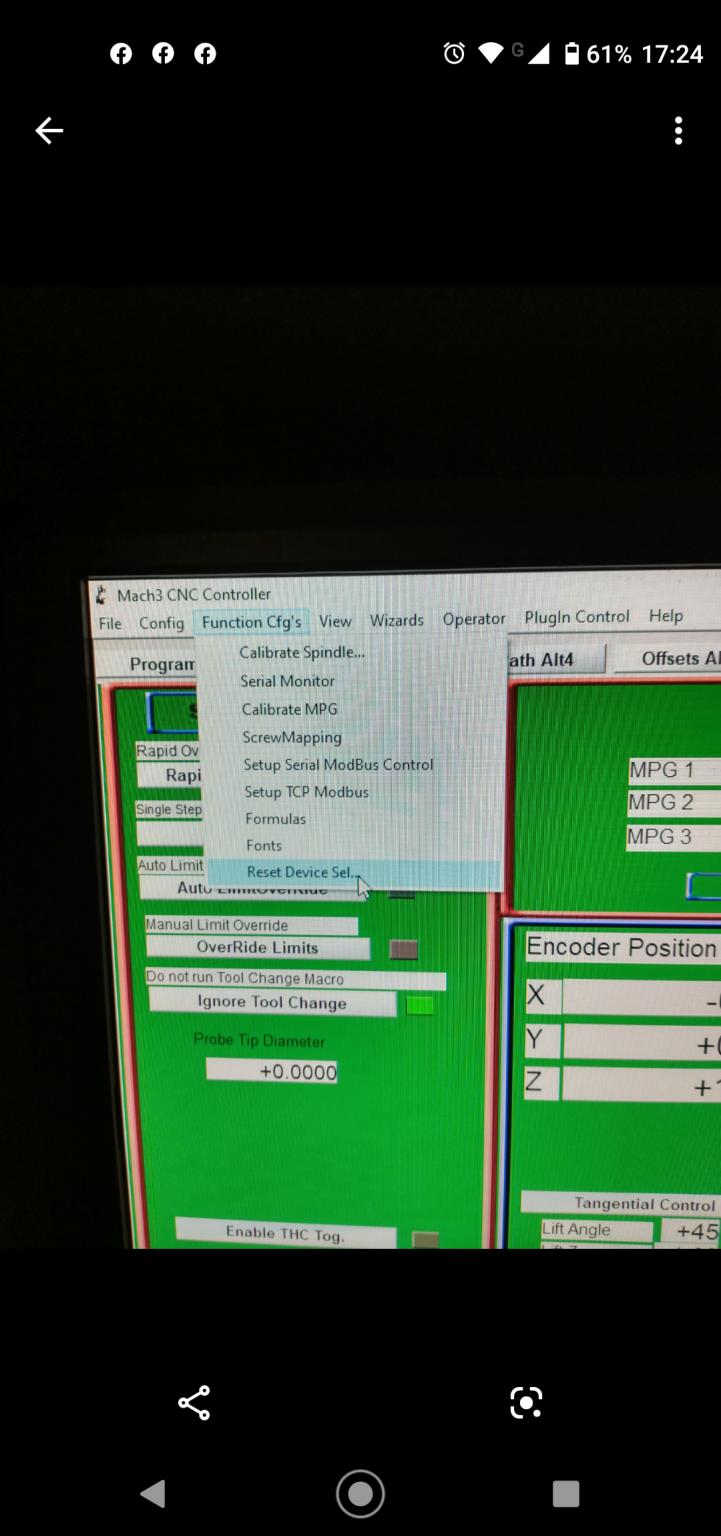

What I did is the mach3 top sections saying configuration and at the very bottom asking reset.
I was sent a message to him about what happened and he's asked me to open the controller box and go true what he asked.
All the lights are green how it should and one is blue etc. So he said it's all ok there.
He asked me to open the motor configuration page and send a screen shot and he said the settings are not right.
He send me a files and said if I drop that file in it would sort this problems.
I did but nothing happened. I mean when I try to jog the machine it's only go one way the X axis and when I want to shift the whole machine only one motor moving instead of two.
And the motor which is shifting the spindle up and down not respond but the mach3 software showing is moving up or down.
But when I jog the machine only move one direction regardless what arrow I press on that axis......

This is how I try to re set the machine
Attachment 29260
