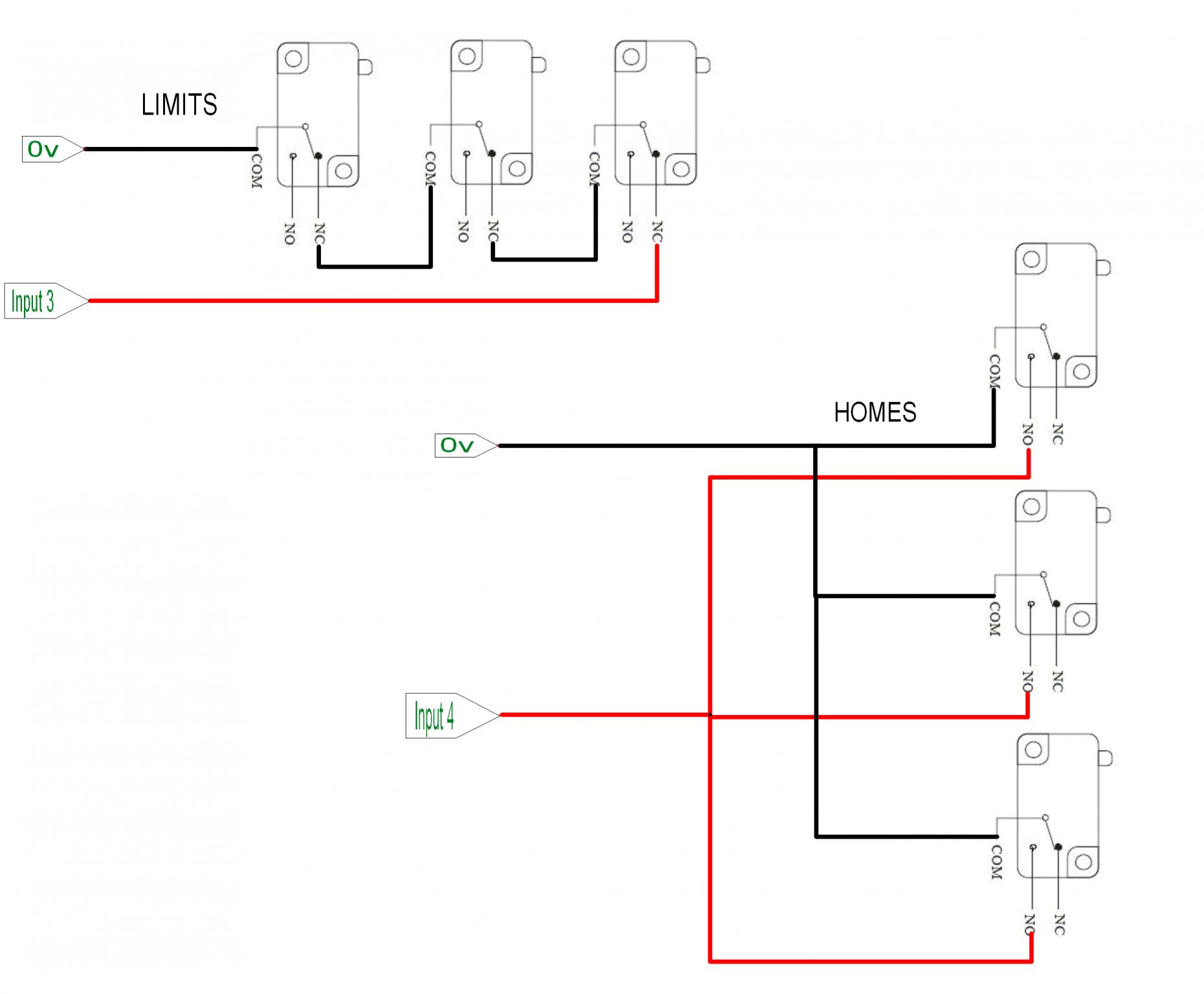

Hi Roy,
I don't know this board at all but It's simple enough if just using Micro switches and just like you thought, take wire from 0v thru the switch back to the Input you want to use.
I've attached a quick diagram showing the wiring for both.
Then In Mach3 -- Config -- ports n pins -- Input signals set each axis limit to same pin number ie:
X ++ = 3
X - - = 3
Y ++ = 3
Y - - = 3
Do the same for HOME Pins ie:
X Home = 4
Y Home = 4
Z Home = 4
Hope this helps.

Can I just clarify that although your diagram shows 3 limit switches I can protect both ends of all 3 axis travels using 6 switches?
I wish to use your suggestion of using separate limit and home switches, if I do how should they be mounted to prevent hitting the limit before hitting the home switch, or vice versa? Or can I mount a home switch and limit switch on top of each other and Mach 3 sort out which switch is activated when either homing or hitting the limit? I hope I have explained this question correctly here.
Thanks and Regards
Roy
Re: Sumtor Control Board - homing/limit switches
Roy-J
Yes I only used 3 as an example, you can have as many as you want in the chain within reason.
Roy-J
Well if your using separate switches then HOME will always be before the LIMIT SW, which is the main reason for having them separate, so if when HOMING the switch fails and the axis doesn't stop then eventually it reaches the LIMIT SW.
So you'll need to place the HOME SW so that it's before the LIMIT SW. When placing the switches you don't want the SW so they get hit HEAD-ON, so to speak, ideally you want them to get RUN OVER when triggered so if something does go wrong or you hit them at high velocity the SW doesn't get wiped out.
Often this is done using ramps to trigger the switch, then if axis goes too far the ramp just rides over the SW.
There are several ways to do it and often the machine and space dictates which works best.

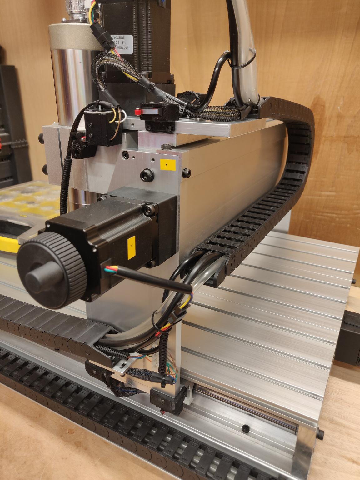

Hi JAZZCNC & Clive S,
I am pleased to report that following your expert help I have completed the upgrade to my CNC 4060,Attachment 29320 and now I have limit switches on all axis and separate home switches as well. I followed your guidance to the letter and I encountered no problems at all and it all works superbly. I can't thank you both enough for the support you gave me as I was more than a little nervous about the electronics side of this work but once I got into it, and using your wiring diagram, I found it really quite straightforward. I have attached a photo showing the finished upgrade and once again thank you both so much.
Kind Regards
Roy
Roy. Thanks for the kind words and glad you have it working.
I notice you have a handle on the stepper. That generally is not good unless it is very light as it will add a lot of inertia.
Hi Clive, thanks for the heads up, I only refitted these to make it easier for me to manually fine tune the limits and home switches, I will be removing them before next using the machine.
Once again thank you for your help.
