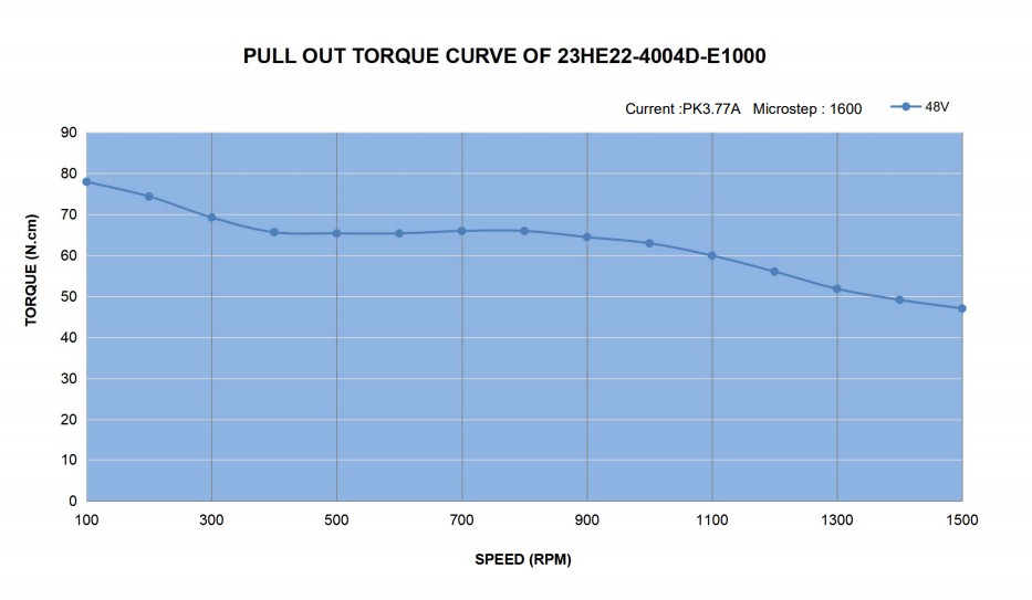

This doesn't look half bad for £72, UK stock, it has the closed loop but not the 3 phase.
Attachment 29279
Slightly naughty testing at 48V when they suggest 36V typical but good enough.
0.8Nm falling to 0.5Nm at 25 rps, I could get anywhere in the machine envelope in just 12 seconds. Maybe faster, they say it can do twice that before it clacks out.
Next question, three 36V 5A PSU's or one 15A? :whistle:

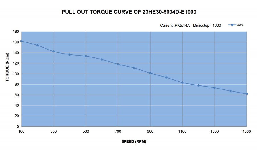

Good point. I just ordered 3 of the next size up and a 36V15A power supply
Attachment 29280
The extra Amp to compensate for the lower voltage

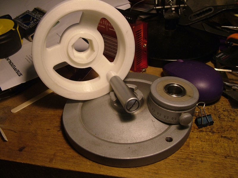

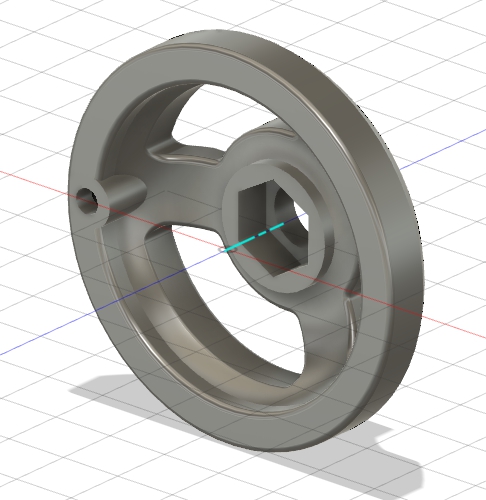

A bit late now, I am already compensating for my poor choice by printing lightweight handles :beer:
Attachment 29283
I had large cast iron wheels like that on my Bridgeport. I couldn't get a decent response from the DMM servos until I removed them. Their moment of inertia was much bigger than the ballscrew itself and the reflected inertia of the table and vise, particularly on the X axis which had 2 of the buggers. As I have an MPG, turns out I never use the handwheels anyway but your solution would be a pragmatic middle way.
Oh yes, don't give up on your handles, I am fighting to keep the dials. What is MPG? Miles per gallon doesn't seem to fit the context :topsy_turvy:
Not fighting to keep these ghastly, spring-loaded, press in before you can turn it handles though.
New handles need paint - wondered if aluminium coloured paint existed - had forgotten about alloy car wheels - spoilt for choice :eagerness:
Attachment 29287
MPG - manual pulse generator. Handheld controller, pendant, or somesuch. My router doesn't have handwheels and I don't bother on my mill either. Wireless mpg or MDI on controller does the job. It's easier than folding out the handles on the handwheels and quicker as well - I can't wind by hand that fast!
