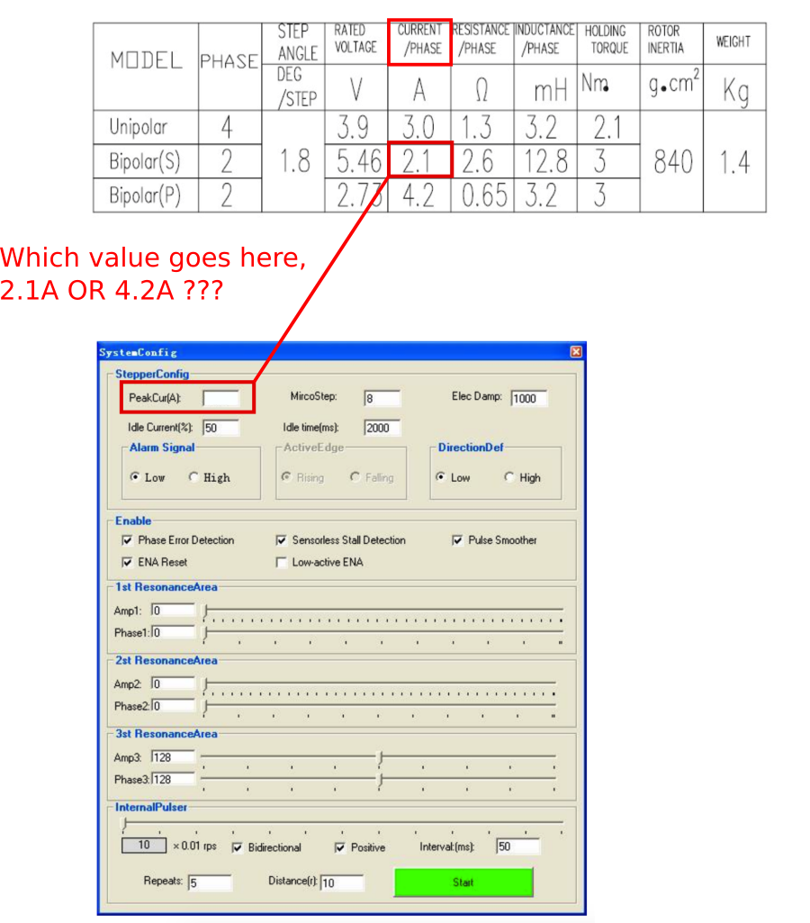

My main concern before looking into the bristle issue is the amps being fed to the steppers. I sense they are too low, it's a dual screw axis on X and a single on the Y both use 5mm pitch screws. Before I changed the "PeakCur(A)" value in ProTuner from 4A to 2A it could do 5mm cuts with a 1/4in 2 fluted cutter, now it struggles and sometimes triggers the stall/estop when doing 3mm passes in Trespa (HPL).
The problem was that the motors were getting almost too hot to touch and I wasn't sure if the PeakCur(A) was too high and would burn the motors out. So I lowered it a while back to 2A but now I noticed some missed steps I'm wondering if it should be set to the 2.1A or the 4.2A.
I get that the currents are always specified per phase on motor specs but what about in ProTuner? Does ProTuner's "PeakCur(A)" refer to the current for each phase or to an individual phase?
Currently I'm set on 2A but am wondering if I should really have set the value in ProTuner to 4.2A, or at least to somewhere closer to 4.2A like 3.8A.

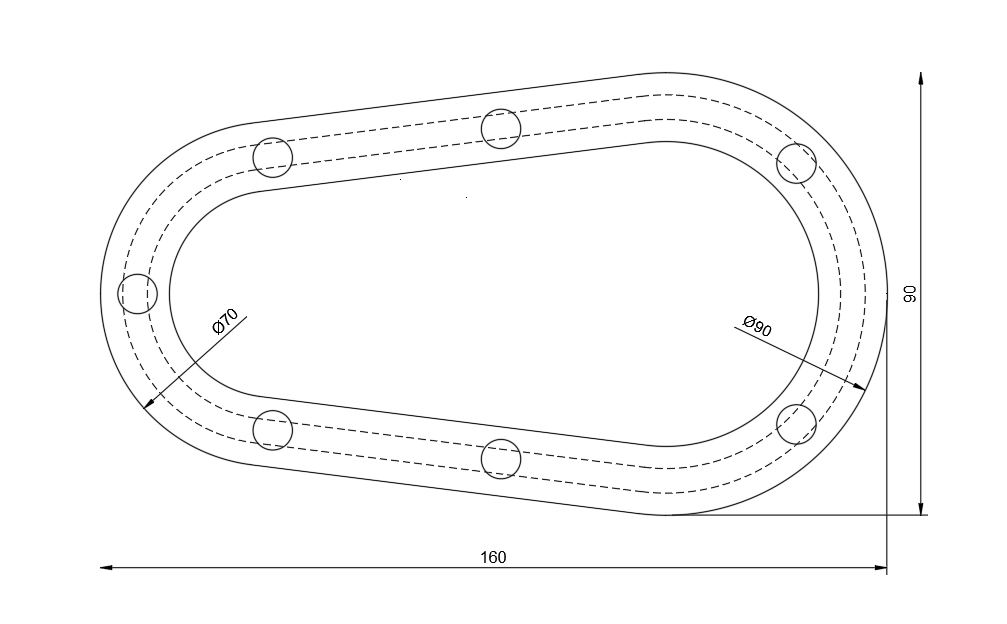

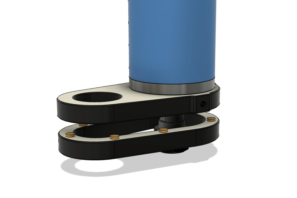

I'll include some pics of the fusion 360 model for sizing and scale but it's a small 2 part dust boot with about a 4-5mm thick layer of bristles glued into a channel on the underside. The drawings won't show the bristles in situ but it's too cold and late for me to go in and take a pic of the actual dust boot at the minute.

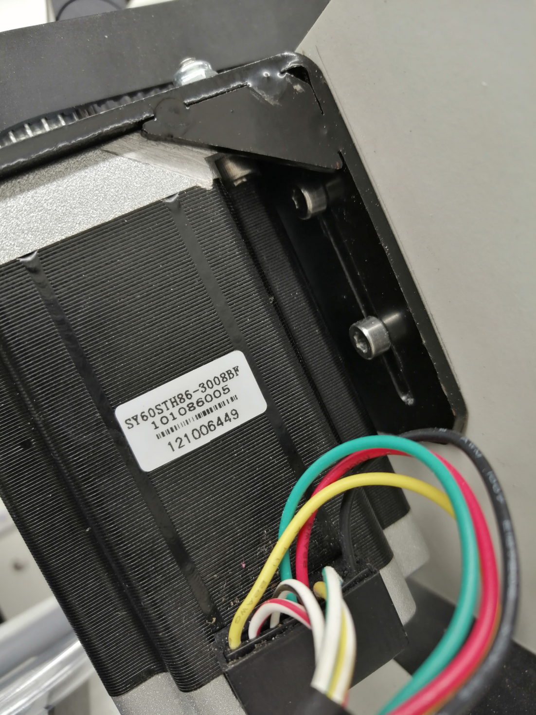

 The motors have 8 wires but only 4 are in use, the other wires are soldered together in their respective pairs. I'll include a sketch but i think the A+A-/B+B- polarities in the sketch might be different as I can't see the motors at the minute.
Attachment 29540
JAZZCNC
			If it's an 8 wire motor then you have it wired wrong which would explain all your problems, in fact, if I'm correct then I'm surprised it even works.
 They do work but when I fire up their linear power supply you can hear a very slight whistling sound, it's high pitch and really annoying to be honest, when they drivers get the ENA high signal they switch off and go quiet. These motors were bought from zapp some years ago but I can't find them on zapp now so am unable to confirm the drawing is defo for this motor. The motors are labelled as SYS80STH86 - 3008BF. Do you hear any sounds from your AM882 powered motors when they are idle?

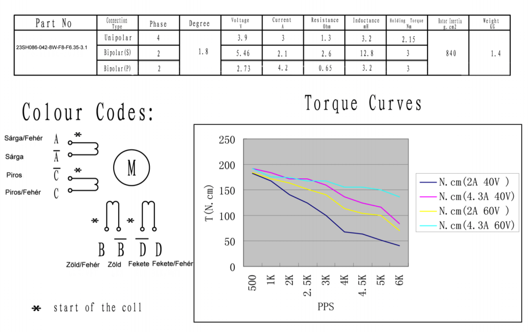

Here's the motor pic and what I think is the closest match to the spec sheet for them, the colours are in Hungarian but i translated them manually and they were the same colours. You can see in the pic that the white/coloured wires are paired together to get what you see in the sketch of the wiring.

 So does the PeakCur box in ProTuner refer to the total amperage the driver supplies to each coil or to the motor? If a spec sheet says 2.5A or 4.0A per phase do I double that figure in ProTuner's PeakCur box? This is what I find hard to understand, If Leadshine stated that the figure was for each phase or if it was for each motor in total it would make it much less confusing.

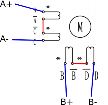

Your current/voltage sums are correct - power = volts x amps - but in this case, because the loads are pulses, of varying levels, and don't happen at the same time on all motors, then the average is lower than the sums suggest. In addition, using a linear PSU is a great idea as it is able to cope with short duration peak pulse overloads with ease, as long as the average load stays within spec. Translation - you can safely get away with it! Switch-mode supplies are cheaper, smaller, and lighter but do not like even very short duration overloads and go rapidly into sulk mode.
In your wiring diagram, connect A to C, -A to -C (can't replicate the exact terms in your diagram but I'm sure you can see what I mean), and then A/C to A+ on the driver, -A/-C to A- on the driver. Ditto for B&D. I think you know that you only then need four wires back to the driver.

Your motors are Nema 34 so running them in parallel becomes even more important for a router. Large motors like these have a higher inductance than smaller NEMA 23 motors which means you require more volts to get the same rpm. Torque drops away much sooner up the curve with NEMA 34's so if you have them wired in series this compounds this even more which is why higher volts are needed to get high speeds out of nema34s.
 The setting is per phase so just set protune to the spec sheet per phase rating ie: 4.2a

 Neale,
Have another look at this please. My assessment of the drawing with it's 'start of winding' marks would suggest connecting A to -C  and  -A to C to create an in-phase pair of windings. It seems an odd way to label the wires but I think it's correct and agrees with the standard drawing....
Attachment 29543
Re: Help - Current For Stepper Motor Driver AM882 - ProTuner
Kitwn
			Neale,
 Absolutely correct - that was a weird way to label the connections! "Start of coil" ends of windings (marked with star) should go together. I confess that I was looking at the lettering and not the "star" marks - and the lettering does not seem to follow a logical convention. Nothing would have blown up my way - but nothing would have gone round either...
Well spotted!

 My bristles came from a draft excluder but your milk bottle idea made me think of the printed skirt idea, it's hands off and much less tedious to do. As for the wiring I think Kitwn confirmed what I thought when I read that so below is the schematic I'll follow when I rewire my motors...
The printed skirt...
Attachment 29544

 These motors are NEMA 23, I got them from Zapp a few years back but either they've discontinued them or for some reason, I may be wrong they seem to be listed as NEMA 24. Either way the frame size is defo 23. I might have used the wrong diagram but I wasn't brave enough at the time of buying to get the 34s. I bought all the electronics before I'd designed the machine. I was 10 years younger back then and didn't know exactly what I was doing or getting into.

OK first off one by one I rewired the motors in parallel and set the amps/phase according to the chart given for the motor after that I tuned them all upto remove the resonanse issues. Now they sit idle and are much quieter and I'm now confident that their torque is much more suited to my setup. I tried a cut at 5mm deep in Trespa (HPL) at 3000mm/min without any problems other than the expected noise from the cutter. It didn't skip a step and the final part was as expected.
As for the dust boot I tried the 3d printed skirts in PLA but if you're thinking of replicating it I'd say don't bother, it didn't work. PLA might be stiff but it's still too brittle, maybe another material might work but mine went into the bin. I work in a business that does plastic fabrication so had a decent offcut of clear flexible PVC sheet, the sort you see hanging on doorways. I ended up using that with 8mm strips cut in to act like the bristles would have done. It works well enough but I'd still say bristles would be better but maybe I'll do that at a later date with some 0.15mm paintbrush bristles.

		Assuming that the current tuning is setting the winding current then the supply current from 68v will be much lower as the drivers in effect are switched mode PSUs.
