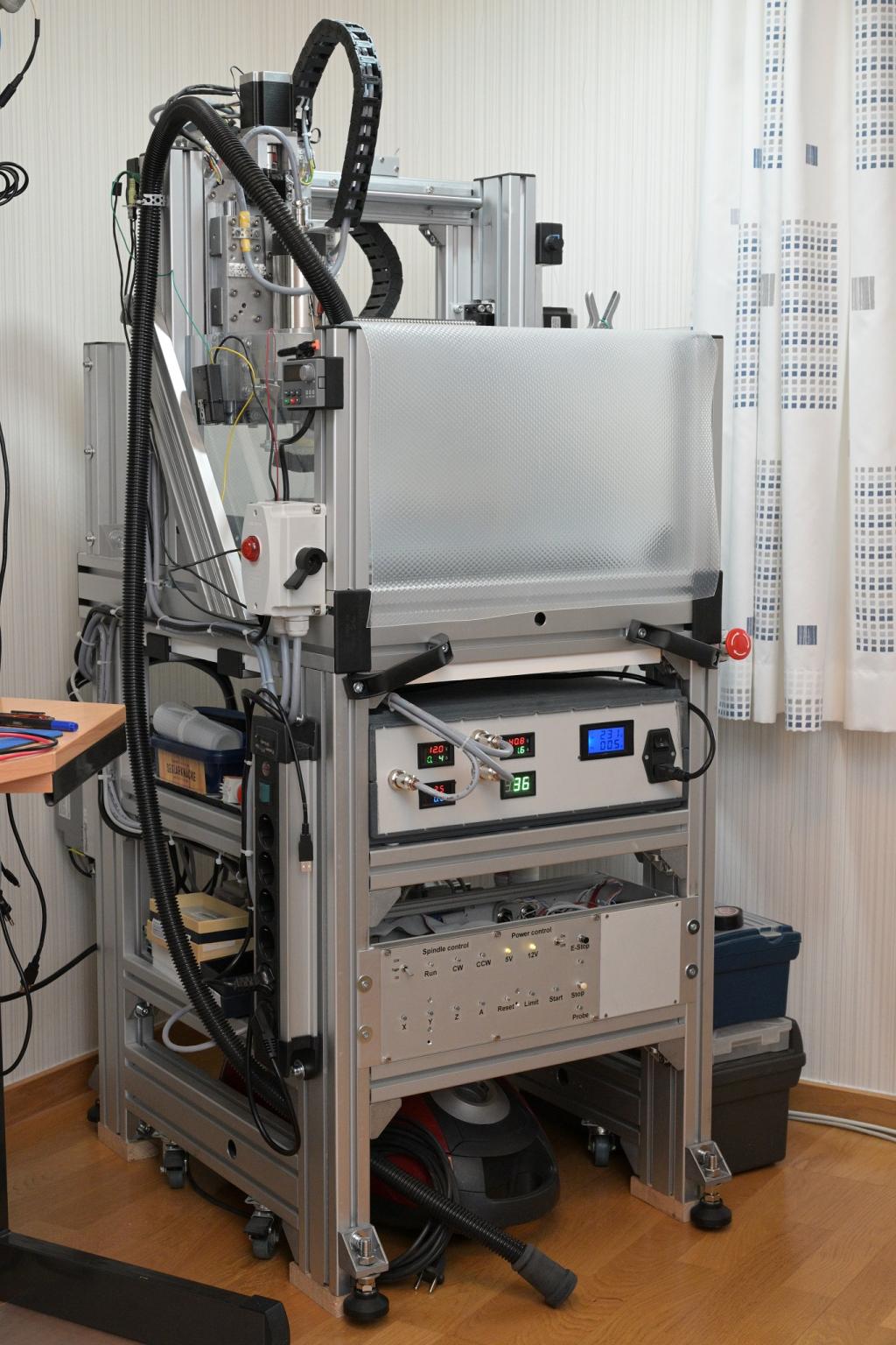

How I move around my heavy DIY CNC
My machine is nowhere near as nice or heavy as many others here, but I don't feel I have to be ashamed of it, I built it completely on my own, cut and drilled, threaded every bit of it, so all in all, I am pretty proud of it, especially since I am an "office rat" engineer since the last 30-ish years. At work I never have to use any other machine than a computer, and even that only through the keyboard. Never the less, I miss my first 20 years of working life, not only because I was MUCH younger, but also because I do like to use my hands and brains in many ways, so at home and as a hobby, I take every opportunity to get my hands "dirty".

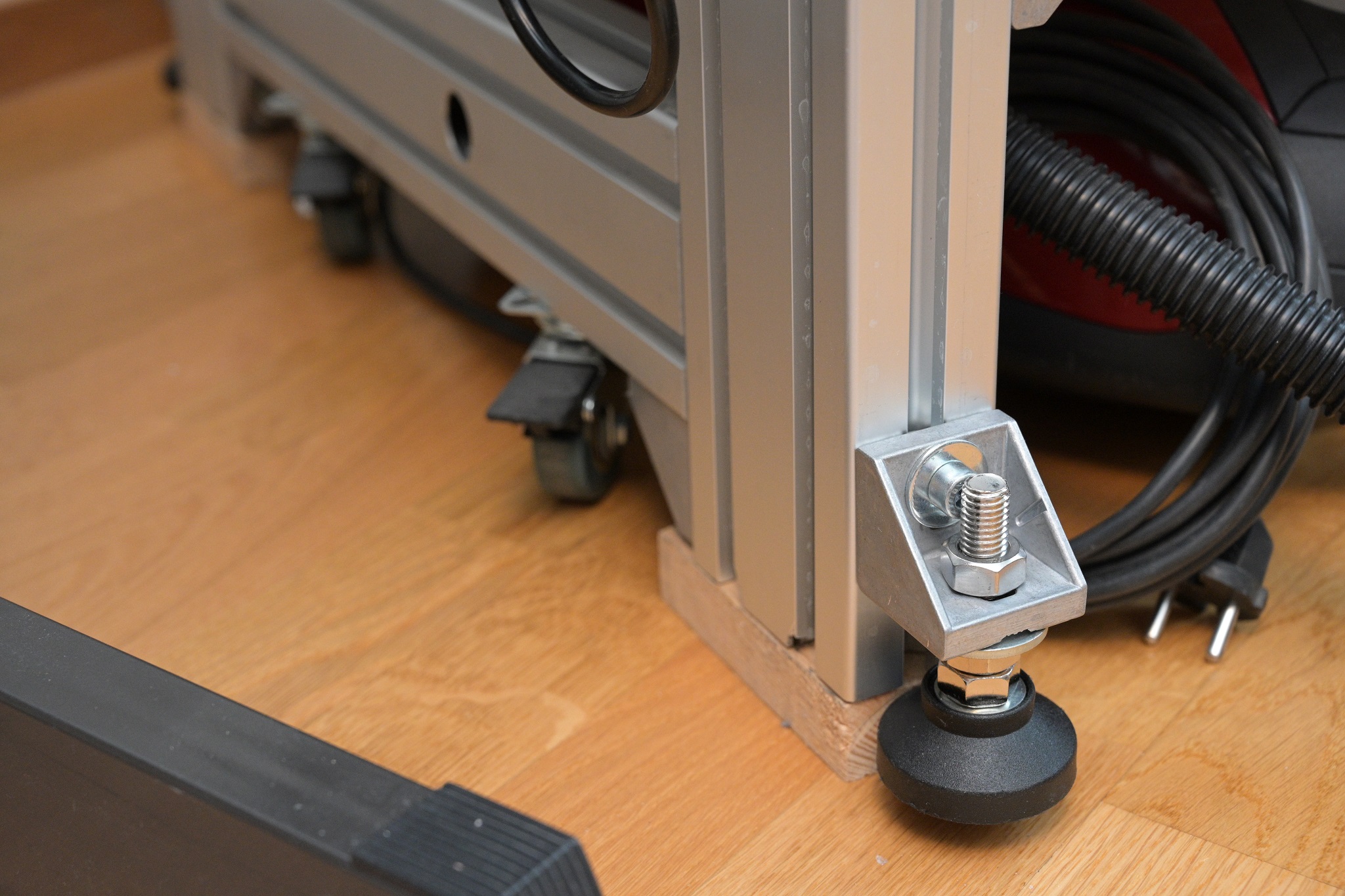

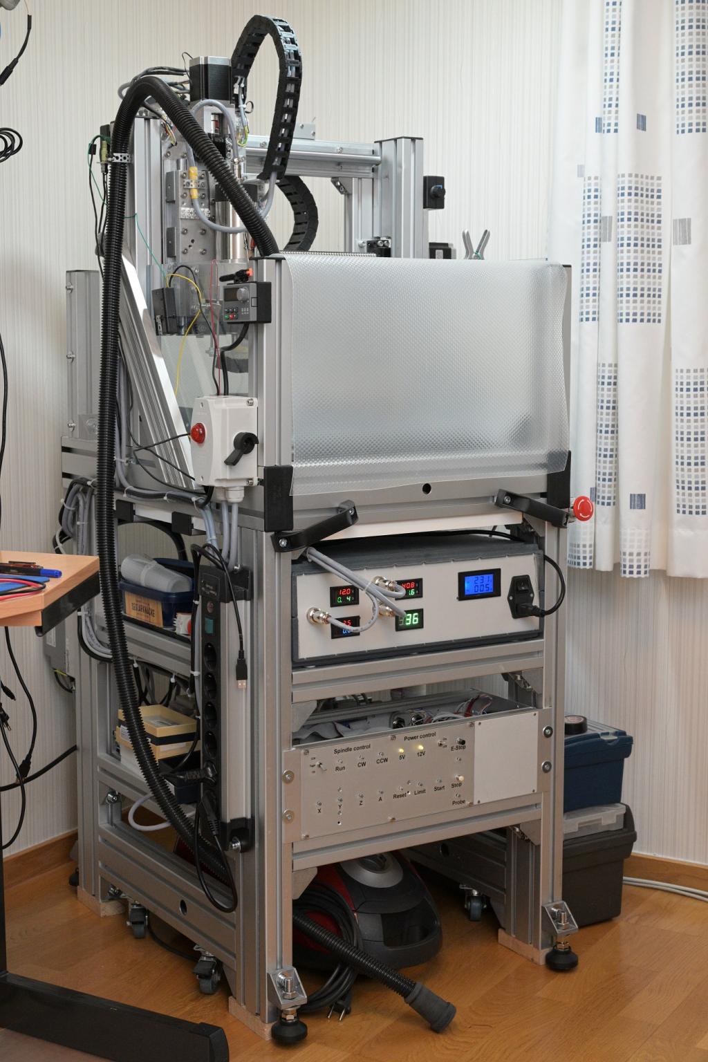

So, this is how my CNC looked like a few weeks ago.
Attachment 29561
I built this a few years ago and use it mainly for plastics and PCB, but also mill aluminium pretty well on it, so for my needs the machine is definitely good enough. From the start I kept track of the weight, but as time went by, the machine got heavier and heavier after all the modifications I constantly make. I knew it was more than 100kg, but not more exactly. The other day I managed to check it more precisely by placing two ordinary bathroom scales under it, just for fun, to check the exact weight. One showed 60kg, the other showed 65kg, so now I know that the total weight was 125kg, which explains why it was more and more difficult to move it around. I noticed this "problem" some months ago when I moved to another, larger room in my house. This is the way I had to do it:
Attachment 29562
I had to lower the round black feet on all four corners to lift the machine, remove the wooden blocks the machine normally resting on, raising the black plastic feet to lower the machine on the four castors, move it to the new place, lift it again, place the wooden blocks under it and lower the machine on those. It was a complicated operation, which actually put me off from doing any improvements and modifications, so I decided to do something about it.

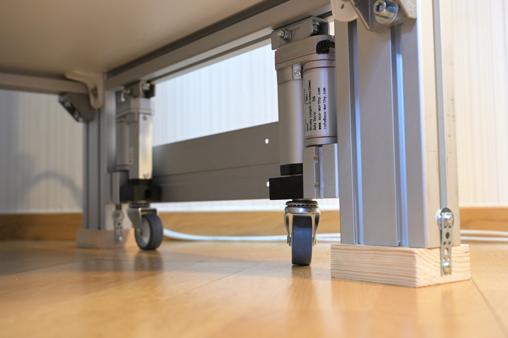

What I did was I ordered four linear actuators, installed castors on them and installed on the four feet.
https://youtu.be/4sUEEOjzpeg
After installing the actuators, my CNC looks like this if I take look in an upskirt view...
Attachment 29558
Each linear actuator can lift 152kg, so I knew I had good margin. The only thing I am not that happy about is that they extend to three different lengths, only two are the same, but in this application that is not critical.

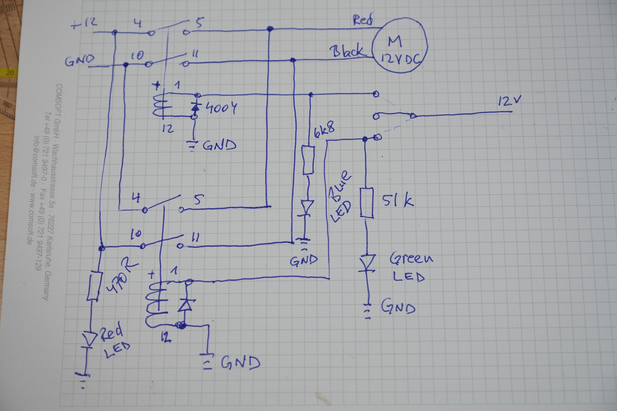

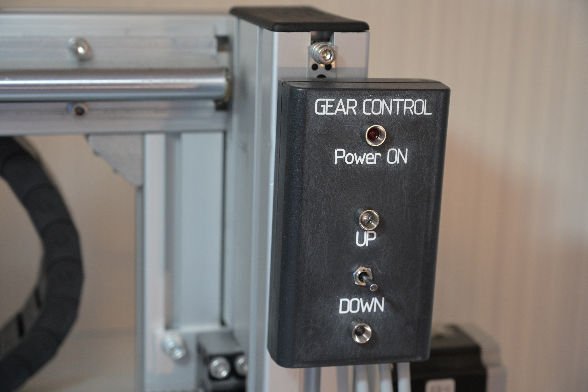

I made a control box with some relays, a switch and three LEDs to control the actuators.
Attachment 29560
Of course, simplest would have been to use a 3-way two pole switch, but I had no such thing in my boxes and drawers. I had however more than enough relays to make it, so I went for a relay based solution.
Attachment 29559
The box isn't as nice as I wished for, but it does what I wanted it to do. This was the first time I made this sort of engraving, so it's OK for now, but I will make a new box top with better polished surface another time. Now it is easy to move my machine around, just flipping a switch and that lifts the machine with the wooden blocks permanently attached under it's feet. No more crawling on floor for a simple move.
Anyway, the subject of moving around heavy machines is often discussed, also if CNC can be permanently on castors or should rest with better stability. Initially, my CNC was on large, heavy duty castors placed under itīs four feet (not like you see in the top picture), but even though each had a lock, preventing rolling, the CNC was shaking because of the rubber wheels and the fact that they are wheels. So my conclusion was that castors are good for moving the machine, but using it resting on castors is not a good idea at all. I considered fixing it the wall, but then I concluded that it will shake the walls and it would be better to let it rest on wooden blocks on my floor. Under the teak parquet I have concrete floor, so there is no floor vibration, and the CNC is resting firmly on the soft-ish wooden blocks, which are soft enough to dampen the machine vibration, but hard enough to provide very good stability. Actually, my CNC works much better, with higher speed, acceleration and accuracy than it had when it was resting on castors.
I feel that my solution with the linear actuators can be used on many other machines as well, and is not adding much to the price of those 400kg + machines, so I don't understand why we don't see any of those. I have seen people building hydraulic systems, which may be needed to machinces which are REALLY heavy, but for the few hundreds of kg our machines weight, I think a pure electric linear actuator is more than enough, simple to implement and can lift quite a lot. Even if a machine weights more than 600kg, it is possible to use the type of cheap actuators I am using, but of course, it may need more than four. In general, I think it ia a good idea to leave some margin, personally I'd feel comfortable to use it up to 400kg, which would leave a 200kg in that case.
In short, I don't think it is a good idea to build CNC which rests only on castors, it is much better to lower the castors when the machine needs to be moved.

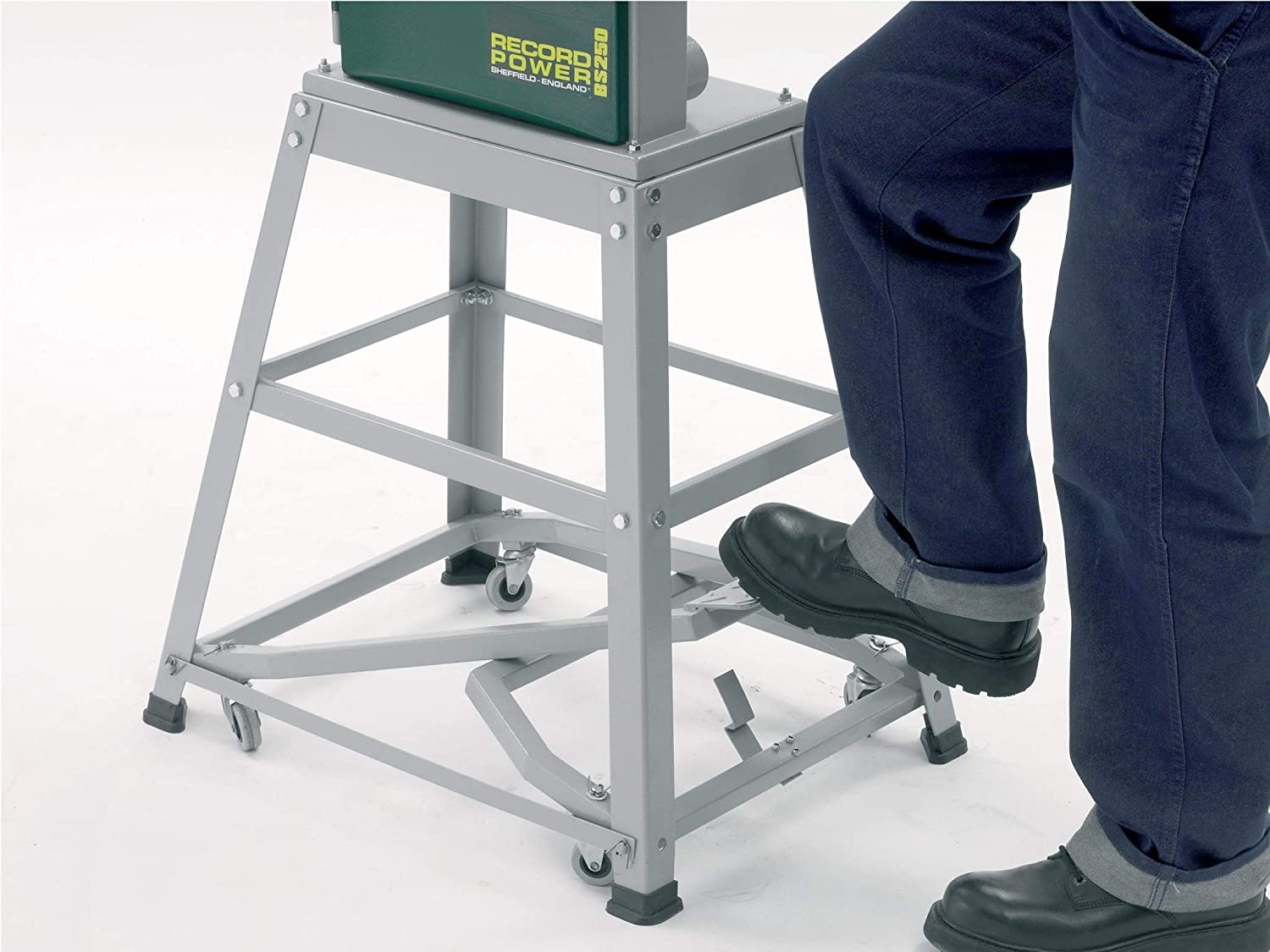

Hi, thanks for sharing this experience and your solution. My first reaction was that it was rather an over engineered solution, as I am rather more used to small workshop solutions like these or these. However a quick check on eBay suggests those actuators are only around Ģ30 each and work for machines in the 200-500 kg range. Plus as you say simple switches and power supply is all you need. Now I have definitely stored this idea away should I need to move my machine regularly for pass through jobs. The satisfaction each time you flip the switch rather than lie on the floor winding up machine castors like these would hasten the pay back!

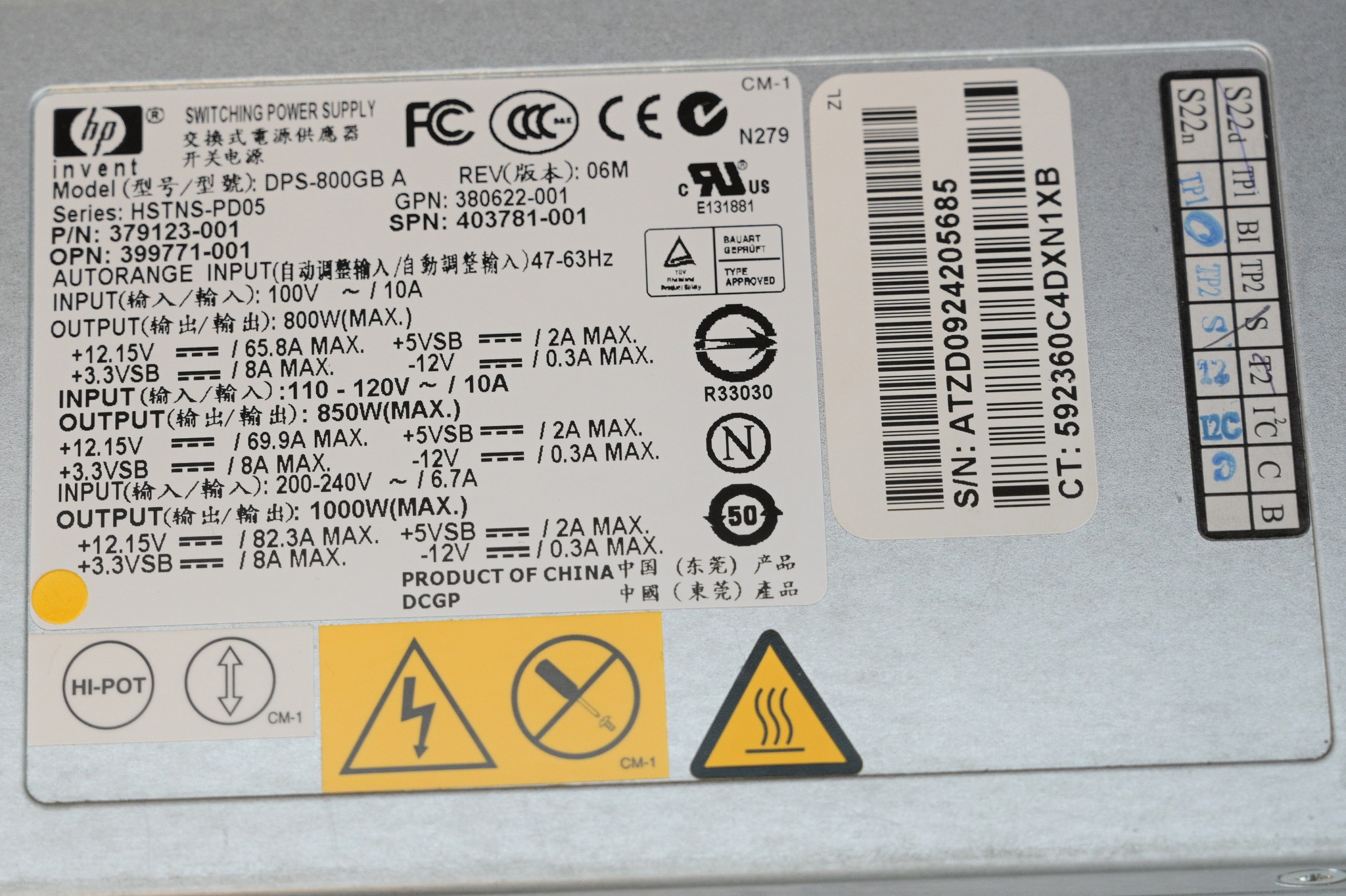

BTW, yes, my control box is definitely over-engineered, but as I said, I had no switch for the high current and I like to use what I have when it is possible, so I had to use relays. In fact, I am using four relays, two for one side two for the other, because the relays I have can't handle all that current (around 12A) so I use two relays for one side and two for the other. The 12A is just a guess, but my PSU to the acuators is a 12V 8A PSU which is OK for now, but if I stop the motion half way in the lifting process then the PSU stalls and the actuators won't continue the pushing. The rated current is 3A for each, but I haven't measured what is the current needed to start with load. Anyway, on my to do list is the replacement of the PSU with a 12V 82A version. Yes, eighty two amps. Once again, it is over-engineering, but I have many PSUs like these:
Attachment 29568
So I will use one of them.

You have got me wondering whether a combination of your linear actuators and a lever system like on that bandsaw stand might be ideal for a mobility solution if one need to build a steel frame anyway. Maybe one for each side, as with the additional leverage two 1500N actuators would be good for weights up to 500kg easily.
I had a similar idea as well, using two actuators, but did not do it because I need the space under my CNC for the vac. Also, the one in that link is I think too weak, but I can be wrong about it. It is however definitely good enough for a band saw or similar.

Is that a server PSU? I have been told they are a cost effective solution if bought refurbished off eBay.
Yes, it is from HP G7 servers. We threw away quite a few last year and I saved a few PSU. They are excellent and easy to use, but beware in case you want to buy a few, the 12V GND is connected to the earth, so connecting these in series is a bit tricky. Of course, the problem is solvable, but you have to be aware of it
