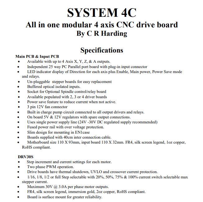

A_camera, Doddy, thanks for replies.
I think the existing system will have the opto isolation built in,I'll try to attach Ist page of manual. (I got it in 2012 and the guys website doesn't seem to exist any more)

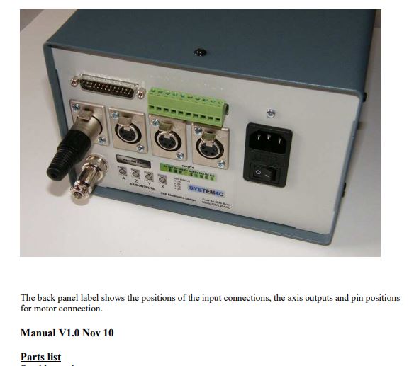

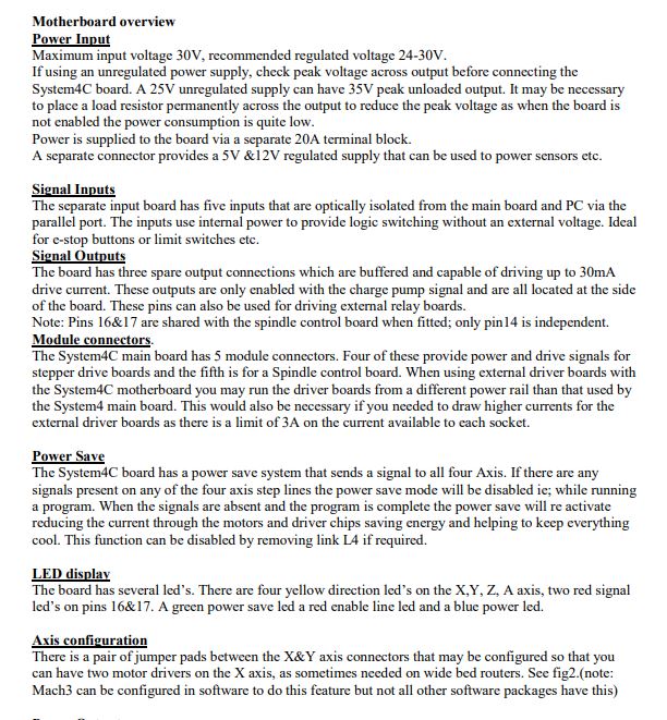

Hi Doddy
My fault for not giving much detail, heres a couple of pics from the manual
Attachment 29709Attachment 29710Attachment 29711
I don't have motor control, just the 3 steppers.

That control box (System 4C - I've found the PDF for it) - implements the functions of the BoB across 2-3 boards. It's fine. Just don't try to power the UCx00 5V supply from it (100mA max).

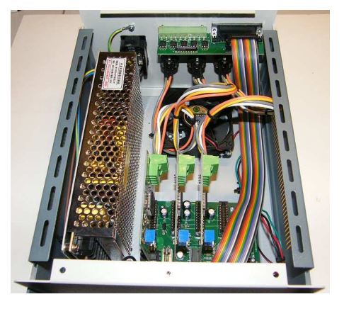

Doddy, you have interpreted my intent correctly :friendly_wink:
So connection wise I think I'd only need a D-sub 25 pin connector to solder on to one end of my lpt cable.
I'm hoping you were meaning the main board 12V (12-24) supply for the UCx00 when you mentioned 5V.:friendly_wink:
I had realised the 12V board supply isn't rated highly enough for the UCx00, which is a pity.

I see. Thanks for clearing the confusion. Yes, that's easy to do. You just plug in the UC400 to the DB25 on the box. No need of soldering because there is a ready made ribbon cable which is delivered with the UC400, which is the obvious choice for you. Just connect that to a small psu and to the LAN and off you go. It should work immediately once you have configured it. Will you be using UCCNC as well? I think it would be the best and maybe CNCDrive has some special deal when you buy both. I got my license almost for free when I bought my UC300ETH some years ago.
