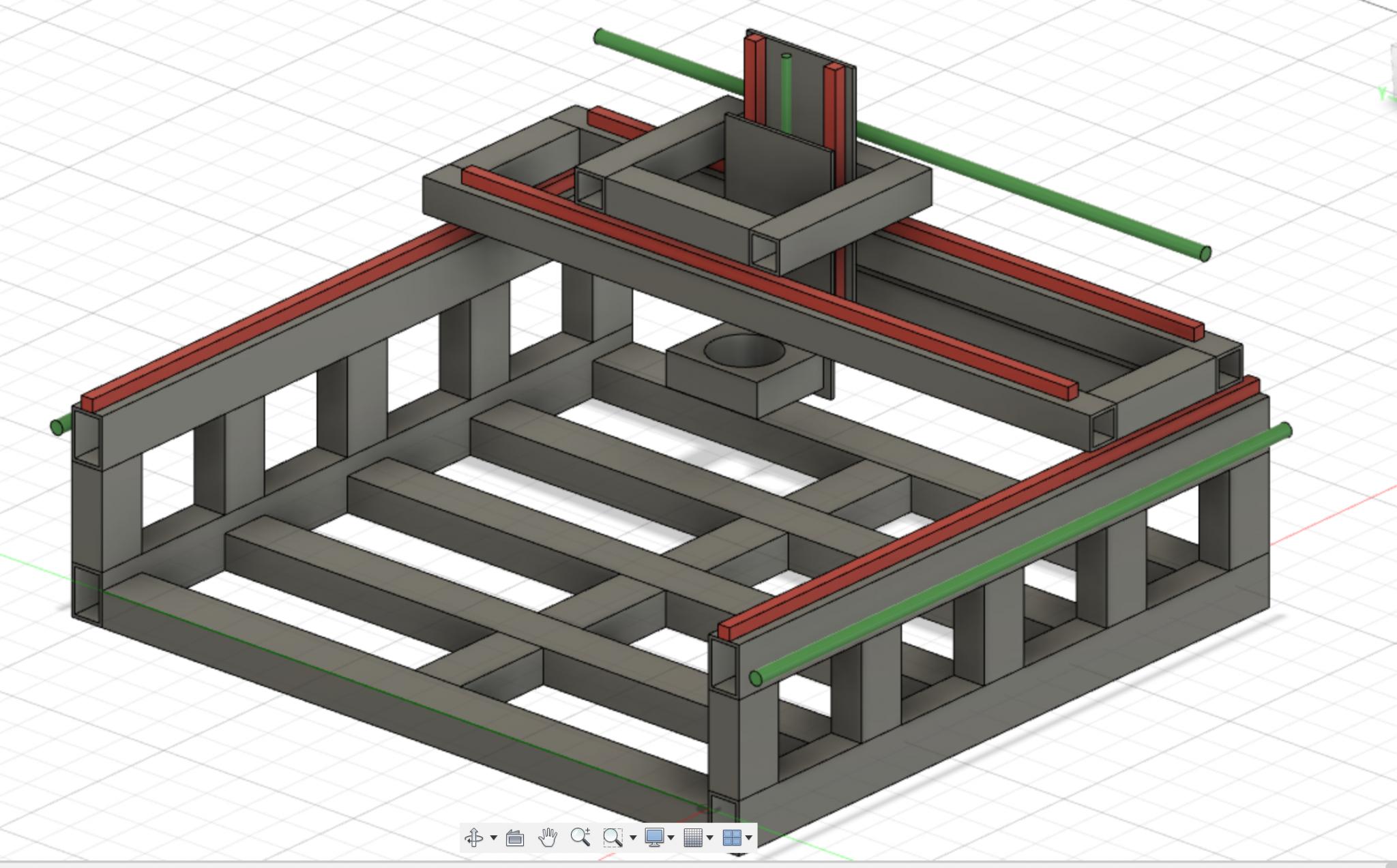

Hello, I am new to the CNC world, I am a graphic designer who enjoys building stuff and tinkering with the oily bits of old cars…
I am looking to build a machine that is suitable for hardwood and occasional light use with soft metals. I started looking at off the shelf solutions such as the Workbee and Shapeoko machines I am seeing mixed reviews and they are not exactly cheap for something that I will likely outgrow. I also saw many suggestions of building a CNC from scratch, I am pretty handy with a welder and steel is cheap and strong so I think this is the best route for me.
I am planning on building the below machine out of 60x40mm box section 4mm thick, with the gantry and z axis support being 40x40mm 4mm thick steel using epoxy to bring everything into tolerance. The plate for the Z axis is planned to be 5mm thick.
All rails are planned to be 15mm from BST Motion on Ali Express (marked red on the screenshot below). The ballscrews (also from BST) are marked green, I was planning on using 1610 for the X and Y axis and a 1204 for the Z axis.
For drive motors I plan on using 265oz 2.8amp Nema 23 for the X and Y axis and a 175oz on the Z axis. Then run it through an Openbuilds BlackBox for control (all from Ooznest). Then use either a 1.5kw or 2.2kw liquid cooled spindle from BST.
This screenshot is a work in progress, I am also new to Fusion 360 but it isn't so different from the adobe stuff I have used previously. I still need to add supports/brackets for motors/ballscrews, carriages for the rails and work on the Z axis further.
Does this look like some sort of workable plan or do I need to have a rethink? Any comments, advice or constructive criticism welcomed…
Attachment 29728
Re: 800X800 Build - Little to no knowledge of what I am doing…
Nearly slipped thru the net this one.!
Ok well first the base frame is pretty much ok, just a little bracing on the corner uprights would call it finished.
The Gantry needs a little work and to be honest, I think you are making it harder than it needs to be with this design. If it was me then I'd just stick with a conventional setup and stump up the extra cost of buying a piece of profile. Look for designs that use the "L" shape layout I came up with years ago, it's tried and tested on 100's of machines large and small. It also makes fastening rails and ball-screws much easier.
Next, the Z-axis is a complete right off.!!
I'm assuming you meant steel 5mm plate.? If so it just isn't strong enough and neither would it be flat enough. If going to use steel you'll need at least 10mm and even then it would need to be machined flat. So again keep it simple and go with a 15 or 20mm aluminum tooling plate, it costs a little more than steel but it's easy to work with and just gets the job done.
Lastly component selection.!
The X and Y ball-screws are the correct choice but I wouldn't go with 1204 for the Z-axis, either 1605 or 1610 would be my choice. 1610 allows you the freedom to connect the motor to the z-axis screw with a short HTD belt and apply a ratio, the belt drive helps with resonance and the ratio means you can tweak the Z-axis to do whatever you want and handle a heavy spindle if needed because the torque increases with a ratio.

Thank you for the pointers, I had wondered if my gantry was making life difficult, I was trying support the weight rather than hang it however I suspect I was trying to run before I could walk… The Z axis is the bit that I have found hardest to get my head around, I did indeed mean 5mm steel plate, your tooling plate suggestion seems like a much better solution, I will look at the Z completely afresh. Good to know that I am not too far off with the electronics, the idea of a belt driven 1610 to give me different gear ratios makes a lot of sense.

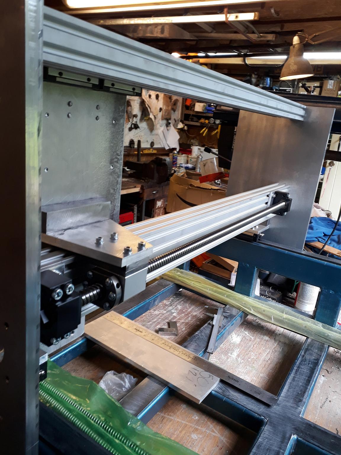

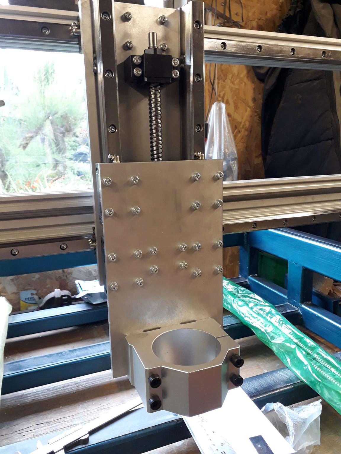

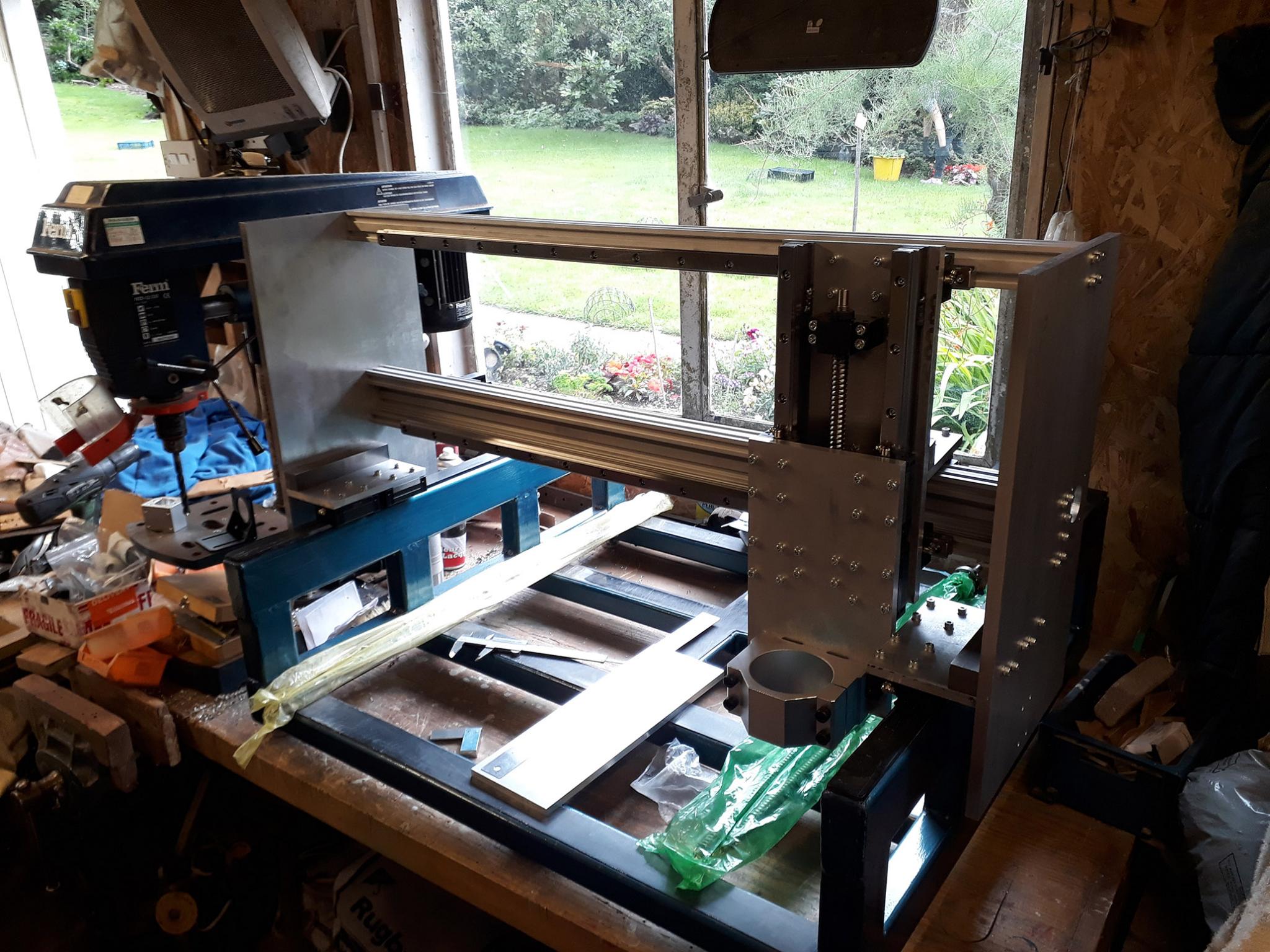

3 Attachment(s)
Progress! I rejigged the plan according to the feedback, ordered a bunch of supplies and got busy with the welder and drill press. I don't have a cnc or mill so this has all been done with basic tools and I am pretty happy with it so far.
While I wait for a few deliveries I am starting to think about motors and controllers. I do not fancy trying to sort out an Arduino, I have looked at the Openbuilds Black Box controller, Duet 2/3 but the Spark Concepts xPRO V5 looks like a good choice for plug and play.
How do I figure out what size stepper motors to use? I have allowed for Nema 23 brackets but I don't know what torque I need, from what I understand bigger is not always better… I am using 1610 ballscrews all around and the gantry weights around 35kg without the spindle.
Photos below show where I am at currently.
Attachment 30314Attachment 30316Attachment 30315

As a first machine I think the structure you have built looks fine, and will get you used to what CNC is all about. You will probably tinker with it and stiffen the gantry but the main thing is you will be learning and listening to the machine.
My first machine in around 2008(?) was made of plywood, with a Bosch router, 20mm un-supported round rails, 16mm ballscrews, 3Nm Nema 23 steppers, and a 24V all in one board (overdriven at 32V). I was not sure if this was a hobby for me, or if it was a passing phase, so went in with a minimum approach. I quickly found the shortcomings and went about upgrading.
Fast forward to 2021 and 4 machines later, plus lots of trigger's brooms in-between, I have a machine I'm finally happy with. The only parts I still have are the stepper motors and ballscrews !

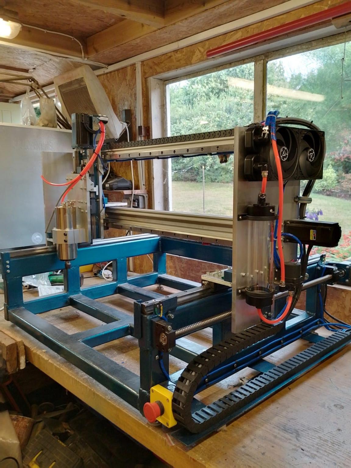

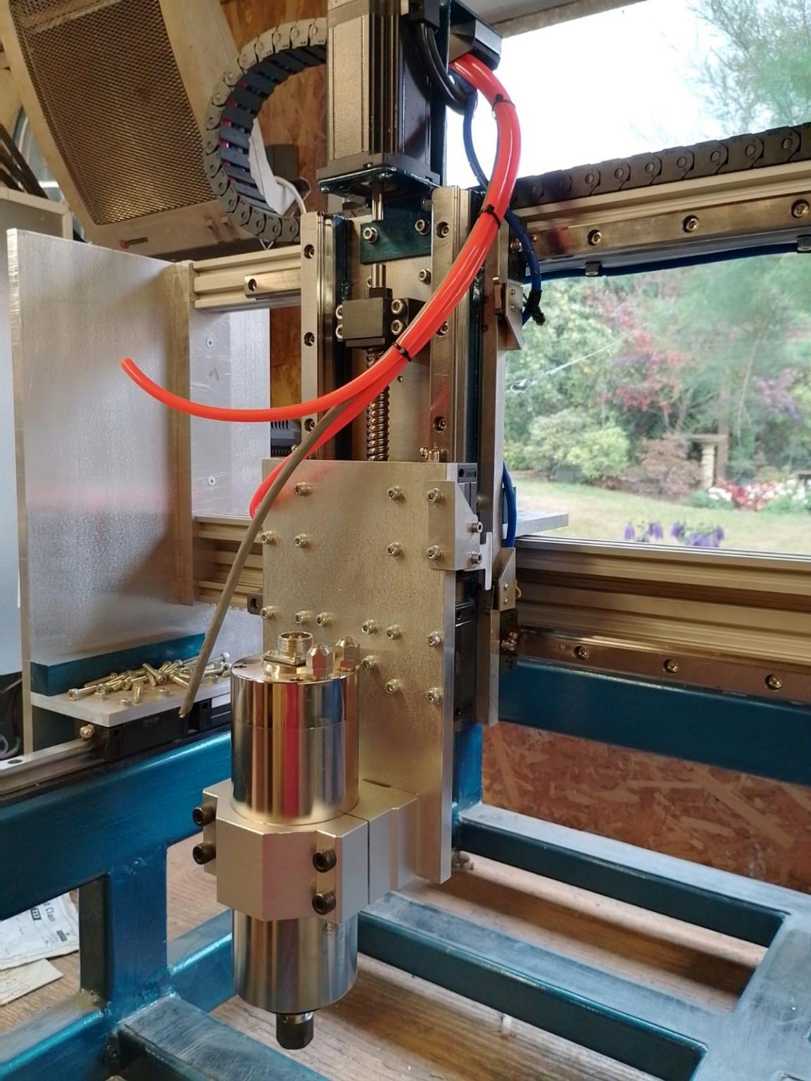

4 Attachment(s)

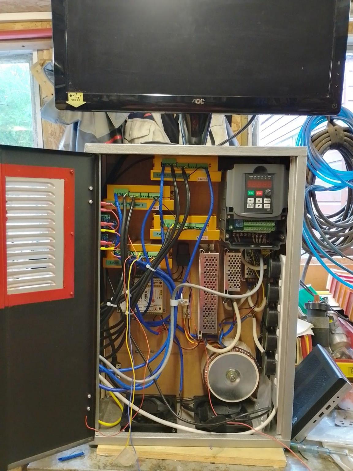

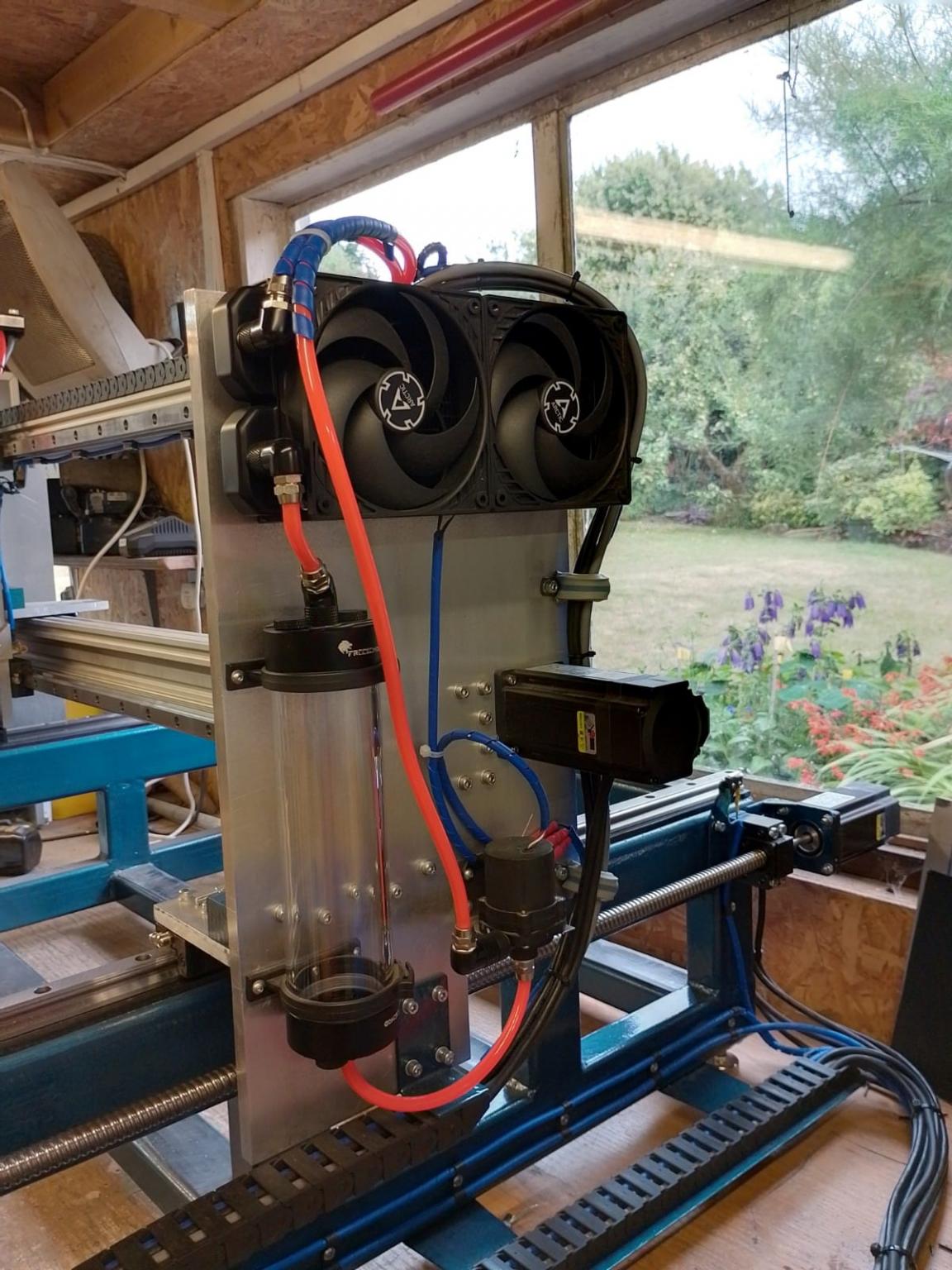

Just logged in to update this and realised it has been just over a year since I started the build… Work got in the way for a good while but I am back on the case now. I purchased the motors, drivers and an AXBB-E from Jazz CNC. So far the wiring has been fairly straight forward, I am hoping I have got it all right thus far. I have been trying to solve a few things but the more I read, the more I realise how little I understand…
How does the alarm system work on the LCDA86H drivers? From what I can work out if wired correctly I can have it work much like a limit switch if a step is missed.
Does anybody have a clear wiring diagram for a xyz touch probe with an AXBB?
Finally does anybody have reliable sources of information for setting up a Huanyang VFD with a Huanyang spindle? The VFD is 2.2KW and the spindle is 1.5KW. I have read the instructions and various bits online but feel like setting it up is going to be guess work…
I am hoping to get the machine running in the next few months
Attachment 31173Attachment 31175Attachment 31176Attachment 31174
