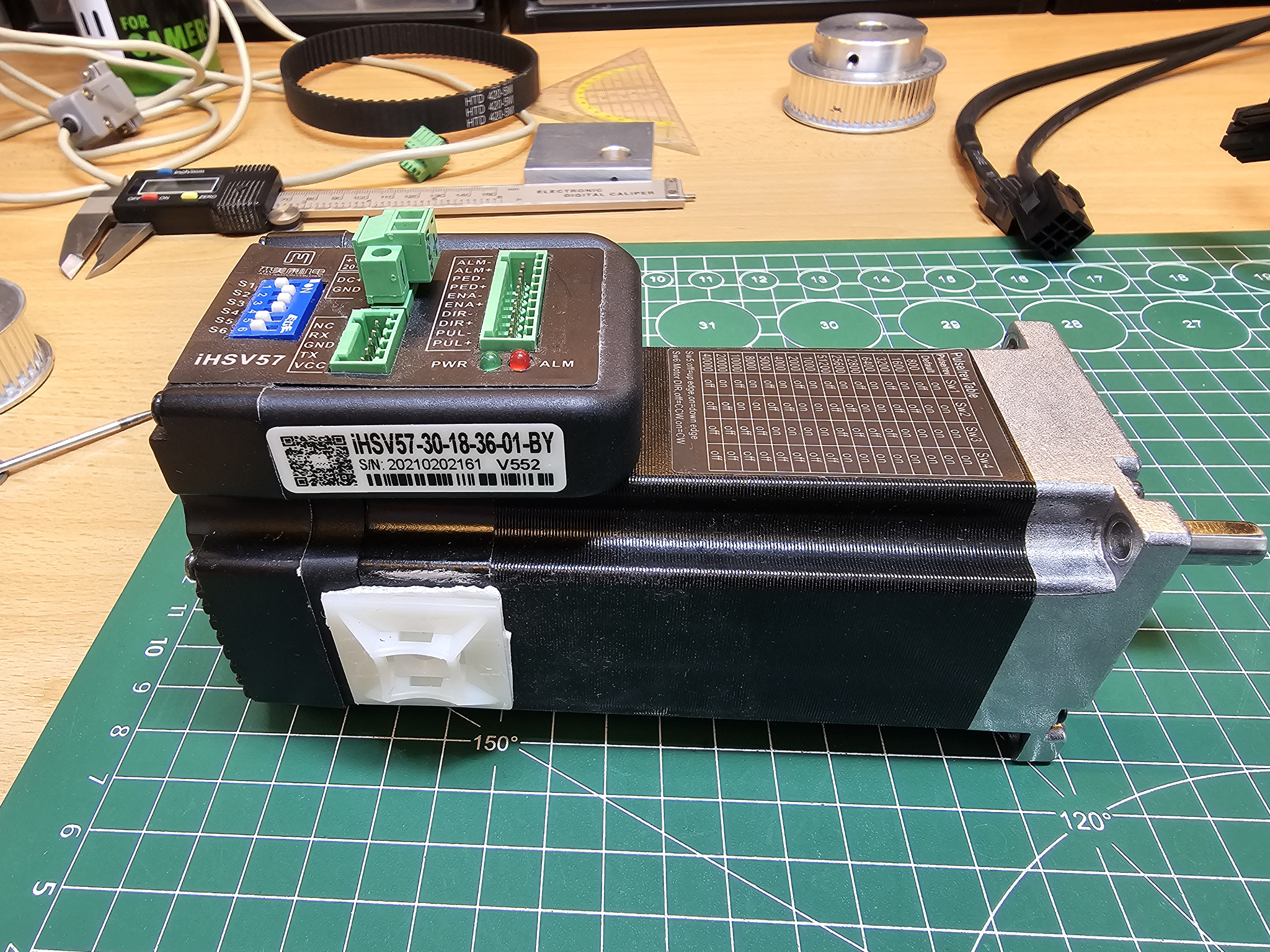

Anyway, while I will finish this with the stepper I have on the chuck now, I am already planning for an upgrade with a more powerful servo or a closed loop stepper. I have already started to look for solutions even for that step. Unfortunately it is not just about changing the motor, because it means I have to change the plate it is fixed to as well, and also get a new timing belt as well as maybe a new pulley. So it may take some time before that step is done.
Right now I am considering this motor:
https://www.aliexpress.com/item/3285...4b6e2e0eyN2Gxo
I have no experience with any closed loop stepper, so I would like to ask the experts. Do you think it is worth the money? My steppers are 1.8Nm type, and this is 3Nm. Would that 1.2Nm make a big difference? Would it run faster? Remember that my current stepper is running at 2280rpm in the video, which due to the 1:6 reduction means 380 chuck rpm, so anything below that is not good. Currently I run the stepper at 2 microsteps, so 400 steps is one rev. and I intend to continue with that. The test condition in that link says 1600 microsteps but I think they mean 8 microsteps per step, which will give 1600 steps per rev. The motor is weaker at that high microstep, and is easier to get higher RPM at lower microsteps.

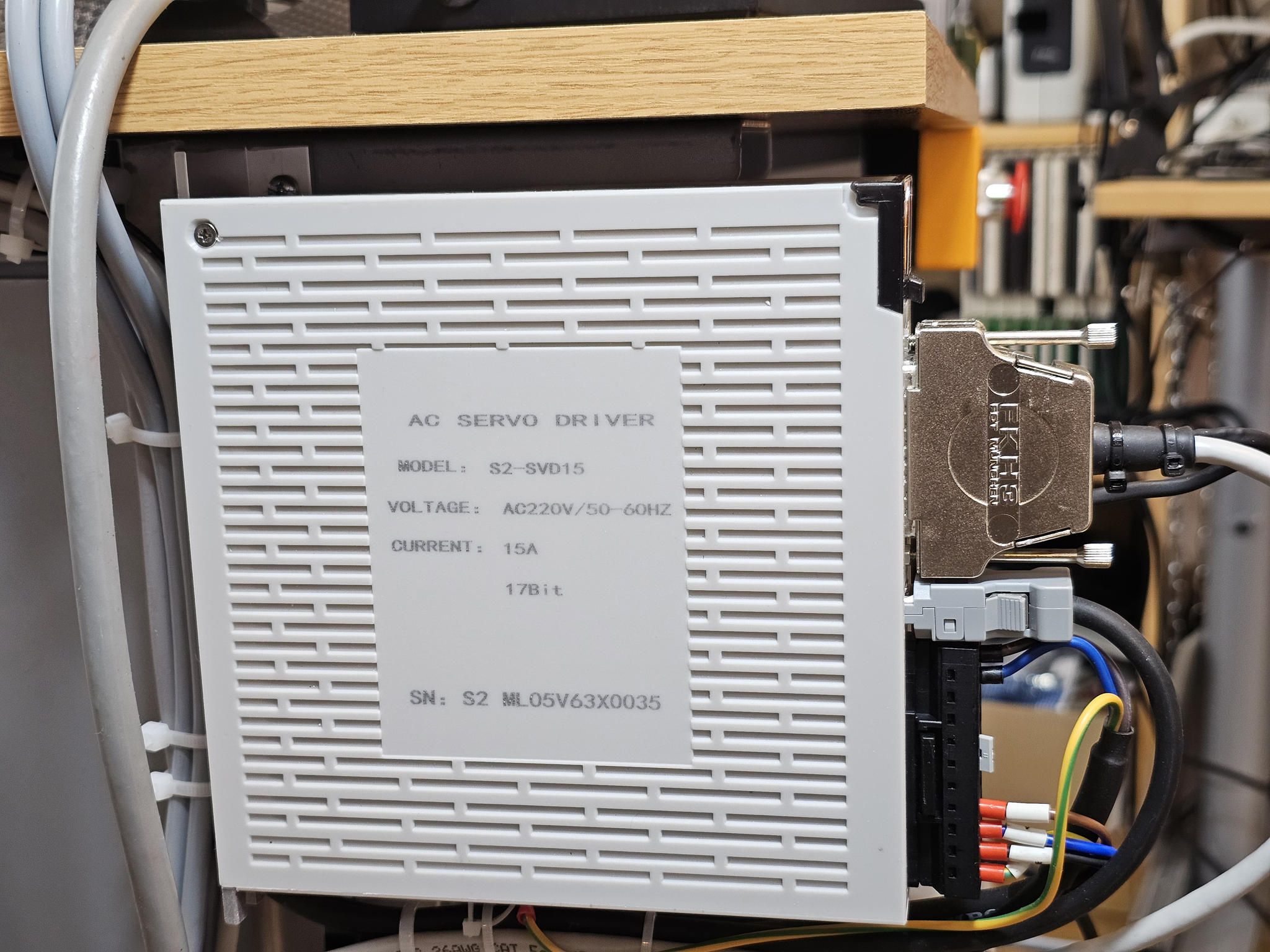

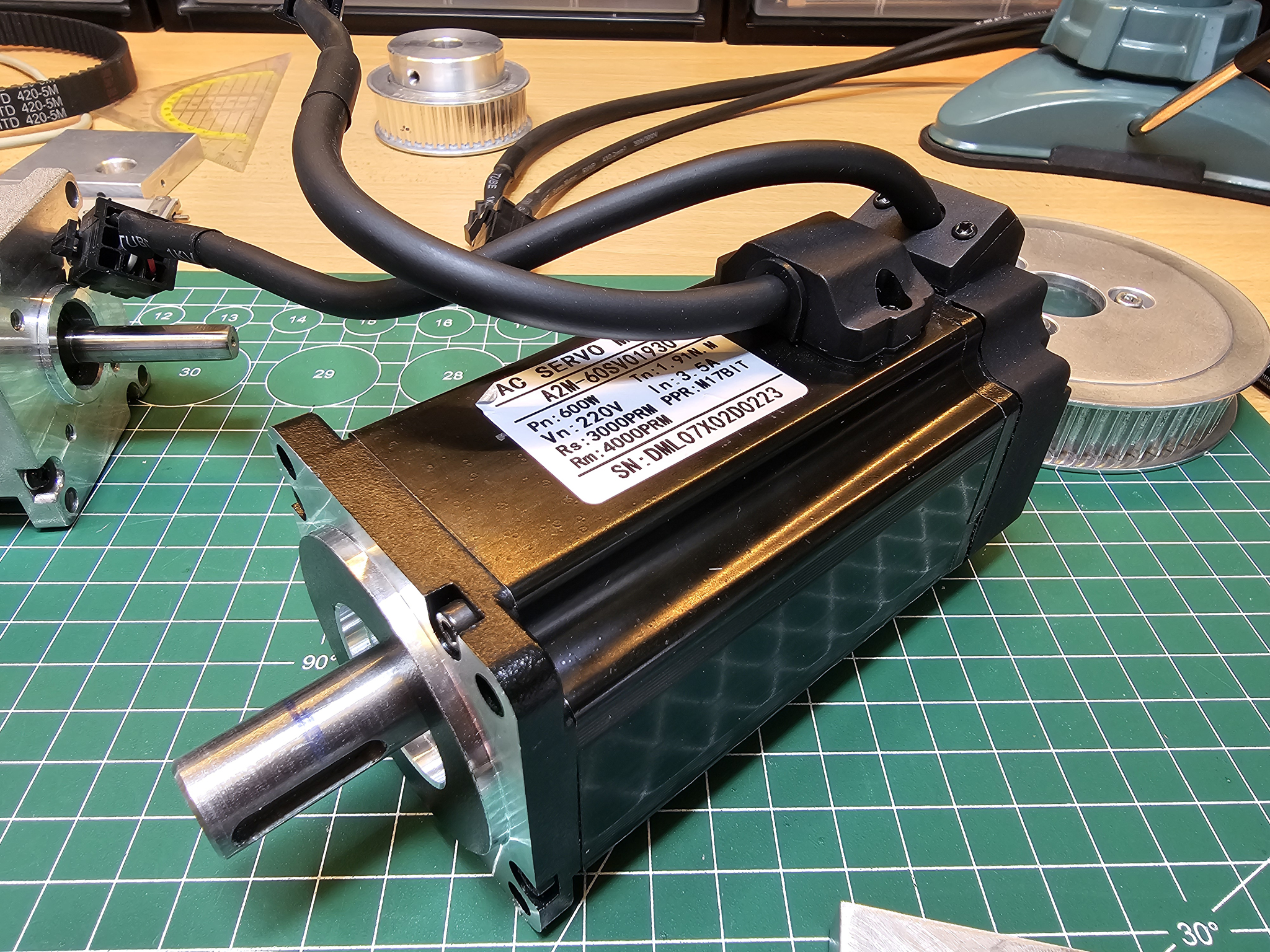

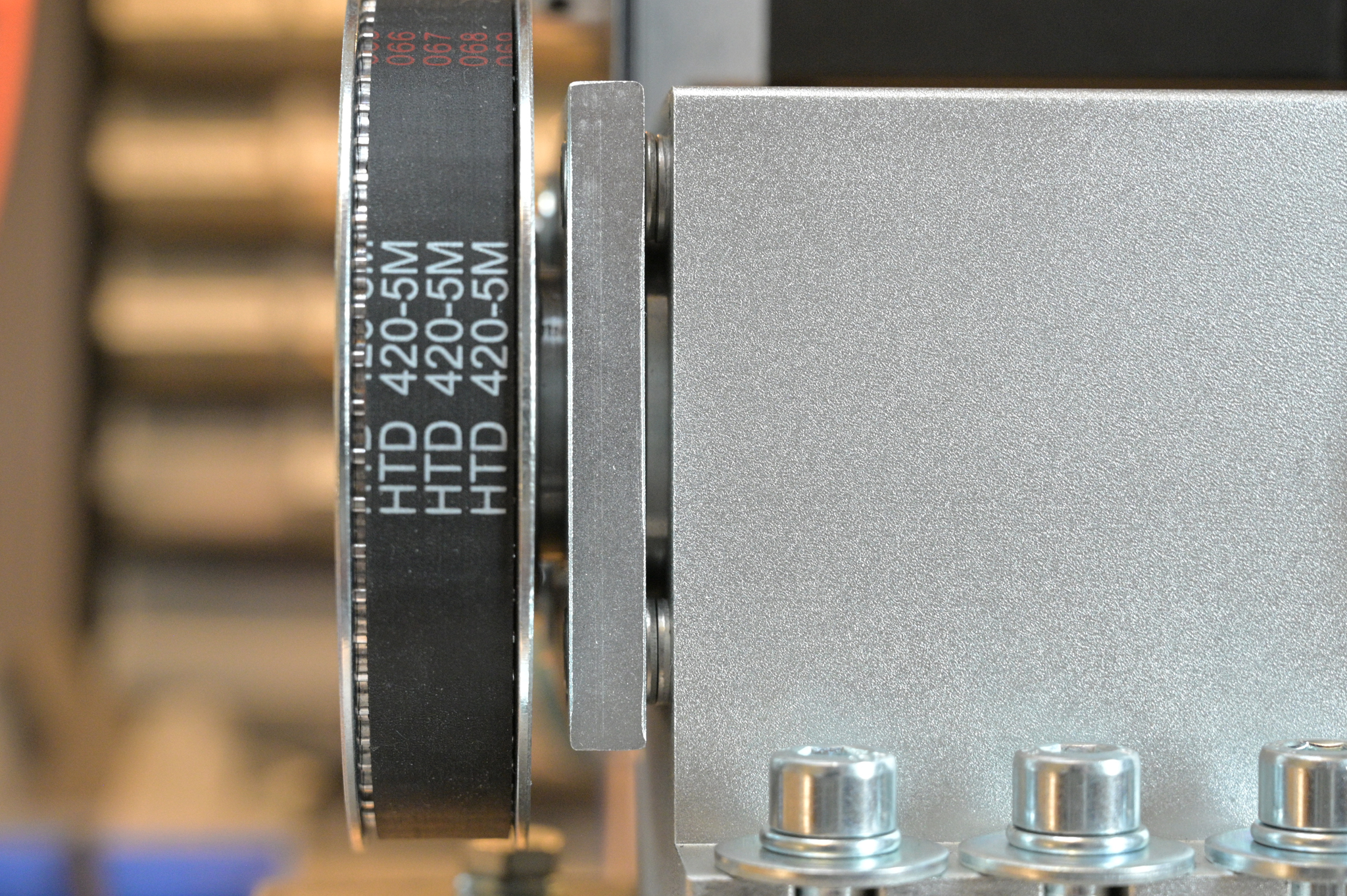

The fun continues. I continued with my "poor man's lathe" project, which has become quite an expensive activity. I made the first major upgrade, changed the stepper to a 180W servo, which required changes in gearing, the pulleys are now 60-20 teeth, so the ratio is 3:1. I also replaced the aluminium extrusion with heavy duty type, added 1605 ball screws and 20mm linear rails on all axes. Of course, the control box also needed to be updated since I can now get 1000 rpm chuck speed.
The change in gearing forced me to replace the belt to a longer one, and I also had to make a new fixture for the motor. I wish I could replace the old fixture with a new one, but I could not find any way of removing the old one, so I added a sort of piggy back plate. Anyone ever removed the motor holder plate, please tell me how to do it without destroying the whole thing. I can not for my life figure it out, and removing the chuck and the large pulley is not enough. Looks like the spindle needs to be dismantled, and I don't want to do it without knowing how.
One thing I am disappointed is the noise. I find the servo is quite noisy. I don't know why, but it is not what I expected. Also, the holding torque seems to be a joke compared with the stepper I had, so maybe this servo is far too weak as a rotational axis, where high holding torque is necessary. Anyway, I will finish the project first, before I buy a more expensive and larger servo.

A_Camera
That doesn't sound right to me, that doesn't sound like a true servo but more like a very resonant stepper motor.
Both DC or AC brushless Servo's are very quiet even at 3000rpm. This video I did about electronic gearing shows just how quiet, jump to the 4min and 16min marks and you will see the motor spinning and hear just how quiet. The motor is a 600W AC brushless servo but DC brushless servos are just as quiet.
https://www.youtube.com/watch?v=bIdzlIKDJeM
Re: 4th axis as a "poor man's lathe"
JAZZCNC
Actually, the sound is normal. The noise comes from the timing belt, not the motor. It is not fair to compare your servo on a test bench with one attached to this spindle through a timing belt. Anyway, my servo is also quiet when there is nothing attached to it. I also made a test bench video, but hadn't had the time to edit and publish it yet.
BTW, what's an AC or DC servo? There is only one servo, but I think you call AC servo a servo which has a drive connected to AC current and DC servo one which has a driver connected to DC current. The only actual difference is that in one case you have the rectifier built into the driver and in the other case you have it built into the PSU. Mine is called AC servo with integrated driver, which requires 20-50VDC, but it is still an AC servo and not a stepper.
There's no black and white definition of AC and DC servo but generally a DC brushless servo uses trapezoidal ("6 step") drive current waveforms and an AC (brushless) servo uses a sinusoidal current. If you drive the motor and look at the phase voltages, so you find an AC servo produces a fairly sinusoidal voltage and a DC servo produces more of a wobbly trapezoidal (rectangular) voltage. A DC brushed motor has just 2 terminals and is driven by a DC current.
Must admit, that machine of yours sounds more like a closed loop stepper. There are 2 quick tests you can do to check. A stepper will feel lumpy when you turn it by hand with the motor disconnected, whereas a true servo will run freely. You could also remove the belt to show that the noise is indeed due to the belt. Having said that, the belt shouldn't be making a racket....

A_Camera
Chill your beans man, I was working on what you said "One thing I am disappointed is the noise. I find the servo is quite noisy." So I took it that most of that noise was from the motor and I was just showing how quiet a servo is compared to a stepper in case you didn't know.
Also, if you are saying most of that noise is from the belts then you need to look at the setup/pulleys/belts because they shouldn't make that much noise. I connect most of my motors to ball-screws with timing belts so have fit 1000's of belts and they make a fraction of the noise you have there.
A_Camera
It's not that simple and the drives work differently regards the motor types, but in both cases, they are virtually silent compared to a stepper which was my point.
I didn't think for a minute or was saying they were steppers but the noise in the video certainly sounds like a badly resonating stepper.

JAZZCNC
Actually, I guess that my comment was a bit too emotional. Here is the sound of the stepper at 380 chuck rpm (2280 stepper rpm).
https://youtu.be/g8rXwJtne38?t=70
Somehow I expected (hoping for) some sort of miracle regarding noise, which didn't happen, but that's OK, I am fine with that for this experiment. In the end, if the whole lathe thing is going to work I may decide for a better solution and a more powerful motor. I think that a larger motor would also be more quiet, but that must wait for now.

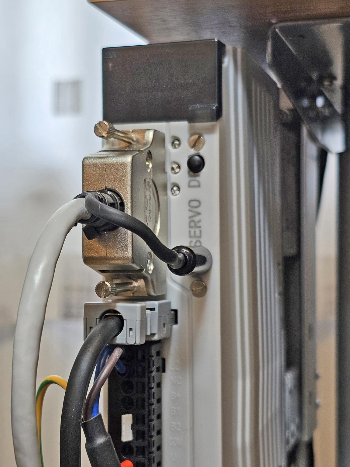

JAZZCNC
I don't know the sort of installation you are doing, but I think that you don't build your motor holder the way I did here, which is the original 8 mm aluminium plate plus a 3 mm steel plate.

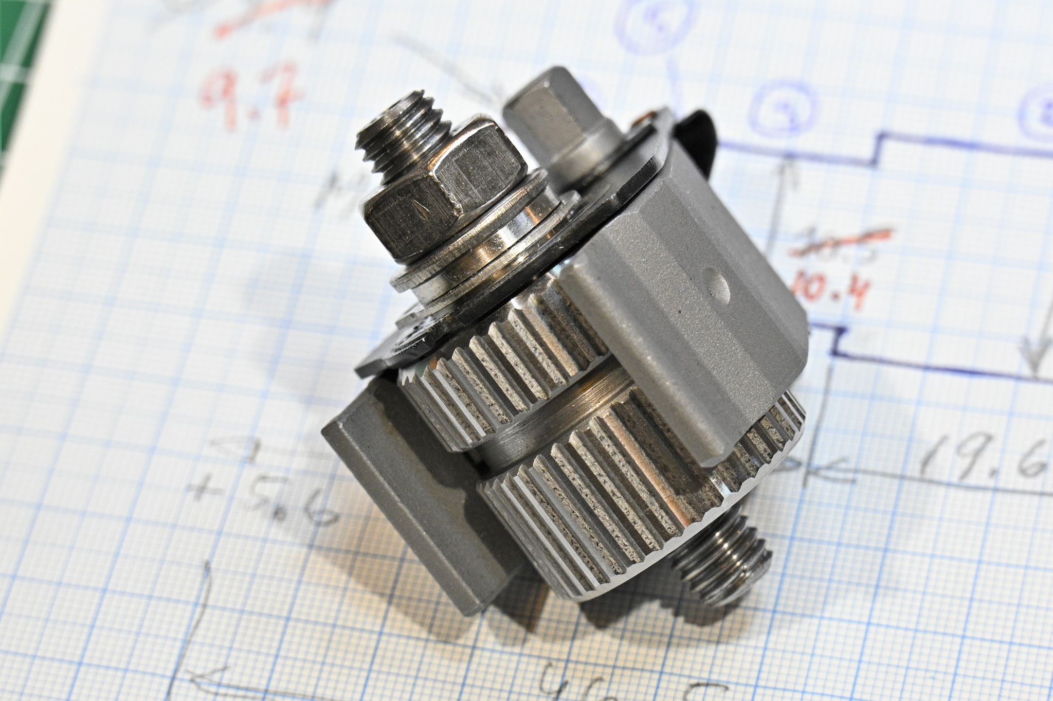

Attachment 30304
The reason for this solution is that I could not for my life come up with a way of removing the original motor holder plate, so I could not replace it with a new, single 10 or 12 mm thick plate, which I intended to do from the beginning, and also because I only had 3 mm steel plate at home, and I have lots of that, and don't want to get other. Of course, I could visit a local workshop and they would most probably free of charge make such a plate for me, or could give me a piece of scrap plate which is thicker, but for now I am happy to be able to do it this way. I also needed longer belt, the 350 mm is been changed to 420 mm long.
Attachment 30305
I also had to add some spacers otherwise the shaft would have ended up too far back. So I think the reason why you don't hear that noise is, apart from the fact that you probably don't run the motor for such long time, is that you also don't have such weird installation, which probably creates a lot of the noise also. With that in mind, plus the fact that my servo is also quiet on the table without load and with a dampening mat underneath, the comment I mage in the video is not fair, the motor is indeed quiet, but my own installation is generating a lot of noise.
So for the future, if I will otherwise be happy with this, then I will remove the original plate through cutting it off and replace it with a thicker aluminium plate in one piece. I think I can do that, but right now I don't want to destroy any part of the machine. Of course, if anyone have an idea about how to remove the original plate without cutting, I'd be glad try and do it that way, but I could not find any video or description in explaining how it was installed the first place or how it can be removed without removing the whole spindle assembly and risking the pre load of the bearings, or causing damage to the spindle or the spindle housing. All I know is that removing the chuck and the large pulley plus the four screws is not enough, the plate can still not be removed.

A_Camera
What I also find strange is that I can NEVER, not once, force maximum current consumption, not even for a very short time. Because I think that is not good, since in that case it can not be called 180W at all. The maximum I could ever measure was below 2A. In my opinion, the driver should increase the current until maximum is reached when I try to twist the shaft when on holding, but long before maximum current, the motor throws an error and just release the tension all together, instead of increasing the current and applying more holding. So perhaps, the motor is a totally different one, while the label says it's a 180W but in reality, maybe it's just a 100W motor.
180W is the rated continuous power at rated speed.
Power output is directly proportional to speed, so at 300RPM aka 10% of rated speed, continuous power output is only 18W.
The only time the drive will draw full power from the power supply is when the motor is running at high speeds and loaded.

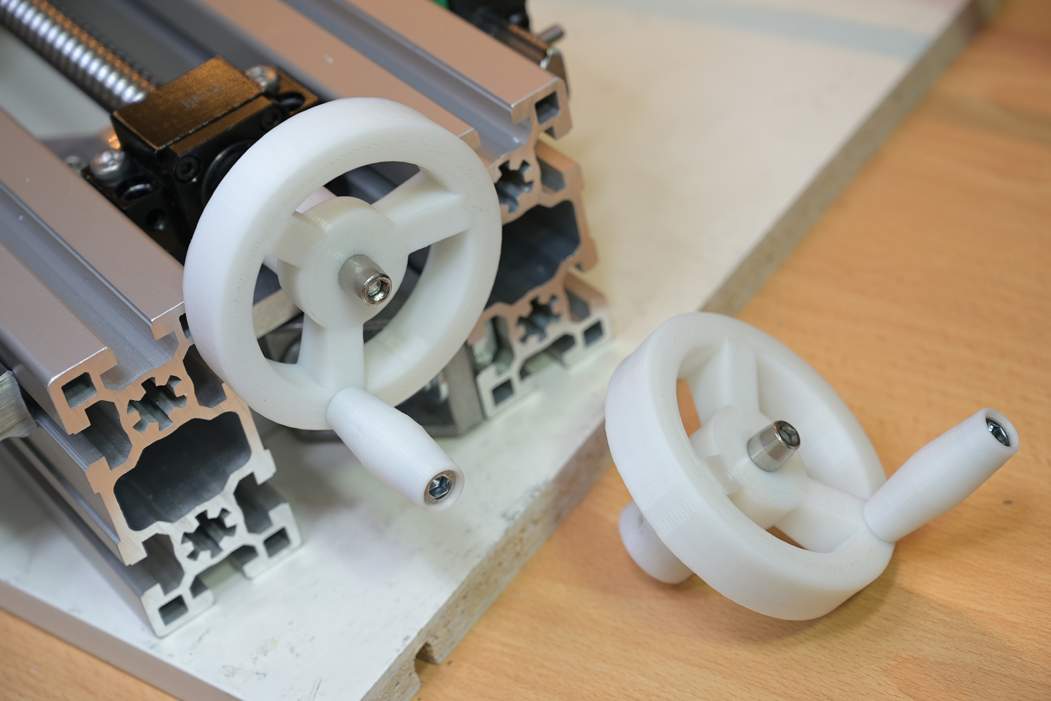

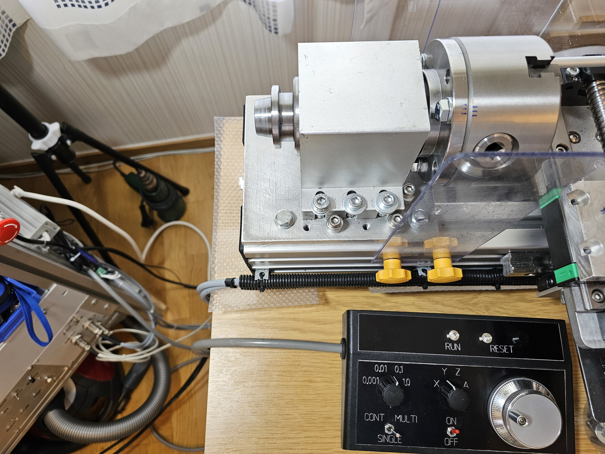

Yesterday and today I 3D printed these wheels which will serve as machine wheels when it is time for the first turning job. Printing time: 7.5 hours each. Made out of three pieces each.
Attachment 30317
Have not yet decided if I will digitize my lathe or not. That decision will be made after some tests, and these wheels will be used until that decision is made.

If anyone is interested in the hand wheel, I made a video about it. There is also a link to more pictures and text and details about how to download the stl files in case you want to print and make one or two for yourself.
https://youtu.be/-YxlNM-9n5Y

I am now ready with the actual basic design and first version of my DIY micro lathe. So far it's only for manual drive, and not really did any test run yet, but the machine is ready and usable as a manual lathe. Not tested yet, because I want some safety features before I make a real test cut, so it is still only cutting air, but any day from now, I'll see if it works or not, but I am quite confident that it will work as I planned and designed it for, mainly small aluminium and plastic parts. If I manage to cut steel also then that will be bonus. Will probably also use for grinding and some threading.
Anyway, here is my latest video, showing the current status.
https://youtu.be/bVynxWKIoyI

My Multifix type tool post arrived and I used it also. It is way better than the aluminium quick change tool post I used before even if it is just fixed with a simple M10 bolt. However, the first use I made for it was to create a tool post holder screw. I measured all the dimensions, found a piece of steel rod in a hardware shop near me which I could use and made the tool post holder. It took some time and not without mistakes, but finally it is ready. It is not perfect, but will be much better than the threaded rod I used originally. I will probably make a new one without the mistakes, now that I learned something while making this one.
Attachment 31834
Attachment 31835

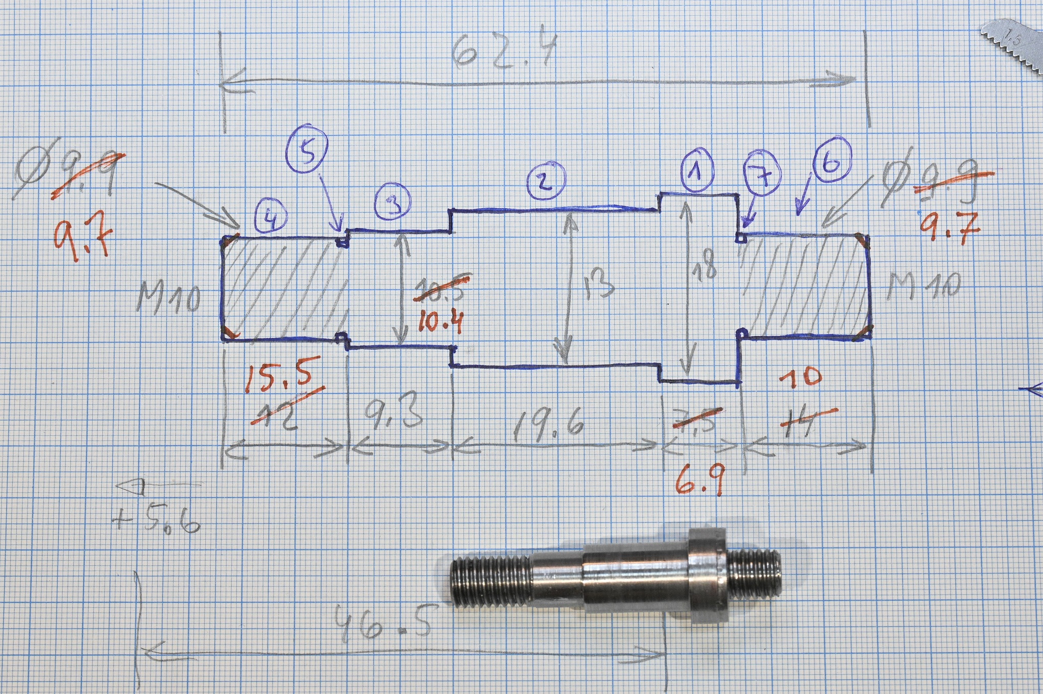

I made a video regarding this upgrade and the making of the tool post holder screw and nut.
https://youtu.be/uQzUsYaM68Y

I decided to make an upgrade (actually more than one...) of my CNA lathe.
Number one update is to change the spindle motor.
Attachment 32276 Attachment 32277 Attachment 32278
While the 180W 50V DC servo works surprisingly well, I want some more torque and higher RPM, so I bought a 600W AC servo. This motor will allow me to change the gearing from 1:3 to 1:1.5 so I will get a maximum chuck RPM of 2000 instead of 1000. I think the motor will be strong enough for me at that speed.
Attachment 32279 Attachment 32280
I made some modifications to the servo driver, added three LEDs and a small relay to the four outputs, and also a button to one input. Inside the driver there is more than enough space for the small PCB necessary for this modification. The parameters are set according to the following for this modification:
LED 1: Servo ready
LED 2: Servo motor power on
LED 3: Zero speed
Relay: Alarm detection
Button: Alarm reset
The relay NO output is connected to a 3.5mm contact, which in turn is connected to my eStop so that when everything is fine (no alarm) the relay is energized and the contact is shorted.When there is an alarm from the servo driver the relay will break the circuit and UCCNC will stop the G-code execution and all motors and halt. When the error condition is back to normal, by pushing the button the error flag is reset and the servo driver is ready again and UCCNC can start again. Of course, this condition is emergency stop, so the code can't continue from the same spot where it stopped.
This is all in theory and after bench tests. I can't run real tests yet, since I must make a new motor holder plate, and I won't have time to finish that work the coming weeks, since tonight I will be off to Hungary and Austria for two weeks.
