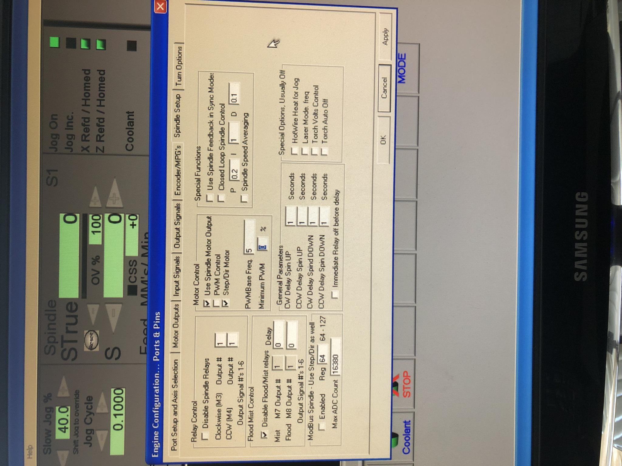

6 Attachment(s)
		Boxford 125 TCL - Mach3 Ports & Pins Spindle Configuration

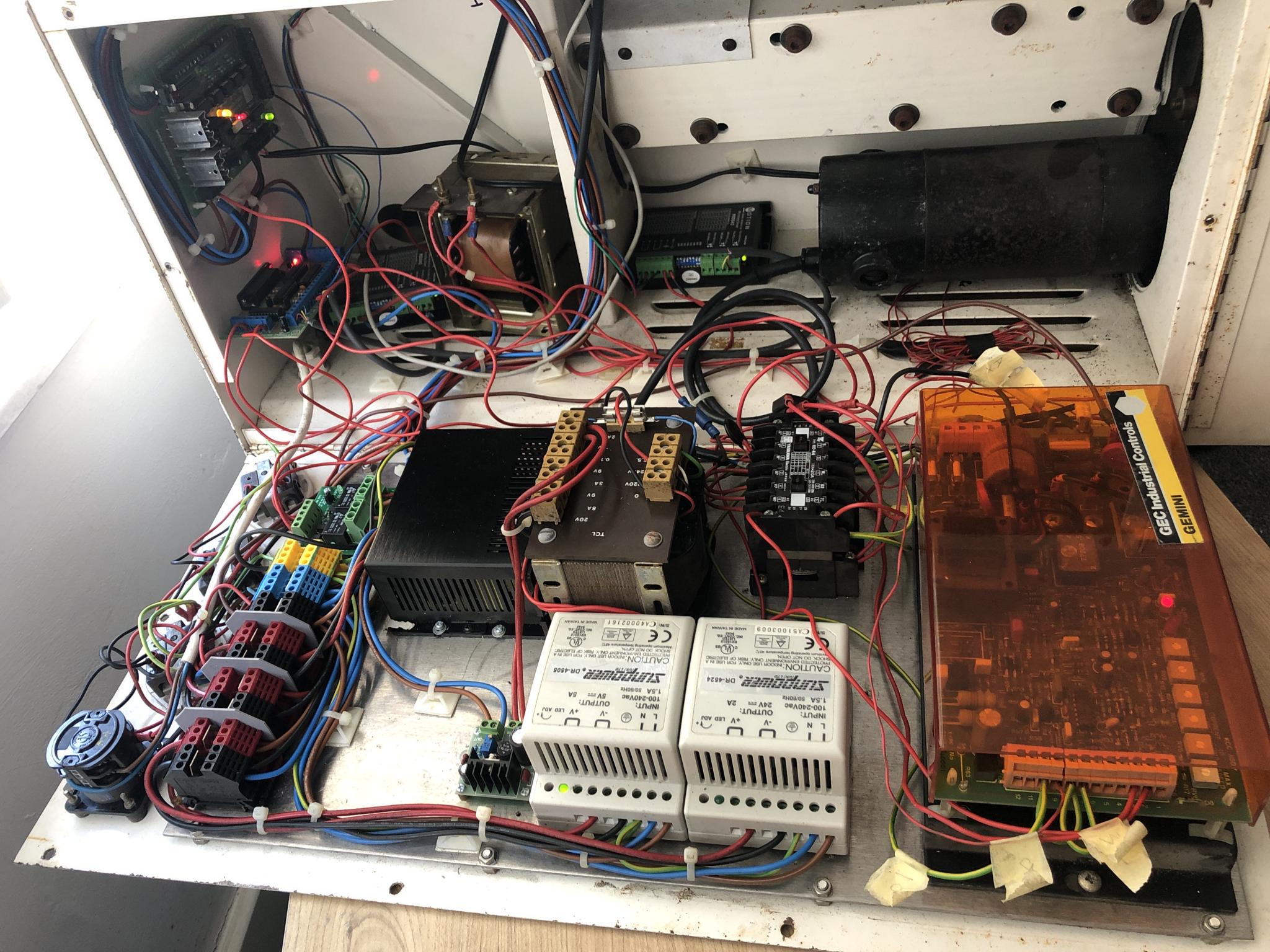

		Hi all, I purchased a Boxford 125 TCL (Mach3 conversion) a little while back with the intention of also buying a Milling machine which has also been converted to Mach3 so I could have a little home machining setup. When I got the 125 TCL home I plugged it all in and ensured everything was working as it should (X/Z axis’ & spindle), and all was fine (I also have a YouTube video demonstrating it working from the seller), so I left it dormant for a little while until I found the free time to delve deeper
So i recently decided it’s time to start cutting some material and I’m a CNC machinist by trade so the programming side is no issue. So I fired the lathe up and homes the X & Z axis, however when I tried to command the spindle to rotate with a simple “M03 S1000” command, nothing happened. I’m not sure if I was in the correct Mach3 profile at the time, but wether I was or not is irrelevant now as I’ve tampered with the settings so need to go back to basics. I’ve read all sorts for forums and scoured through a multitude of YouTube videos trying different values in ports and pins but so far I’ve had no success
To be clear, I have no experience with the internal workings of these machines although I am somewhat familiar with basic electronics, and I am just getting to grips with Mach3. Along my research and peering inside the machine I kind of figured out the basics going off the control board and I understand how the pins correlate to the inputs within Ports and Pins, although there are 25 pins on the data cable and only 16 inputs on the board. Besides that my findings for the control board are as follows:
1. (I think this feeds to the spindle relay but not 100%)
2. X-axis +
3. X-axis -
4. (Empty)
5. (Empty)
6. Z-axis +
7. Z-axis -
8. (Small cable feeding into another board, which is labelled “step”)
9. (Empty)
10. Kill switch
11. X-axis limit switch
12. (Small cable feeding into another board, which is labelled “out”)
13. (Empty)
14. (Empty)
15. (Empty)
16. (I think this feeds to the spindle relay but not 100%)

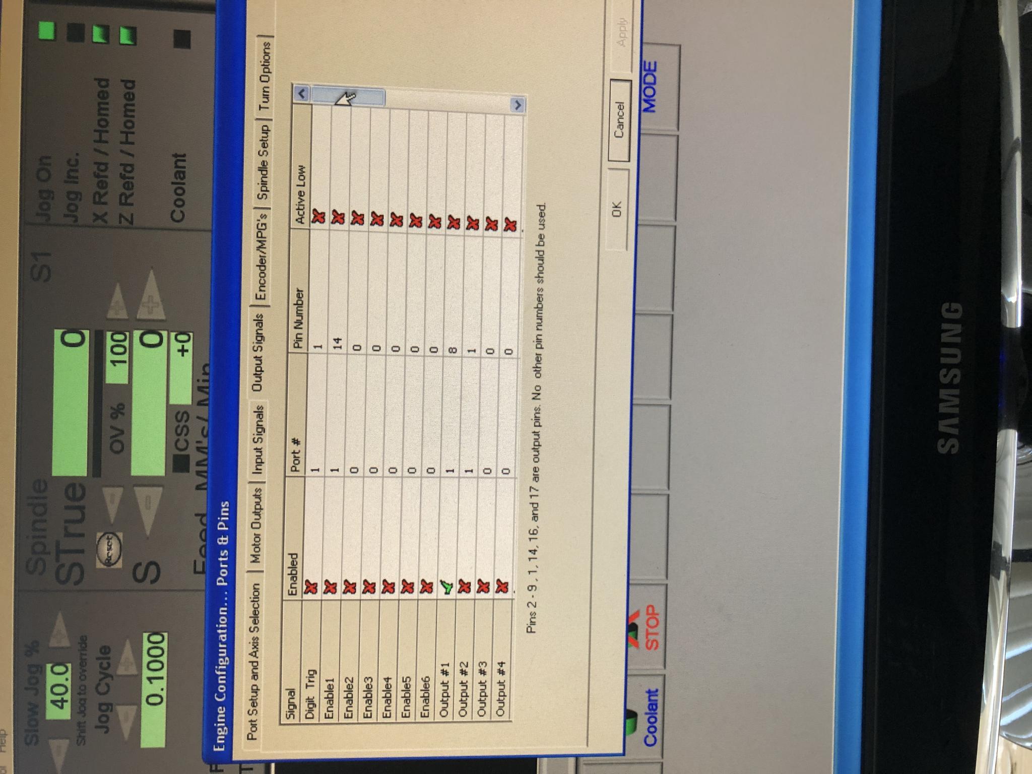

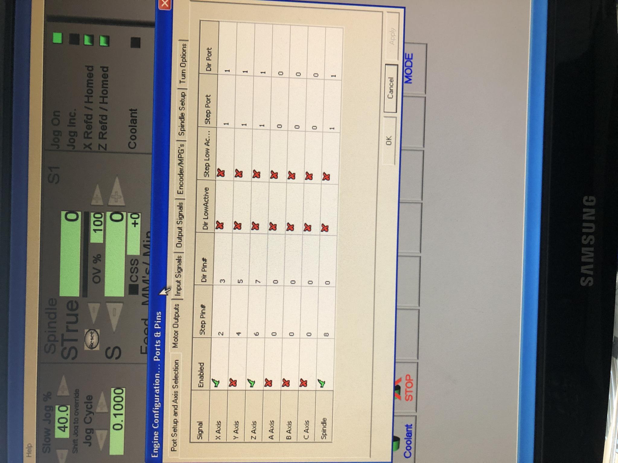

So, I am happy that the X and Z axis’ are working correctly along with the X axis + limit switch and the kill switch, however I am stumped on the spindle. I assume that ports 1 and 16 are being used to drive the motor as they feed to a large relay which goes to the motor (with a couple of pieces of hardware in between) and port 8 is being used to tell the relay to kick in, but as I mentioned I’m simply a noob and it’s 0 understanding of these machines
I have attached a handful of pictures, some of the machine and some of the Ports and Pins pages so see if somebody can guide me into the right direction
Many thanks, Repro!
Attachment 30428Attachment 30429Attachment 30430Attachment 30431Attachment 30432Attachment 30433

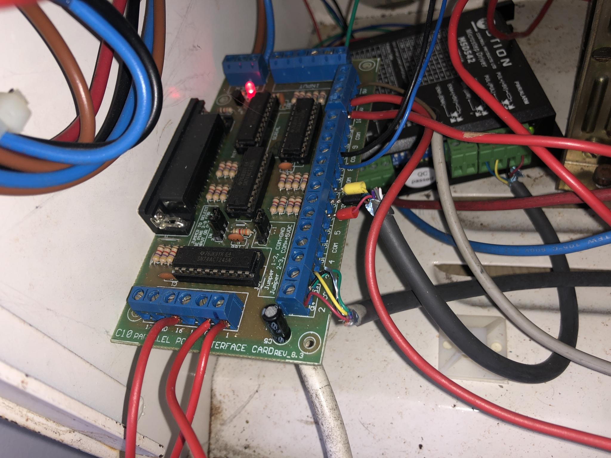

		Re: Boxford 125 TCL - Mach3 Ports & Pins Spindle Configuration
		Hi Reprobus . Thanks for detailed post .
Certainly a lot different to mine .  See http://www.mycncuk.com/threads/13959...TCL125+boxford   Skim through and you will find pic of the guts of mine.
Doyou know its history ?
Certainly looks to be  very much adapted from original  Although original motor , choke  and power supply transformer seem to be there . with a few added items of "bespoke" origin.
My motor drive was a Lenze  type and looks at first glance to have been replaced by the gemini contraption on the right .  More details of that would be useful.
Your BoB is  a very old style  compared to the sort we seem to see more often these days https://www.ebay.co.uk/itm/393334570...cAAOSw-7ZgpVSd
There may be some info on the underside  regarding the functions of the terminals on the near end of your board  .  but depending on where they are connected this may give us some clues .
Just beware  .   I cant see any info to specify  whether the Gemini controller   is an "isolated " drive . If not there may be some high voltages waiting to bite you.
		The 24v box isn’t putting out any power for some reason, I’m unsure whether the DC converter is broke or whether a signal has to be received from Mach3 first before the box puts out the power. I shall investigate
My new BoB has now arrived, so before removing the old one I labelled all of the wires to eliminate errors. The layout of the ports on the new BoB is rather different from my old one, but unfortunately I can’t upload a picture.
Between ports 2 and 3 (for example) on my old BoB there is a port labelled “COM” which I presume is ground. This isn’t on my new board so I routed the wires around to another ground port on the side
After fitting all of the wires to the new BoB I powered up the machine and tried to jog the X and Z axis but there was no movement at all, nor from the lathe’s kill switch. I’ll re-fit the old one for now and focus on getting the spindle turning

So I’ve replaced the 24v supply, the board has power and the relays are kicking in when I tell the spindle to turn (Relay 1 with M03 and Relay 2 with M04). I count this as a success, however the spindle still isn’t turning…

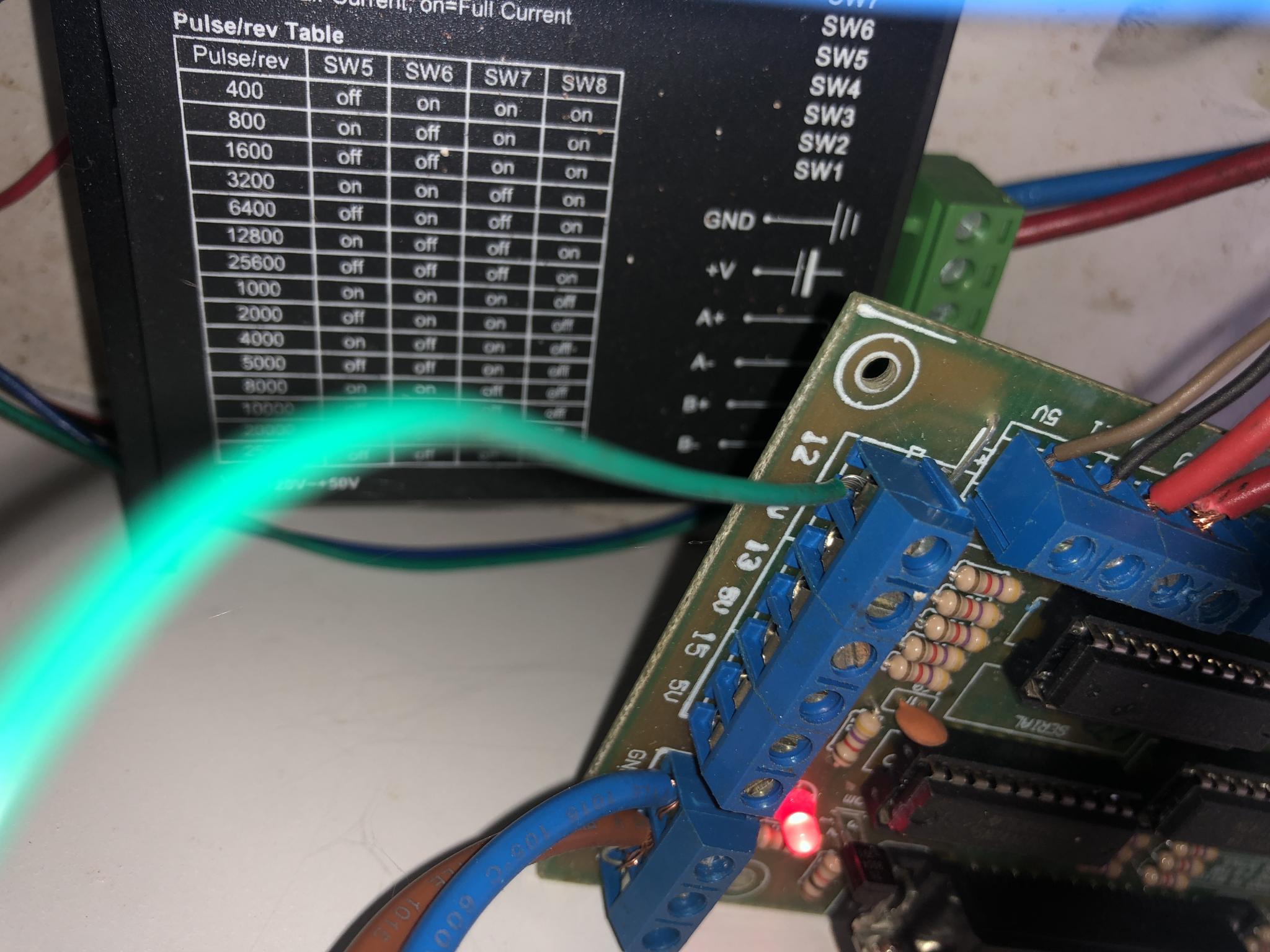

The only pins which I couldn’t work out on the BoB are pins 8 and 12. As mentioned in a previous post, pin 8 goes to another board where the terminal is called “Step”. Could this be what I’m missing for Mach3 to monitor/control the spindle RPM? If so, where within “Ports and Pins” do I put this value?

		2 Attachment(s)
		So it sounds like  your forward and reverse  relays are now supplied .

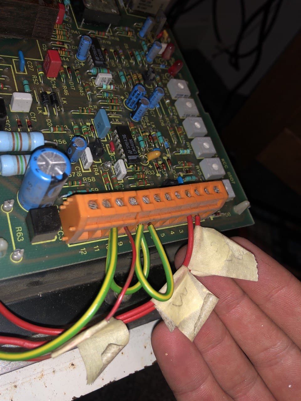

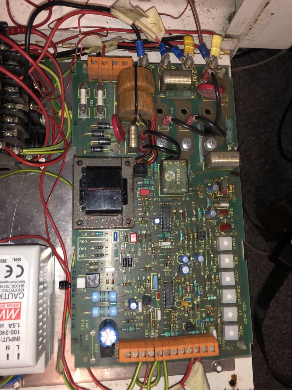

Next thing to check is your spindle  DC driver which is board with the orange perspex cover ( GEC gemini) . Do you have any info on it ? I cant raise any online.
Would also be useful if we could identify the functions of  two other boards   The small one adjacent to the 5V psu (I am wondering if it  could  be a PWM generator) and the one at the far left corner by the yellow terminal block which I think will be a simple relay board.
Somehow these in combination have to supply  your DC driver board .

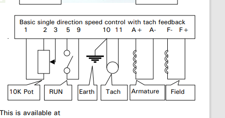

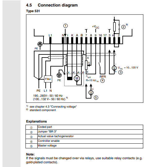

This is the wiring of the  original Lenze board used on some TCLs
Attachment 30456
And I am using a Sprint  DC driver with connections as shown here
Attachment 30455
You should see common elements here and I am sure your GEC board will have the same functions.
A run switch, and a 0-10v dc potentiometer .
On Sprint  they are 5-9 , and 1,2,3 respectively
On Lenze they are 16-17 and 7,8,9
If you can determine which they are on GEC you should be able to test the motor function separately  by connecting a simple switch and a pot .
With these you should be able  run the spindle  independently of computer connections and prove its functon.  Just  make sure you let the spindle  stop before selecting reverse .
If successful you can even run the spindle in this way  while you sort out the outputs from the computer in Mach.
We can then look at Mach settings to supply these from your computer.

		Thanks for your reply, I read it back a good few times on Sunday to try to break it down and understand how the GEC board works, but no unfortunately I have no info on this at present. Indeed my board does appear to have similar connections to your Sprint board although the layout is different.
I’m up for trying the “switch & pot” although I have no idea what a pot is, haha. I won’t be able to try this until next week however as my schedule for this week is pretty crammed
In regards to the two other boards you asked about, the small one is a relay board. It feeds relays 1 and 2 for the motor direction. If the other board is a PWM generator that might explain what my next step is within Mach3 > Ports & Pins > Spindle Setup

		A pot is a potentiometer .  Intended to vary voltage for a number of possible applications .
With these drivers a varying voltage input between 0  and 10 v  dc causes a varying output voltage typically from 0 v to 170 volts or so,  which will give full motor speed .
Most drives have a 10 v output terminal and a ground terminal across which a 10 kilohm  resistor can be connected .   A wiper brushing along the length of this resistor will pick up a proportion of this 10 volts  from 0v to 10v  which is used to feed the input terminal and this is all that a potentiometer does.   This in turn causes it to give an output  voltage to the motor between a minimum of zero volts which leaves it  stationary , to say 170 volts which gives it  full chat .  This is the simple way to operate  and indeed prove one of these drivers.  And this is what we are aiming to prove by connecting a pot .
Then In our case we want the computer to send the signal voltage which will vary the motor speed under program control , so the PWM output is used .
This may need to be converted to a 0-10v analog output which many modern breakout boards handle, or I suspect in your case the PWM output may be  used to generate a the 0-10v analog input which is needed to control your motor in a separate board .  This then replaces the function of the Pot.

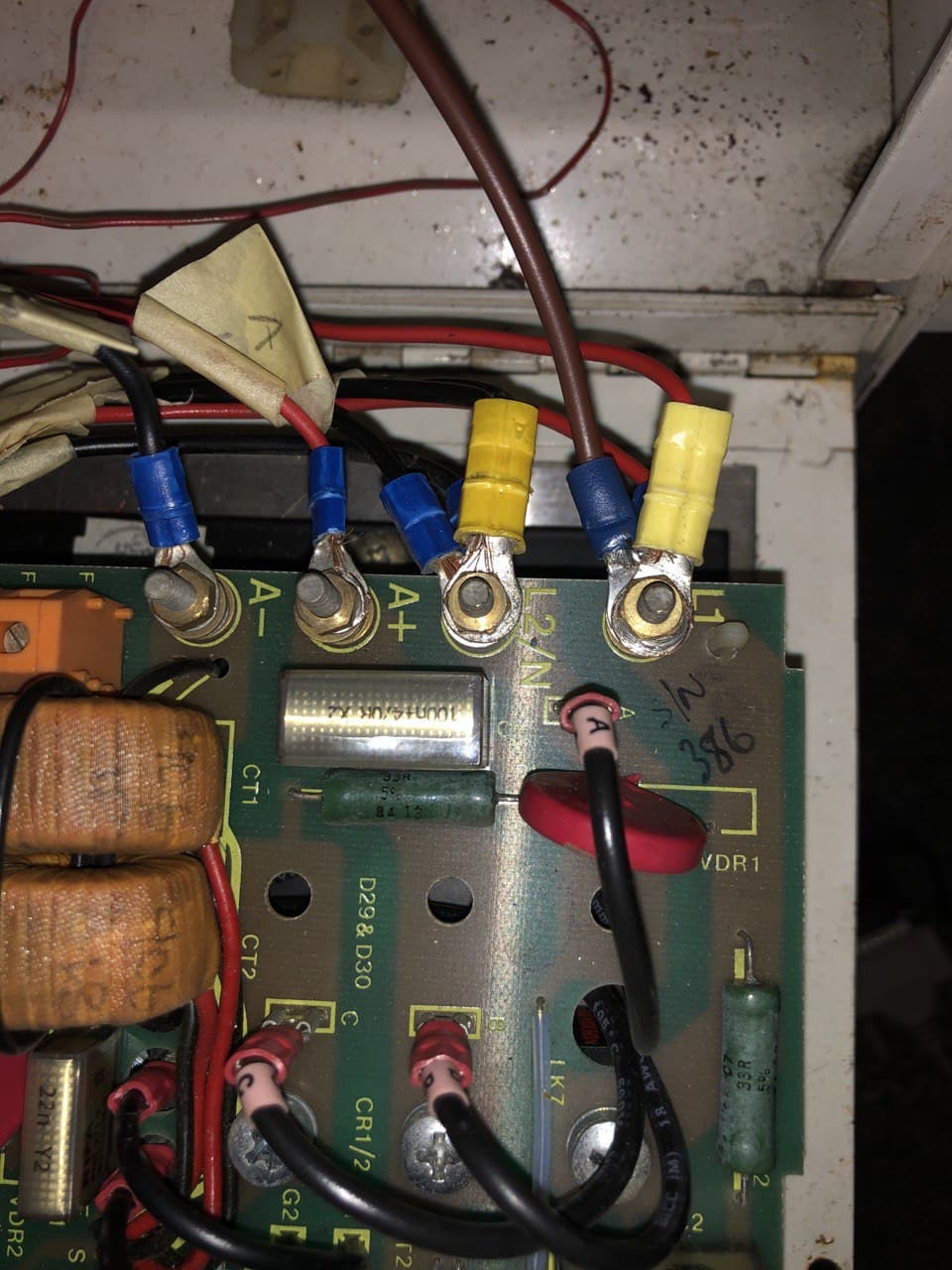

I've removed the orange cover from the GEC Gemini board (please see pictures attached)
I've also attached a picture of my "ports" findings for the BoB and Driver boards
