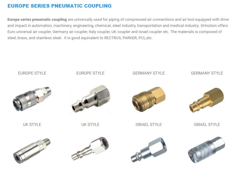

I can't make sense of the apparent panoply of air line couplings. I have recently purchased a compressor and a tiny pencil grinder from Germany and also a Fogbuster kit from US (although sourced from Sorotec Germany). I need to get some kind of splitter and an oiler for the die grinder. I guess the compressor and die grinder have some kind of Euro fitting and the Fogbuster some kind of US fitting - none of the manufacturers specify which kind - they just seem to assume you'll know. Most of the UK-available stuff seems to be BSP, of course.
How do I make sense of this stuff ? :) - I've tried a bunch of reading and web browsing - all I'm finding is more connector types - which isn't helping any. For instance for 'Euro' connector, I find this:
Attachment 30443
- which is really not helping. Some advice?
TIA, Alan
Re: Air line couplings aaaaahhhhhh....
The UK style you can find by search for PCL air connector, as it's probably the most commonly used.
Some people do prefer the Euro/German styles (I can't remember their proper names)
I will say if you do go PCL, buy genuine PCL, as there are a lot of cheap copies, that quite frankly are no where near as good, and will fail/ start leaking with little use.
In terms of fittings, nearly all air tool fittings will be some variation of BSP. 1/4, 3/8 and 1/2" depending on the tool. But it may also be described as G1/4, G3/8, or G1/2, which is just BSP with the inch bit dropped, and a G added to magically make it metric.

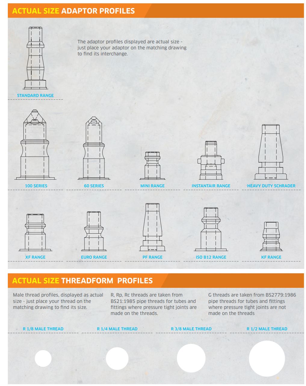

For anyone playing along - here's most of the varieties of just the PCL range:
Attachment 30457
And I think I'm going to standardise here on PCL XFs as that's what the tools I have here have already.
Alan
Just to add a little bit of spice, whereas page 19 of PCL's catalogue (above) shows 'XF' and 'Euro' with distinct profiles ... PCL likes to call one range of their connectors 'XF-Euro' - go figure.
